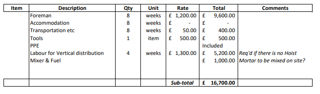

flanagaj Posted Thursday at 07:34 Posted Thursday at 07:34 (edited) Just received another quote from a building contractor and not only is it 30k more than the last, but it includes 9k for a Foreman. When I used to labour as a youngster for a two brickies, the only time I remember there being a Foreman on site was when we working on large projects, eg schools or hospitals. (Rant alert) - All I want, is a 2 * 1 gang who can build the shell up to plate and do a good job. Here is the prelims Basically that 60k to build a 200m2 house with attached single storey double garage. Edited Thursday at 07:43 by flanagaj

flanagaj Posted Thursday at 12:49 Author Posted Thursday at 12:49 I must admit, I do like "Vertical distribution". Not heard that term before.
DannyT Posted Thursday at 20:41 Posted Thursday at 20:41 (edited) I just commented on your other post but as a bricklayer in a 3-1 we get some work down in a day and your quote is taking the piss. What’s the £500 for tools? £9600 foreman? All of the gang should be capable of reading drawings, organising etc. Edited Thursday at 20:45 by DannyT 3
flanagaj Posted Friday at 16:28 Author Posted Friday at 16:28 19 hours ago, DannyT said: I just commented on your other post but as a bricklayer in a 3-1 we get some work down in a day and your quote is taking the piss. What’s the £500 for tools? £9600 foreman? All of the gang should be capable of reading drawings, organising etc. Thanks for your comment. Yes, they are taking the proverbial ****. Estimators online gave me a labour quote or around 20K for all masonry works up to plate. The £9600 is an insult and the guy knew that I had worked in construction when I was younger. No idea what he was thinking.

Nickfromwales Posted yesterday at 11:03 Posted yesterday at 11:03 I wish I could charge for “tools” lol. Could just drop my stuff off at 08:00 and collect again at 16:30, and say “stump up please “ Finally, the perfect career
saveasteading Posted yesterday at 11:21 Posted yesterday at 11:21 On 21/08/2025 at 21:41, DannyT said: All of the gang should be capable of reading drawings, organising etc. Really? In my experience of a 3 person gang. The lead bricky (or other trade) sometimes can read a drawing and manage. The second bricky seems good until left in charge. The labourer no chance. The potential need for a foreman will depend on the gang, the complexity and the client. 1
Nickfromwales Posted yesterday at 11:28 Posted yesterday at 11:28 Defo need one person at the helm and the others following. One person to take the info, and one person responsible. If not, it’s he’s said / she said, or worse; when the chap you programmed fecks off for a few days leaving Larry and Mo behind, who immediately start doing their own thing.
