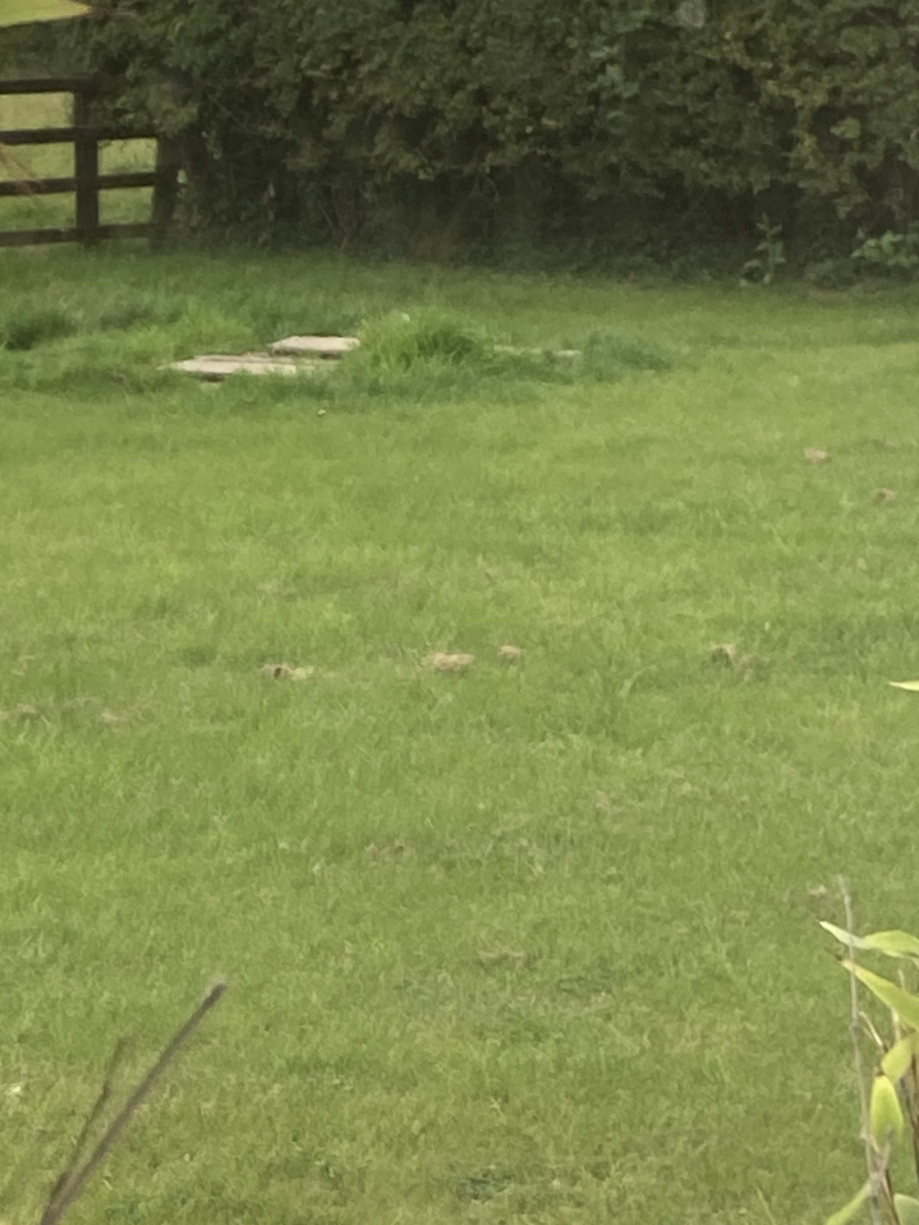

Fallowfields Posted Wednesday at 09:10 Posted Wednesday at 09:10 15 hours ago, jumbletons said: Hi all, To DIY or not to DIY? Shared septic tank (brick, from 1960s, not huge) is being closed and decommissioned. Professional websites say not to DIY it, in case of leakage/collapse, but a lot of people seem to DIY it. I'm a part owner of the tank, but it isn't on my property....should I care how it's done?? Personally I'd prefer to have a document to add to my property records that shows the septic tank was appropriately decommissioned (because I'm a part owner, even if it's not on my property) - if nothing else it may stave off issues if/when I sell my property because solicitors want EVERY document! The costs have been estimated based on man hours for moving rubble/soil to the site from where a new STP is currently being installed, and we've all agreed to pay our fair share of this cost - it would be fairly simply to just get one of the guys doing the new STP installation to fill the septic tank in, and we all get a copy of the invoice for our records. Other owners, including the person whose property the tank is on, think we should just DIY it and don't need a professional or proof of professional decommissioning. I suspect this is a cost-cutting thing for my neighbour, as it means my £ share goes towards the neighbour's labour/time rather than the installer (fair enough, not the best job in the world!). If we DIY it I may offer to move my proportion of rubble and contribute to the decommissioning with labour rather than money 😆 But my main concern is protecting myself and my property from practical/legal issues further down the line. So, to DIY or not to DIY? Will anyone know it was even there. we did ours ourself. We had it properly cleaned and threw all rubble, soil, sand and stone, packed it down with tractor bucket, pulled soil over and plan to put more soil on top before seeding for grass.
jumbletons Posted Wednesday at 10:08 Author Posted Wednesday at 10:08 56 minutes ago, Fallowfields said: Will anyone know it was even there. we did ours ourself. We had it properly cleaned and threw all rubble, soil, sand and stone, packed it down with tractor bucket, pulled soil over and plan to put more soil on top before seeding for grass. Good question, it’s in a small yard so not somewhere that can be planted over but it’s not really my problem what it looks like as it’s not my property, only really if there’s a safety/liability issue and the answer seems to be ‘not really’, so the owner of the property it’s on can do things however they see fit. 1
