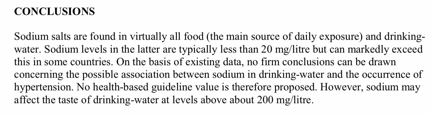

Nick Laslett Posted August 23, 2025 Posted August 23, 2025 (edited) Drinking water quality… HUGE can of worms!!! We are in the safe hands of Ofwat and the commercial water companies for the quality of our drinking water! Here is a UK Government note on Water Hardness: https://www.dwi.gov.uk/consumers/learn-more-about-your-water/water-hardness-hard-water/ Document ‘G’ sets out the regulations. Here is an FAQ that covers the topic of “wholesome water”: https://assets.publishing.service.gov.uk/media/5a81a884e5274a2e8ab552a5/160321_Part_G_FAQ.pdf Here is a good primer on the topic of softened water from a water treatment specialist: https://watertreatmentservices.co.uk/drinking-softened-water/ Here is the standard for our water: https://www.dwi.gov.uk/drinking-water-standards-and-regulations/ You can check your local water quality on your suppliers website. Here is an example. https://www.stwater.co.uk/my-supply/water-quality/check-my-water-quality/ Use the Water company HQ post code CV1 2LZ for results. TLDR, Your main drinking water supply should be from the mains. Recommendation is not to regularly consume large quantities of water that contains more than 200mg/L of sodium. You will need to test the water provided by your water softener to see if it is below this limit. For a comparison reference, here is the water analysis for Buxton Mineral water https://www.buxtonwater.co.uk/bottled-water/still WHO paper on Sodium in drinking water: https://www.who.int/docs/default-source/wash-documents/wash-chemicals/sodium-background-document.pdf Edited August 24, 2025 by Nick Laslett 2
sharpener Posted August 24, 2025 Posted August 24, 2025 (edited) 17 hours ago, Nick Laslett said: TLDR, Your main drinking water supply should be from the mains. Recommendation is not to regularly consume large quantities of water that contains more than 200mg/L of sodium. Has been the received wisdom for decades. I would be particularly hesitant to drink softened water if immunocompromised, have high blood pressure or less than perfect kidney function. Difficult to avoid entirely as our tap water comes ultimately from Dartmoor so quite acidic. A SWW chemist told me they treat it with NaOH to raise the pH. But according to the calculator at www.aqion.de only 0.1 mg/l is required to raise it to pH 8.4 so it is miles below the 200 threshold. Nearly all the outlets in the house are fed from harvested rainwater; to raise the pH we treat it with NaHCO3 at about 100g/m^3, which is quite a lot of sodium. So we have tap water piped to drinking water taps in the kitchen and bathrooms. Edited August 24, 2025 by sharpener 1

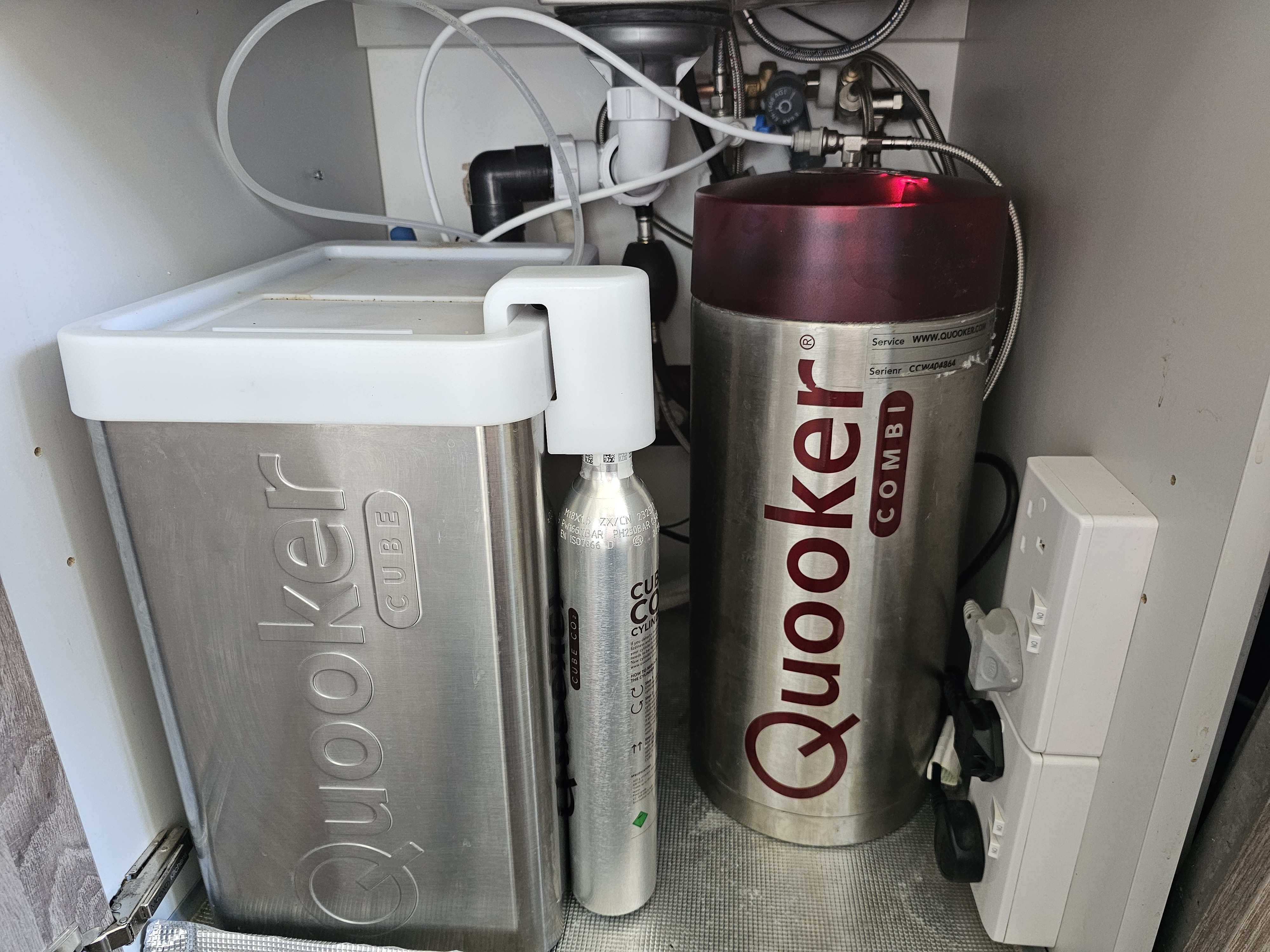

canalsiderenovation Posted September 3, 2025 Author Posted September 3, 2025 (edited) Edit to add that Quooker have confirmed that our Quooker Combi tank is cold fed as is the Cube so if we left the cold water feed hard then the water in the combi tank that is boiled will remain hard which is pretty much one of the main reasons we were looking into a softener as it's destroying the Quooker Combi tank! They pretty much had to replace it a couple of weeks ago when they came out and it has huge shards of limescale in it. If we leave the utility cold feed hard then we could drink that but I like my ice cold filtered and sparkling water from the Cube! Edited September 3, 2025 by canalsiderenovation
