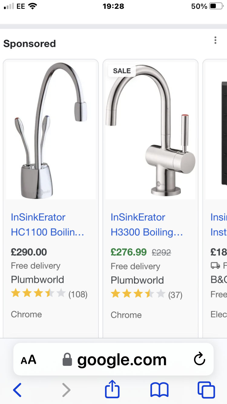

nod Posted Tuesday at 15:58 Posted Tuesday at 15:58 A friend has a insincuted boiling tap It went wrong after two years and they replaced it free of charge a cup of tea tastes the same out of his boiling tap as ours £350 1
canalsiderenovation Posted Tuesday at 18:01 Author Posted Tuesday at 18:01 2 hours ago, ProDave said: That is a Proboil 2, the same as I have supplied by Howdens under their own brand. Ours was originally the Proboil 1 but the boiler was replaced under warranty as it failed in the first year and replaced with the Proboil 2. Ours only has ordinary hot and cold and boiling (actually 98 degrees) We are in a soft water area so no scale issues and I didn't even bother installing the supplied in line filter. There are also instructions on the Proboil site to dismantle and descale the boiler if needed. Our Proboil 2 has been in use for about 6 years now. Get a price from Howdens before buying. Ahhh so its the same tap? I'll get a price from Howdens too and see if its any different. Can you send me the link for it I can't seem to find it! Thanks
canalsiderenovation Posted Tuesday at 18:04 Author Posted Tuesday at 18:04 2 hours ago, nod said: A friend has a insincuted boiling tap It went wrong after two years and they replaced it free of charge a cup of tea tastes the same out of his boiling tap as ours £350 Do you have a link for this? Do you mean InSinkErator? https://kitchensinksandtaps.co.uk/h3300-brushed-steel-boiling-hot-water-tap-only
nod Posted Tuesday at 18:27 Posted Tuesday at 18:27 22 minutes ago, canalsiderenovation said: Do you have a link for this? Do you mean InSinkErator? https://kitchensinksandtaps.co.uk/h3300-brushed-steel-boiling-hot-water-tap-only I don’t sorry I may have spelt it wrong also I can ask 1
