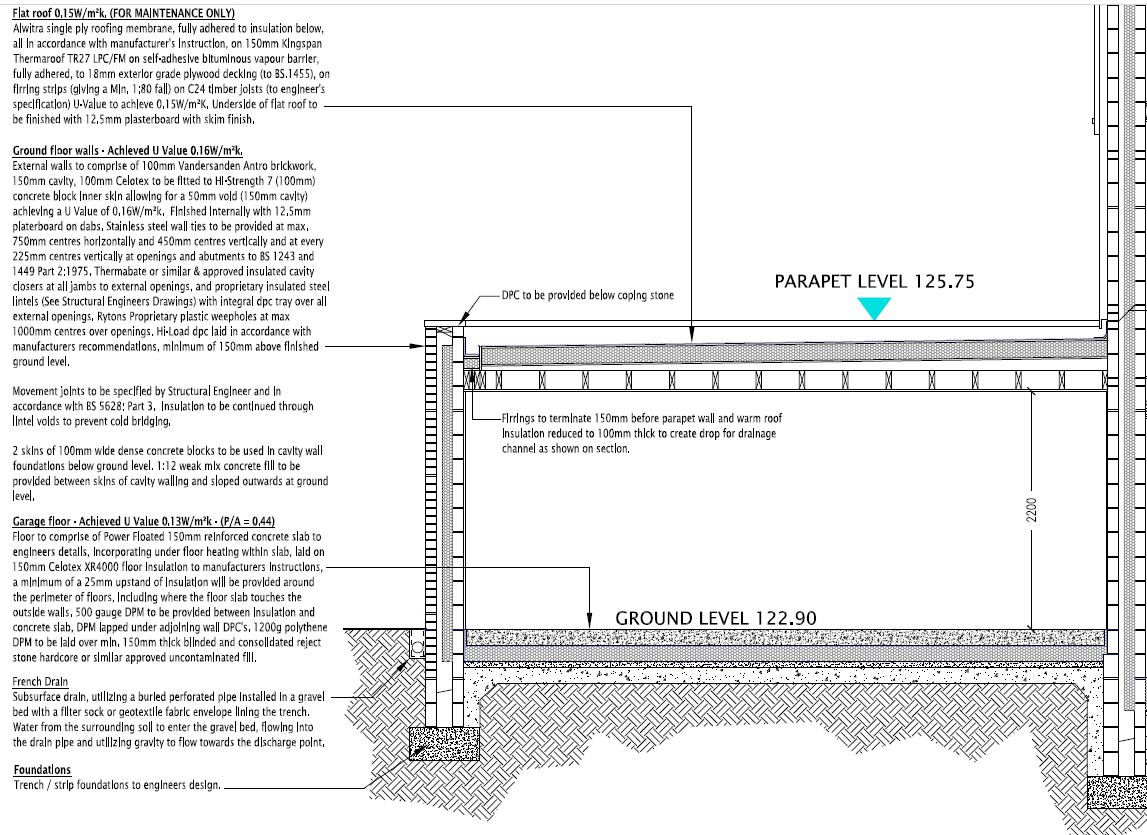

flanagaj Posted yesterday at 09:51 Posted yesterday at 09:51 (edited) One of the requirements for our build is that I want a garage that is not cold and damp. As a result the TA has specified cavity walls as per the main house, 150mm celotex floor insulation and 150mm Kingspan TR27 roof insulation. This obviously comes at a cost and I am wondering whether it is overkill and I could reduce the floor insulation and also the roof insulation a bit. There is no door connecting the garage to the house. The garage will be my workshop and gym so having something that is not Baltic during the winter months is the main criteria. I am also thinking of putting a radiator in too. Edited yesterday at 10:00 by flanagaj added image

Nickfromwales Posted yesterday at 11:25 Posted yesterday at 11:25 Parapet looks better than an upstand?! And far more robust for directing runoff, also hides the slope. Is this really a bank breaker? Not a lot of insulation here, and if I was going to pay to install poor insulation or the same labour / time to fit much better insulation…..🤔 1

saveasteading Posted yesterday at 12:15 Posted yesterday at 12:15 Its certainly very well insulated. Lucky car. What is the garage door spec? Is it insulated? What draught seals are around it? If not a very special garage door then your heat will pour out of it and all the extensive insulation will be pointless. It's designed to a house spec. Either that is all your designer does, or you intend slowly turning it into a habitable room which I can't condone. 1

saveasteading Posted yesterday at 15:23 Posted yesterday at 15:23 I'm renovating a pitched small farm shed, 12m x 9m, to be a garage, store, workshop. We are putting 40mm composite on the roof and walls, nothing on the floor. The doors may be up and over , with virtually no insulation, or perhaps a wooden pair, a little better. Heating will likely be infra red pointing at work bench. It won't be Baltic. 5 hours ago, flanagaj said: garage will be my workshop and gym so Not a garage at all then? No car type door? I suggest you design it for that, including any PP and building regs it needs. Otherwise the insulation and ufh are wildly excessive. Lose the parapet and fit external gutters and this will reduce risk long term, and make construction easier and insulation better. You can add a rainwater barrel for car cleaning nearby. All in all, there's a good few £k saving. 1

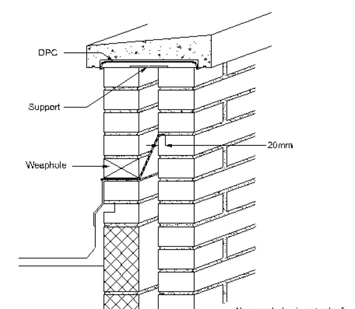

LnP Posted 23 hours ago Posted 23 hours ago Should there be a cavity tray below the coping in the parapet?
