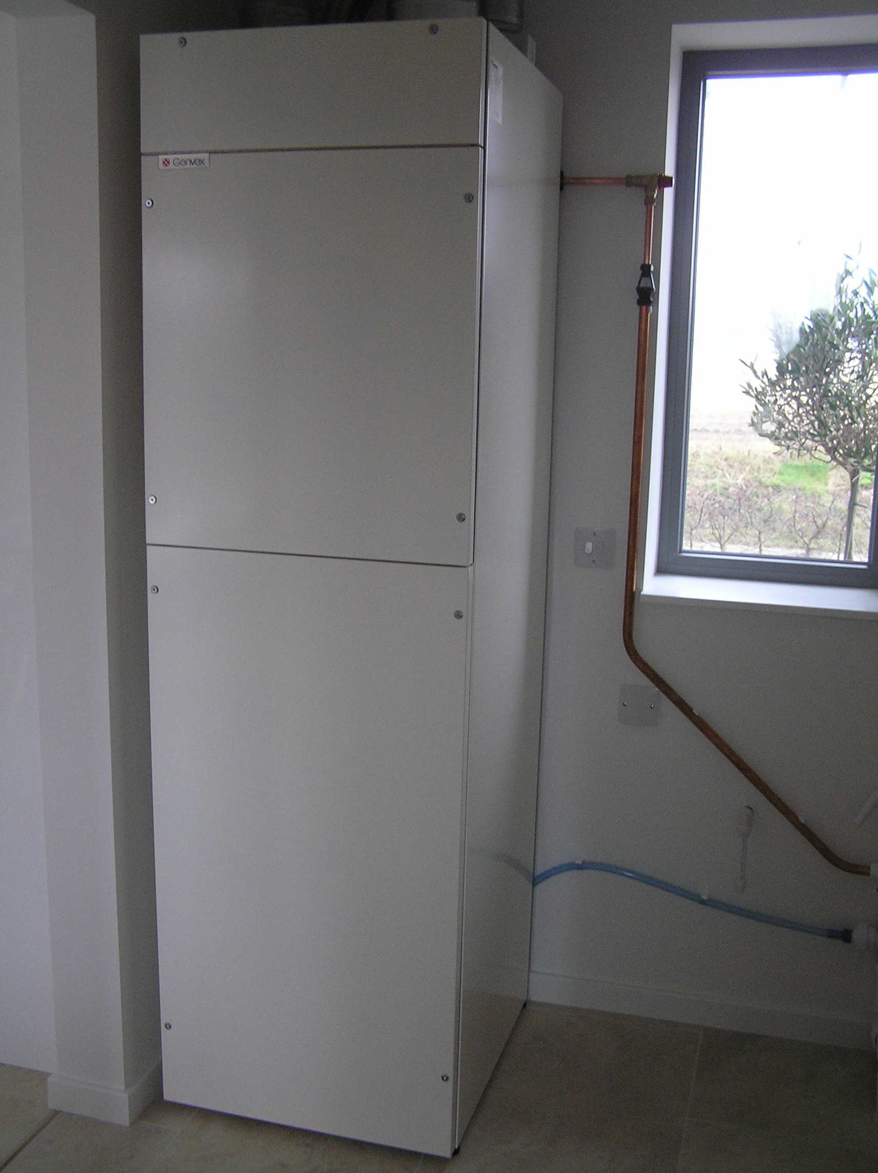

3 hours ago, graeme m said:
I'm now looking at the Nilan Compact P system. I like everything in one box. Ducting is blooming expensive though.
That looks very similar to the Genvex Combi 185LS that I have installed in our house. It provides ventilation, hot water and warm air heating. I used plastic ducting which has worked well.
3 minutes ago, graeme m said:
Peter dare I ask the price?
Just over £5000 direct from Denmark. Just over £8500 in bought in the UK.
Does that include the ducting?
How does the warm air heating work? Is the only heating you have?
It has a built in EASHP which heats the water and heats the ventilation supply air up to 40C. That is supplementary heating because we also have electric towel rails in each of the three 'bathrooms'. These are 300W but are turned down to around 200W and are on eight hours a day. The heat from these is recovered and heats the supply air. We are not living in the house yet but it's kept at around 19C/20C. The Genvex Combi185LS has worked well for us so far but ours is a very low energy house.
No I bought plastic ducting and fittings which I fitted myself. I did design the system myself so it was easy to work out was was required.
I'm building Passive certified. The Nilan is similar but it's £5000 here plus the tubing which is £2500 (silver lined apparently).
The silver coating is to prevent bacteria etc forming on the inside surface. I don't know if that is overkill or not, sounds like it might be to me. Do you have to use their ducting, so it would invalid a warranty if you don't for instance.
I don't know as only spoke briefly with the supplier. I'm waiting on the revised PHPP before making taking things further.
