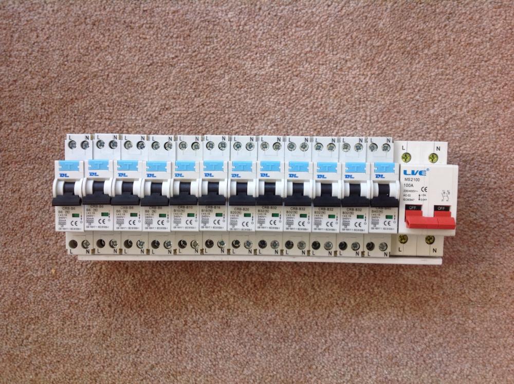

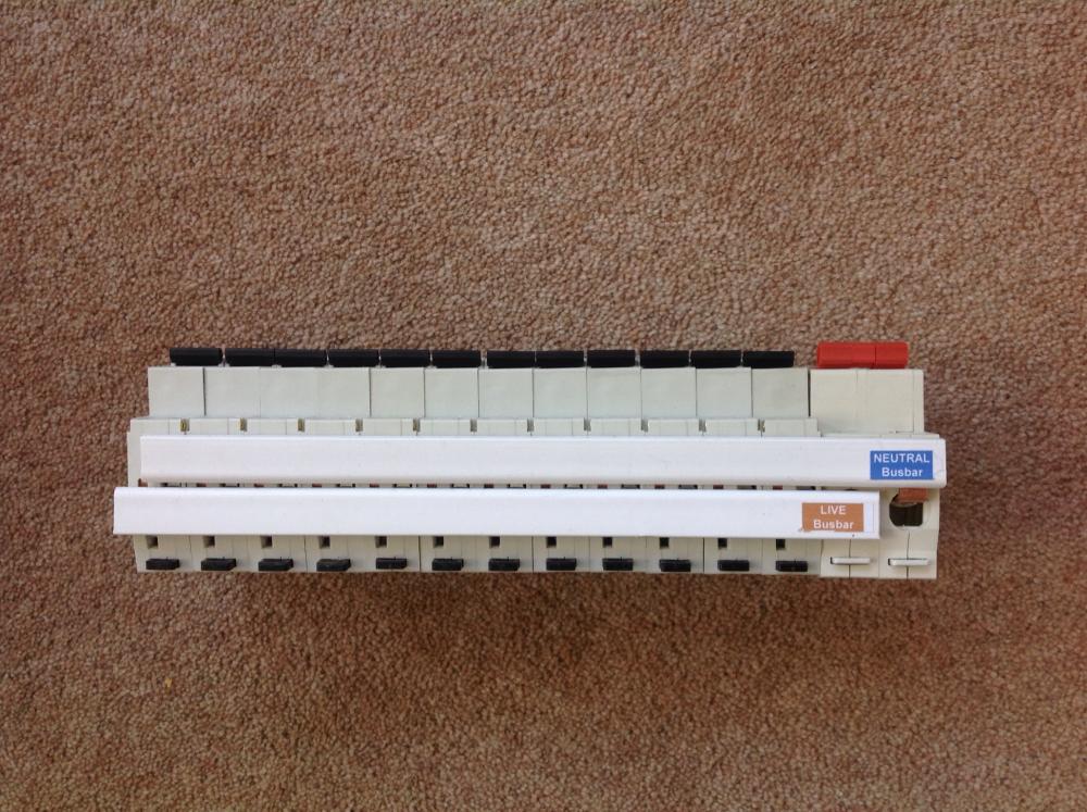

I'm not touting the SBS products but a couple of pics of a pre assembled line of DP RCBOs done for a customer with an existing cu - in this instance Wylex. The idea as I alluded to above is out with the old main switch, RCDs and breakers. For every 2-module wide RCD you ditch you get space for two more circuits. In a split load board thats 4 more ways. Each circuit is protected by its own RCBO and if it trips it affects no other circuit. Clips onto the existing DIN rail. Tails into the main switch, line and neutral for each circuit into the L & N atop each RCBO and all cpcs (earths) to the earth bar of the cu.
Note the separate L & N bars running under the line of RCBOs - means you don't have a neutral bar on the enclosure like on most.

That looks like a nice piece of kit. Single module double pole rcbos like this are fairly standard in France , but rarely seen in the UK. What's your preferred source for these parts? And how do you get round the various regs glitches when fitting them into pre-existing consumer units from other manufacturers? Such as approvals of boxes only apply when fitted with the box suppliers own components (especially when connected to the DNO supply direct) or the updated requirements on non-combustible enclosures? No criticism intended, just need to know how to present an install like this to my scheme assessor.
Simple answer is BS7671 is not "the law" just one way to comply with it.  There has to be a bit of common sense. e.g a Crabtree rcbo would be no more or less likely to catch fire in a wylex box than a crabtree box.
Those components are sold in the UK by a trade only distributor. To make up an all rcbo set up like that costs roughly double the price of a standard split load twin rcd setup, and for me unfortunately most of my customers I have offered that to reject the cost and opt for the standard twin rcd split load board.
So many points there! :) Tbh I can't answer them all, only really generalise.
See here for the SBS page ref certification:
https://www.sbstradesales.co.uk/products/
Somebody else on here recently went all DP RCBO but not from SBS as SBS sell to trade only. They went to Live Electrical for their stuff. I think the Live and SBS DP RCBO's are all made in the same factory. Live have strong Chinese links as in company directors:
https://beta.companieshouse.gov.uk/company/07429017/officers
There's some tie up as SBS use Live boards.
My take on the mix 'n match is that individual components like the metal enclosure and a line of like RCBOs even if from different makers, when put together, combine to satisfy the regs. Most problems are caused IMO when people fit / force in the physically wrong sized breaker with different busbar offsets. Don't know what an insurance company would make of it in the event of an issue...
When a split load board of any make simply doesn't comply with the regs anyway I'd see such an upgrade as making an old board more compliant rather than less. We all know split load boards are a compromise.
