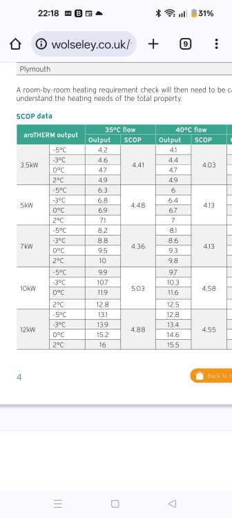

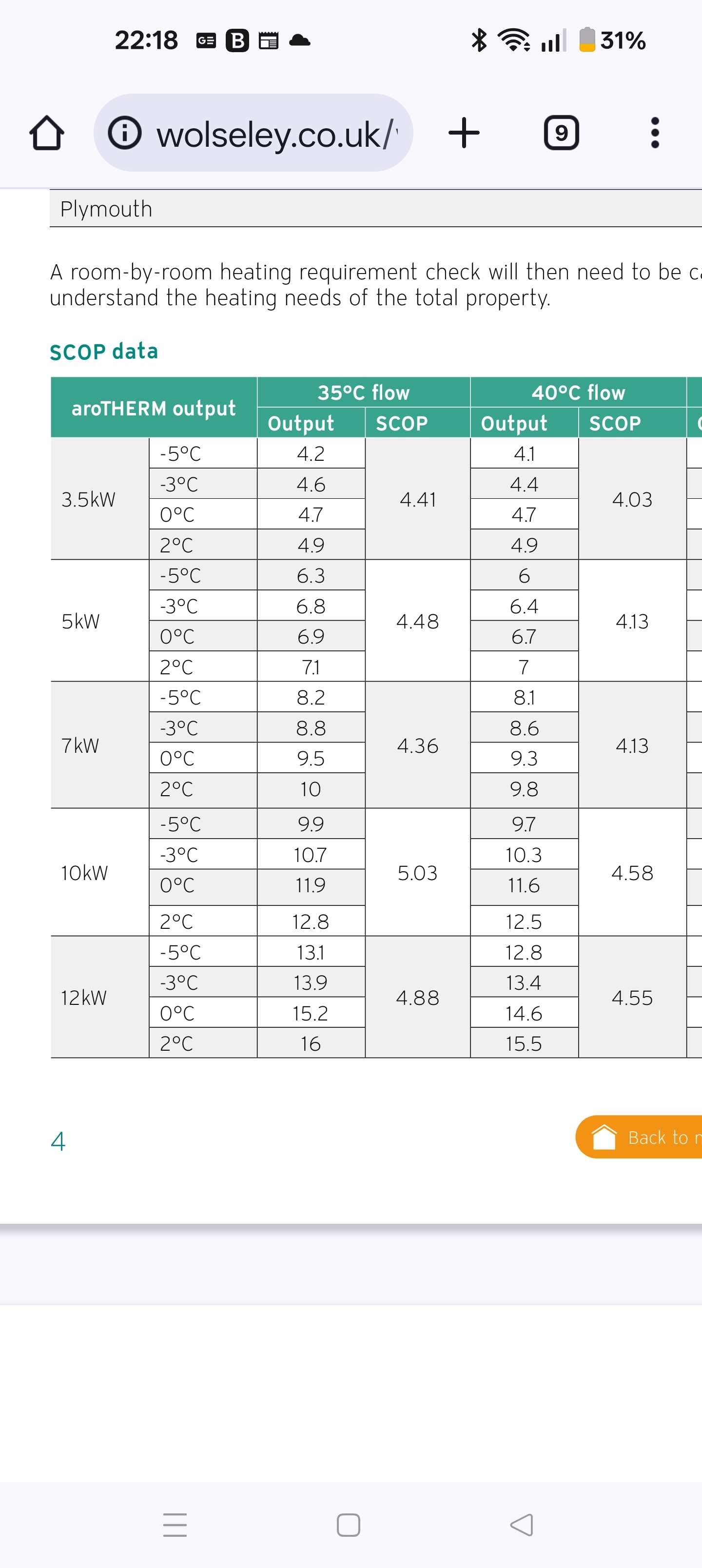

54 minutes ago, SBMS said:
9kW at -4 in total
So including DHW if 9kW is correct you need a 10kW Vaillant, but if 9kW is rounded up you could use a 7kW. Your flow temp shouldn't exceed 35, possibly lower and a 7kW puts out 8.8kW.

8 hours ago, JohnMo said:
10kW Vaillant
Which is the 12kW model firmware limited.
Does the 10kW modulate down to same level as the 12kW? What’s the point in going for the 10kW then??
So far as I know yes and none respectively, except for a relatively small price difference.

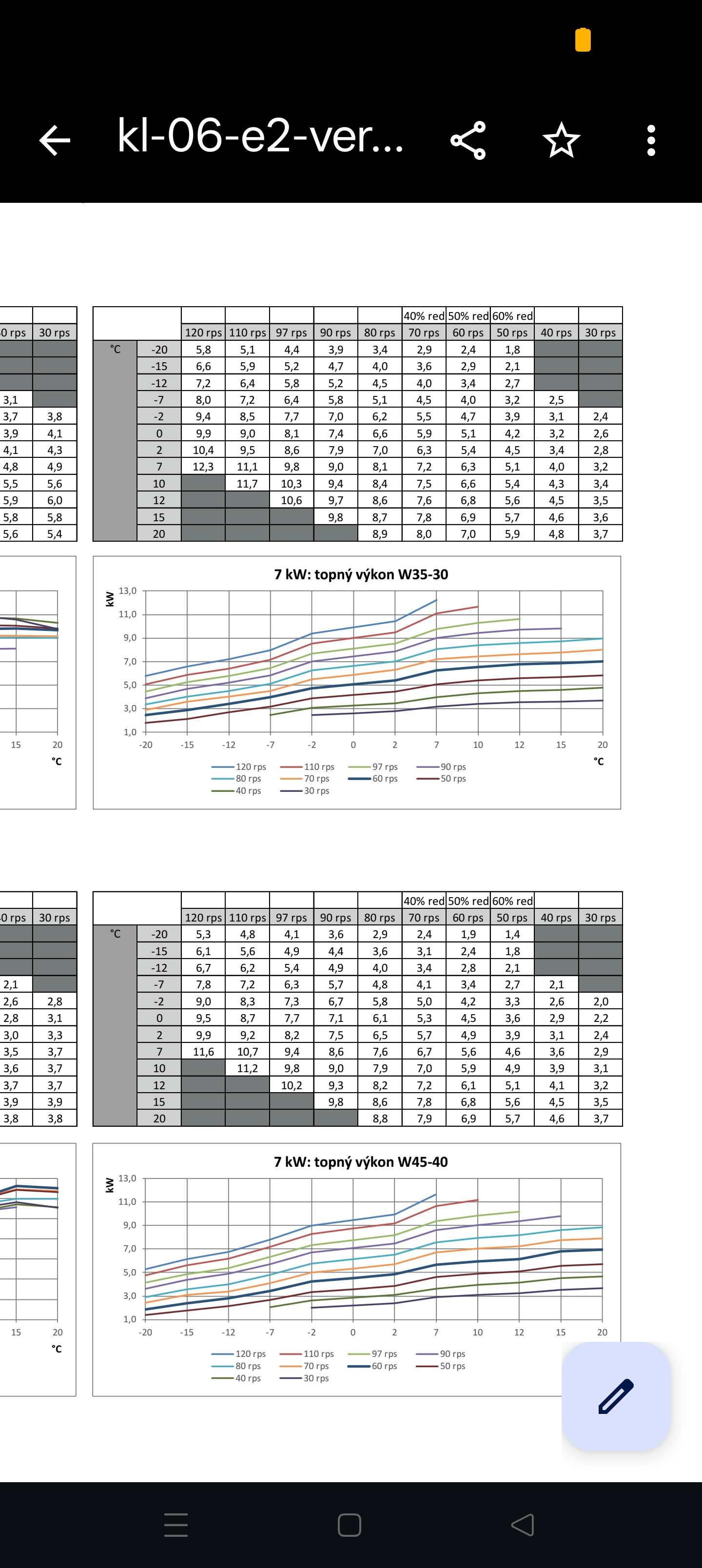

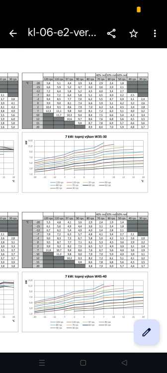

1 hour ago, JohnMo said:
Attached. Page 33 on
At 7 degs the 10kW puts out between 7 and 15kW.
The 12kW puts out 7 to 18kW
At -7 the 10kW puts outs 4 to 9.5kW
While the 12kW puts outs 4.5 to 13kW
Interesting that the 10 modulates lower than the 12 in heat mode (and outputs higher) but in cooling mode the maximum output is identical. (Page 5)
makes me think it’s the same hardware but software is range setting in heating mode but allowing the compressor to run full speed in cooling mode. Which actually is a useful thing for me as there is no additional cooling output with the 12kW but the 10kW is possibly better suited for my heat loss requirements 🤷‍♂️

On 08/08/2025 at 23:07, JohnMo said:
It's good to have facts to allow you to make informed decisions.
Unfortunately, Vaillant don't really have the data for modulation on the Arotherm plus heatpumps - all you get is an approximate at certain outdoor temperatures. I asked the question just a few days ago when I was at Vaillant for training on the Arotherm plus heatpumps and they went internally to ask the technical design team. Therefore, you can't use any data to accurately design a system according to modulation on these heatpumps.
The Vaillant quick guide charts are given at maximum compressor speed only.
Have you looked at the data book I attached above? Me thinks they just don't want to tell you.
Here is snippet - all temps full range of compressor speed. All compressor sizes in data book attached above.
Screenshot_2025-08-10-11-06-44-23_e5d3893ac03954c6bb675ef2555b879b.thumb.jpg.f2b04976d39aedec254d5ef1a89952df.jpg
