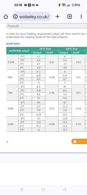

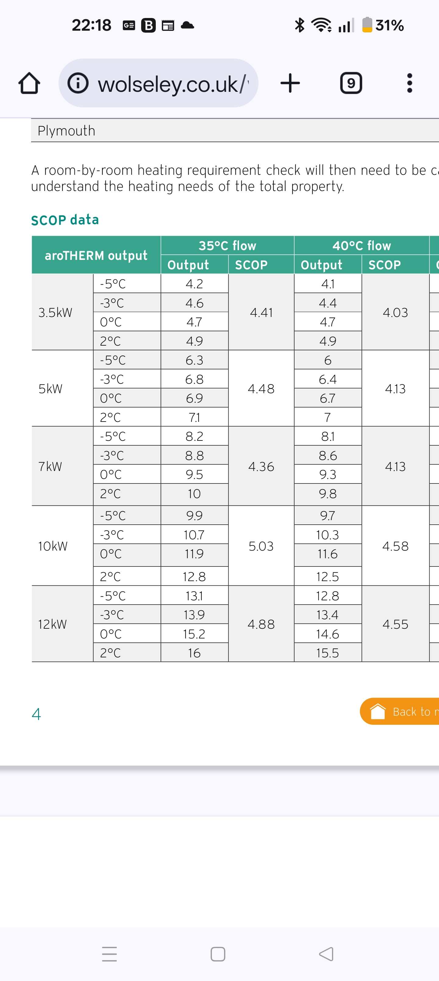

On 07/08/2025 at 23:25, JohnMo said:
So including DHW if 9kW is correct you need a 10kW Vaillant, but if 9kW is rounded up you could use a 7kW. Your flow temp shouldn't exceed 35, possibly lower and a 7kW puts out 8.8kW.
Screenshot_2025-08-07-22-18-00-90_40deb401b9ffe8e1df2f1cc5ba480b12.thumb.jpg.7ab5cc3f9cbe8031100db92ffab491da.jpg
We need to stop quoting/using Vaillant datasheet numbers in relation to sizing; they are peak output figures which cannot be achieved over any length of time in UK winters with frequent defrosting.
There’s a reason the units are named ‘7kW’, ‘10kW’; these are roughly the sustained outputs they’re capable of under prolonged defrost conditions (providing there’s enough water volume to facilitate the defrosts).

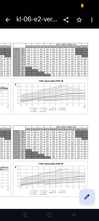

What is your source for said information? So we can use that instead, and what do we use for other manufacturers data?
16 minutes ago, ectoplasmosis said:
At least that is some good testing to show where Vaillant get the name plate data from, which has always been unclear.
So a general in the round assumption for heat pumps - not just Vaillant.
ASHP are tested to European standards. Europe (not UK) is less coastal than the UK, so has a lower humidity in winter than the UK. As a result, the ASHP has less need to complete defrosts.
To compensate for the difference in humidity levels at or close to design point, an ASHP designed to be installed in the UK, should be over sized by 20% (above datasheet) at design point conditions, to allow a clear margin for defrosting. This is especially important in coastal and near coastal locations.
