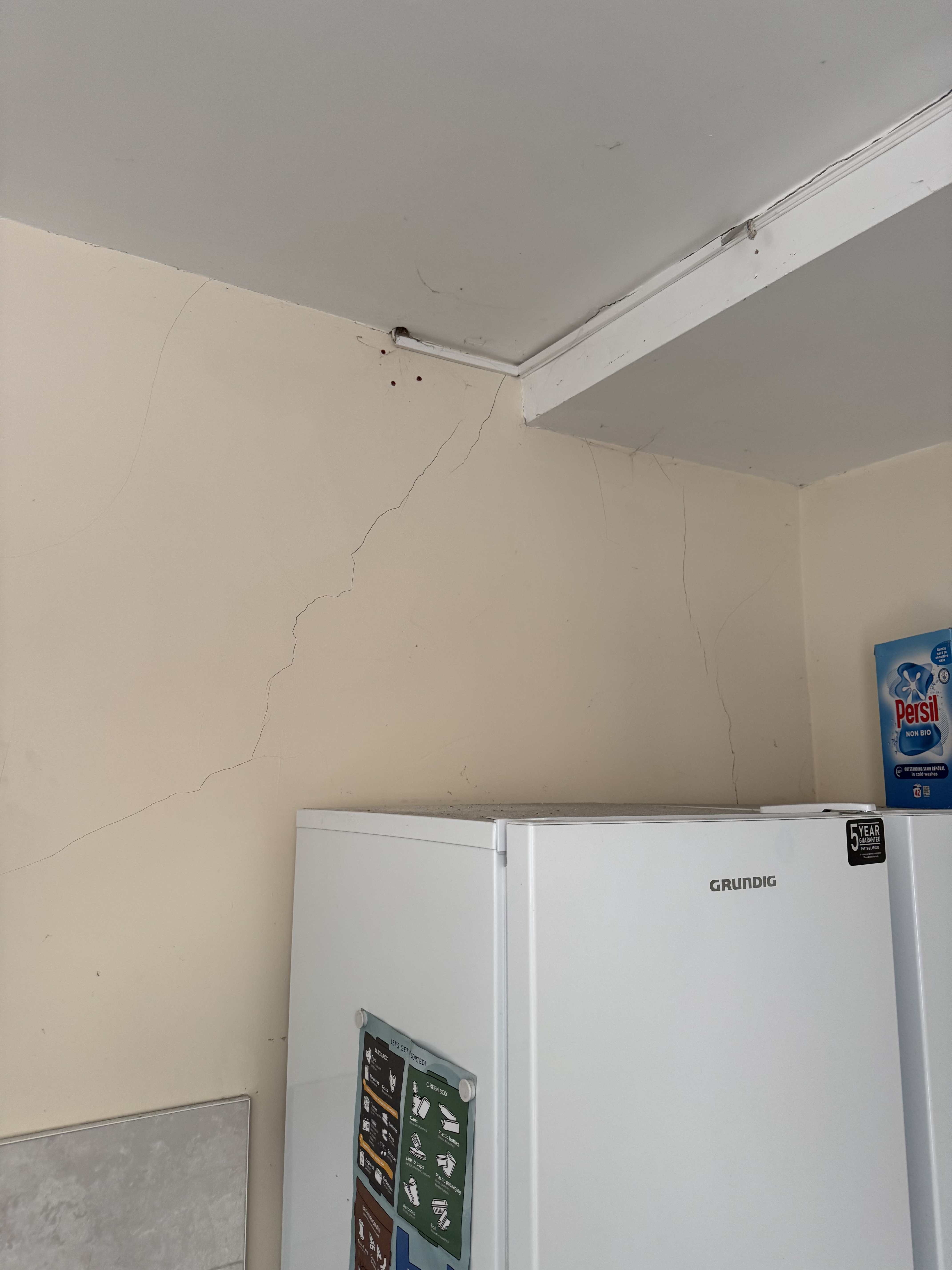

Cracked plaster ; leaking roof ?

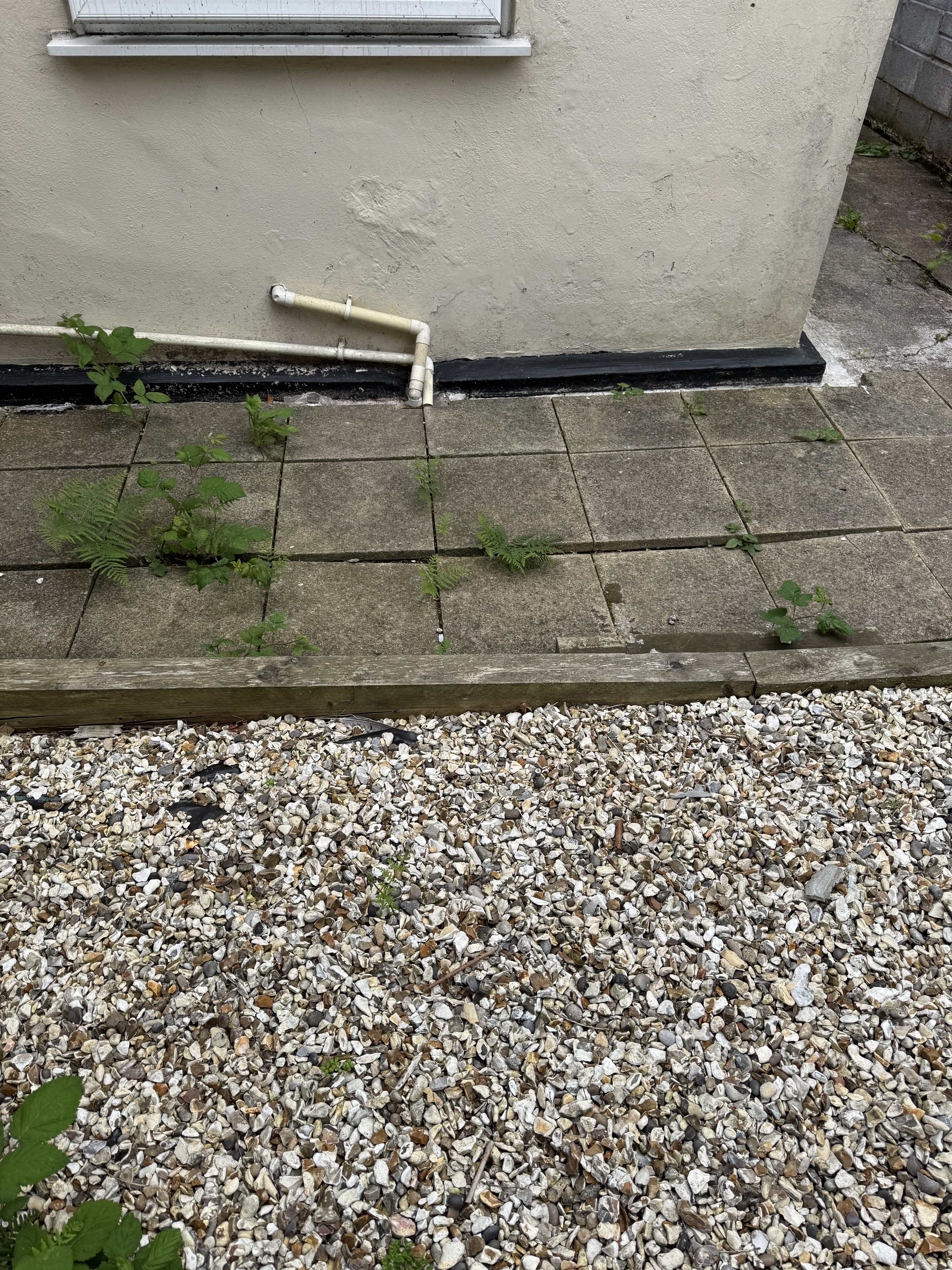

2 hours ago, Pocster said:
Kitchen sink waste and boiler overflow
Both go straight into the drain
Gut feeling, it's there the problem is..
The dropped slabs suggest there is something washing away underneath, if there's water degrading around the foundations at that point, even a slight drop would cause the gap to form 16 feet above. Effectively, the foundation joint between the house and extension is a pivot.

We inherited a house with similar symptoms and found that there were at least 6 others with exactly the same problem in the same row. (Broken foul drain scouring out the foundations leading to multiple diagonal cracks in the stair well - " broken back" )
Been up on the roof yet?
The surveyor taught me a simple trick about the cracks...
Insert a piece of card (paper or plastic) in the crack leaving enough of the card outside the crack such that the card is able to move with the fissure (but not fall out in a bit of wind). In other words create a telltale. Watch it. Or photograph it over the next few months. That will show you the rate of change. Helps you decide how urgent the issue is.

Was at the property today . Noticed some light cracking downstairs and indeed the pavers have dropped .
I forgot that a few months ago tenants blocked the drain with Wetwipes . Had raw sewage up from the house to over the pavers .
Guessing that could contribute to some movement

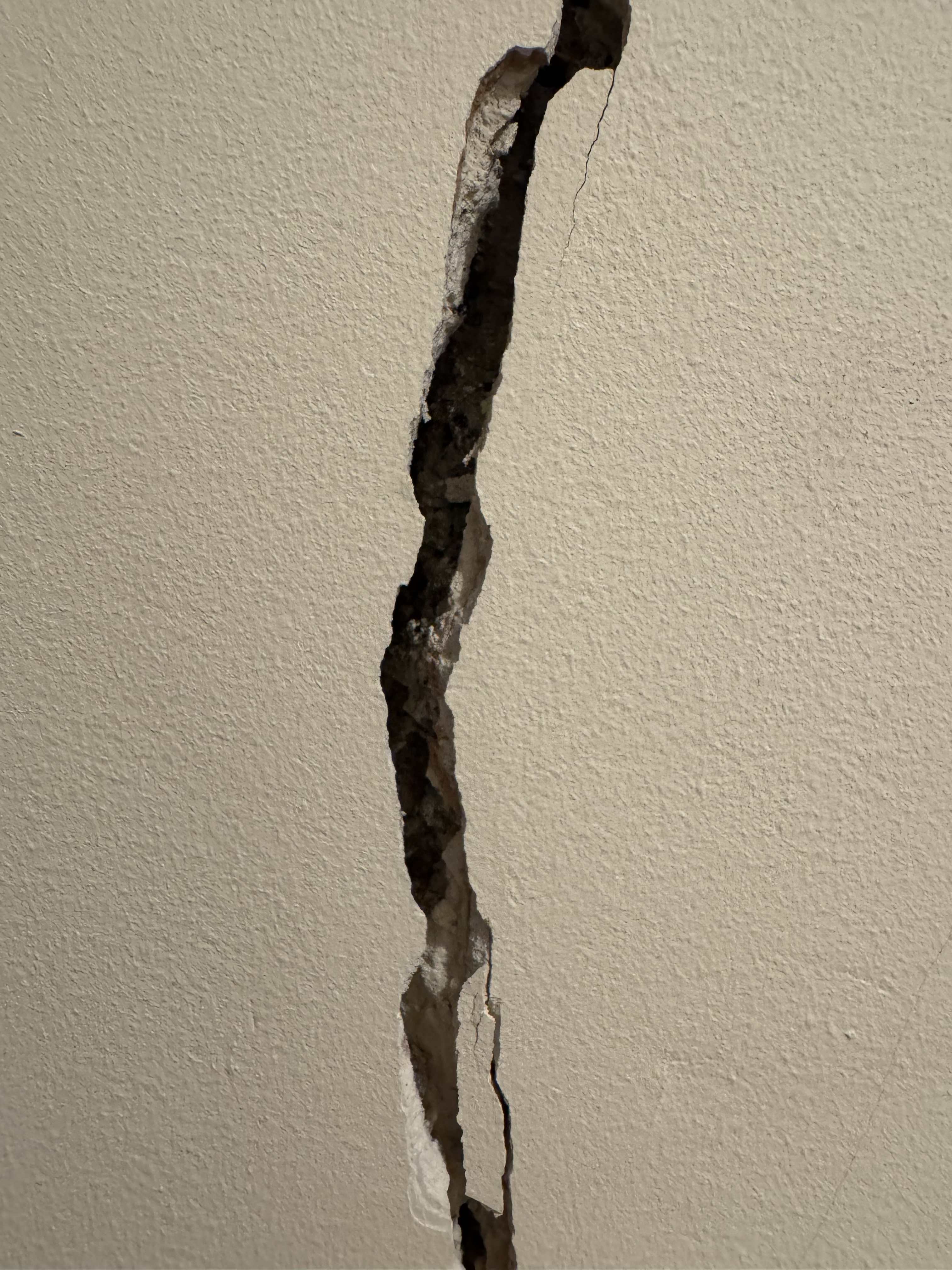

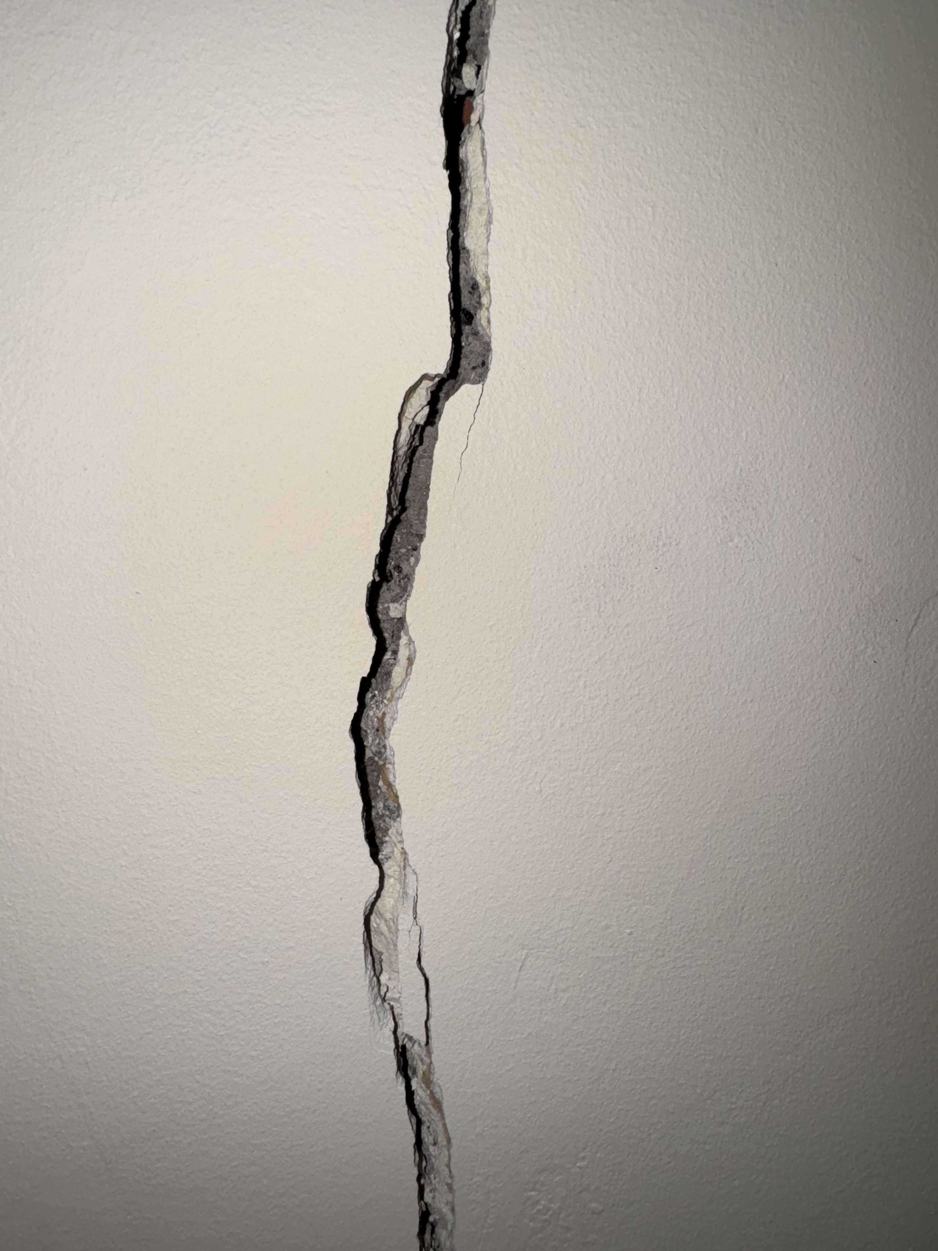

Right I've been informed this crack is worse. I'm going to look at it tomorrow. The roof leaks still there - roofer supposedly attending tomorrow to do that.
On the assumption this crack isn't just from the leak how do I approach the insurance company?. Do I approach them first?; what do I do?

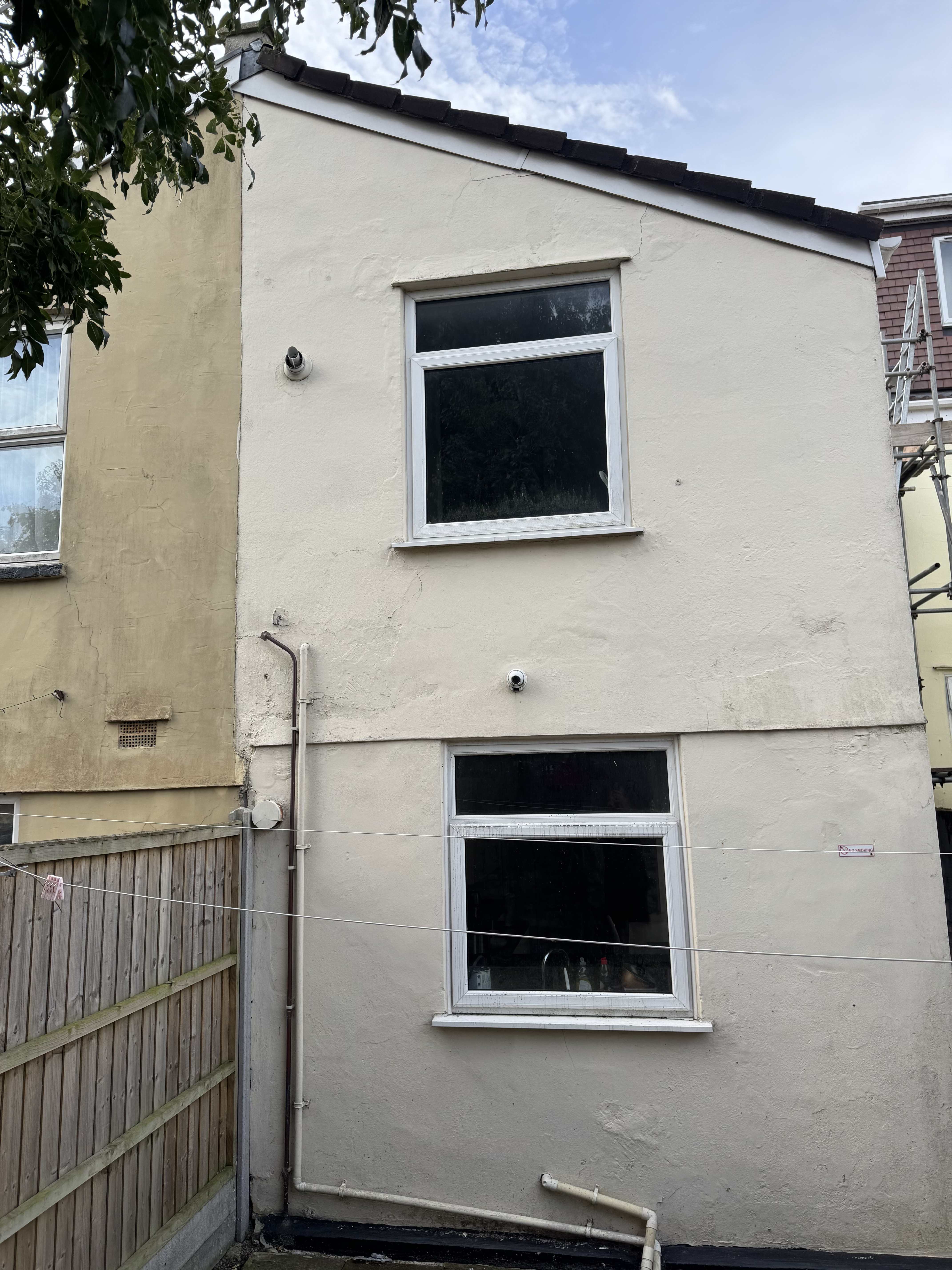

Any chance you could speak with the neighbours and see if they've been affected?
Looks like theirs is a mirror image of yours?
If your side is worse than theirs, it hints that the problem is on your side. If they've got the same problem, you might find that it's a bigger issue.
Could this be a bust water main eroding underneath?
Had another look
looks same too me . Can see red brick in some of the cracked plaster . Zero cracking outside which I find really strange if subsidence .
Got someone looking today who will go in eaves and maybe remove some of the plaster . I suspect the brickwork is solid ( fact I could see it and no obvious cracks in brickwork) - but requires investigation
