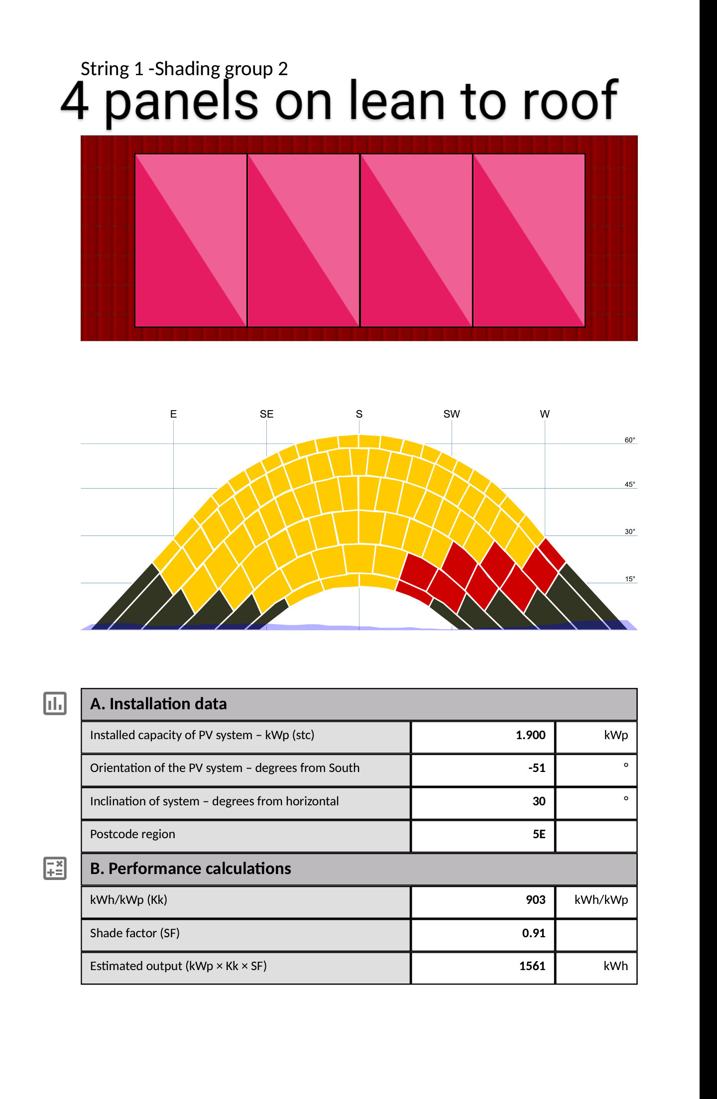

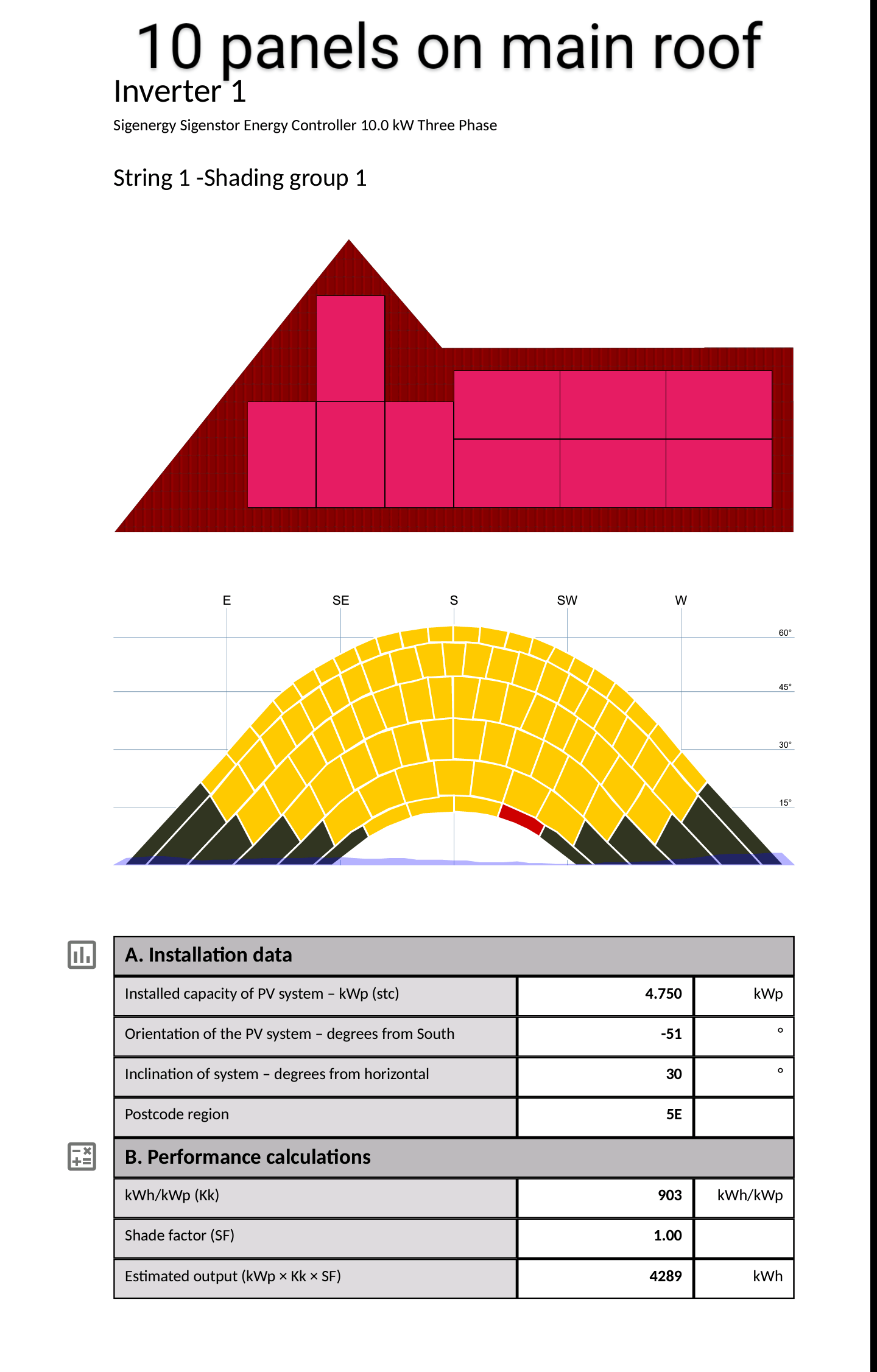

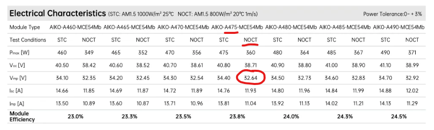

Ay8452 Posted July 30 Posted July 30 Hey folks Looking for some advice on proposals I've received for my solar setup particularly inverter sizing. Proposal: 14 X Aiko Neostar 3S 475W N-Type, Mono Glass All Black, Gen 3 Panels (good panels?) - 4 of the panels are on a separate roof to the other 10 and are heavily shaded in the late afternoon/evening. Sigenergy battery - thinking either 8kWh to 10kWh for now. Not sure if going bigger makes financial sense based on my estimated usage really? We have 3-phase supply and plan to have it well balanced (new electrics going in as part of renovation). Estimated use is 4-5,000 units (not moved in yet, we are still renovating) for a family of 2 adults and three young kids, not including future EV charging for a car doing 10k miles a year, plan to charge overnight via the Grid. For 3 phase Sig energy inverter sizing; I've had conflicting advice with some installers recommending a 6kw, 8 kw, 10 kw, and even a 15 kw. Based on my basic research 8 kw seems sensible? Questions: What inverter size would you recommend for this kind of setup considering it's 3 phase? Would 8kW be sufficient, or is it worth stretching to 10kW? For the 4 panels that are shaded, some have recommended optimisers whilst others have said not to as they go "wrong" over time - thoughts? Roof is SE facing pitched at 36 degrees. Appreciate your insights!
Bramco Posted July 30 Posted July 30 58 minutes ago, Ay8452 said: For 3 phase Sig energy inverter sizing; I've had conflicting advice with some installers recommending a 6kw, 8 kw, 10 kw, and even a 15 kw. Based on my basic research 8 kw seems sensible? Sizing the inverter depends on few things - what is the maximum PV output, what is the maximum draw from the house etc. Given you'll almost never get the maximum PV output and the estimated output is 6kW, you'd be OK with a 6kW inverter. On the house side, the biggest draw from appliances is about 3kW, so you could draw 6kW from the batteries without pulling anything from the grid. But if you want a fast EV charger, they would pull more but then it would depend on what the batteries can deliver. Don't know what Sigenergy can do but it will be on the spec. If you plan to do EV charging from off peak, at night, then this might not matter. Personally I'd put more battery capacity in rather than a larger inverter. If you are on O Go Int, then you can dump almost everything in the batteries in the evening at 15p before the cheap rate starts and then refill them at 7p. It's a bit of a no brainer. So the larger your batteries, the more you gain. Having said that, we are single phase, so I don't know how this would work with 3 phase. 1

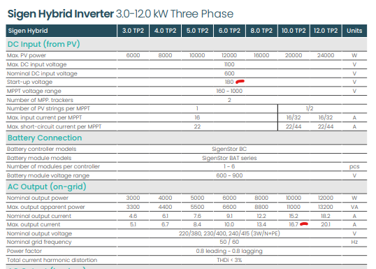

SimC Posted July 30 Posted July 30 There may be an issue with the 3-phase Sigenergy inverter combined with the 4 panel string, in that the MPPT startup voltage is stated at 180 Volts. In comparison the 1-phase inverters have MPPT startup at 50 Volts, but only size up to 6 kW. The Sigenergy datasheets and install guides provide no information on how the 3-phase unit reacts to unbalanced loads. If the inverter only outputs equal power on each phase when there is an unbalanced load, then the net result is that some phases will be importing from the grid and some will be exporting, rather than all 3-phases being grid neutral. It is not clear whether any specific 3-phase grid meter from a supplier operates with net metering calculations or not for billing purposes. With the 10kW 3-phase inverter, the max output current per phase is 16.7 Amps, which equates to just over 3.6 kW on each phase. If your loads draw more than this on a single phase, then the remainder will be imported from the grid. The Aiko NeoStar 3S 475 W panels will probably only produce around 30 V each in lower light conditions, which only produces 120 V when the 4 are connected in series. This string input is unlikely to start even in the brightest conditions, so is not worth installing with the proposed equipment. These observations may not provide a solution for you, but I hope they are helpful in what to look out for when choosing a new system. 1

Ay8452 Posted Tuesday at 21:00 Author Posted Tuesday at 21:00 On 30/07/2025 at 19:18, SimC said: There may be an issue with the 3-phase Sigenergy inverter combined with the 4 panel string, in that the MPPT startup voltage is stated at 180 Volts. In comparison the 1-phase inverters have MPPT startup at 50 Volts, but only size up to 6 kW. The Sigenergy datasheets and install guides provide no information on how the 3-phase unit reacts to unbalanced loads. If the inverter only outputs equal power on each phase when there is an unbalanced load, then the net result is that some phases will be importing from the grid and some will be exporting, rather than all 3-phases being grid neutral. It is not clear whether any specific 3-phase grid meter from a supplier operates with net metering calculations or not for billing purposes. With the 10kW 3-phase inverter, the max output current per phase is 16.7 Amps, which equates to just over 3.6 kW on each phase. If your loads draw more than this on a single phase, then the remainder will be imported from the grid. The Aiko NeoStar 3S 475 W panels will probably only produce around 30 V each in lower light conditions, which only produces 120 V when the 4 are connected in series. This string input is unlikely to start even in the brightest conditions, so is not worth installing with the proposed equipment. These observations may not provide a solution for you, but I hope they are helpful in what to look out for when choosing a new system. Thank you for your reply. If ALL the panels were on the same string fitted with optimisers for each panel then it "should" negate the issue with the start up voltage right? This is what my installer is suggesting

Kelvin Posted Wednesday at 08:10 Posted Wednesday at 08:10 3 phase just seems to over complicate everything especially when you add in PV. I’d do as above and run everything on a single phase and a future EV on another phase. Why run all the panels on a single string even with optimisers. Run each roof on its own string and using optimisers for the shaded roof. Although if it’s heavily shaded wouldn’t micro-inverters be better? My west facing roof gets a tiny bit of shading for around 40 minutes very late in day. It’s not enough to impact the output very much so I didn’t bother with optimisers. It will be worse in the winter of course but I plan on adding a third string on the ground in front of the garage as it’s unused and I could get 5/6 panels there.
