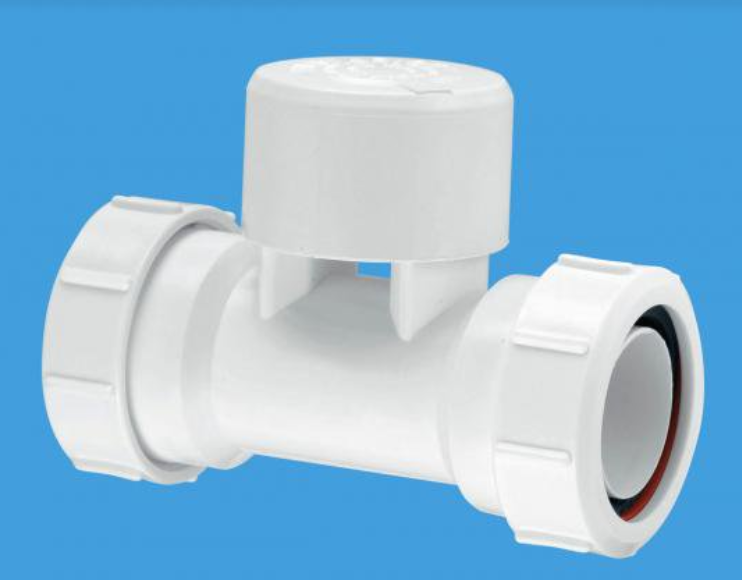

PeterW Posted December 31, 2017 Share Posted December 31, 2017 Worth fitting these on every basin and then you have no issues at all with syphoning when the toilets flush. McAlpine Waste Link to comment Share on other sites More sharing options...
willbish Posted December 31, 2017 Share Posted December 31, 2017 15 minutes ago, Temp said: Normally you have several stacks on each run to the main sewer. Most BCO will want the furthest stack to be open vented but the rest can have AAV. Great, so I think my plan conforms. 8 minutes ago, PeterW said: Worth fitting these on every basin and then you have no issues at all with syphoning when the toilets flush. McAlpine Waste Yep as I thought, thanks Link to comment Share on other sites More sharing options...
