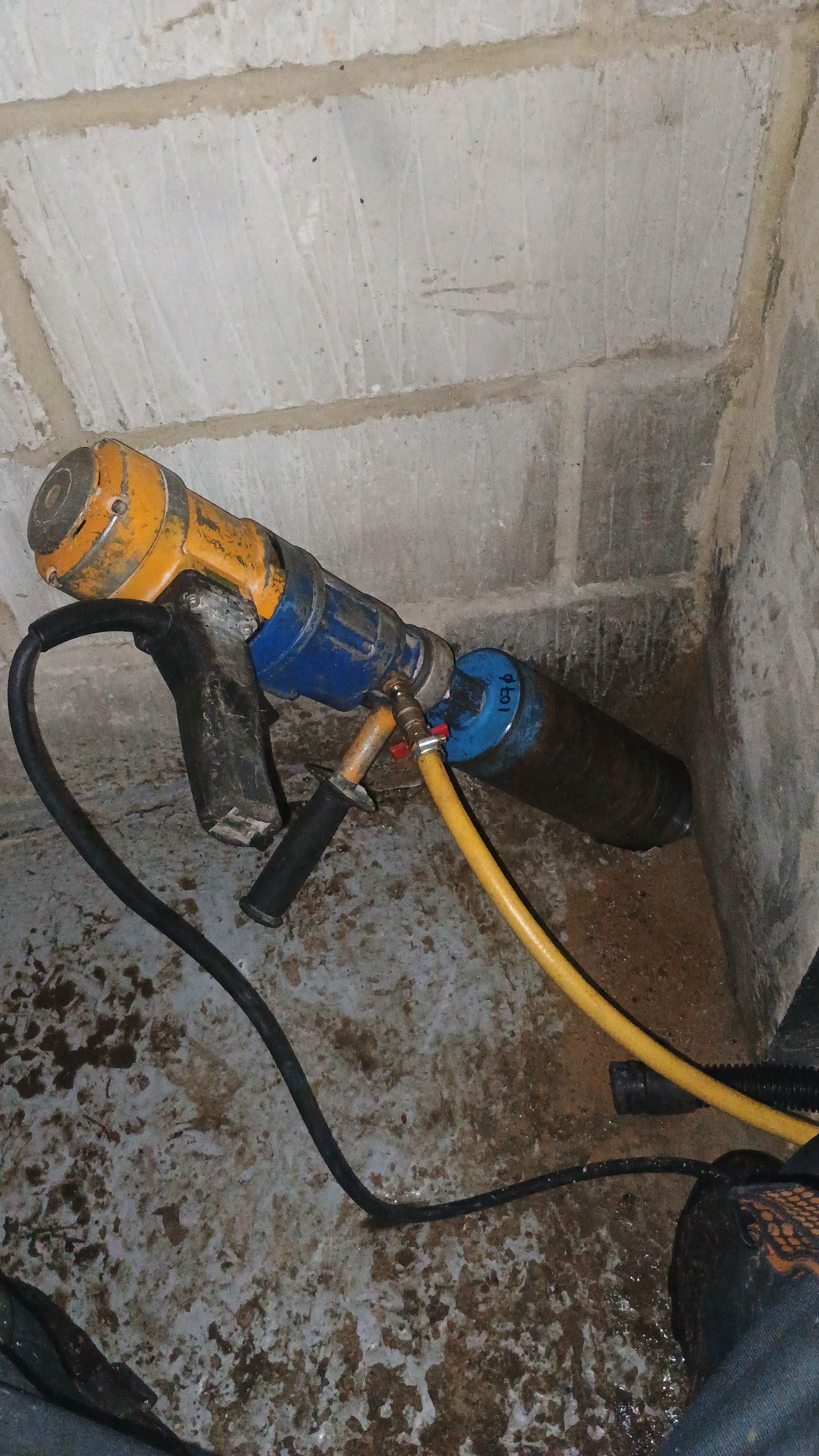

Good luck. Even with the right kit diamond core drilling can be hard work. Trying to go through my garage foundations and this bad boy packed up:
Still got a way to go 🙁

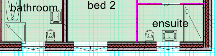

We were wondering about about floor level, but weren't sure how that would work with shower drain.

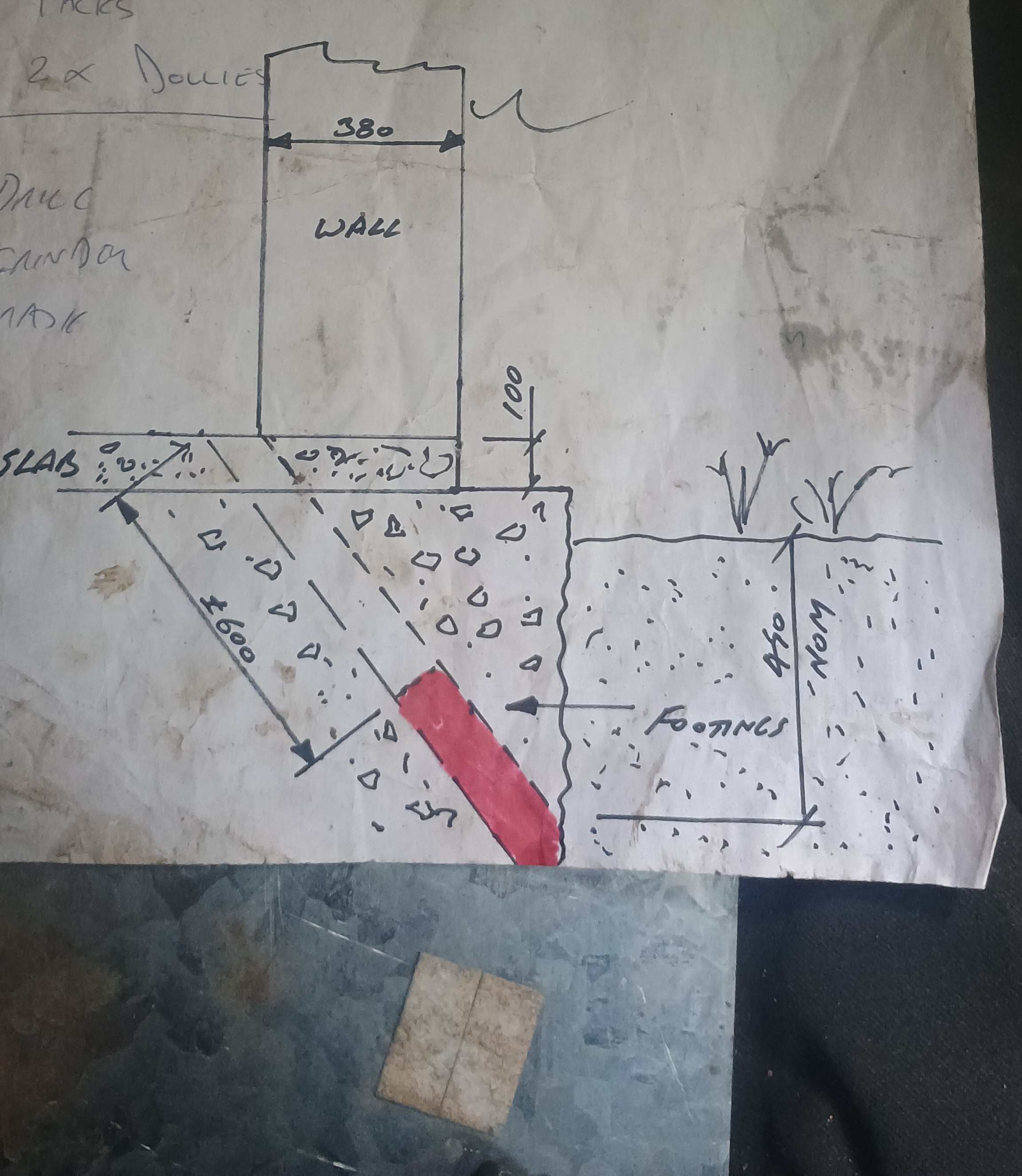

This is the layout for the 2 bathrooms.
It is agricultural concrete, which we have broken lots of, but that didn't matter when it cracked.  We need these foundations to stay sound

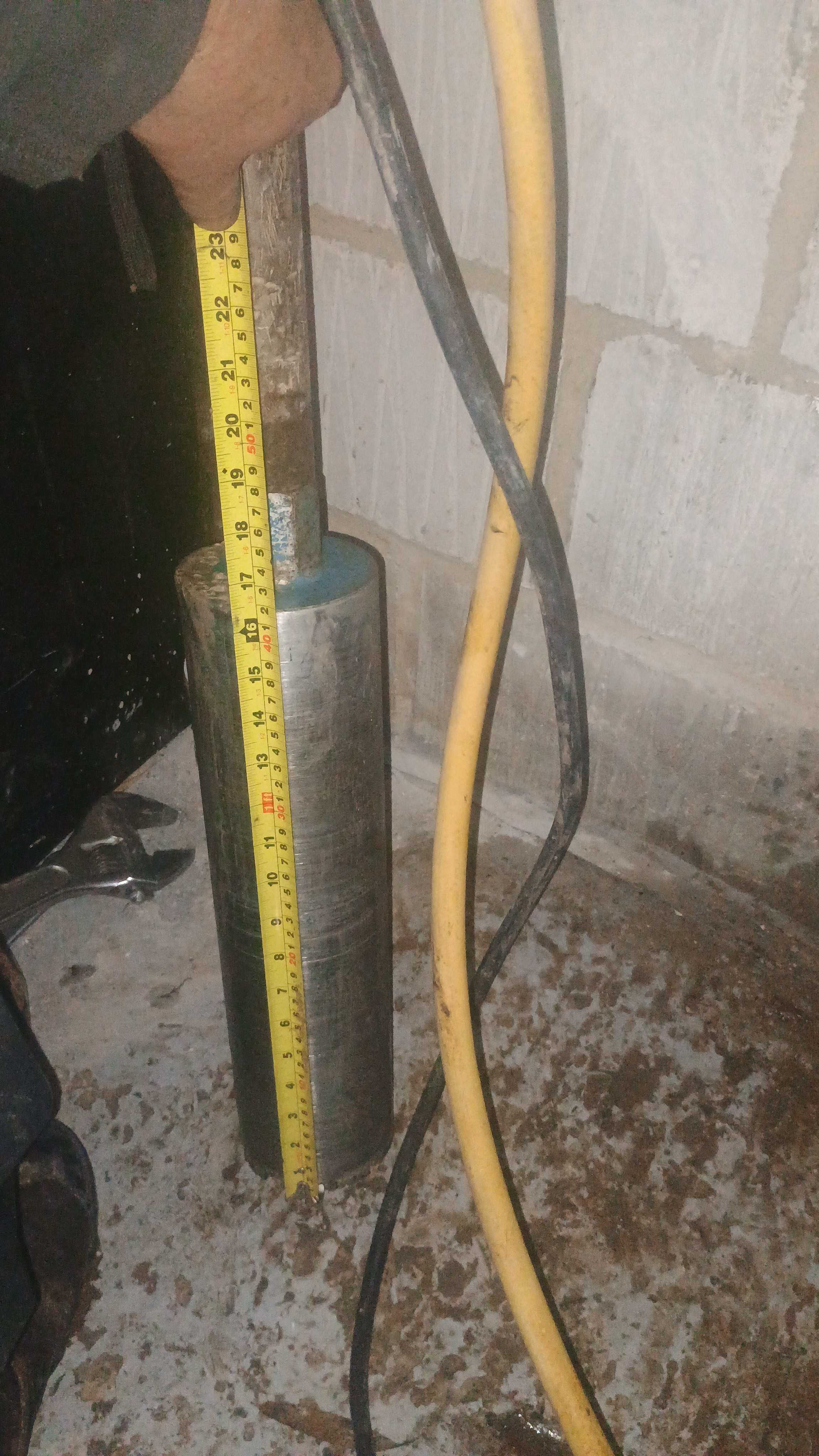

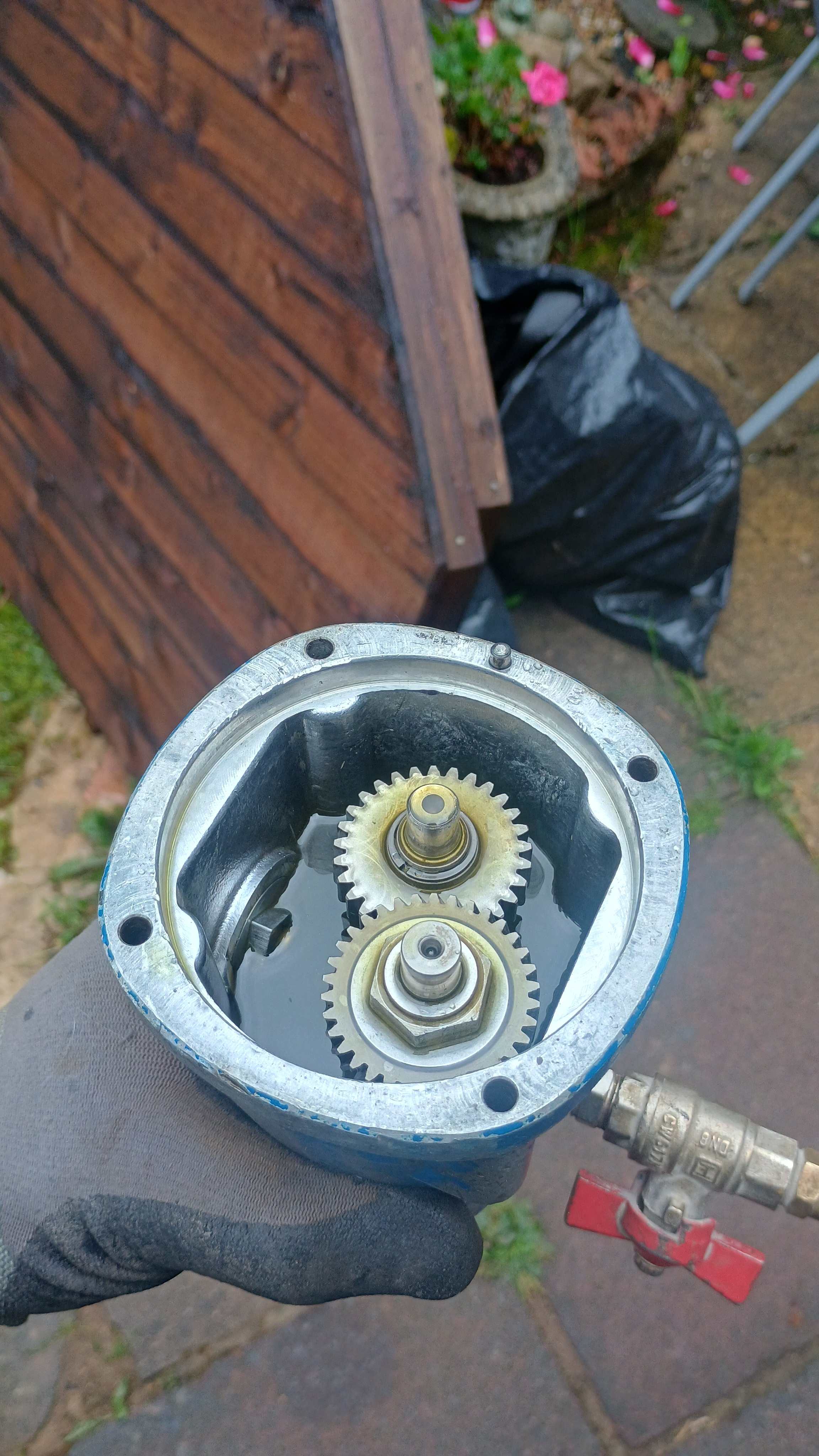

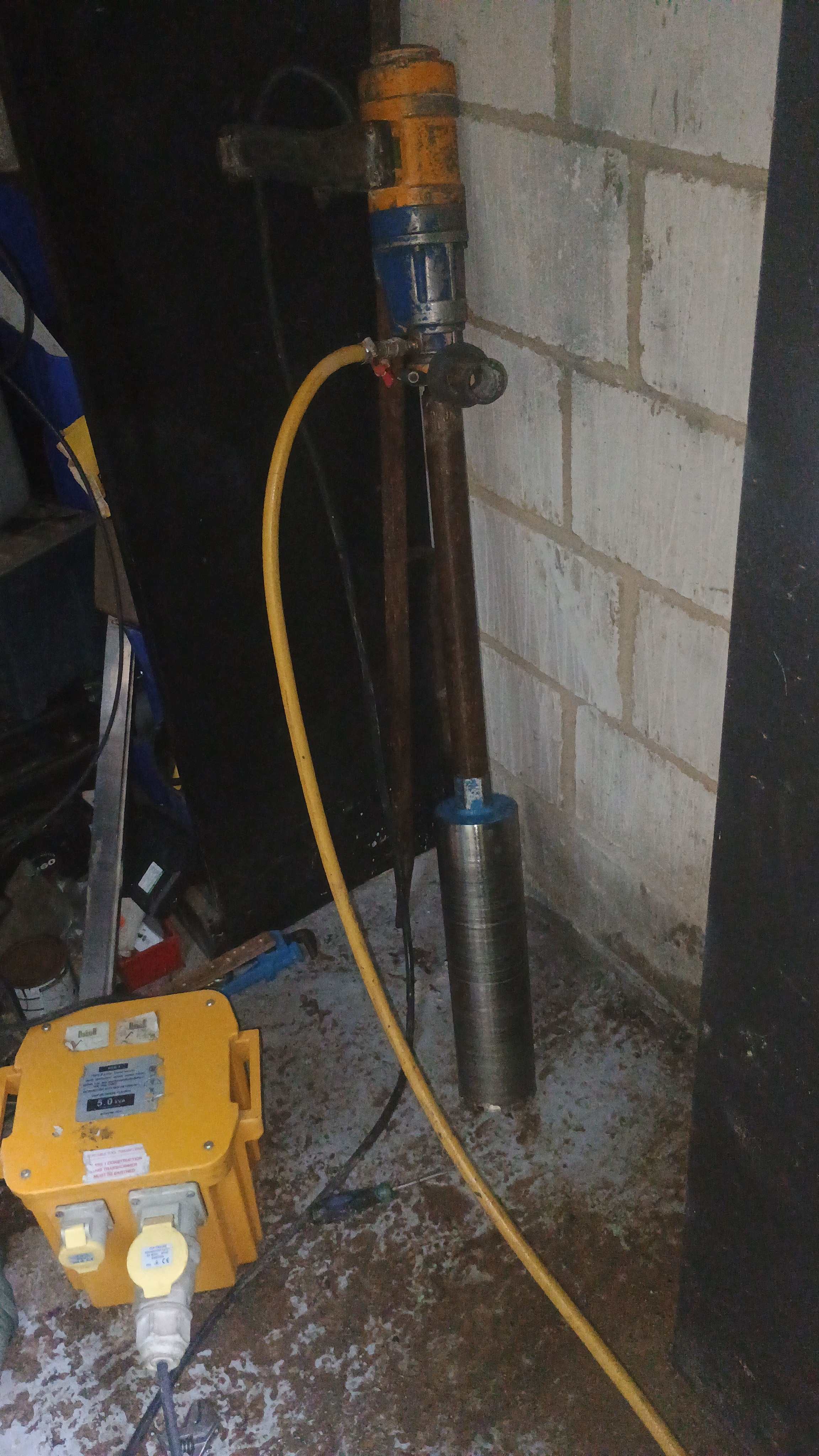

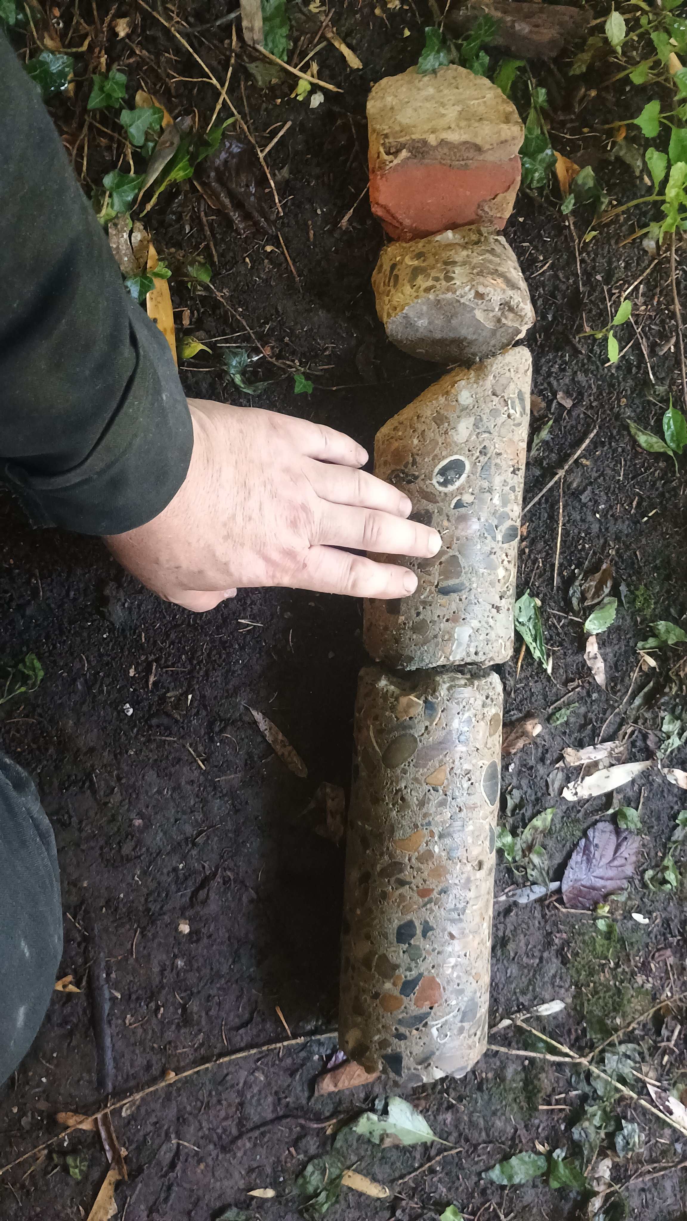

As of today I'm roughly this far through mine with a 107mm core cutter. This is proper kit from a demo contractor mate.
En route I've had to have the drill apart and tighten the clutch where it was slipping.
Drilling the first 16" was not easy but I got there. Then on the next section it's very  easy to go very slightly off true. The angled interfaces then make it stick a bit.
Tbh I think the clutch was actually OK and it's slipping a protective thing. Now, using it, it's one slip up from A&E:
In case anyone was wondering:
