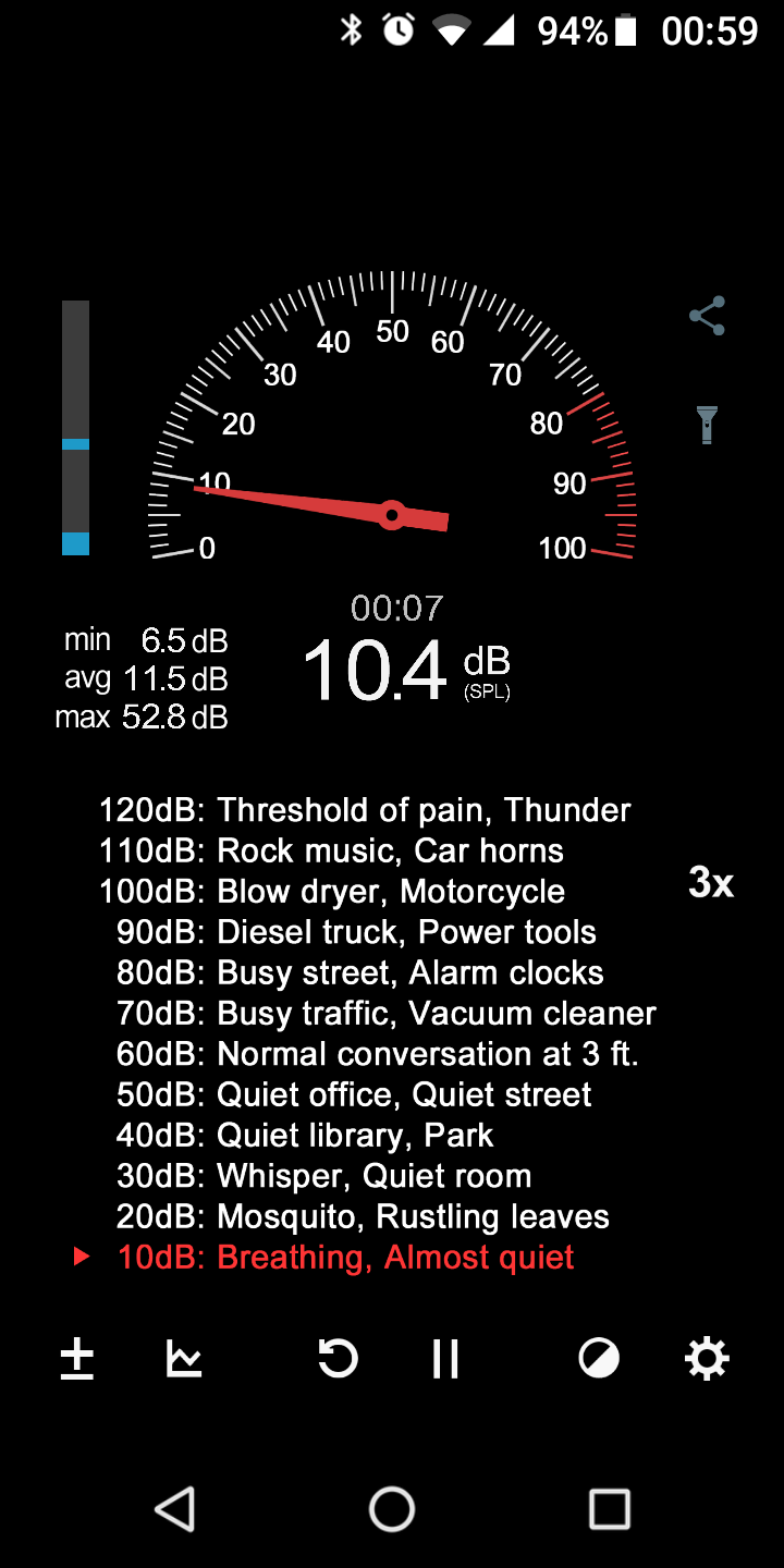

SteamyTea Posted June 28 Posted June 28 I made up my own secondary glazing to cover up my old double glazed windows. The noise reduction was quite amazing. Very rarely does it go above 20 dB now, and I am not far from a busy road. This is what I am hearing at the moment and it is quite breezy outside. 1 1
