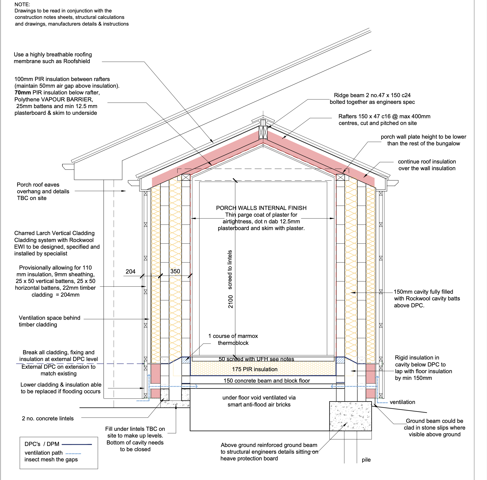

boxrick Posted June 26, 2025 Posted June 26, 2025 So in summary... I am renovating my house. My Architect specified that below DPC rigid closed cell insulation to be used. Above DPC we were using full fill and in this case we have specifically used https://www.superglass.co.uk/products/superwall-32-cavity-wall-batt/ For context we were flooded at the start of the year. I was looking at the cavity of my new porch ( this is the last thing to be built ) and its clear its just full fill with the same material above and below. So now I am worried about this and would like some advice about how much you guys believe it matters, should I be insisting this is rectified ( given that my entire extension has now been built.
Redbeard Posted June 26, 2025 Posted June 26, 2025 If the specification of closed-cell material (XPS, I kind of hope, but OTOH it floats well) was specifically related to knowledge of the flood incident(s?) then it arguably matters a lot. If the builder had the specification it is also arguably their problem. If you expect (at least the possibility of) flooding again then yes, the use of a material which sucks is an issue.
boxrick Posted June 26, 2025 Author Posted June 26, 2025 (edited) Hey I appreciate the reply! Just to confirm the specification for closed cell insulation below DPC was definitely due to previous flooding, it has been written in the architect notes because we were flooded earlier this year. There is an entire section on flooding. The superwall 32 has been used instead both above and below DPC, despite the instructions. Given this how serious an issue am I facing if I leave it as is? Should I be pushing the builder to put it right even though the extension is finished, this will be a major piece of work? Does anyone have experience of getting this sort of thing rectified? Any advice on the best way to handle it would be much appreciated. For extra context I plan to apply a tanking / heavy waterproofing slurry externally when works are complete. Edited June 26, 2025 by boxrick

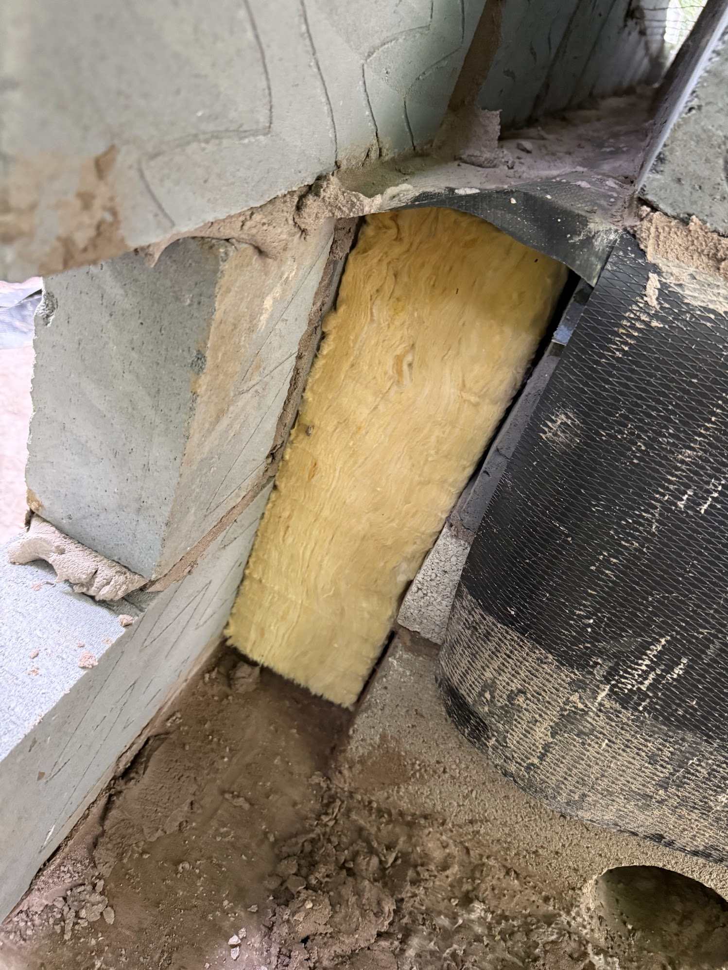

boxrick Posted June 26, 2025 Author Posted June 26, 2025 1 minute ago, kandgmitchell said: Is that a dpc laid flat across the cavity? Yes thats the DPC
Redbeard Posted June 26, 2025 Posted June 26, 2025 26 minutes ago, boxrick said: Given this how serious an issue am I facing if I leave it as is? You have already answered your own question. XPS (I assume) was spec'd so that it would not become a wet sponge if flooding happened again. It has not been used. A dry sponge has, and a dry sponge will get wet in a flood. Obviously tricky as you say most of it is completed, but you did not fail to follow the spec.
kandgmitchell Posted June 26, 2025 Posted June 26, 2025 1 minute ago, boxrick said: Yes thats the DPC So it's a tray dpc then where the inner leaf level is higher than the outer leaf level so as to direct any water ingress to the cavity out to the external leaf (and thence via weepholes). It's just that in the photo the dpc looks flat across the cavity rather than sloping as per the drawn detail - although even that doesn't have the 150mm min drop from the inner leaf dpc to the tray as per Approved Document C diagram 9(b).
boxrick Posted June 26, 2025 Author Posted June 26, 2025 22 minutes ago, kandgmitchell said: So it's a tray dpc then where the inner leaf level is higher than the outer leaf level so as to direct any water ingress to the cavity out to the external leaf (and thence via weepholes). It's just that in the photo the dpc looks flat across the cavity rather than sloping as per the drawn detail - although even that doesn't have the 150mm min drop from the inner leaf dpc to the tray as per Approved Document C diagram 9(b). Can you clarify? Here are a couple of pictures from about a month ago when the cavity was exposed as it was built up. It looks like there was a slope towards to external wall.

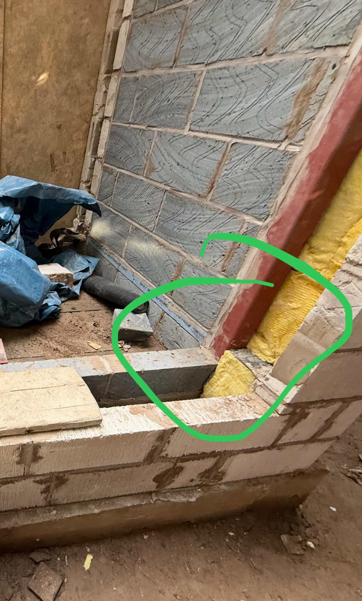

kandgmitchell Posted June 27, 2025 Posted June 27, 2025 17 hours ago, boxrick said: Can you clarify? Here are a couple of pictures from about a month ago when the cavity was exposed as it was built up. It looks like there was a slope towards to external wall. I'm not trying to add to your woes but take yourself on line to the Planning Portal and look up Approved Document C and go to page 30 and look at Diagram 9(b), does your arrangement look like that? A tray should have a significant slope outwards to prevent water reaching the inner leaf. It should definately have weepholes otherwise water can't drain away. 1
torre Posted June 27, 2025 Posted June 27, 2025 I'd echo @kandgmitchell's point. You either have a tray with significant slope plus weep holes, or separate DPMs on inner and outer leaf. None of this is easy to correct retrospectively. I've seen similar insulation float around quite happily for weeks but it's not designed for total immersion and is bound to hold a lot of moisture afterwards for considerable time and I'd also be concerned it will slump down to the bottom of the cavity after flooding and leave a cold bridge between it and the batts above.

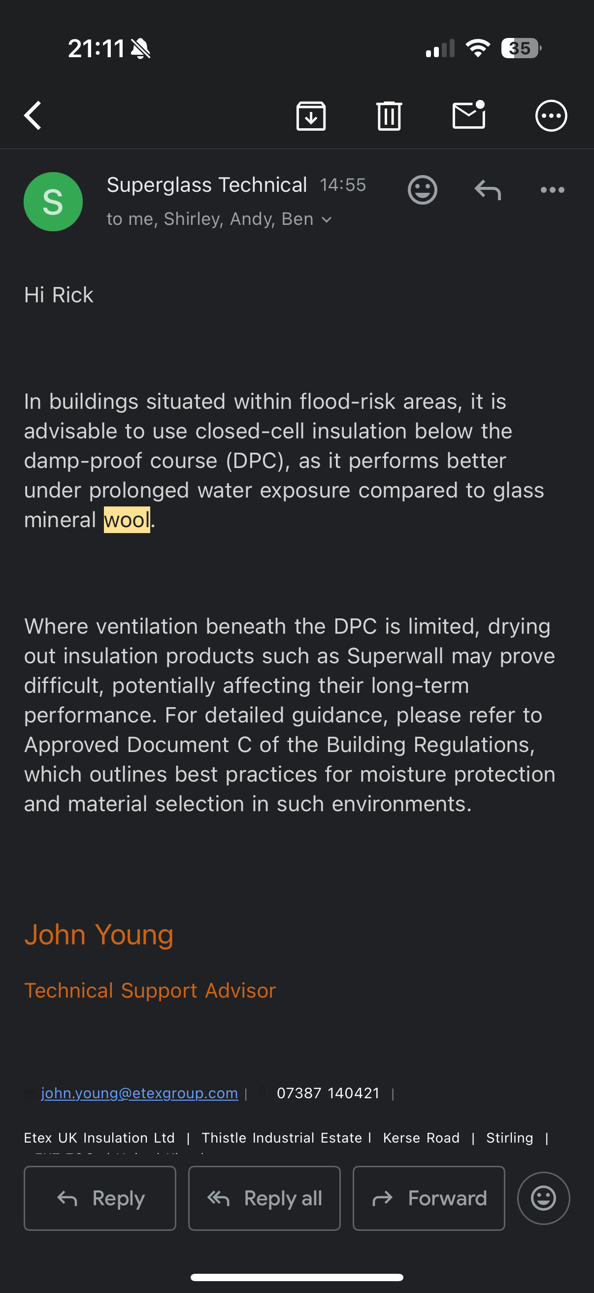

boxrick Posted July 1, 2025 Author Posted July 1, 2025 A very generic reply from the manufacturer technical team... whoop
Roundtuit Posted July 1, 2025 Posted July 1, 2025 I guess they can only really do generic, but the conclusion looks fairly definitive to me I'm afraid: it's ill-advised.
