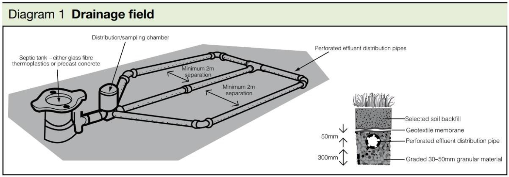

flanagaj Posted Sunday at 14:52 Posted Sunday at 14:52 So I am reading a lot of conflicting information regarding whether a STP needs a drainage field. If I am correct drainage fields are historically used for septic tanks, but if you read section 5.3 of NHBC-Standards-2025-Chapter-5-3-Drainage-below-ground.pdf you see that they mention discharging to a soakaway. Interestingly, they make no mention of a the percolation test draining away too quickly (like one of our trial holes). So what is the actual requirements for discharging from a STP if you cannot discharge to a water course? Ideally, I'd like to be able to use soakaway crates or the Graf infiltration tunnels. Our site is quite tight and excavating and installing a conventional drainage field will be tricky.

IanR Posted Sunday at 17:44 Posted Sunday at 17:44 (edited) 2 hours ago, flanagaj said: So what is the actual requirements for discharging from a STP if you cannot discharge to a water course? If your site is in England you must meet the General Binding Rules, otherwise you require a permit from the Environmental Agency. The GBR is the far easier route. For a new discharge you can not use a soakaway, for discharges to ground it must be via a drainage field. Both STP and Drainage filed must be in line with the relevant British Standard. See Rule 9 for the specifics Quote Rule 9: make sure your treatment system meets the right British Standard Your system must meet the relevant British Standard that was in place at the time it was installed. If different parts of your treatment system were installed at different times, each part must meet the relevant British Standard in place at the time of installation. The current standards for new systems are: BS EN 12566 for septic tanks and small sewage treatment plants BS 6297:2007 for drainage fields Ref. https://www.gov.uk/guidance/general-binding-rules-small-sewage-discharge-to-the-ground Lots of rules, make sure you meet all of them. Under the GBR you can discharge to a Water Course in some circumstances, so when you say "cannot discharge to a water course" I assume you mean you do not have access to a suitable water course. Edited Sunday at 17:44 by IanR 1
flanagaj Posted Sunday at 18:57 Author Posted Sunday at 18:57 1 hour ago, IanR said: If your site is in England you must meet the General Binding Rules, otherwise you require a permit from the Environmental Agency. The GBR is the far easier route. For a new discharge you can not use a soakaway, for discharges to ground it must be via a drainage field. Both STP and Drainage filed must be in line with the relevant British Standard. See Rule 9 for the specifics Ref. https://www.gov.uk/guidance/general-binding-rules-small-sewage-discharge-to-the-ground Lots of rules, make sure you meet all of them. Under the GBR you can discharge to a Water Course in some circumstances, so when you say "cannot discharge to a water course" I assume you mean you do not have access to a suitable water course. Correct. There are no water courses within the vicinity of the tank. Hence, discharging to ground.
saveasteading Posted Sunday at 19:31 Posted Sunday at 19:31 Ok so I'm getting mixed up by the terminology now. Drainage field in the English regs is just french drains. So use French drains but call it a drainage field. They call it a drainage field for the small amount of liquid from an stp, but soakaways if it is rainwater. What I say still applies.
IanR Posted Sunday at 19:43 Posted Sunday at 19:43 (edited) 50 minutes ago, flanagaj said: Correct. There are no water courses within the vicinity of the tank. Hence, discharging to ground. Then to meet the General Bing Rules you'll need a Drainage Field that meets BS 6297:2007 I'm not sure if that document is available free of Charge, but if you ask Gemini, it gives you a good idea of what is required: Quote Designing a drainage field for a small treatment plant that meets BS 6297:2007 requires a systematic approach, starting with site assessment and ending with detailed construction. Here's a comprehensive guide: Key Principles from BS 6297:2007 for Drainage Fields Further Treatment: The drainage field provides additional biological treatment of the effluent from the treatment plant as it infiltrates the soil. This requires an aerobic environment, which means the pipes should be laid at a relatively shallow depth. Controlled Infiltration: The ground must be permeable enough to allow the effluent to seep away but not so permeable that it drains too quickly, leading to insufficient treatment or pollution of groundwater. Protection of Water Sources: The drainage field must be sited safely away from buildings, watercourses, and water abstraction points (wells, boreholes). Site Suitability: Not all sites are suitable for a drainage field. A thorough site investigation, including percolation tests and a trial site assessment hole (TSAH), is essential. Steps to Design a Drainage Field 1. Preliminary Planning and Site Investigation Identify Suitable Location: Distance from Buildings: A minimum of 15m from any habitable building. Distance from Watercourses: A minimum of 10m from any watercourse or ditch. Distance from Water Abstraction Points: A minimum of 50m from any water supply abstraction point (e.g., well, borehole). Groundwater Protection Zones: Ensure the site is not within a Groundwater Source Protection Zone 1. Underground Services: Keep the area clear of any underground services or water supply pipes. Access Roads/Paved Areas: No access roads, driveways, or paved areas should be within the disposal area. Topography: The field should generally be downslope of any groundwater source. Avoid floodplains. Trial Site Assessment Hole (TSAH): Excavate a hole at least 1m square and 2m deep, or a minimum of 1.5m below the proposed drainage field pipework. The primary purpose is to determine the position of the seasonally highest groundwater table. The groundwater table must never rise to within 1.2m of the bottom of the drainage field pipework (i.e., if your pipes are at 700mm deep, the water table needs to be at least 1.9m deep). Look for "mottles" (brown/grey discoloration) in the soil, which indicate seasonal waterlogging. Leave the hole open for at least 48 hours to observe any rise in the water table. If the water table is too high, the site is unsuitable. Percolation Test (Vp Test): Purpose: To determine the soil's permeability (how quickly water drains away). Procedure (as per BS 6297:2007): Excavate Holes: Dig at least two holes, 300mm square, to a depth at least 300mm below the proposed invert level (bottom of the infiltration pipe) of the drainage pipes. Space them along the proposed line of the system. Note and record changes in soil characteristics at measured depths. Saturate the Soil: Fill each hole with water to a depth of at least 300mm and allow it to seep away completely. Repeat Saturation: If water drains rapidly (within 10 minutes), refill the hole up to a maximum of 10 times to ensure saturation. If it continues to drain rapidly, the ground may be unsuitable. Unsuitable Ground: If the water has not soaked away within 6 hours, the area is not suitable. Measure Percolation Rate: Refill each hole with water to a depth of at least 300mm. Observe and record the time in seconds for the water to seep away from 75% full (225mm depth) to 25% full (75mm depth) – a drop of 150mm. Calculate Vp: Divide this time (in seconds) by 150 (mm). This gives the average time in seconds for the water to drop 1mm. Repeat Tests: Repeat the test at least three times in each hole. Average Vp: Calculate the average Vp value by summing all the test results and dividing by the number of tests. Acceptable Vp Range: Drainage field disposal is only suitable if the average Vp value is between 15 and 100 seconds/mm. Vp < 15: Water drains too quickly, insufficient treatment, risk of groundwater pollution. Vp > 100: Water drains too slowly, leading to ponding and system failure. Further Tests: If Vp results vary widely (more than 50% above or below the average), conduct more tests in different locations. 2. Detailed System Design Calculate Required Drainage Field Area (A): For a package wastewater treatment plant (which provides additional treatment compared to a septic tank), the formula is: A=p×Vp×0.20 Where: A = required drainage field floor area in square metres (m2) p = number of people served by the treatment plant (for domestic properties, this should be the maximum number of people that could live in the house). Consult BS EN 12566 for population equivalent guidelines if unsure. For a typical small domestic plant, this might be based on the number of bedrooms (e.g., 5 persons for a 3-bedroom house, plus 1 for each additional bedroom). Vp = average percolation value (in seconds/mm) obtained from the percolation test. Trench Dimensions and Layout: Trench Width: Between 300mm and 900mm wide. Pipe Depth: Perforated pipes should be laid at a minimum depth of 200mm and a maximum depth of 700-800mm to ensure aerobic contact with the soil. Pipe Type: Use 110mm downward-facing perforated pipes. "Flexicoil" type land drainage pipe is NOT allowed. Gradient: Lay pipes with a uniform gradient, not steeper than 1:200. Gravel/Granular Fill: Pipes should be laid on a 200-300mm layer of clean gravel or granular fill material (graded 16-32mm or 20-50mm). Geotextile Membrane: Trenches should be filled to a level 50mm above the pipe and then covered with a layer of geotextile membrane to prevent silt entry. The remainder can be backfilled with topsoil. Undisturbed Ground: Maintain a minimum of 1m wide strips of undisturbed ground between parallel trenches. Maximum Trench Length: The length of a single trench should not exceed 30m. Inspection Chamber: An inspection/distribution chamber should be installed between the treatment plant and the drainage field to distribute effluent evenly to the trenches and for monitoring. Loop System: The drainage field should ideally be set out in a continuous loop fed from an inspection chamber. Venting: Upstream ends of distribution pipes may be extended vertically above ground level and capped with a cowl or grille for venting. Example Calculation (Illustrative) Let's assume: Small treatment plant serving a 4-bedroom house: p=6 persons (typical for a 4-bed house, 5 for 3-bed +1 per extra bed) Average Percolation Value (Vp) : 30 seconds/mm (within the acceptable range of 15-100) Calculate Area (A): A=p×Vp×0.20 A=6×30×0.20 A=36 m2 Determine Trench Length: If you decide on a trench width of, say, 0.6m (600mm): Total Length of Trenches = A/Trench Width Total Length of Trenches = 36 m2/0.6 m=60 m You would then design a layout of parallel trenches, each no longer than 30m, to achieve a total length of 60m. For example, two trenches each 30m long, with 1m of undisturbed ground between them. Important Considerations and Next Steps Professional Advice: It is highly recommended to engage a qualified wastewater engineer or a British Water Wastewater Accredited Service Technician for site assessment, percolation testing, and detailed design. They can ensure full compliance with BS 6297:2007 and local regulations. Building Regulations: The installation must comply with Part H of the Building Regulations 2010 (Drainage and waste disposal) and be signed off by a building inspector. General Binding Rules: Ensure compliance with the General Binding Rules for small sewage discharges to the ground in your specific UK nation (England, Scotland, Wales, Northern Ireland), as these may have additional requirements or nuances. Maintenance: A drainage field requires proper maintenance of the treatment plant to ensure the quality of effluent entering the field, which prolongs its lifespan. An inspection chamber before the drainage field allows for monitoring. Record Keeping: Keep all test results and design documents for regulatory purposes and future reference. By following these guidelines and engaging appropriate professionals, you can design a drainage field that effectively treats wastewater and complies with BS 6297:2007. Edited to add what looks like a good reference to clear up any confusion on what a Drainage Field is: https://www.homeseptic.co.uk/drainage-field-size-calculation-and-design/ Edited Sunday at 19:49 by IanR
flanagaj Posted Sunday at 19:49 Author Posted Sunday at 19:49 4 minutes ago, IanR said: Then to meet the General Bing Rules you'll need a Drainage Field that meets BS 6297:2007 I'm not sure if that document is available free of Charge, but if you ask Gemini, it gives you a good idea of what is required: This is where it gets confusing. My understanding is that a sewage treatment plant does primary and secondary treatment. That therefore negates the requirement for the aerobic treatment provided by the soil.
IanR Posted Sunday at 19:54 Posted Sunday at 19:54 2 minutes ago, flanagaj said: That therefore negates the requirement for the aerobic treatment provided by the soil. That's a misunderstanding. While the discharge has low toxicity, if it is allowed to build up it can get to a hazardous level, so the GBR's require their discharge to be controlled either into a drainage field or a water course. 1
flanagaj Posted Monday at 05:50 Author Posted Monday at 05:50 10 hours ago, IanR said: https://www.homeseptic.co.uk/drainage-field-size-calculation-and-design/ This link was very helpful and clearly details my question regarding drainage fields / infiltration tunnels for a STP. "Currently, written legislation has fallen behind the technology available, notably in Sewage Treatment Plants. Sewage Treatment Plants produce near clean water, thus the need for secondary treatment is redundant. A Septic Tank with a Drainage field is nearly always cheaper than a Sewage Treatment Plant with a Drainage Field. Written legislation allows you to build a slightly smaller drainage field but the impact is minimal. Essentially a rational economic person would not install a Sewage Treatment Plant with a discharge to ground and a Drainage Field. While explicit written standards have not caught up, building control and local authorities have. With consent, it is possible to install a series of Infiltration tunnels to discharge the treated effluent from a Sewage Treatment Plant. Again there are calculations to perform based on porosity etc to ensure an element of secondary treatment and adequate dispersal. A Sewage Treatment plant with an infiltration system is generally cheaper than a Septic Tank with Drainage Field. Further, an infiltration system can be installed in a far smaller area increasing flexibility and applicability. For instance, the majority of Septic Tanks currently do not have a Drainage field that meets the general binding rules. The Environment Agency is unlikely to check on your Drainage Field. However, when you come to sell your house or replace a failed Soakaway a Drainage Field will need to be installed. Drainage fields cover a large area, in most cases four to five times the surface area of a traditional Soakaway. Many properties with Septic Tanks do not have sufficient space to install a Drainage Field constructed in line with legislation. A Sewage Treatment plant with an infiltration tunnel system could be the only viable option."
