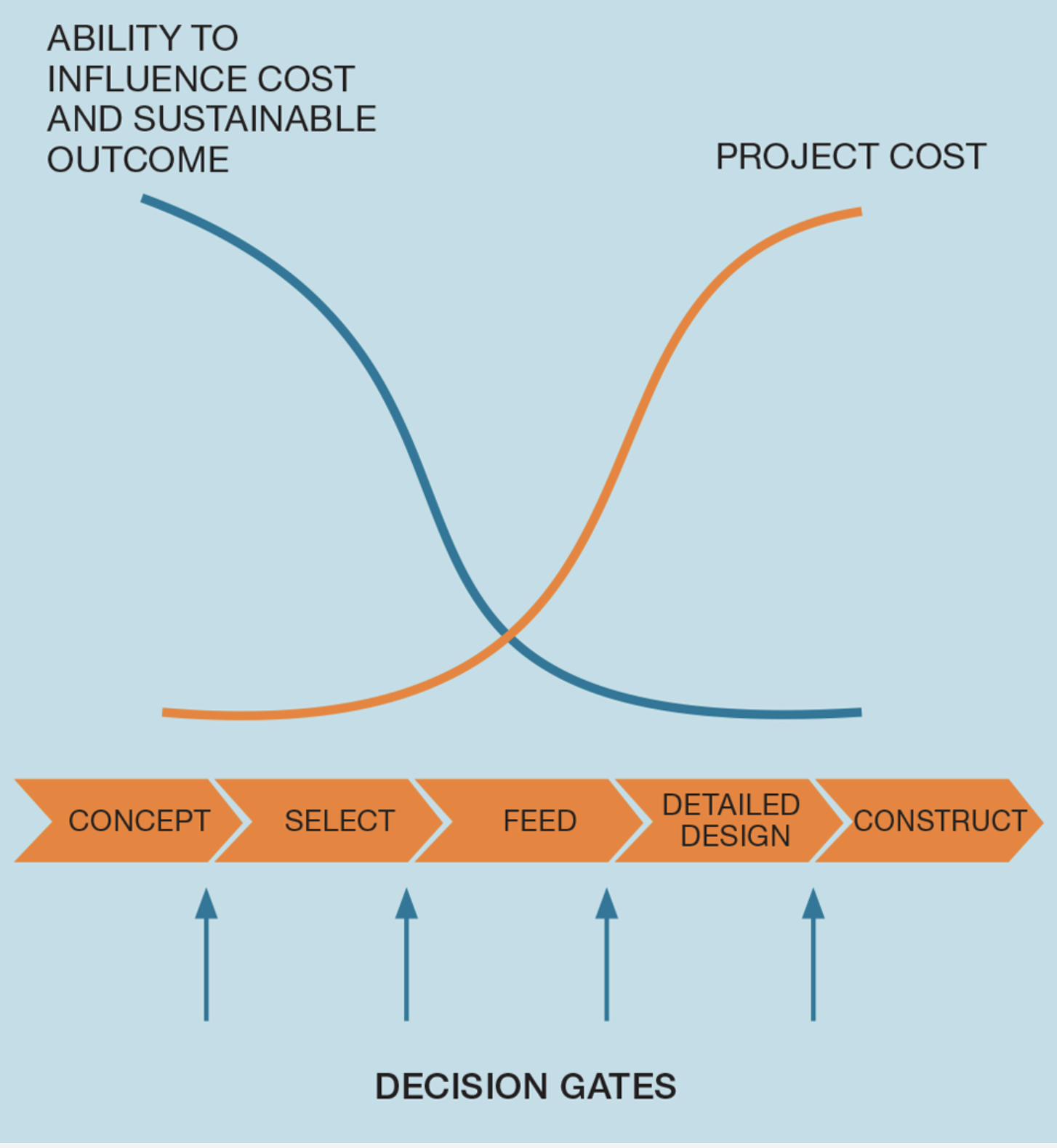

LnP Posted July 22, 2025 Posted July 22, 2025 3 hours ago, Dunc said: Overall, happy and would recommend. But for ANY company you go with, make sure either you are all over every little detail at every moment. It's astounding what "slips through the cracks" particularly during the design and engineering phase. Good advice. It's like any project I suppose. 1
