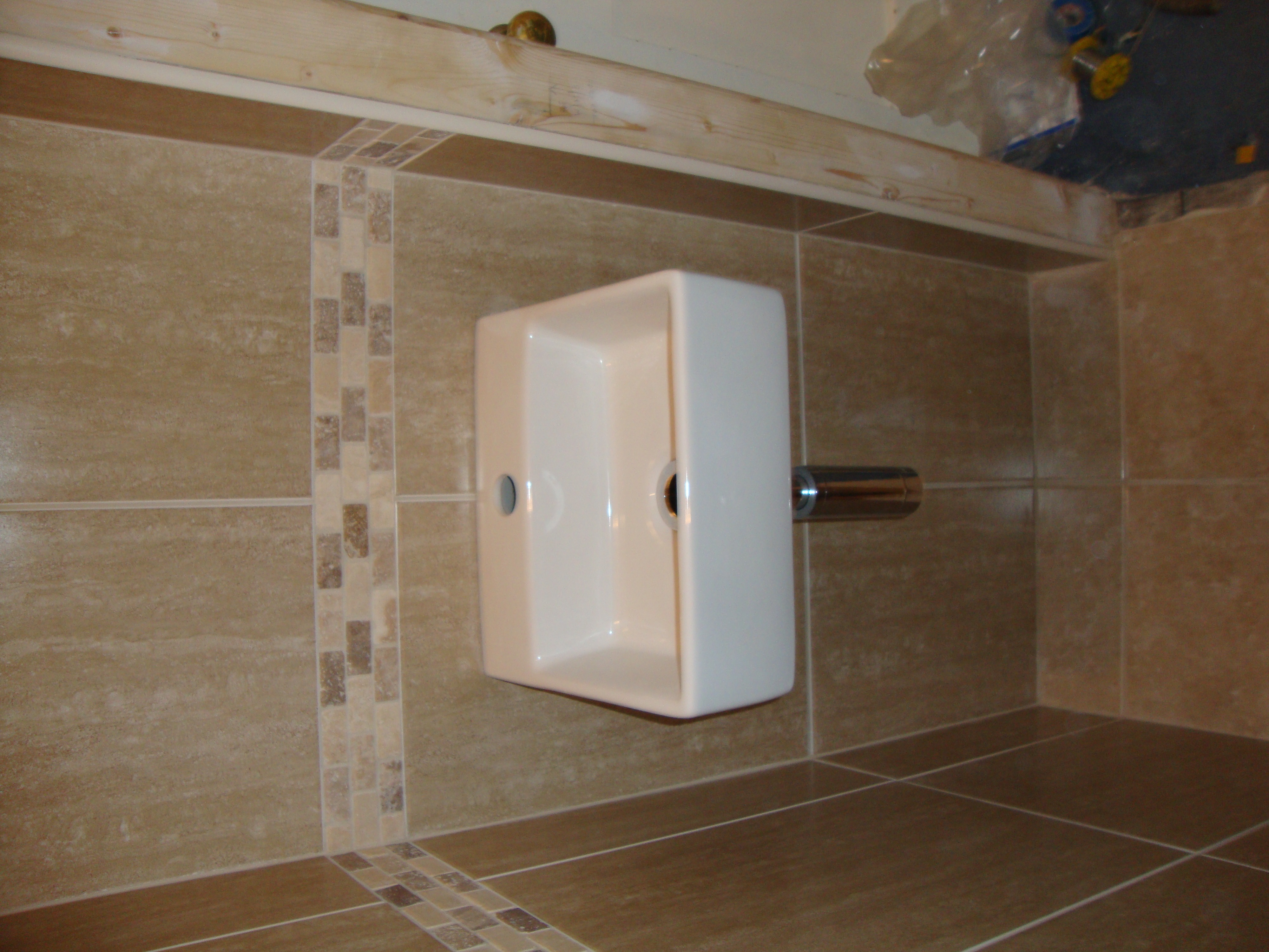

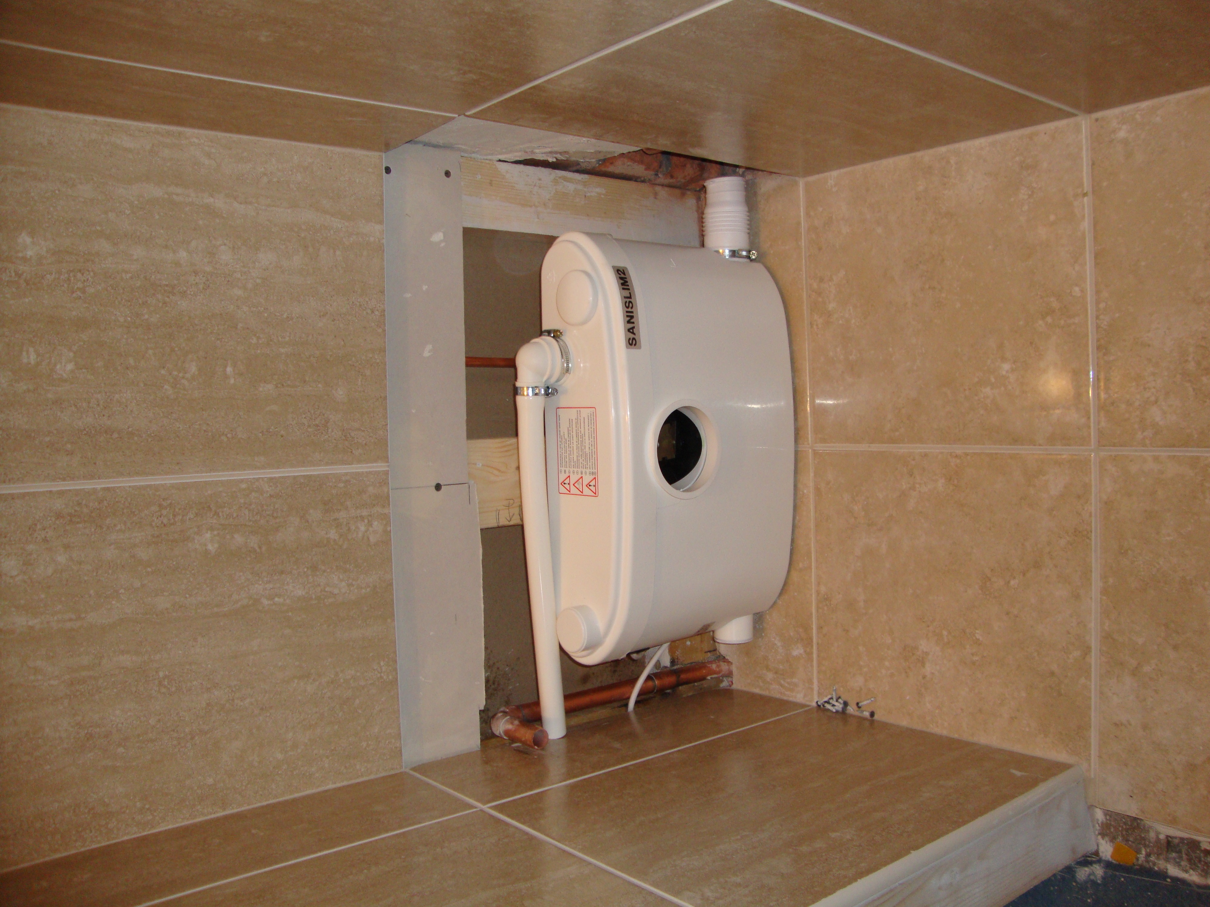

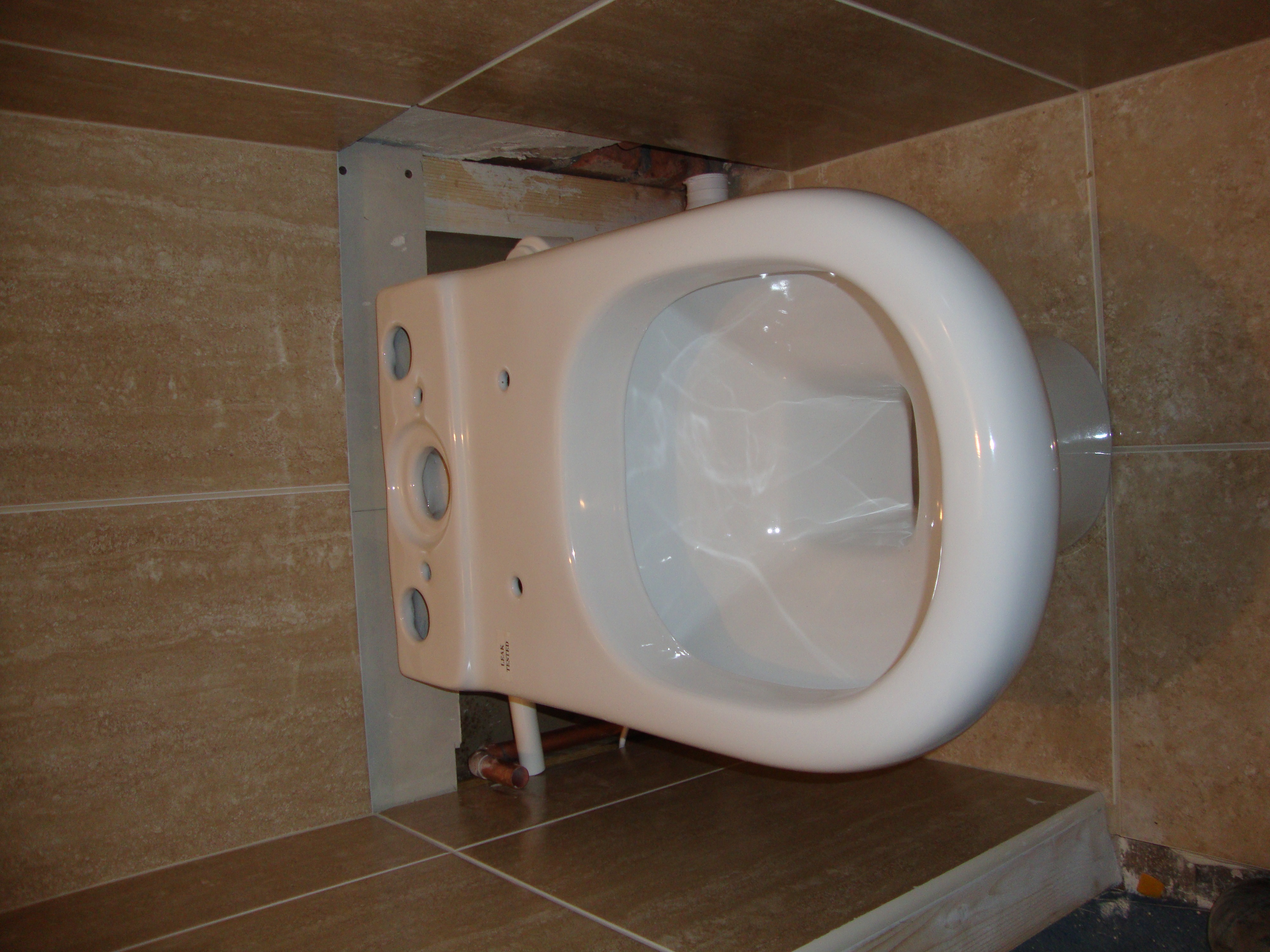

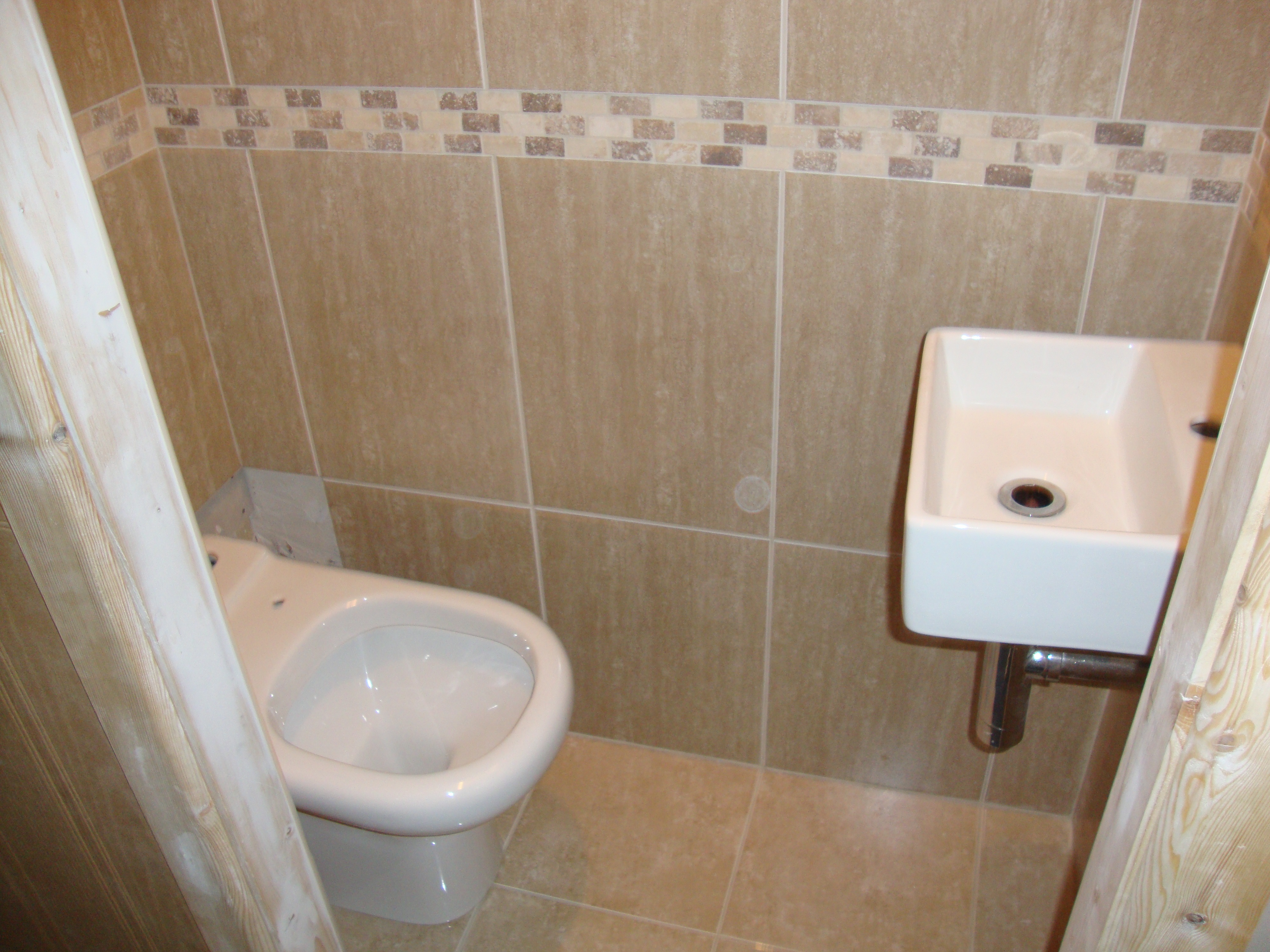

I fitted a cloakroom suite into a bookcase on top of a landing once. 1450x600mm internal dimensions. Customer still raves about it as its opposite all the bedroom doors ( no ensuites ). It's a strictly 'pee only' loo as that was one where I had to use a Saniflow compact.image.thumb.jpeg.1dffce34cba3e20b2131d5d93f7ed88d.jpegimage.thumb.jpeg.b6c220df531d4946677f7677a07b032f.jpegimage.thumb.jpeg.1569e2b753bdb3915e9f446347f3eace.jpegimage.thumb.jpeg.c965cd5267b1f80279174f6a84740180.jpeg
