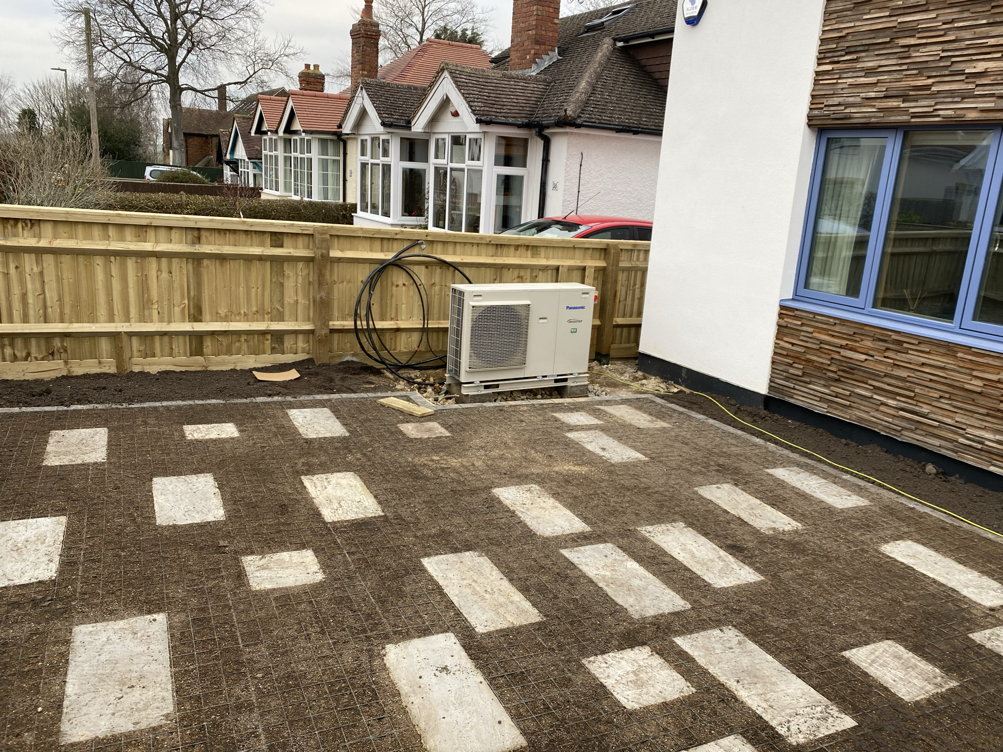

Nickfromwales Posted June 13, 2025 Posted June 13, 2025 I’ve installed a Panasonic in a clients front garden, next to the boundary fence, and when on full wallop the lady next door asked if it would be noisy when it’s in use. I said it’s on right now, and she’s said “oh, I couldn’t tell”. Bingo. Another where the client could hear a boiler flue 30m away over the unit he was stood next to, again going full wallop as I was there switching these on for the very first time, the latter in dec and an outside temp of -2°C. Your architect is saying the wrong thing, as regardless of where the heat comes from a kw is a kw, so a 16kw ASHP will produce………16kw, and a 16kw GSHP will produce……..16kw 🤷♂️🤦♂️🥹. So, they’re completely out of their depth and should stop giving you advice imho. They may be very good at designing houses, best they stick to what they know. 1
