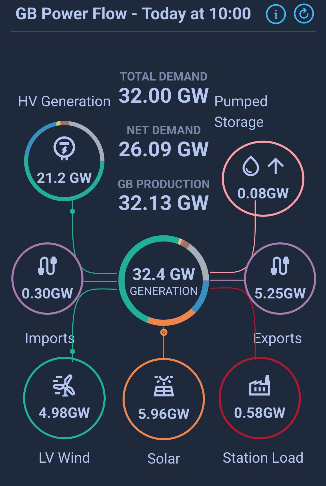

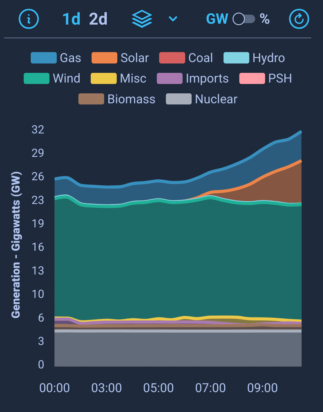

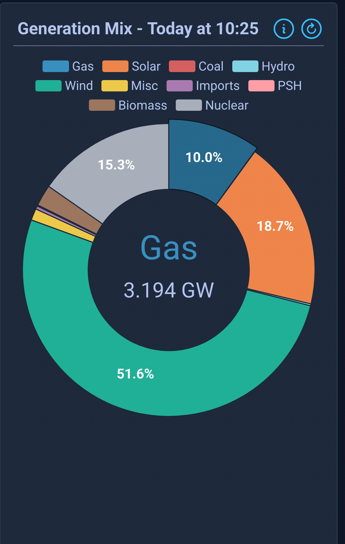

Beelbeebub Posted May 25, 2025 Posted May 25, 2025 So this morning (Sunday 25 May) the wind is blowing, the sun is shining and nearly 70% of our electrifty is coming from renewables. But the wholesale price will be set by the 3GW of gas that is being produced. Fine, that's just how it is. But we are also currently exporting 5GW of electricity. So if we just exported 2GW we could burn no gas and get cheaper electricity? If you look at the generation mix graphs you can see that we seem to be constantly burning gas even though we have enough generation for demand (and even export). The gas portion holds at a steady 3GW-ish. I get we need to keep gas plants up and spinning even in periods of plentiful renewables just in case we get a fault or the wind unexpectedly dies or whatever and they have to step in rapidly. But in that case is the Dutch auction system really a good way to price electricity? Surely it wouod be better for gas plants to be in their own separate silo as a "backup" generator with costs spread equally across the year as with other infrastructure like substations and cables.
