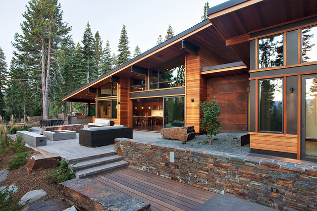

Russell griffiths Posted December 18, 2017 Posted December 18, 2017 (edited) So confused as usual. I read a thing recently regarding, what is the point in having super dooper walls if you have 75% glazing in that wall. Well I think I may be in that position, I’m trying to decide on a buildmethod and the approximate u value achieved with that build up, but if you look at the pic below this is a design we have been following and the rear wall will have a very similar look to the pic. Would you consider the amount of glass area to have such an effect on the overall heat loss that making really low u value walls will be a waste with all that glass, even with good quality windows and doors I don’t believe they come close to matching the walls. Any thoughts. Edited December 18, 2017 by Russell griffiths

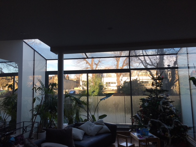

LadyBuilder Posted December 19, 2017 Posted December 19, 2017 I have this in my living room. I did it about 5 years ago and it was low U-value for glass (can't remember precise value). Building control was not happy, but after a very thorough SAP report, it was passed as SAP thought that it actually adds heat to the building. In actual fact, despite it being quite air tight, temps are always about 2 degrees lower in that part of the living room in the winter and in the evening I have a blanket. In the summer it is impossible to sit directly underneath. I love the look of it though, so I am happy to use that blanket in the winter…It is down to a personal choice more than building regulations IMO
Cpd Posted December 19, 2017 Posted December 19, 2017 I really really like the look of the photo @Russell griffiths But how on earth do those massive H beams not cause a world of trouble..... i know its the design you like and am sure you would not make such a thermal bridge ! But its still impressive.
Russell griffiths Posted December 19, 2017 Author Posted December 19, 2017 6 hours ago, Cpd said: I really really like the look of the photo @Russell griffiths But how on earth do those massive H beams not cause a world of trouble..... i know its the design you like and am sure you would not make such a thermal bridge ! But its still impressive. We are thinking of changing the beams for gluelams, this pic is from the states where anything seems to be ok.
