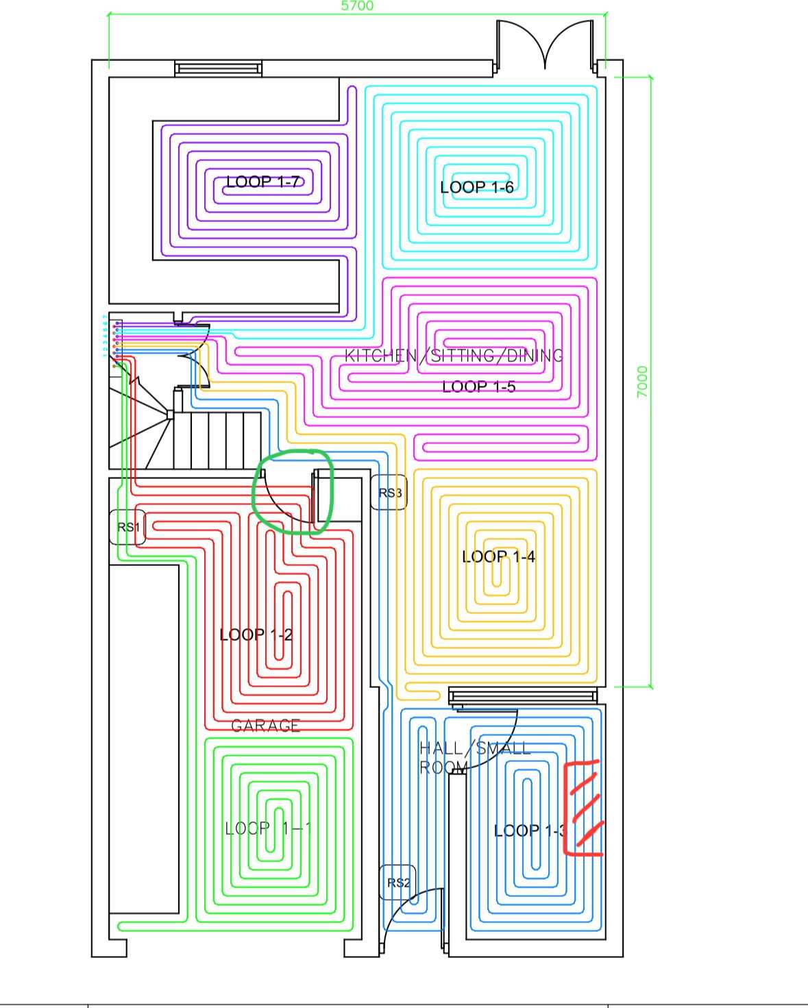

vala Posted May 12, 2025 Posted May 12, 2025 We have a polished concrete floor being installed in July so next month have to install the UFH. Had a design completed with Wunda and they have omitted any pipes under the kitchen units/fridge freezer etc. As it's a polished concrete floor, and expecting to be running low flow temps would having it under the units, fridge freezer have as much of an adverse effect on those appliances? My thoughts were that the heat would end up underneath them anyway as it's all being poured as one slab. So just wanted to gain and advice from here as to whether I'm on the right track and have the UFH everywhere? For what it's worth the fridge freezer will be a free standing unit.
JohnMo Posted May 12, 2025 Posted May 12, 2025 Just now, vala said: polished concrete floor Polished concrete or tiles are no different. In open space your floor temperature will around 2 to 6 degs above room temperature. Air trapped beneath kitchen units is going to warmer that the room. Make your own call. I didn't have any UFH pipes below beds, wardrobes, any kitchen units. Does house feel cold - no, even at 300mm pipe centres I don't flow high temps. You will get answers that say do and others like mine that say don't. You need to consider your house layout and likelihood of being changed in the future. For example - Our house is not likely to be reconfigured, as it's all geared to views, other/yours houses are different. 1
nod Posted May 12, 2025 Posted May 12, 2025 Most companies will ask you to mark the units islands etc I think the cupboard's would get quite warm Weve 150 centres in our current build and 300s in our previous build There’s really no noticeable difference
Gus Potter Posted May 12, 2025 Posted May 12, 2025 1 hour ago, nod said: Most companies will ask you to mark the units islands etc I think the cupboard's would get quite warm Weve 150 centres in our current build and 300s in our previous build There’s really no noticeable difference Philistine here.. Nod makes a good point. I've run my UF pipes under my island units. The cupboards are warm... keeps the pasta dry for example. I have a gap at the top of the plinth to let excessive heat out. Where I have my fridge and freezer I opened up the pipe spacing.. just to provide a bit of residual heat. I've been doing this for decades. UF is a pragmatic art.. the focus is on the art! What I do is have plenty loops, and short flow adjustable loops. Commercial companies will try and be smart and seek some cost advantage.. which is bonkers when you think that UF should at least last the lifetime of the house.

Nickfromwales Posted May 12, 2025 Posted May 12, 2025 Where I meet the run of kitchen units I stop the pipes at 450-500mm away from the walls, but where there is an island or peninsula I just always go under them. The temp is so low it really doesn't do any harm at all, and unless you plan on keeping perishables in those particular units it matters not afaic.

vala Posted May 22, 2025 Author Posted May 22, 2025 Thanks all for the comments. Looks like some of the base units in the kitchen area will contain food, but as I don't know which ones yet think I'll play it safe and just leave that area unheated. Got the final plans through from Wunda and aside from a phantom door (circled in green) which isn't in our house, they've put the pipe everywhere in the small room at the front. Here there's just a washing machine and small unit for a wash basin. Worth veering round those 2 or just go under?
vala Posted May 22, 2025 Author Posted May 22, 2025 1 hour ago, JohnMo said: I must be missing something - UFH in garage? yes. thought it best in case that ever changed at some point to a habitable room. Plus I often work in there, so saves me firing up a heater.
JohnMo Posted May 22, 2025 Posted May 22, 2025 (edited) 12 minutes ago, vala said: yes. thought it best in case that ever changed at some point to a habitable room. Plus I often work in there, so saves me firing up a heater. So will the garage floor be insulated as well as the rest of the house? If not you will be unlikely to get a balance out of the heating and most of the heat in the garage will take the easiest route - which is down, not into the room. Make sure you really think this through. Edited May 22, 2025 by JohnMo
vala Posted May 22, 2025 Author Posted May 22, 2025 5 minutes ago, JohnMo said: So will the garage floor be insulated as well as the rest of the house? If not you will be unlikely to get a balance out of the heating and most of the heat in the garage will take the easiest route - which is down, not into the room. Make sure you really think this through. exact same level of insulation and floor build up/finish as the rest of the house. It's all getting done at the same time.
Mike Posted May 22, 2025 Posted May 22, 2025 (edited) 4 hours ago, vala said: Looks like some of the base units in the kitchen area will contain food, but as I don't know which ones yet think I'll play it safe and just leave that area unheated There is no significant benefit from omitting heating under the cupboards. The floor beneath will heat up anyway (it's in contact with the rest of the floor) and the cupboards will heat up too (they're in contact with the rest of the room). Omitting the pipe just means that it may take them an extra hour or three to reach a stable temperature. Just put any temperature-sensitive foods in the fridge. Edited May 22, 2025 by Mike
