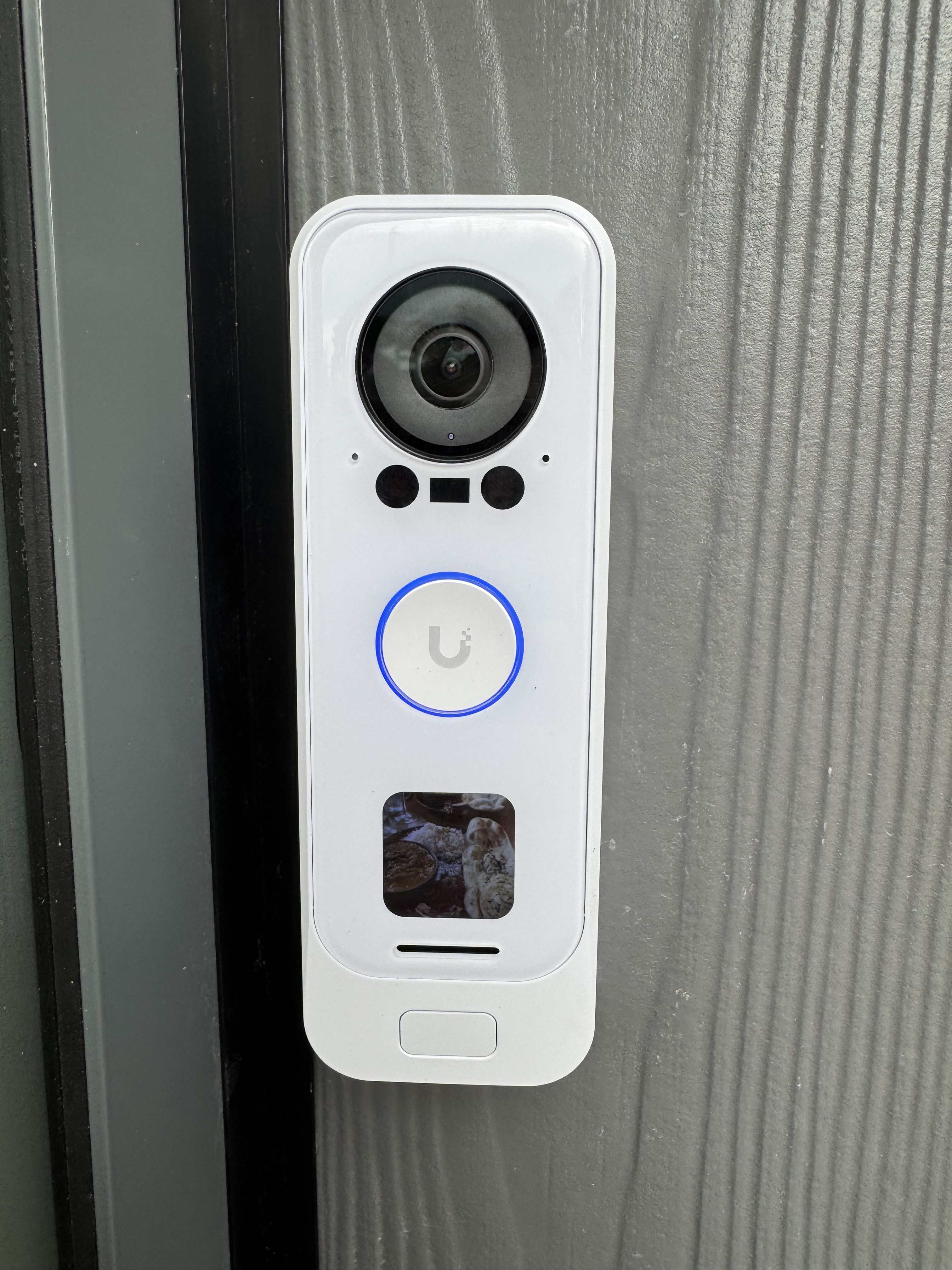

Pocster Posted May 6, 2025 Author Posted May 6, 2025 Ffs ! the UniFi g4 does it all - even the chime is poe ! So perfect ! But I’m not paying £200 for the (expletive deleted)ing protect bs
Pocster Posted May 6, 2025 Author Posted May 6, 2025 (expletive deleted) it ! g4 pro off eBay new stupid (expletive deleted)ing chime from Amazon used cloud key off eBay . Thats an expensive (expletive deleted)ing doorbell

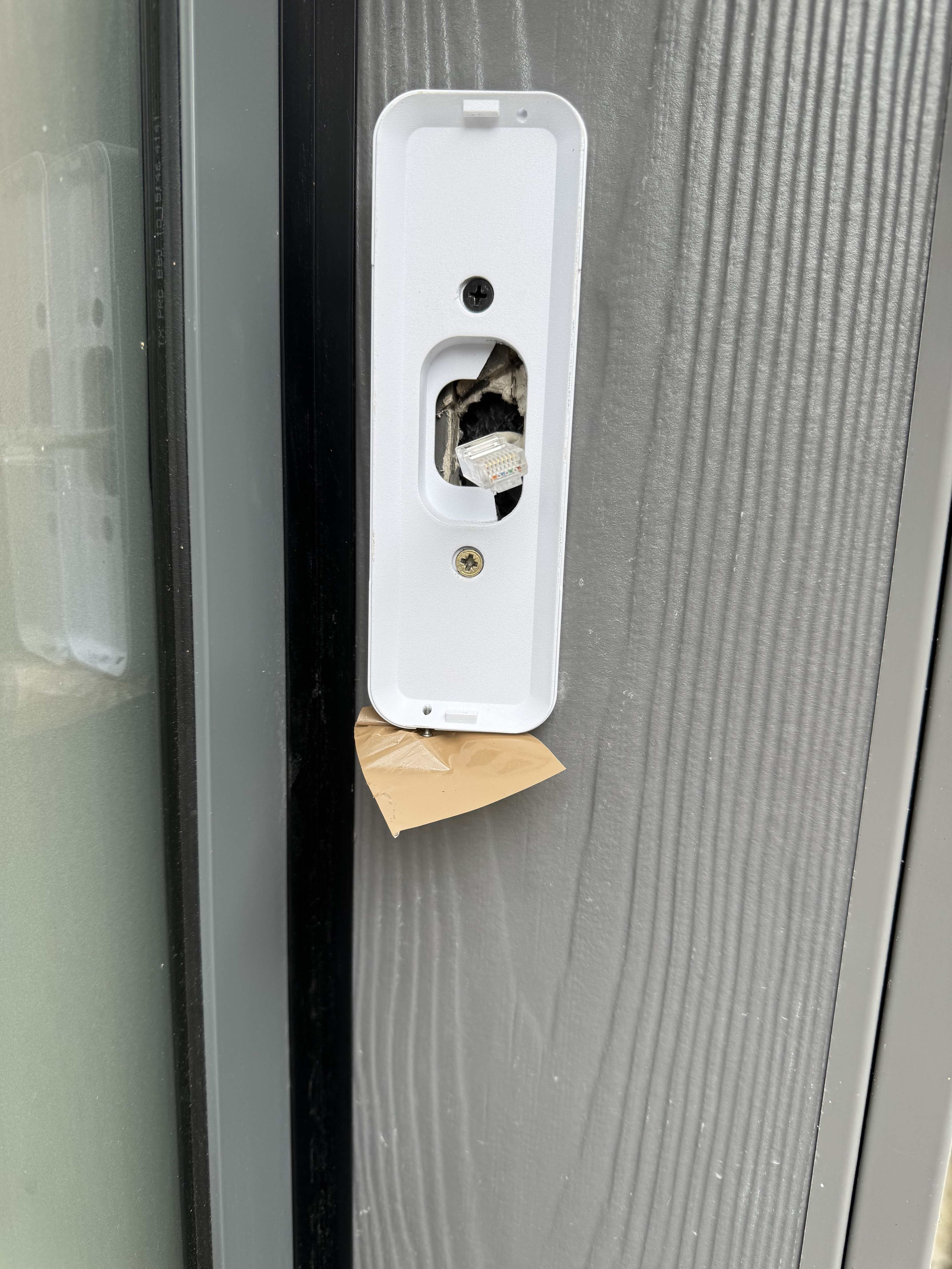

Pocster Posted May 12, 2025 Author Posted May 12, 2025 Well ! You ubiquti guys must love this shite ! umpteen updates - to everything , cloud key , protect , os , doorbell , chime ; half the (expletive deleted)ing ubiquiti global network I think . Over and over again ! Finally can’t get anything else to update . Device discovery seems a bit hit and miss . But finally it’s all up ! Doorbell install is the worst I’ve ever seen . Plastic bits that don’t fit all held in place by a tiny m2 screw . Shite . Googling confirms my frustration . Hence in the photo the packaging tape holding that tiny (expletive deleted)er in place to reduce probability of falling out and losing it . Package cam is shite ( not that I was concerned about that ) - doesn’t even show that in the app - but does in the web ui . Oh and doesn’t identify a package anyway . Custom ring tones ? - nah , without ssh into it . What (expletive deleted)ing year is it !? Chime not loud 🫤 Anyway the chime works ( poe ) though you can’t configure / custom the chime . For a premium product with a premium price it’s a bit slack . Still - on test now . Instead of the default (expletive deleted)ing pointless dog picture on the screen I have a photo of one of my curries . 1 1

joth Posted May 13, 2025 Posted May 13, 2025 Agree their doorbell is a bit of an electrical-mechanical-firmware fail. At least you don't have the previous version with PoE over USB-C (a horrible connector for outdoor installation use), and pisspoor electronics that would melt down and release magic smoke if you enable "mechanical chime" mode when powering it direct from a 12V psu. Do you need a cloud key to run it, or just to setup? In the old days you could use a laptop to run the cloud config software just when needed. And most the "smart" features (like AI object detection) are built into the doorbell itself. You should be able to configure webhook(s) on it to have it ping HA (or whatever) when object spotted or button pressed, and this part at least doesn't need the cloud key. I guess remote answering via app does though. Anyway good news is now you have cloud key you're one of us, and lower marginal cost to buy your next shinny unifi object. 1
Pocster Posted May 13, 2025 Author Posted May 13, 2025 5 hours ago, joth said: Anyway good news is now you have cloud key you're one of us, and lower marginal cost to buy your next shinny unifi object. I was always reluctant with ubiquiti because of the cloud key . In the future say g6 - they can then do “ needs super cloud key gen 3 + “ … I did manage to get a 2nd hand one off eBay for £90 though . Or make its functionality paid subscription only …. . Don’t like locked in brands . But ! they do have some interesting cameras and sensors ( price ranging from reasonable to (expletive deleted)ing stupid ) . So I’m sure something will cause me to open my wallet once I’m convinced their doorbell works reliably.

Pocster Posted May 15, 2025 Author Posted May 15, 2025 A few updates on the g4 doorbell You can see the parcel cam view - it’s just not obvious in the app ; but it’s there . It does indeed recognise parcels as the recorded footage shows it . But notifications of a parcel being left appear not to work . Managed to hopefully get another poe chime for upstairs .
