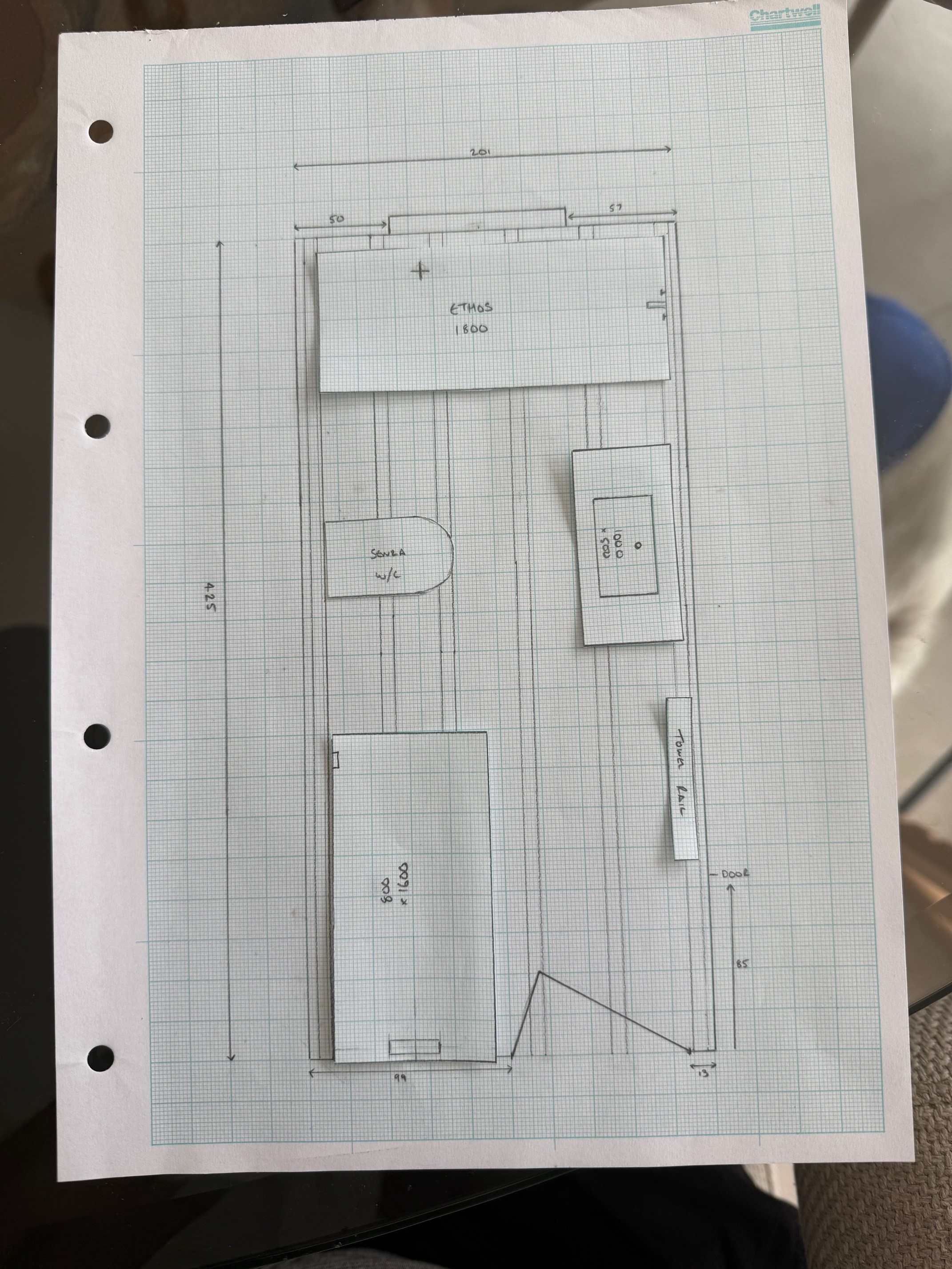

I am just designing my main bathroom and we have found a freestanding bath we like. One concern I have is the weight of it!
The bath is 180kg, capacity to overflow is 400L and guessing got the allow for 2 adults (worst case) so quite a lot of weight
The bath will definitely site on 4 joists and more likely 5 joists (see attached layout)
They are posi joists at 400 centres, 75x225mm
Is this weight spread over those joists anything to worry about?
If so how would i check/confirm this?
Many Thanks

Assuming the joists are as specified for a bathroom then the bath weight is accounted for. The joists are OK. But you could splice more wood on, or a ply plate on the side if it makes you more comfortable. It doesn't have to reach the supports.
But, as above, the floor boarding is the weakness.
It already has 22mm T & G chipboard floorboard above, all the floor will be tiled and then bath sat on the tiles
I will put some extra noggins and strongback's in like suggested

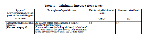

Let's start with the loads that a domestic floor often is required to carry. BS 6399 part 1 on says:

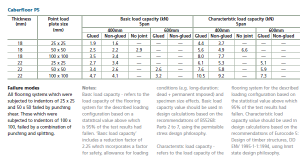

Ok the 1.5 kN/m^2 (about 150 kg per square metre of floor)  uniformly distributed load is often seen when you look up any basic joist manufacture's data tables and suppliers of chipboard flooring. But what you rarely see is how much point load say 22mm thick P5 flooring can carry. We want to know this to ensure your bath legs don't punch through the floor in the first instance. The table above requires that the floor can carry a point load of 1.4 kN (about 140 kg). Now say you have a penchant for cowboy boots or high heal shoes. This is a concentrated load which causes punching shear (like bath legs) and we can, if we have the will to live, work this out mathematically to some extent but this would give a very conservative result. For design purposes we want to look at test data.
But to make things a bit easier (broadly speaking) we could find some manufacture's data that tells us what the safe working punching shear capacity of chipboard flooring is! Now as luck would have it Caberfloor have a nifty table as below:
Start at the top left of the table. For an 18mm thick flooring loaded with a 25 x 25mm contact area the floor can carry 1.9 kN (~190 kg) on glued on joists spaced at 400mm apart... but this is away from the floor edges which are much weaker.

For me I would be inclined (if the bath is heavy) to take other posters advice and add a few noggings under the bath leg positions. If tiling with large format tiles I would be double up the joists under the bath leg area to avoid differential deflection that could crack the tiles. Also if the bath leaks a bit then the performance of the flooring drops off dramatically so having some solid timber under the legs of a heavy bath is a good idea.

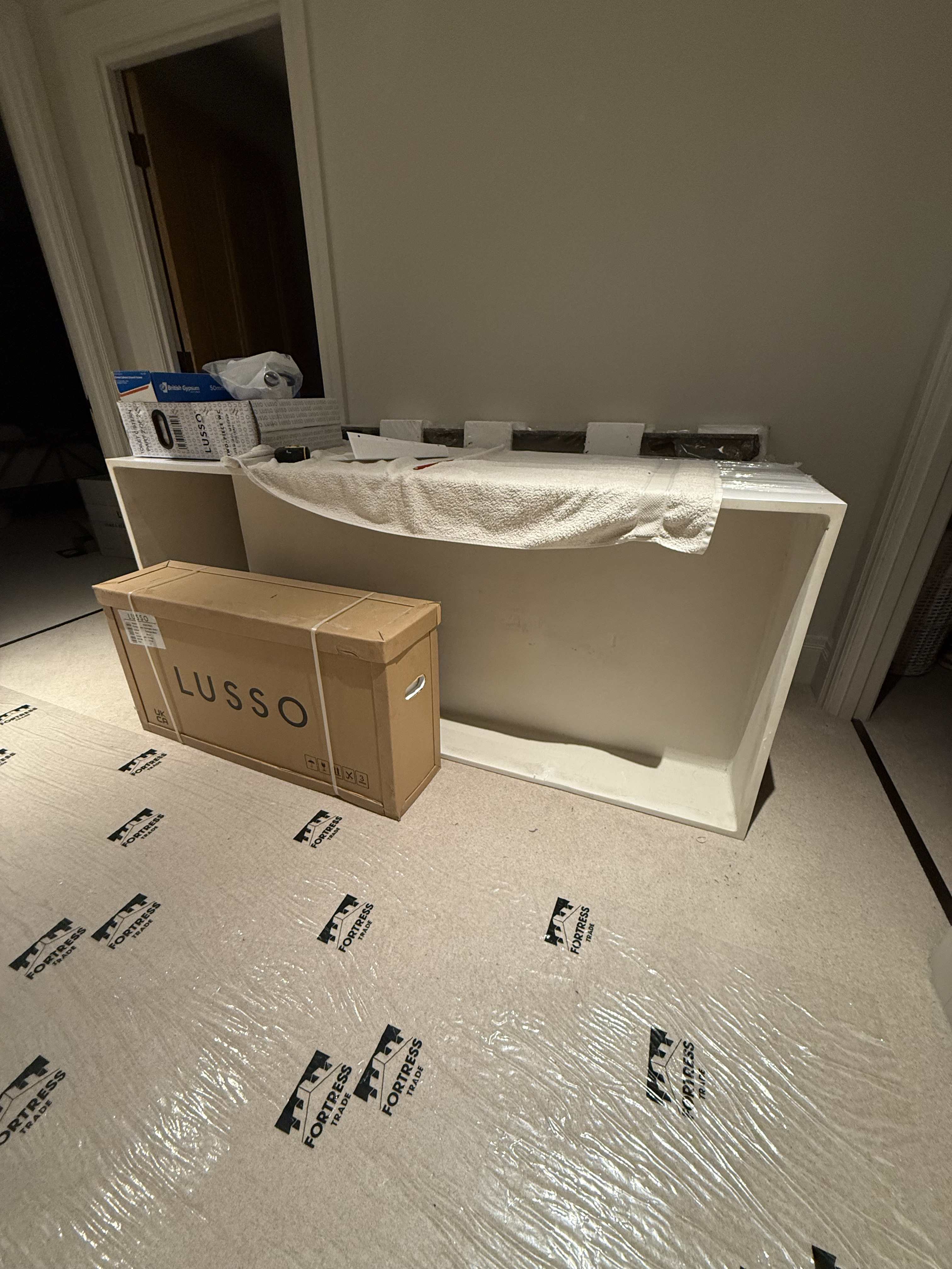

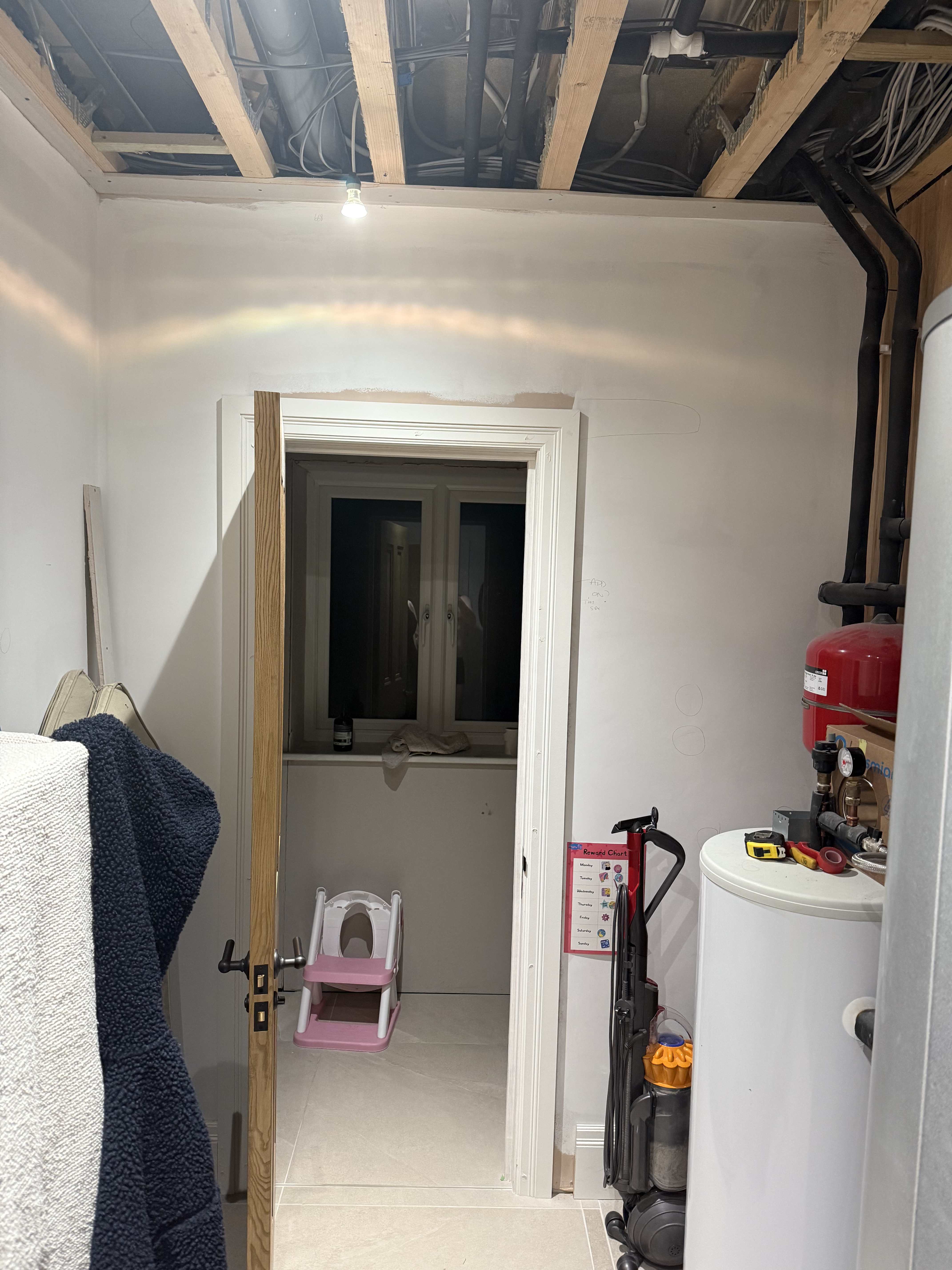

Hi All
I just thought I would add to this post as my bath will be going in very shortly. The bath hasn’t got legs but has a continuous 20mm edge all the way round (see pic)
We will tiling completely underneath it so complete make up will be 75x225mm posi joists at 400 centres, 22mm T&G floorboards, plywood, 600 x 1200 tiles.
I am overly cautious with things like this, would it be worth getting a structural engineers advice on this? Or will it be fine?

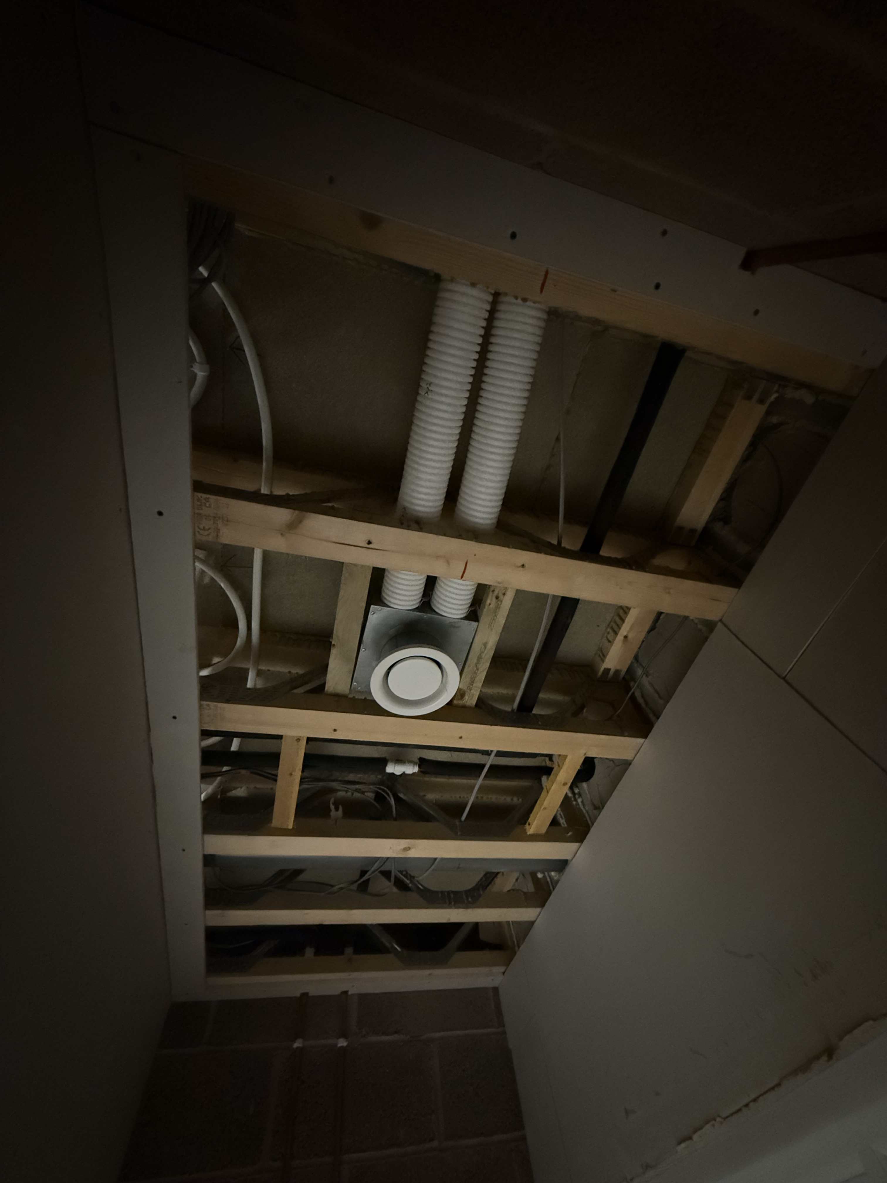

I have attached a picture of below, if anyone can suggest best way to reinforce the floor it would be very much appreciated. The bath actually sits inside the downstairs toilet so I can lose a bit of ceiling height if it would help with support etc.
Any help or advice would be very much appreciatedIMG_9726.thumb.jpeg.2a5047b2c499825ef89919a8df3a159e.jpegIMG_9727.thumb.jpeg.f30d9e631c3f708a6b81d7a170b0a6b7.jpeg

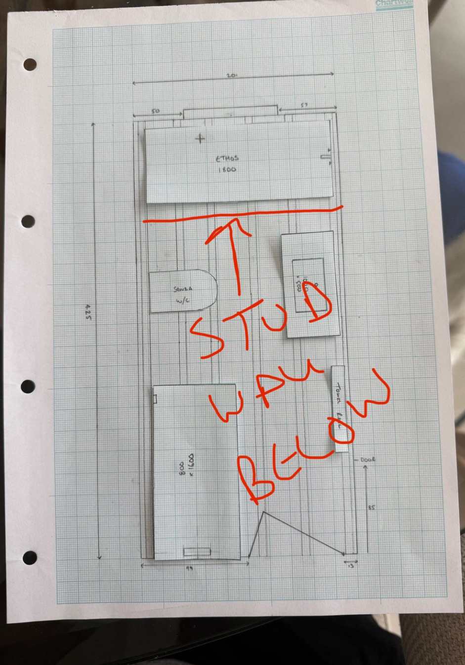

Meant to add I have a stud wall below that is fixed to the underside of the joists
Will this help at all?
Sorry for the spam, just want to make sure it’s rightIMG_9729.thumb.jpeg.9b7cc4c915e19422bcd9e1bdd32612e3.jpegIMG_9728.thumb.jpeg.eb691712277c77a1357a075433d2eb0b.jpeg
The floor will have already been spec’d to take a bath, and with the short span from the stud to the outside wall I doubt you’ll have any issues whatsoever.
Your floor build up will spread the weight quite well too.
Do you know if the posis rest on that stud wall, or simply fly over it (and there’s just a few token nails fired in to pin it together)?
Best to make sure the tiler hasn’t been on the pop the night before laying the tiles, as that’ll need a very flat / level surface to sit on. ;)
What is that small room below the bath being used for?
