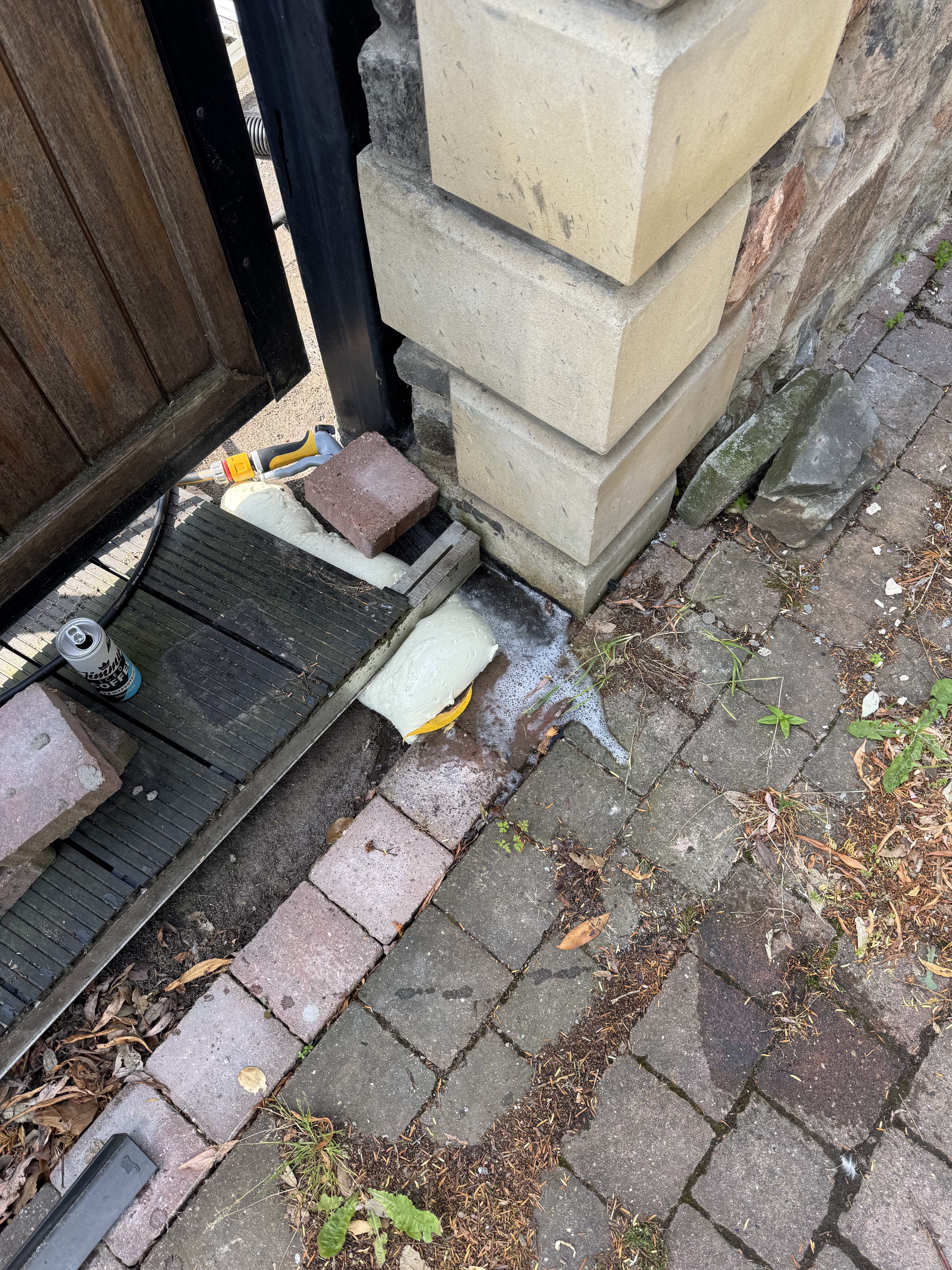

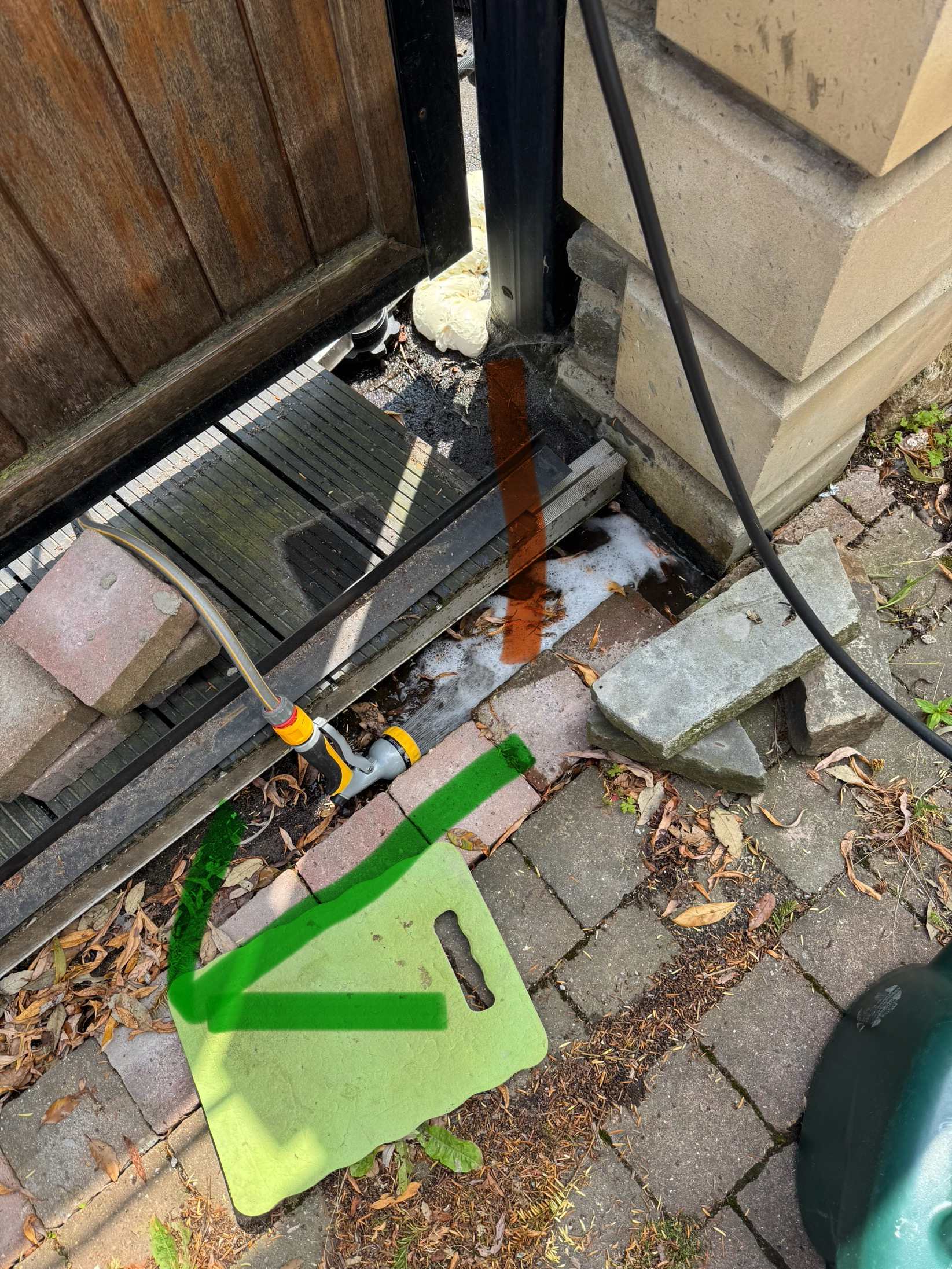

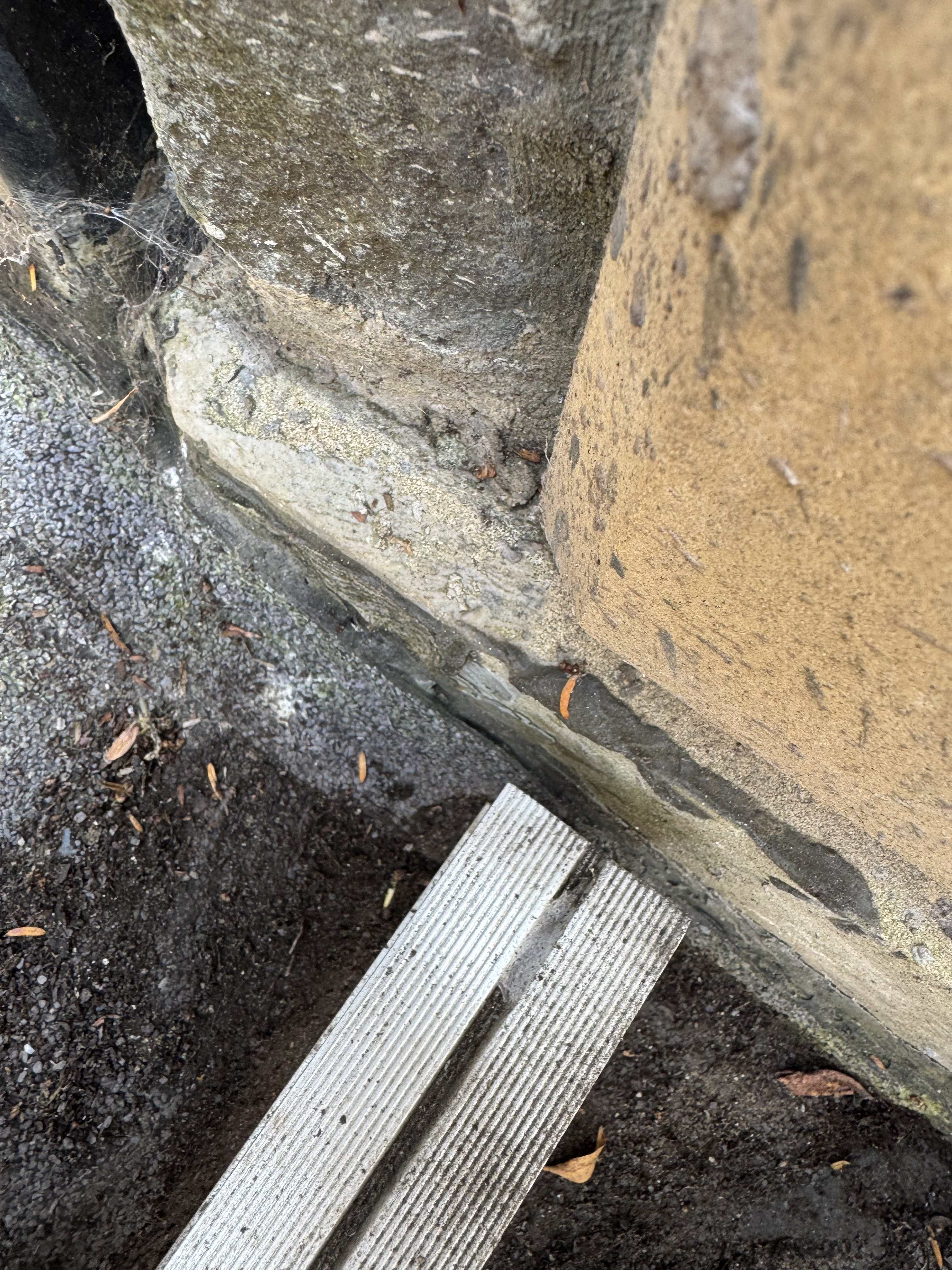

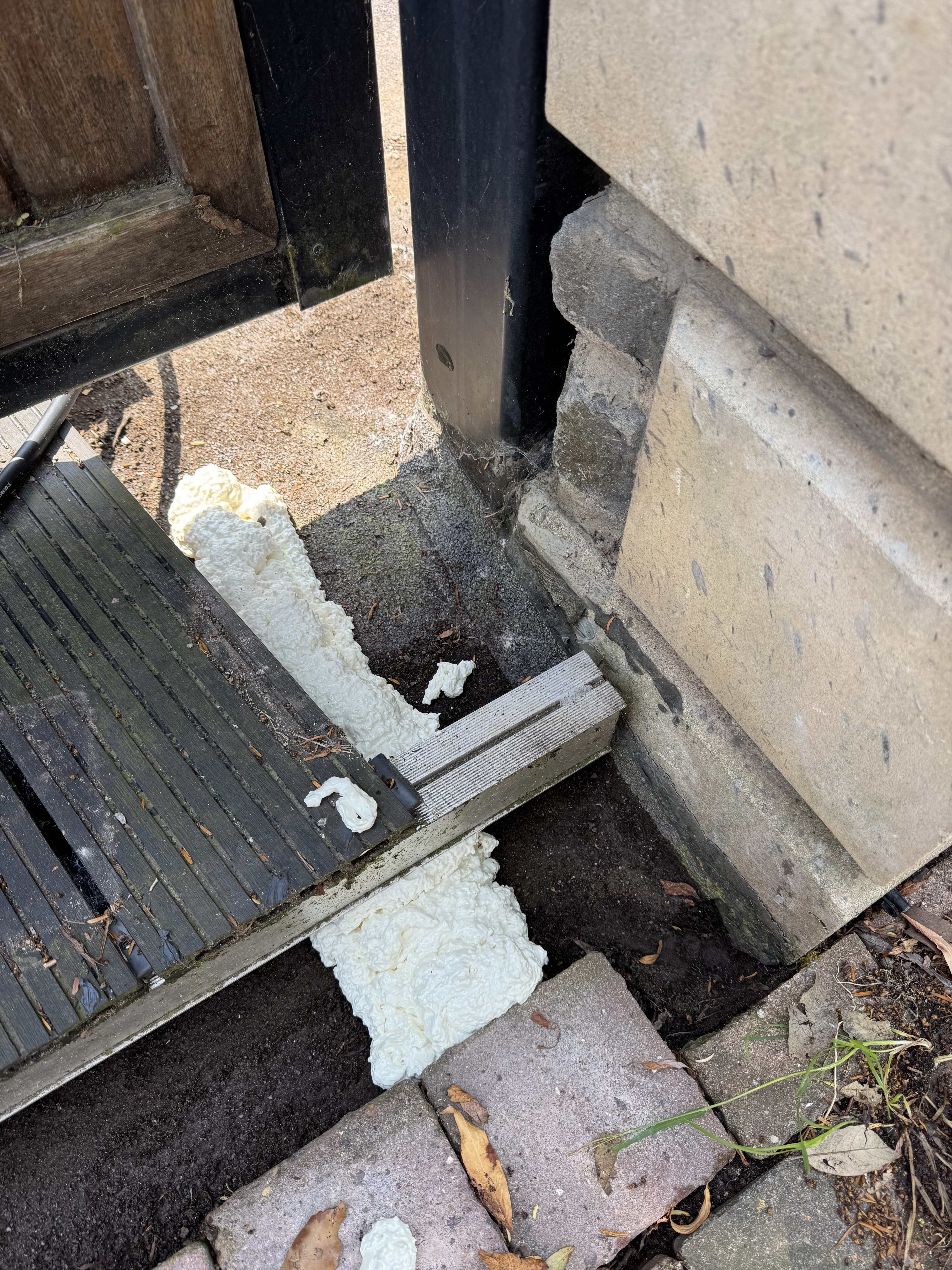

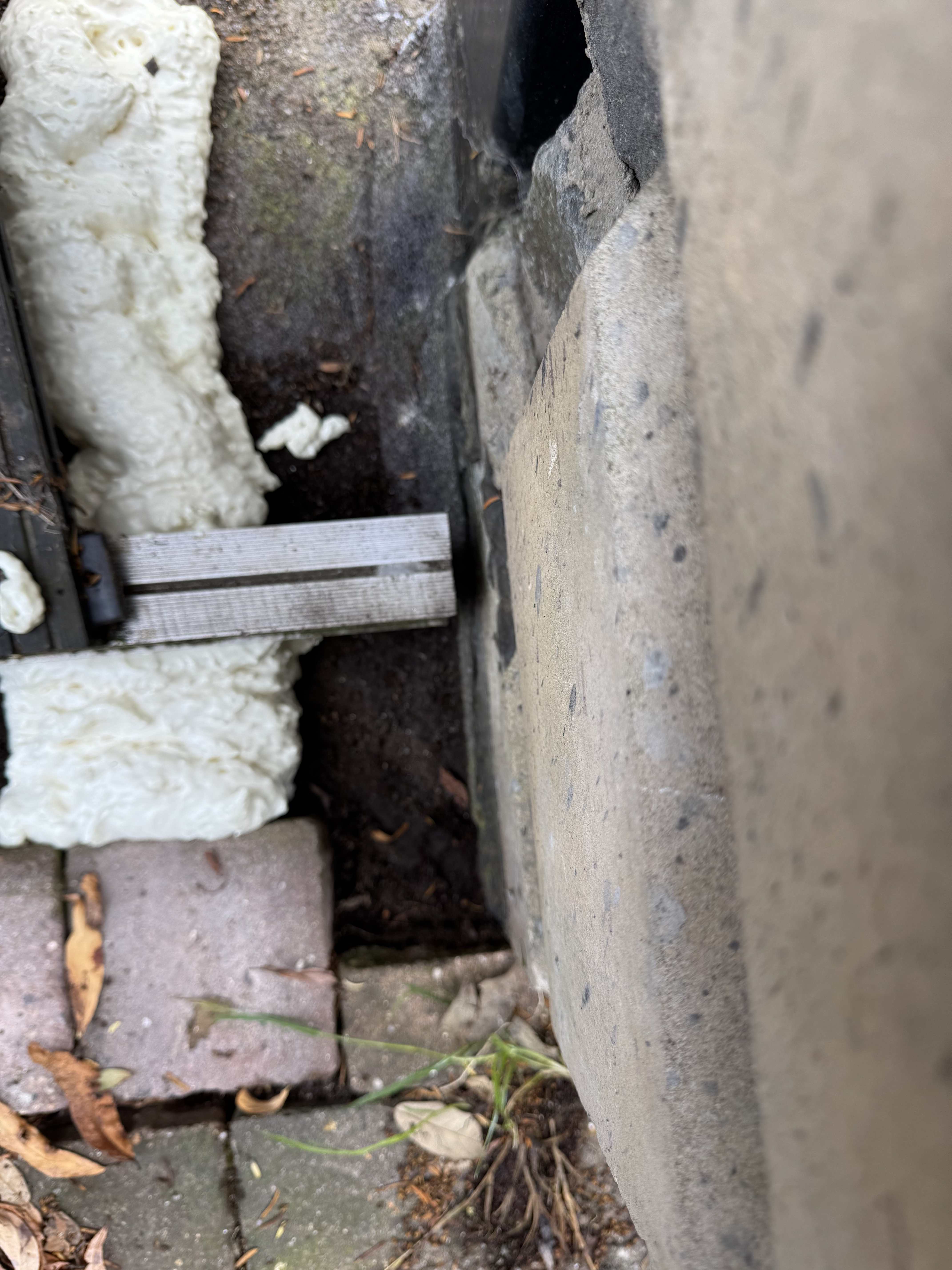

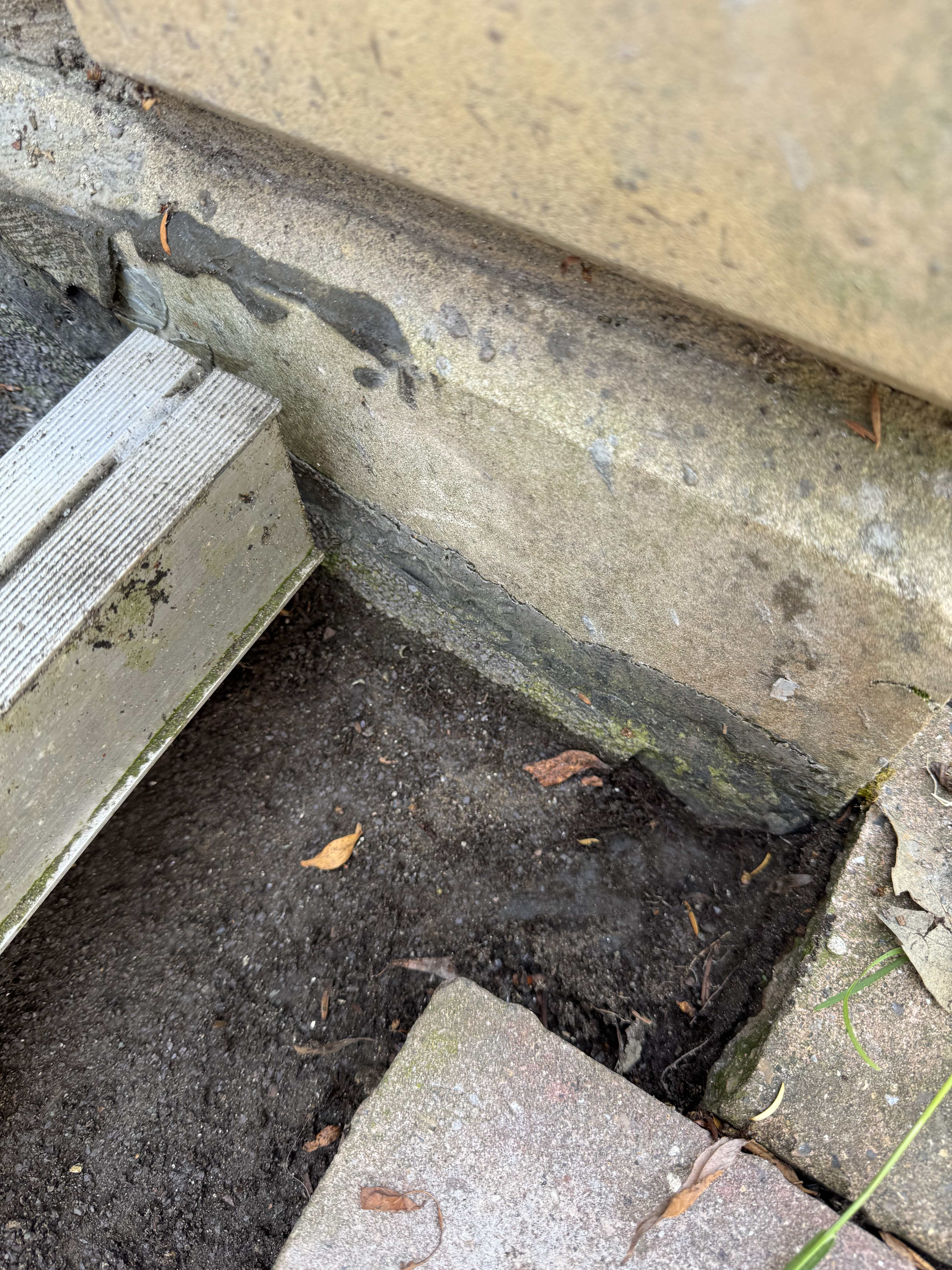

Pocster Posted Saturday at 06:48 Author Posted Saturday at 06:48 (edited) Stay with me fellas - it’ll be worth it ! New plan ! Remove all existing foam barriers . This front bit has a slight fall as shown by the green arrow . Difficult to isolate that corner so will put a foam barrier on the red line . Water runs off roof and avoids this corner . Will use hose as it seems a better test ( ignoring the water bill ) My theory is this corner will hold water with high enough rain , but a shower ; it just follows the fall hence sometimes no leak even after constant rain . So will hose further up the roof letting the water run naturally down and out under the gate but avoiding this corner . Edited Saturday at 06:48 by Pocster

Pocster Posted Saturday at 10:10 Author Posted Saturday at 10:10 (edited) 2 hours ago, Onoff said: How about pressuring the basement then going round the roof with leak detection spray? How’s that work ? . Assuming I could pressurise the basement . Not sure that would work as the water is seeping through the concrete block upstands - no actual obvious gap Edited Saturday at 10:14 by Pocster
Onoff Posted Saturday at 10:42 Posted Saturday at 10:42 24 minutes ago, Pocster said: How’s that work ? . Assuming I could pressurise the basement . Not sure that would work as the water is seeping through the concrete block upstands - no actual obvious gap I forgot to put the tongue in cheek emoji as was only half serious but tbh, why not? If the dwelling was "airtight" then wouldn't a leak path also allow air to escape? Thus you ramp up the pressure in the basement sealing everything else up then go around spraying some leak detection fluid on suspect seams. It forms a thin film & any air leakage bubbles it up. https://www.tyrebaydirect.com/product/leak-detection-fluid/ 1
Pocster Posted Saturday at 10:54 Author Posted Saturday at 10:54 11 minutes ago, Onoff said: I forgot to put the tongue in cheek emoji as was only half serious but tbh, why not? If the dwelling was "airtight" then wouldn't a leak path also allow air to escape? Thus you ramp up the pressure in the basement sealing everything else up then go around spraying some leak detection fluid on suspect seams. It forms a thin film & any air leakage bubbles it up. https://www.tyrebaydirect.com/product/leak-detection-fluid/ Yeah I can’t see it working tbh . But it’s not as barmey as it sounds !
Pocster Posted Saturday at 10:56 Author Posted Saturday at 10:56 So ! All the other foam barriers removed . This one ; waiting to cure . Will place the hose at the top at a controlled flow rate . Want it to go in this bit and overflow the block paving . Some of the asphalt to stone have potential small gaps on their edge … But everything looks like a suspect when you’re desperate!

Pocster Posted Sunday at 09:10 Author Posted Sunday at 09:10 Feeling lucky today ! Hose positioned to overwhelm this corner . Angled so it can’t run back - now to wait …
