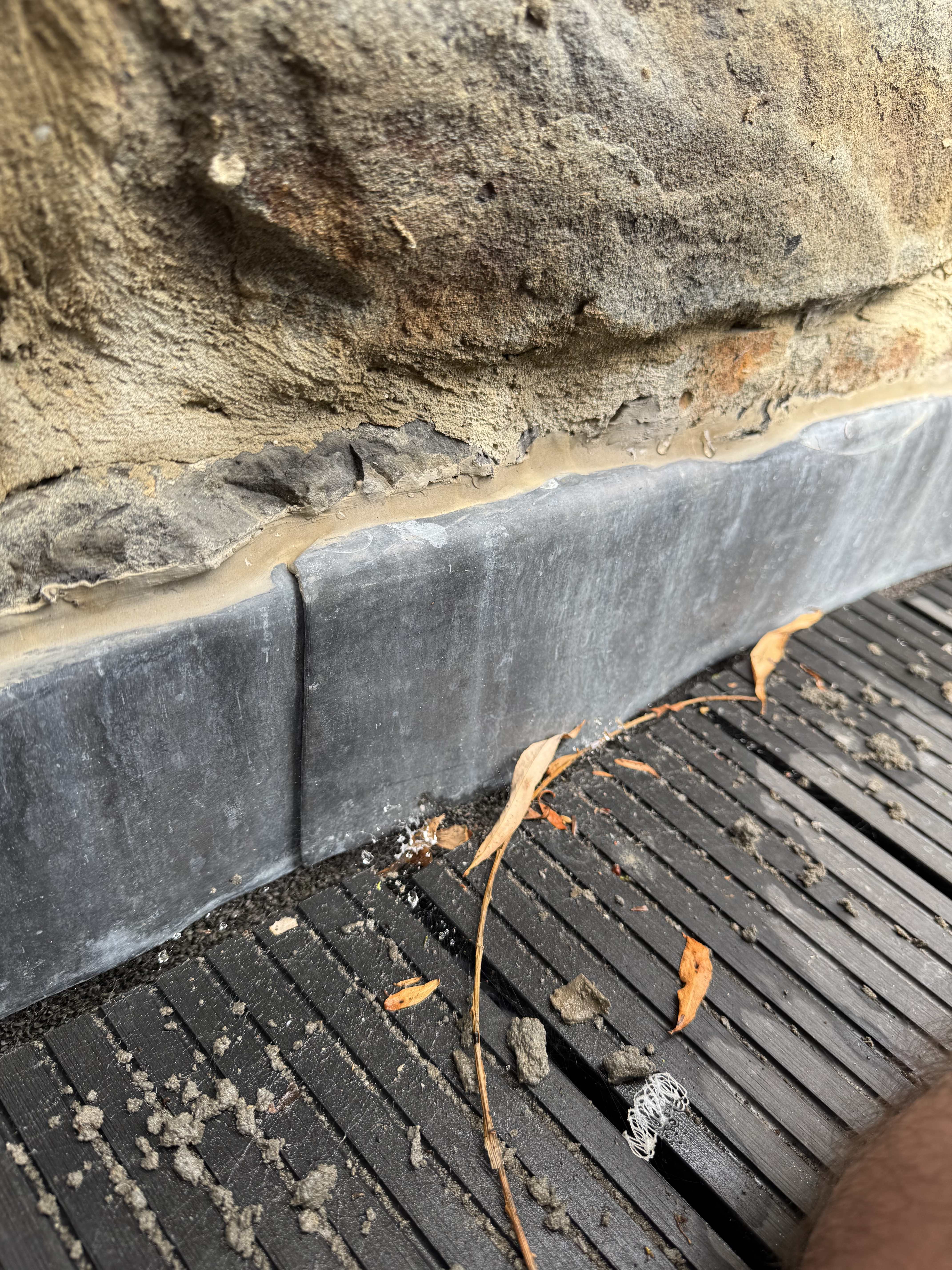

Finally filled the flashing overlap with ct1 as dry today . Will hose and test tomorrow
Hosed the wall on Max for 10 mins above that flashing overlap . The inside was slightly damp to touch from previous rain - so it makes judgement harder . But ! , 20 mins later nothing obvious inside ! . So will leave ( assuming it’s fixed ) as inside should be drier tomorrow and repeat . Looks promising though !
Ok . It still leaks - 1 drop and a bit damp .
I was hosing that area - I believe ( guess ) that spray from that maybe also hitting this overlap . So will ct1 that and repeat tomorrows test.
Ok , more than 1 drop . But not quarter of a bucket . So now to fix that 2nd overlap . There are no more overlaps on that run , so I hope this is it ….

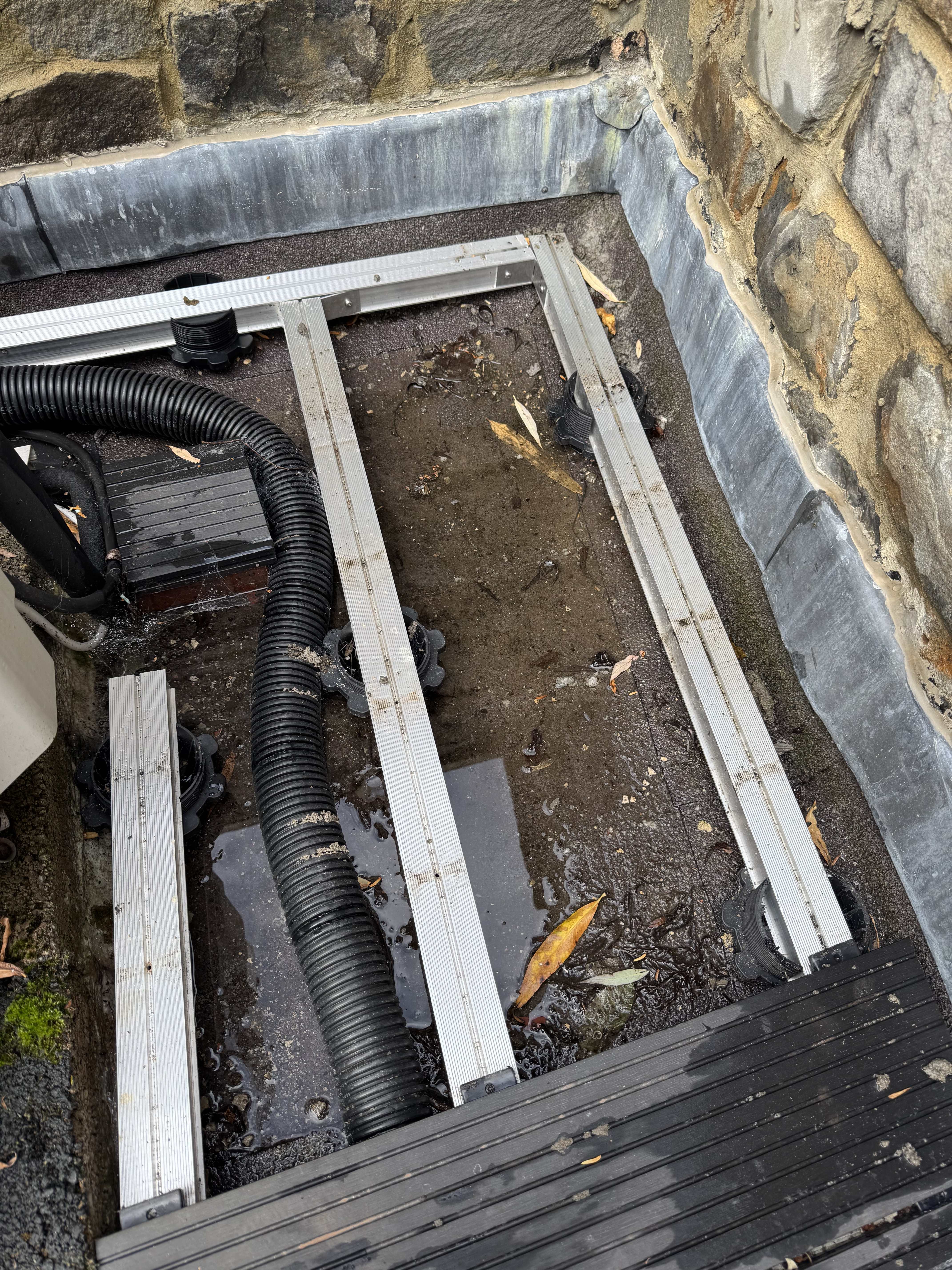

So it’s something around this corner .
Took up the decking . Nothing obvious . Those overlapping flashings filled with ct1 look fine . Next test once it’s dried up and leaking stopped to flood this corner but not up or over the flashing - just the actual roof .
Not sure what else to try .
42 minutes ago, Pocster said:
Not sure what else to try.
Moving?
2 minutes ago, DamonHD said:
Moving?
Ouch !
Took up more decking . Looks like the surface water does run round to that skylight . But it can’t be flooding around it . Also of course the leaks coming in under the roof not over the upstand . But it’s another possibility ( perhaps roof asphalt damage during installation of glazing ? ) .
Watched some flat roof leak finding videos . What I REALLY want is a method to make anywhere on the roof a water tight container around areas to isolate it .
For example if I took all the decking up around the skylight and put a 100% water holding barrier around it - that would be magic . But how ? . Can I use expanding foam on asphalt to build a retaining barrier ??? 🤔
Edited by Pocster
My best mate chatgpt says it’s ok to use to form a temporary holding perimeter. Any humans agree ??
