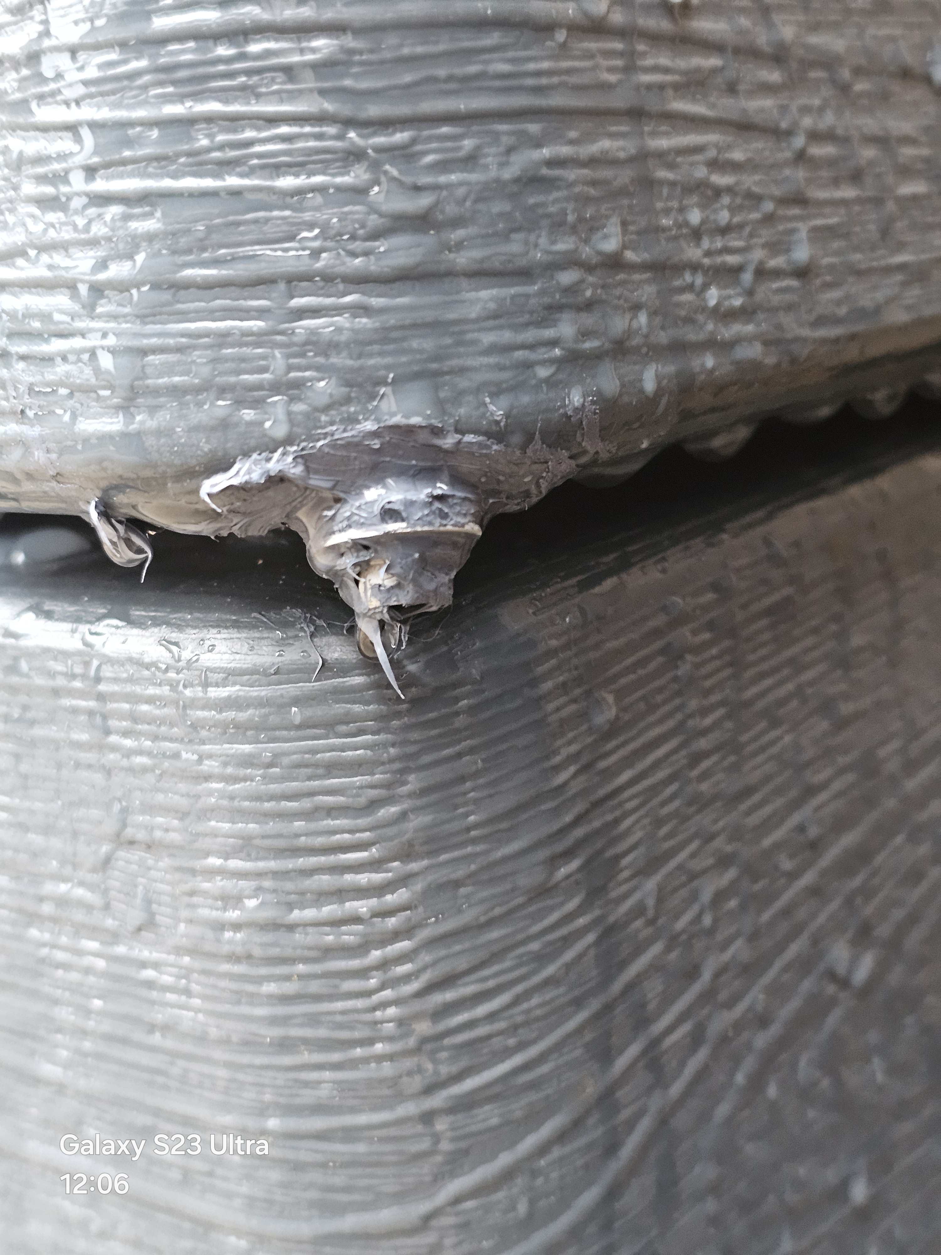

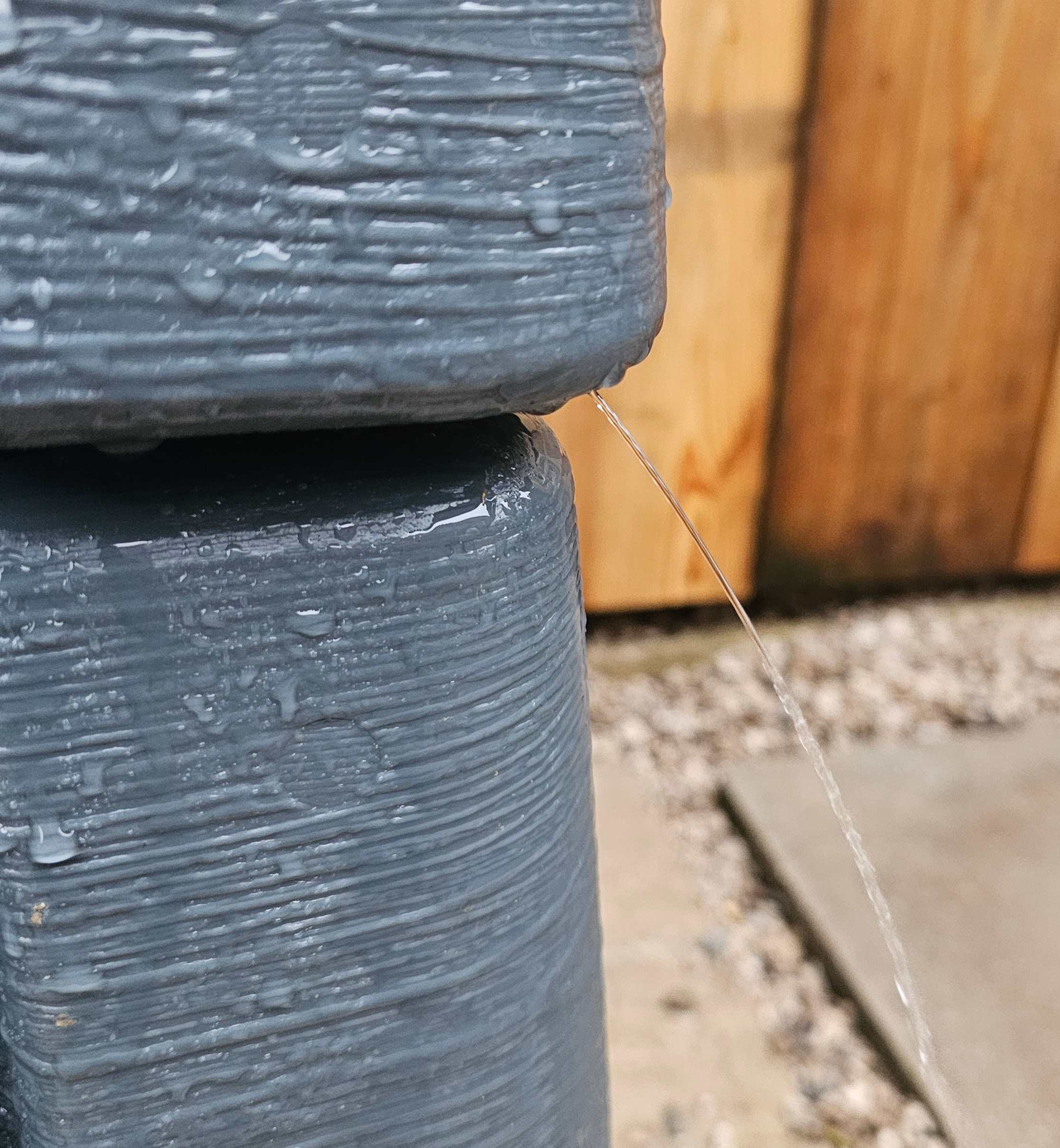

ToughButterCup Posted December 9, 2025 Posted December 9, 2025 Well since @Pocster has been brave enough to show me (us all) his : I feel brave enough to return the favour I installed a water butt - ostensibly for the wife, but actually for the Brownie Points. And its hacking it down this morning. She came in from outside giving me one of this wifely looks, and merely gestured at the water butt As yer man would say FFS 2
Pocster Posted December 9, 2025 Author Posted December 9, 2025 39 minutes ago, ToughButterCup said: Well since @Pocster has been brave enough to show me (us all) his : I feel brave enough to return the favour I installed a water butt - ostensibly for the wife, but actually for the Brownie Points. And its hacking it down this morning. She came in from outside giving me one of this wifely looks, and merely gestured at the water butt As yer man would say FFS It’s having a wee !
ToughButterCup Posted December 9, 2025 Posted December 9, 2025 2 hours ago, Pocster said: It’s having a wee ! So is our puppy. There's piddle everywhere 🤨
Onoff Posted December 9, 2025 Posted December 9, 2025 10 hours ago, ToughButterCup said: Well since @Pocster has been brave enough to show me (us all) his : I feel brave enough to return the favour I installed a water butt - ostensibly for the wife, but actually for the Brownie Points. And its hacking it down this morning. She came in from outside giving me one of this wifely looks, and merely gestured at the water butt As yer man would say FFS CT1 1
Pocster Posted December 10, 2025 Author Posted December 10, 2025 11 hours ago, Onoff said: CT1 Yeah @ToughButterCup should know this . CT1 and expanding foam fix 99% of all problems
SteamyTea Posted December 10, 2025 Posted December 10, 2025 On 08/12/2025 at 18:11, Pocster said: I need counselling No shit Sherlock. 1
ToughButterCup Posted December 14, 2025 Posted December 14, 2025 On 10/12/2025 at 08:28, Pocster said: Yeah @ToughButterCup should know this . CT1 and expanding foam fix 99% of all problems Yes, well it would have done fine, until a mate comes round, looks at the 'repair' and asks .... "Whassat ? " and pulls the CT1 plug out with his finger nail. "With mates like you who needs enemies? " So he repaired my repair with his repair . Roofing screw + CT 1 At least the CT1 is the same colour as the water butt.
Pocster Posted December 14, 2025 Author Posted December 14, 2025 5 hours ago, ToughButterCup said: Yes, well it would have done fine, until a mate comes round, looks at the 'repair' and asks .... "Whassat ? " and pulls the CT1 plug out with his finger nail. "With mates like you who needs enemies? " So he repaired my repair with his repair . Roofing screw + CT 1 At least the CT1 is the same colour as the water butt. Shame - bodge . I’d never do anything like that . Bet it’s leaking now ; go check ! 😉

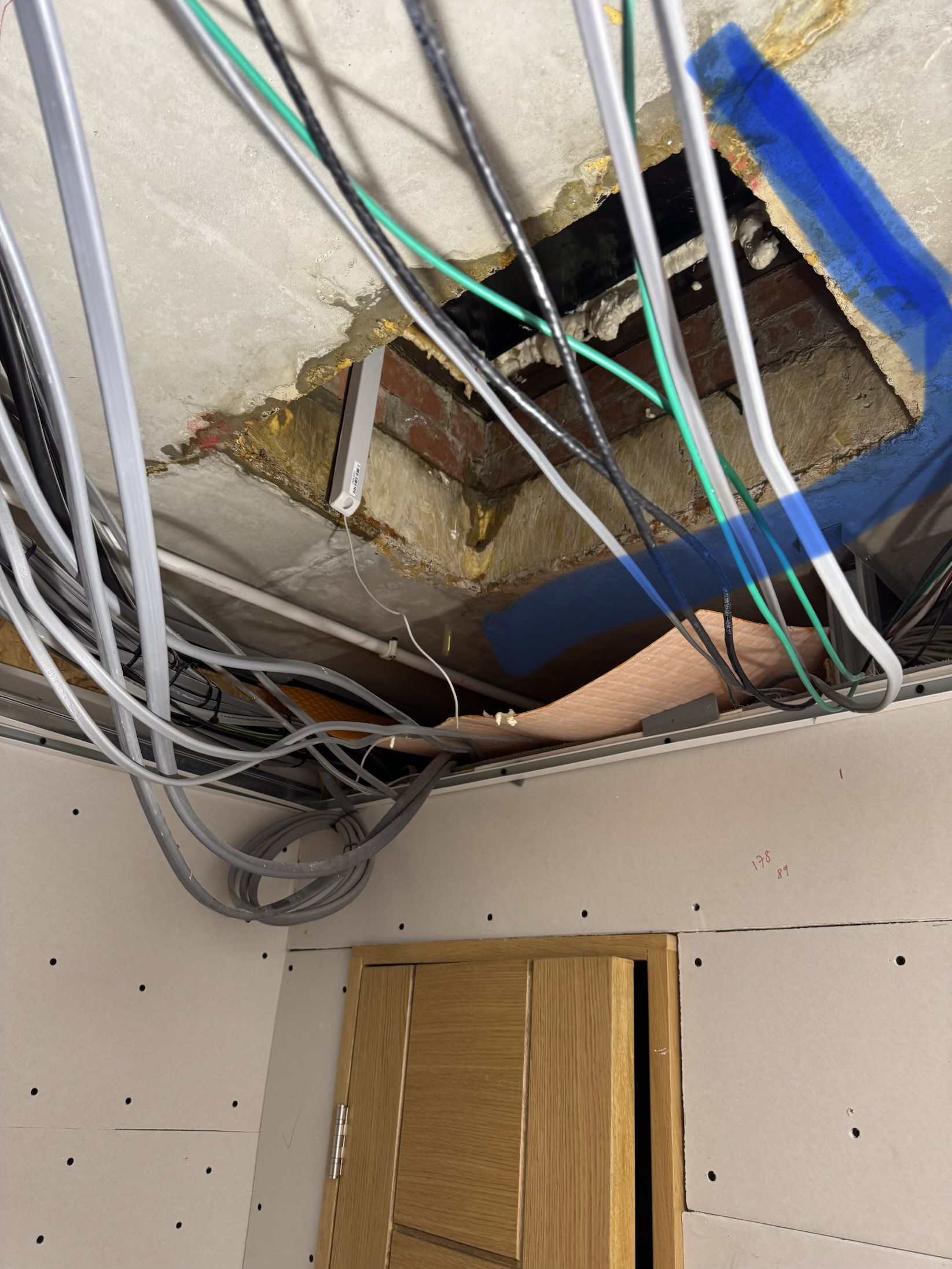

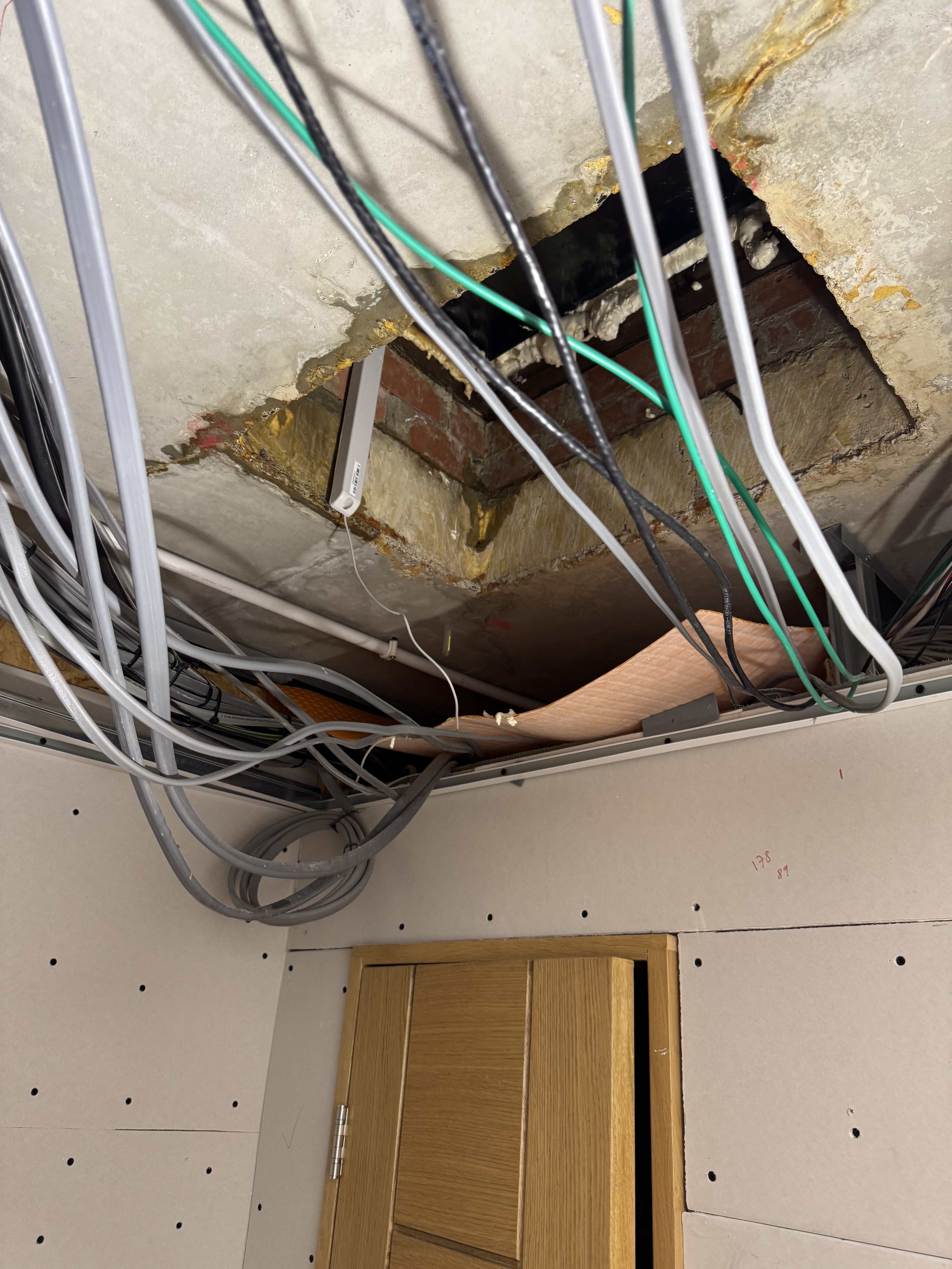

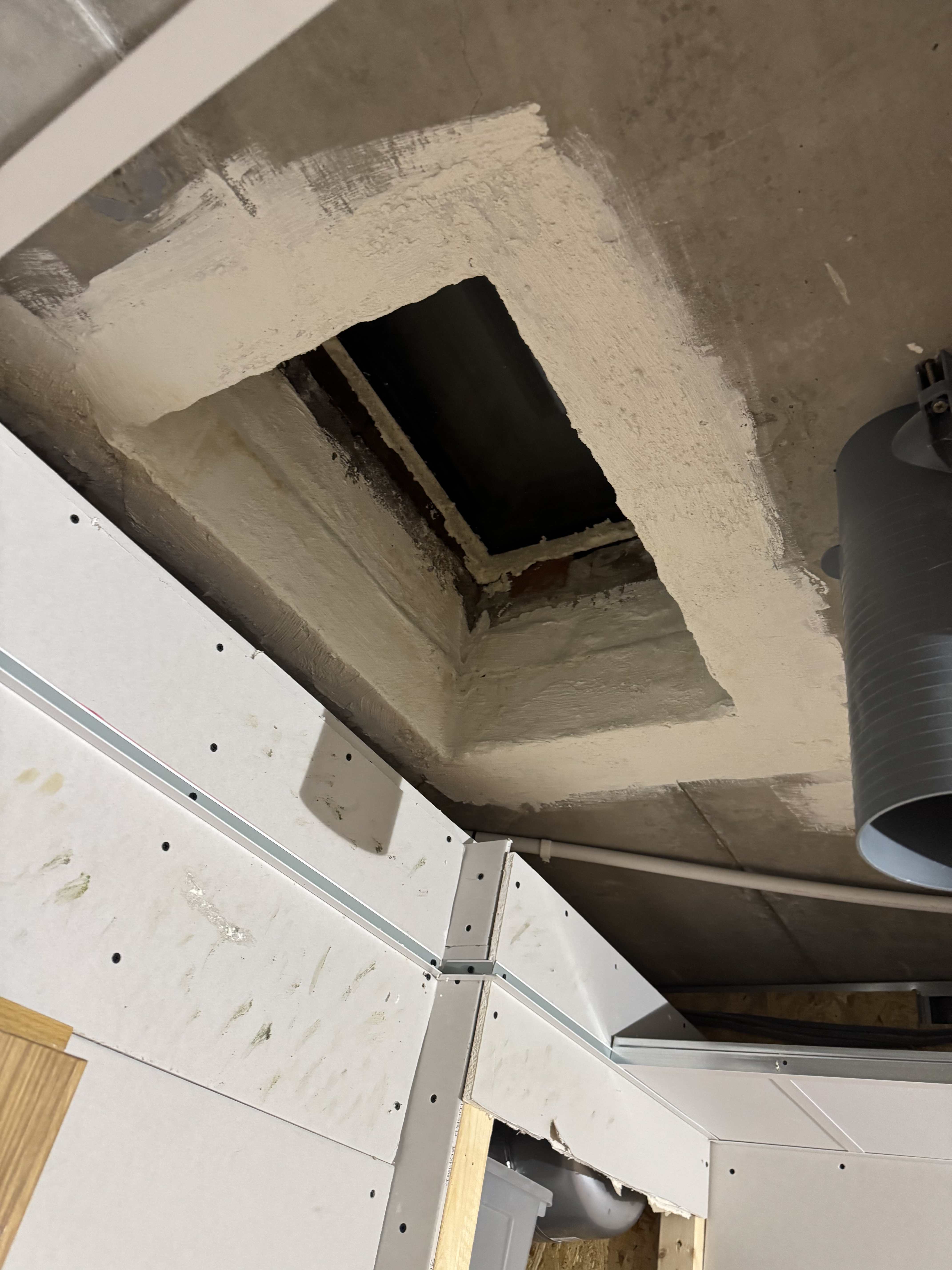

Pocster Posted Sunday at 17:46 Author Posted Sunday at 17:46 Right ! Been waiting for this ! First Lightwell - tanked , no leak . But I know waters still coming in . So today it finally pushed through to the 2nd deliberately untanked - and leaks . Sure I’ve got zero options but to tank this one and then the water is going wherever !!! . What worries me is it tracks then to the skylights in the kitchen . Or do I think like an optimist and think as it can’t get through the 1st and then can’t get through the 2nd it just runs off the edge of the slab …. 🫤
Pocster Posted Sunday at 18:12 Author Posted Sunday at 18:12 Hmmmm . What about I just tank along the blue sides ? . Forcing it forwards ? . Then some kind of gully taking it to the wall and lip into the wall waterproof membrane . Good plan ? Shite plan ? I prefer to control the water than seal its routes off and hope . Don’t want to post “ leaks moved to the kitchen ! “ 🫤🫤🫤
Onoff Posted Sunday at 19:48 Posted Sunday at 19:48 1 hour ago, Pocster said: leaks moved to the kitchen Fry in butter.....Mmmmm!
Pocster Posted Monday at 08:11 Author Posted Monday at 08:11 2am plan occurred to me . Tank around the edge of the opening to prevent tracking . Solvent weld pipe cut in half length ways to form a gully / apron . All round the edge ditra tiling mat then round the inside of the opening sitting in the gully . Pipe outlet from that into the wall membrane. What could go wrong !
ToughButterCup Posted Monday at 08:44 Posted Monday at 08:44 Oh bloody Hell, @Pocster . I feel genuinely sorry for you. There's something insistent about a leak isn't there. Every damn forecast is watched for -will-that-rain-make-my-leak-worse. Reeeely annoying. 14 hours ago, Pocster said: ... Or do I think like an optimist and think as it can’t get through the 1st and then can’t get through the 2nd it just runs off the edge of the slab …. Your idea appears to me to mean : - I could create a sump - But I know how it feels - if you can't see the leak, there's no leak...... As you say above, Quote I prefer to control the water [ than seal its routes off and hope] I prefer control too. Just reassure me would you (this thread is so long) have you tried leak tracing dye? (£10 from Screwy's) 1
Pocster Posted Monday at 09:40 Author Posted Monday at 09:40 54 minutes ago, ToughButterCup said: Oh bloody Hell, @Pocster . I feel genuinely sorry for you. There's something insistent about a leak isn't there. Every damn forecast is watched for -will-that-rain-make-my-leak-worse. Reeeely annoying. Your idea appears to me to mean : - I could create a sump - But I know how it feels - if you can't see the leak, there's no leak...... As you say above, I prefer control too. Just reassure me would you (this thread is so long) have you tried leak tracing dye? (£10 from Screwy's) lol . Yeah it’s coming in from outside the plot - impossible to pinpoint . I’m going to do my channel plan . This is the 1st leak in months - though there has been plenty of rain k er that time . It’s a management issue not a fix issue as tried that .
