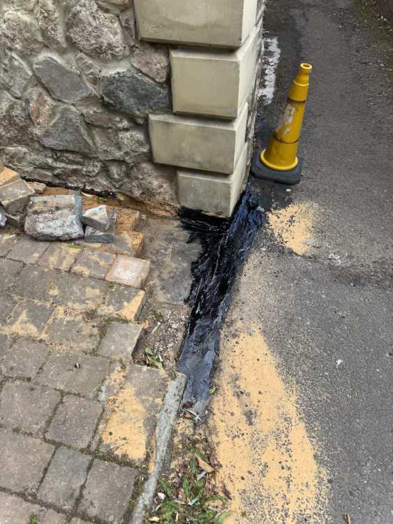

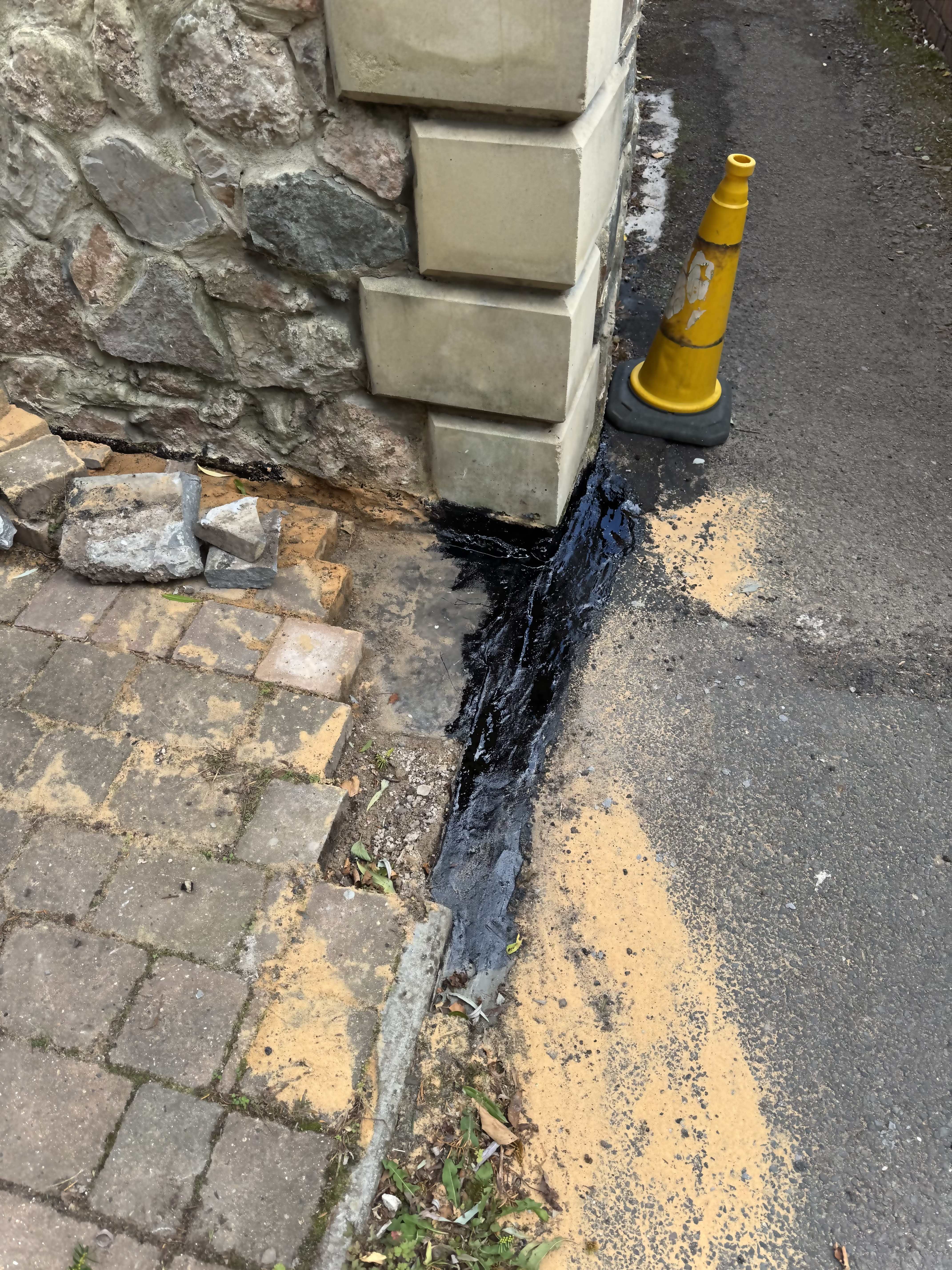

I still don’t get it . It’s pissed down for weeks everything was swimming in water zero leak from this front part . (expletive deleted)s me off

  • Plenty of rain last night for sure . Didn’t witness it . But bone dry 😀
  • Pocster
    Pocster
    Been hosing that corner like it’s the end of the world . Many times a day since Friday . Yet to reproduce any leak at all ! . Not 100% convinced yet but …… getting there ……

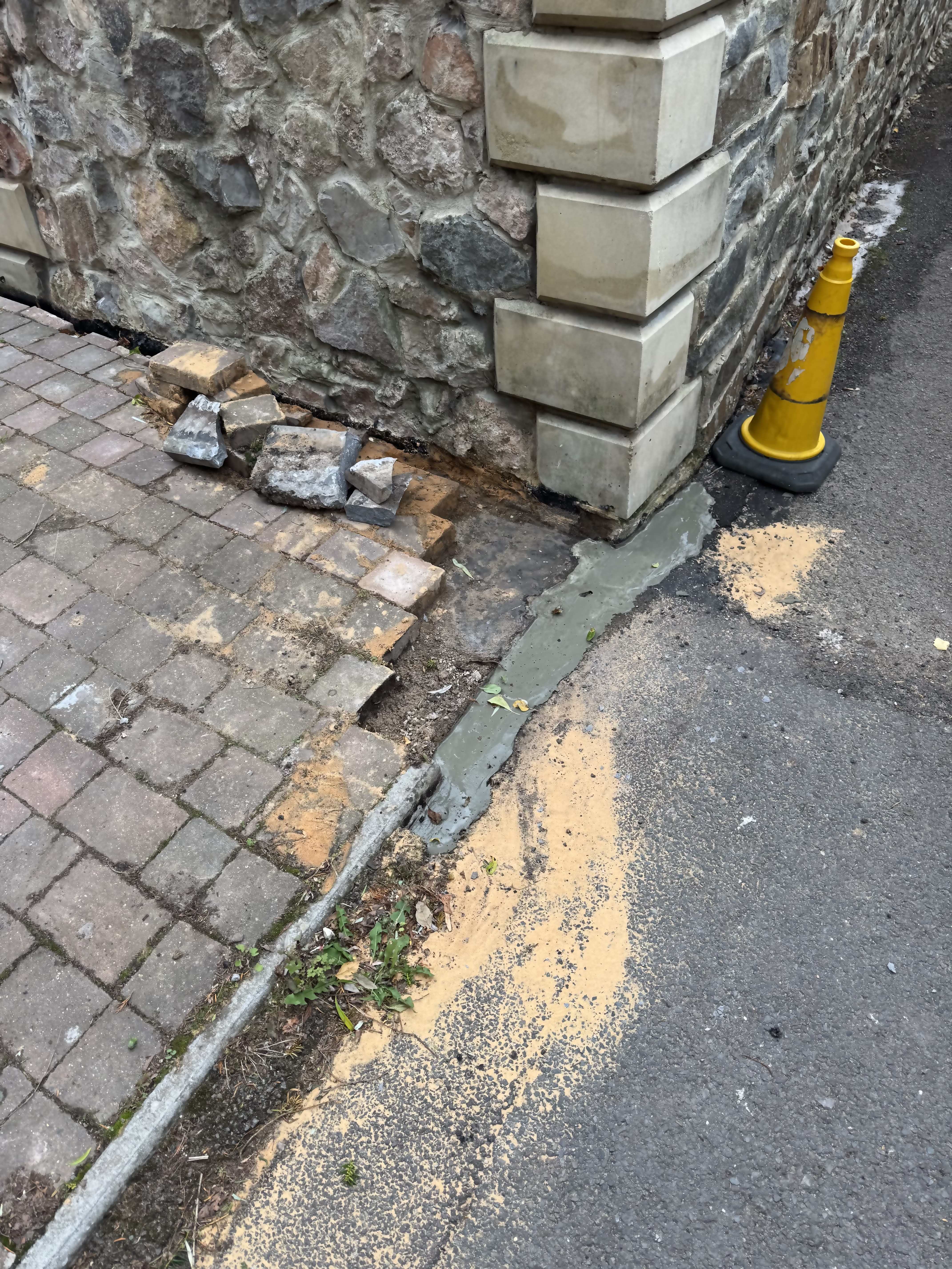

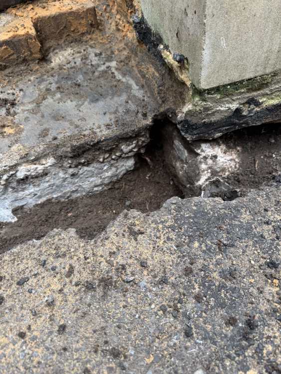

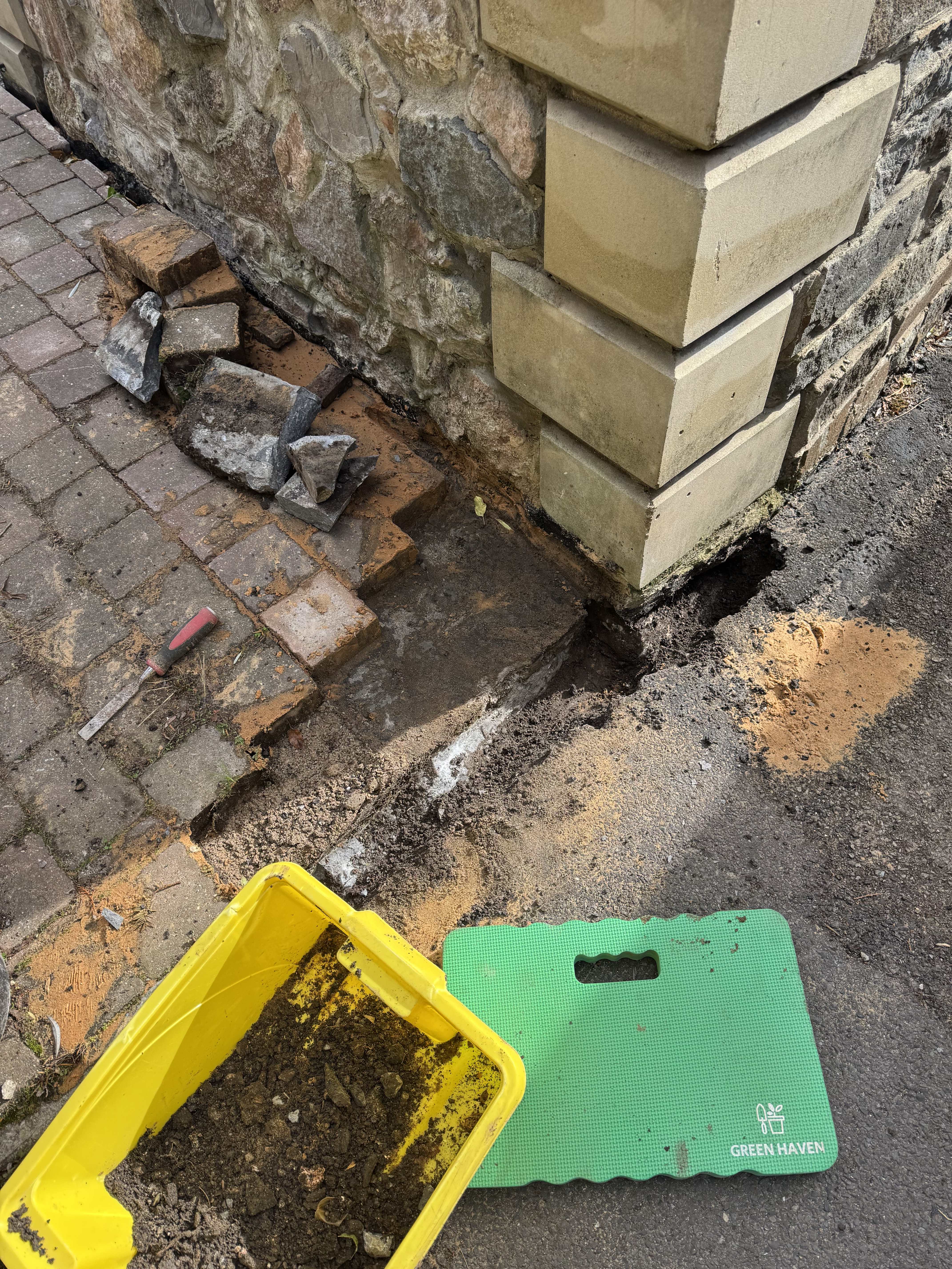

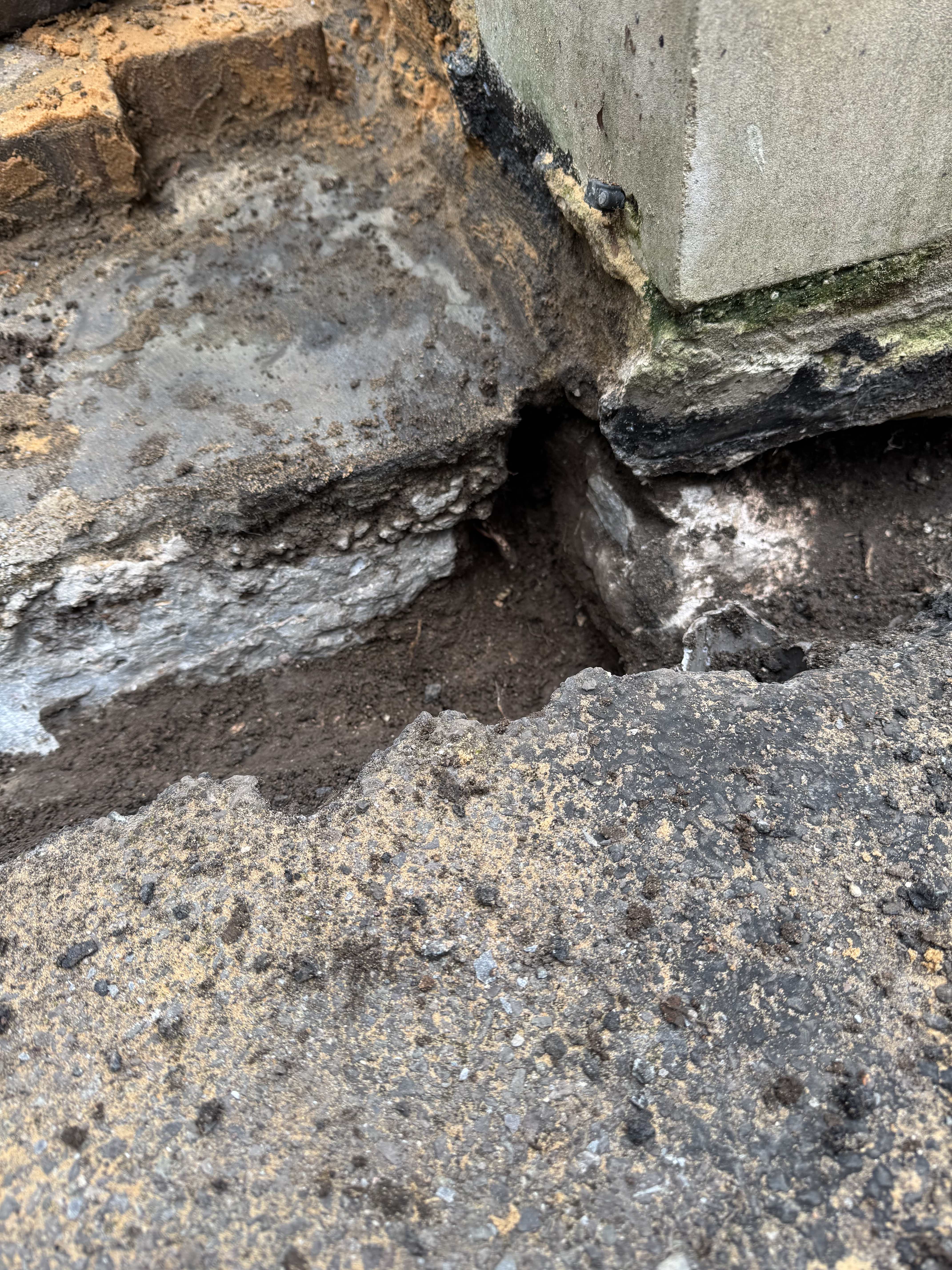

Dug out the end . Got my nice concrete / bitumen slab .
ground to right of quoin seems dry even as I dig down . Ground in front of quoin damp - so suggests waters still getting in . Going to tidy this up then concrete in the lot
Done . Be interesting to see what happens . I’ve deliberately took the kerb edging out so water can run off but also so I could get right under that corner
