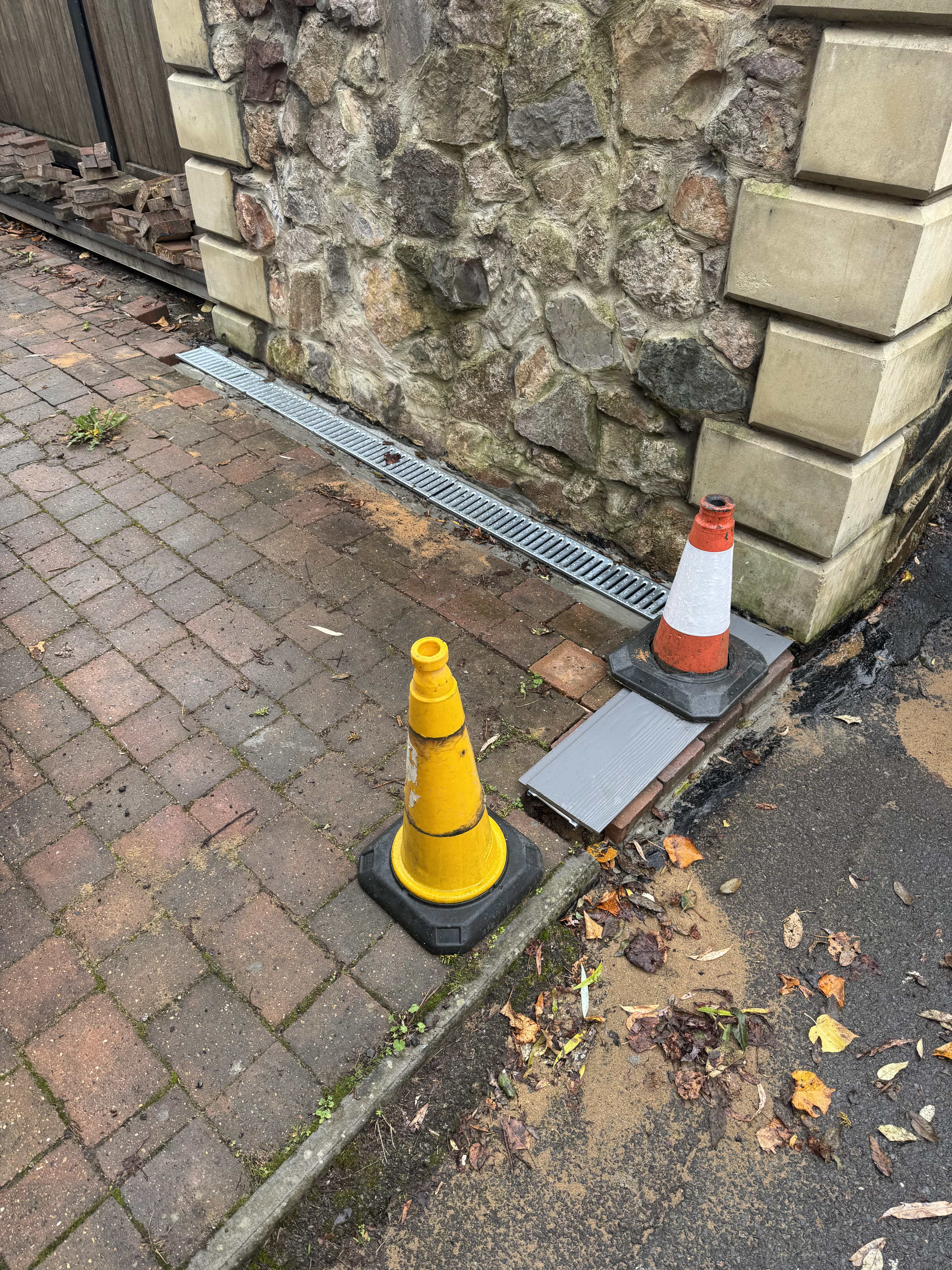

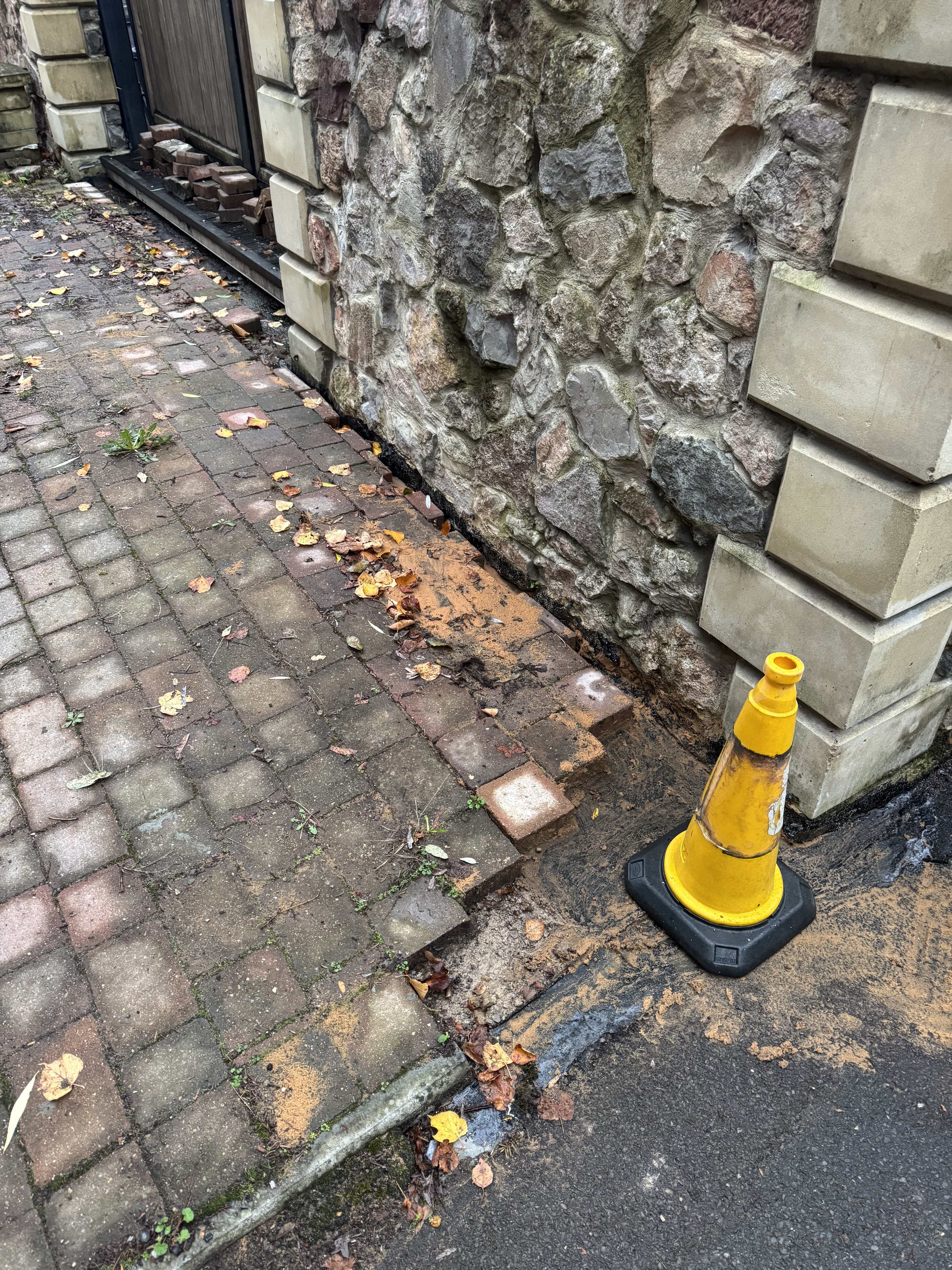

Noticed damp in the recess . Went outside to look . Only lite rain today . A neighbor ( aka wanker ) had placed some of the cobble stones back at the end presumably to stop the sand washing out . No idea when they did this - but clearly will cause a dam .So clearly still an issue ( can’t say if their block caused the issue but it doesn’t help me ) . Removed blocks and put cone out now ffs . So still an issue - what a bast !
Edited by Pocster
Where the cone is now nice toss pot basically put some of my pavers . Can’t possibly have sand on the lane ! Tosser !

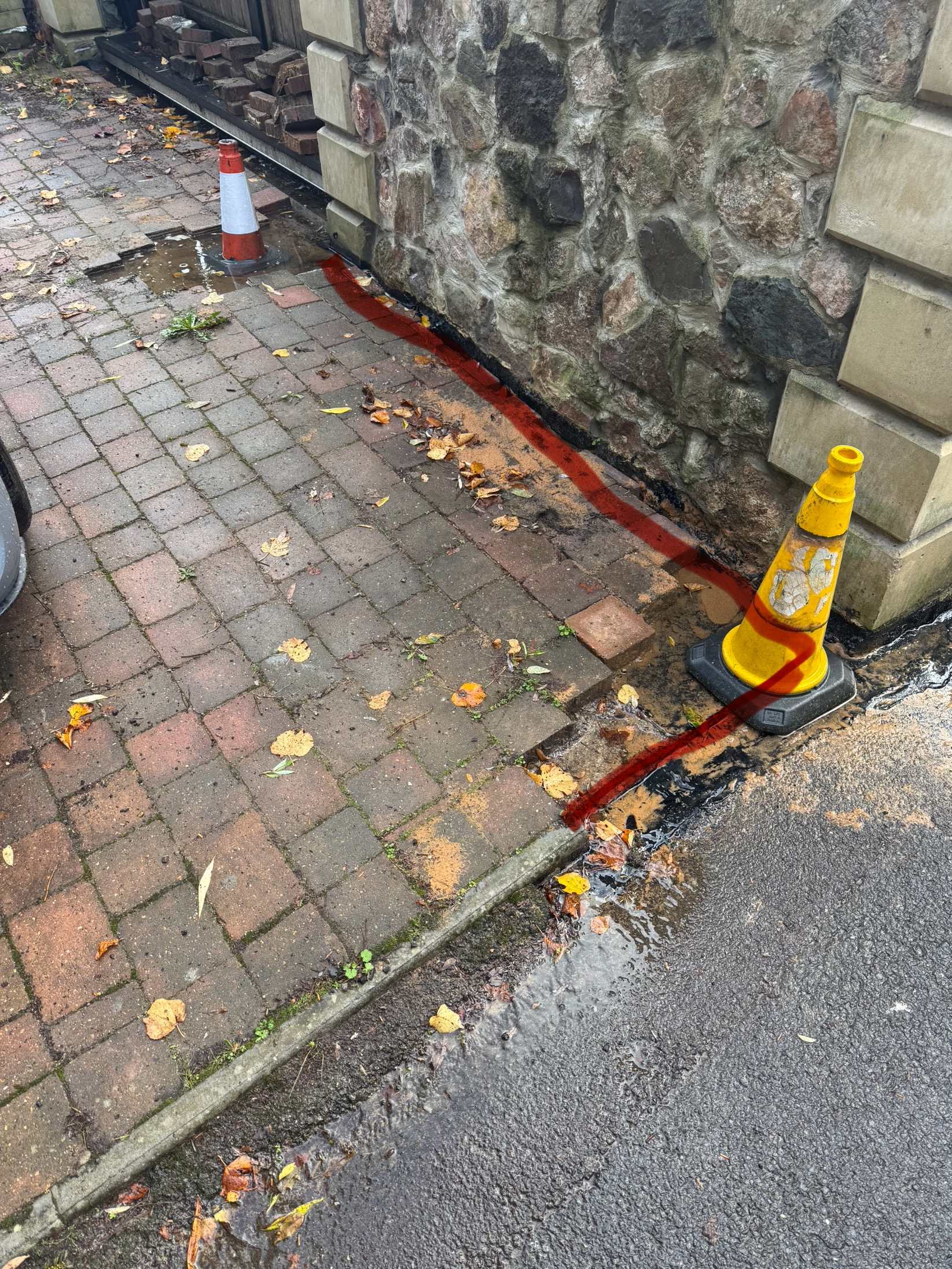

So a plan I had before I’m going to try . Remove blocks on this drawn section . So water can’t pool and run along the wall . A way for it to run off away from the wall .Remember with those 4 courses not in I had zero leaks ! . So it’s water running along the wall base and maybe down the lane the issue ….?
Edited by Pocster

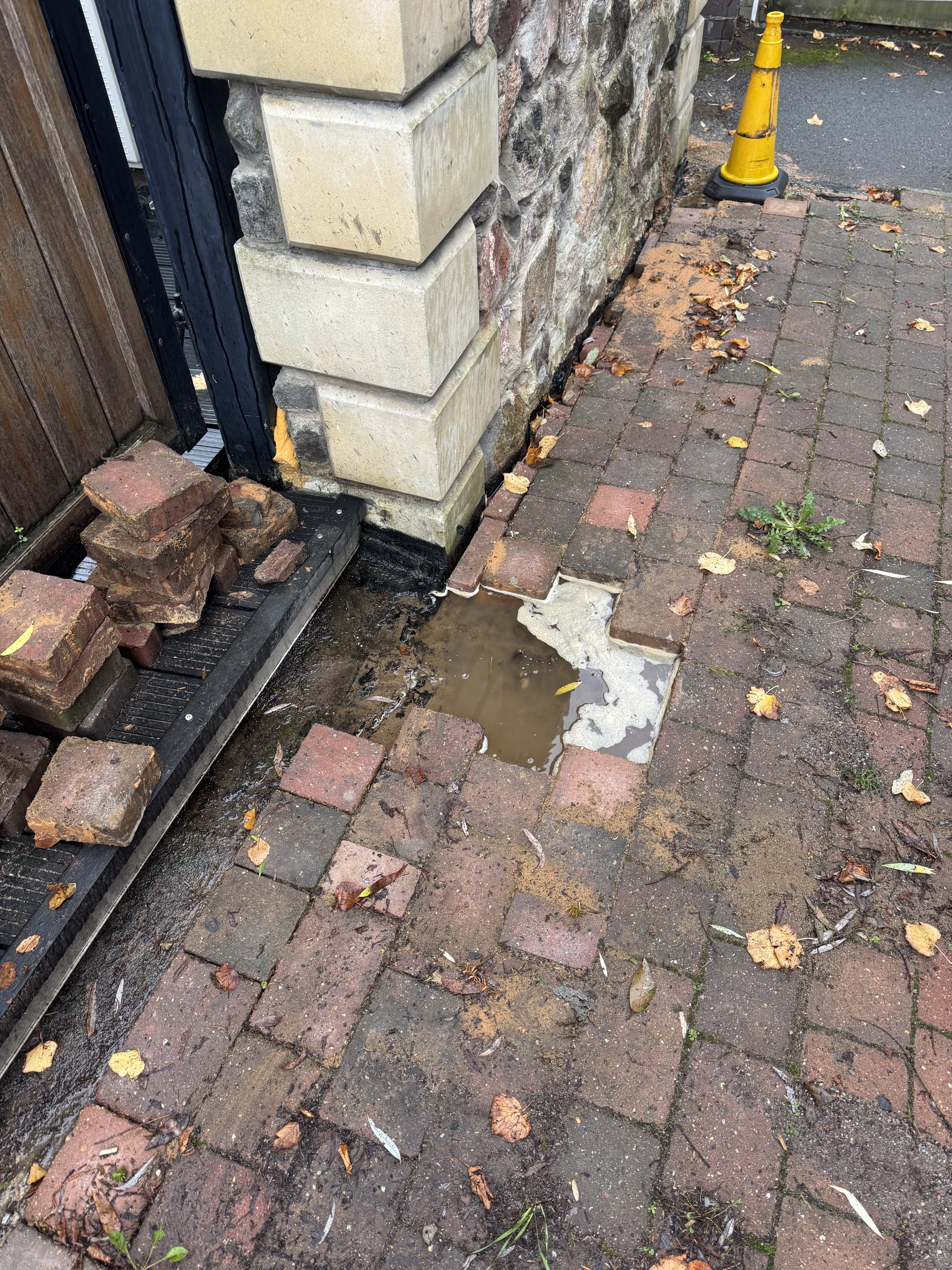

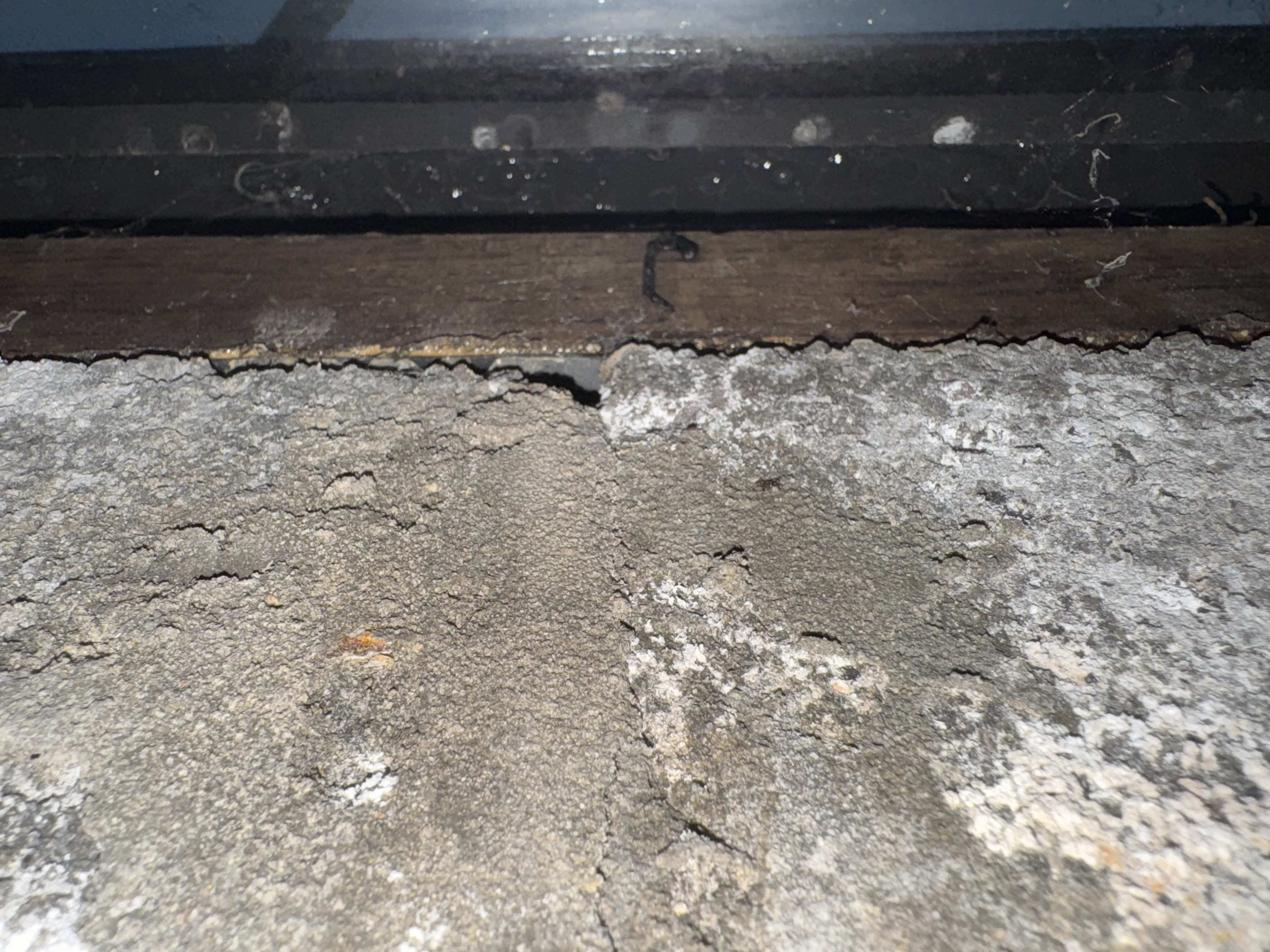

So to put it in context ! If you zoom in you can see the green is shiny I.e damp . Yeah I know it’s minimal - but it’s still there . I’ll try my plan out the front for a few months . I know some of you will say “ (expletive deleted) that just seal the concrete in the upstand “ - what concerns me is where the water goes if it can’t get through there …
Still like my idea of gallons and gallons of water proofing drowning the entire area, after a dry spell!! 😁
Took out those blocks so the main water escape route is forwards away from the build . Any idea what I could put here ? . A Clark’s drain type cover but with a grill ?
Edited by Pocster
Hmmm . I can’t take enough blocks out to get the water to fall away . What about an anco type drain here ? . The 90 at the end important as can get water to run away with the fall there rather than settling at the corner .
Good plan / bad plan ?
Yeah - I’ll try that . Too slow you lot ! 😊

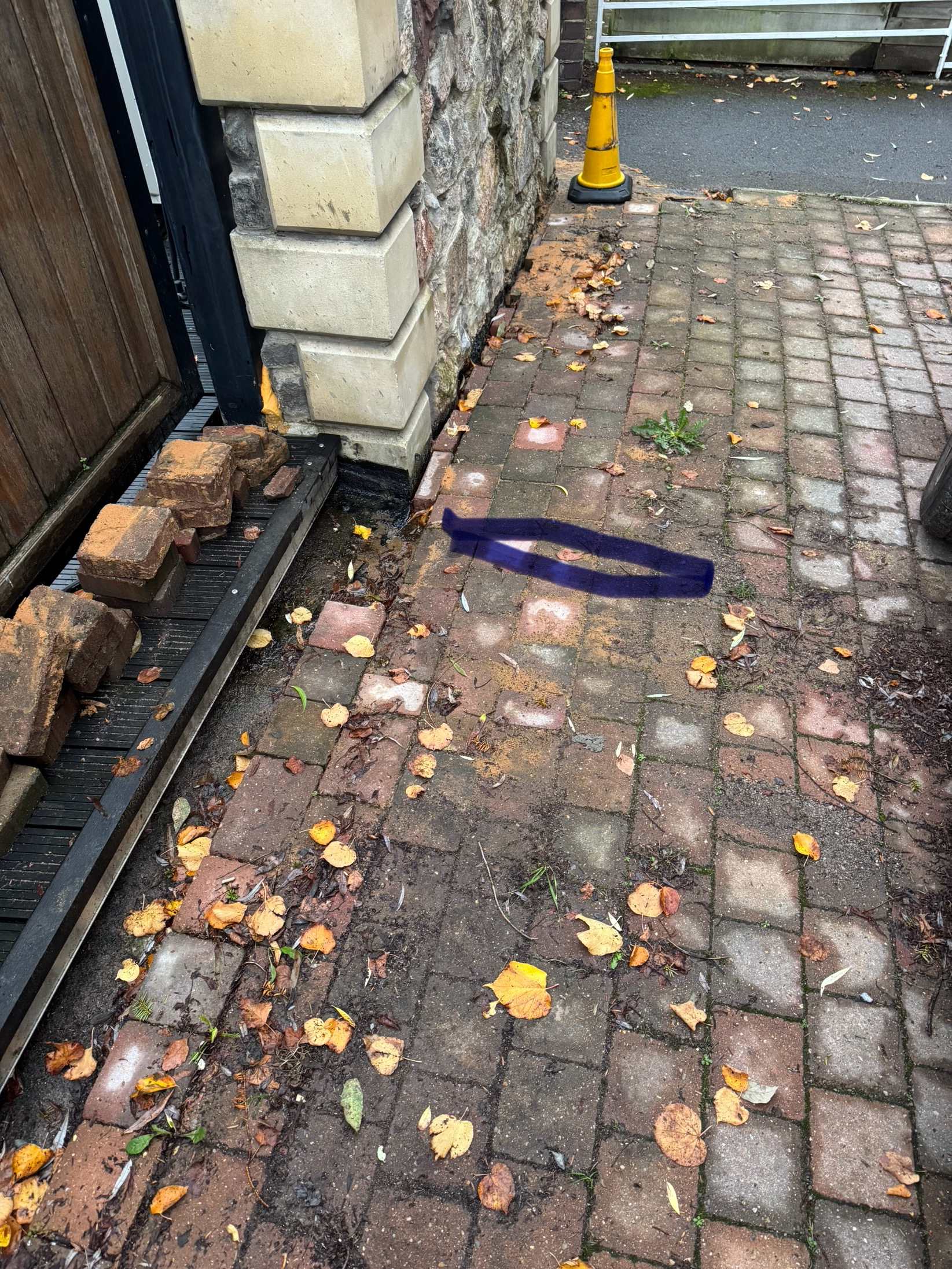

All done . Decking board just to protect cement from rain . If nothing else it will direct water away from property .
  • 2 weeks later...

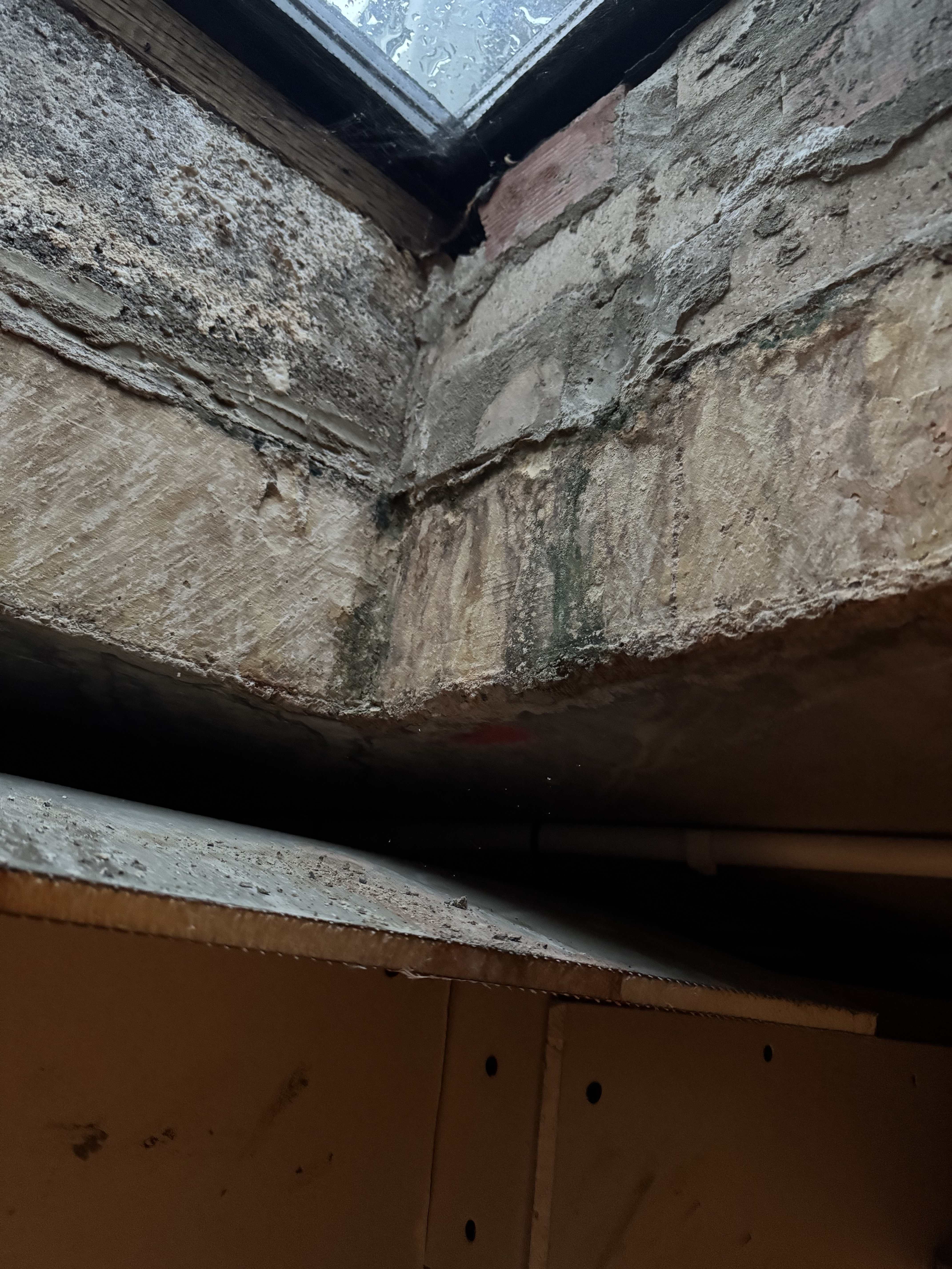

Lots of rain over the last few weeks . Most at night so I don’t “ count it “ . Wee’d down today . Went out to look at my low profile drain . Certainly doing its job ! - small river coming out the other end - draining away from the property . Still can ‘feel’ some moisture inside ( I think ! ) but zero water drops . Paranoia causes me to check the room with the leak a few times everyday…. 🤪
Only thing I notice is ‘ condensation ‘ on the inner part of the glazing frames .
Some cold bridging maybe? Make airtight & insulate?
Yeah that’s what I think . But , everything looks like leak 🙄
Might just foam the (expletive deleted) around there - effectively insulating…
Neatly cut and stick some insulated pb around the faces? You'd have to mitre the corners to ensure the insulation layer is continuous.
