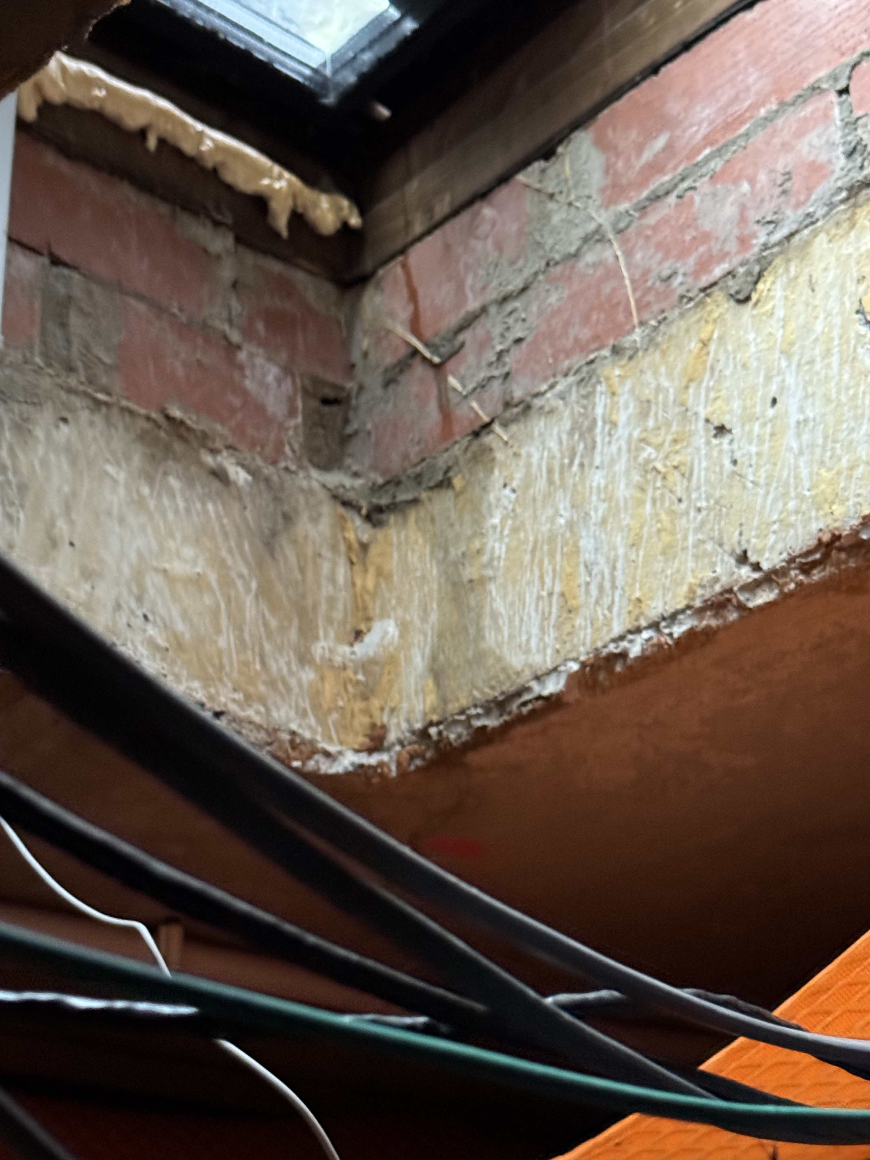

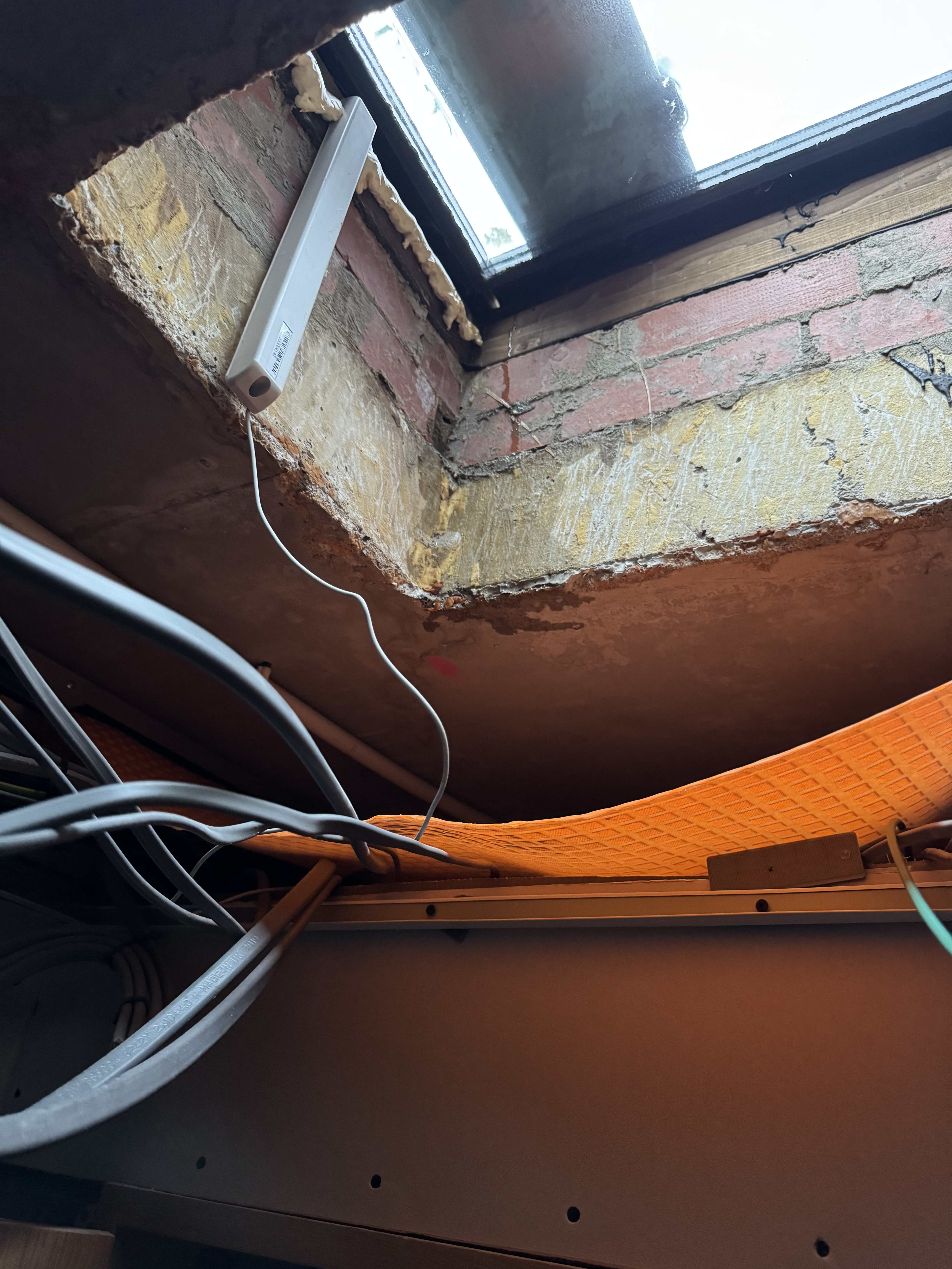

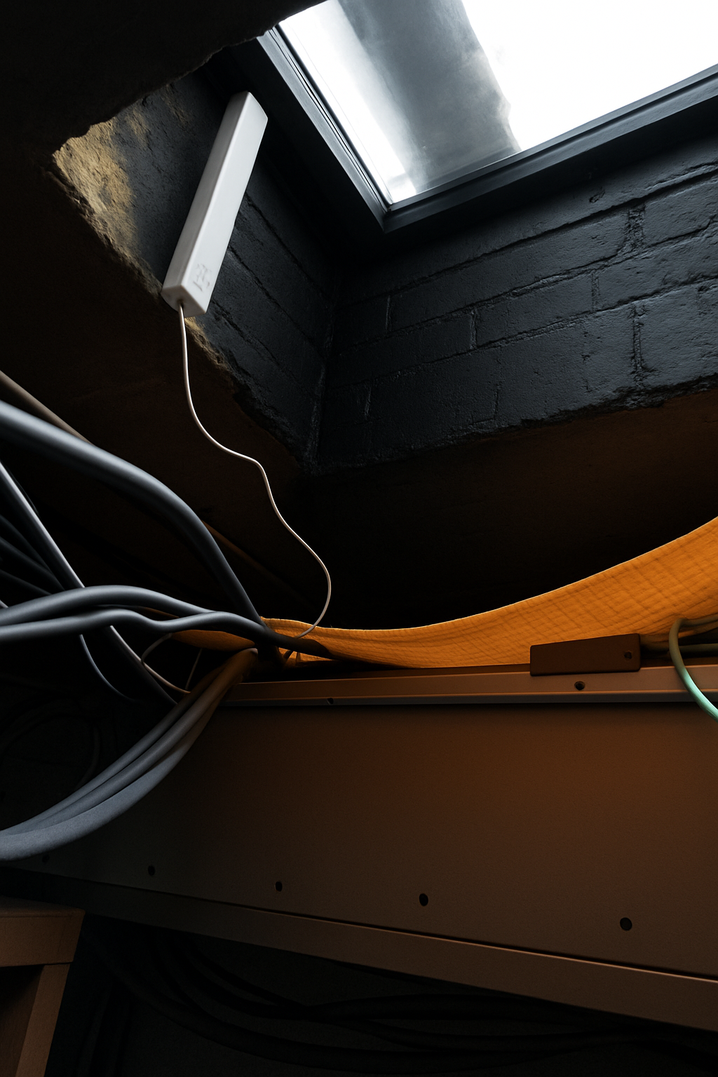

Storm just now . Pissed down biblical style . Gods final test for me .
We have good news and bad ….
Water running over the slab I.e the pig leak - seems good ; no leak.
Both front upstands leak . This are really low to the roof - not 30cm as recommended but like 3cm worst case .
But it’s over the upstands so the seal between roof and window frame . Best to take windows up and refit I think ; tons of structural silicone then smack ‘em down .
Clearly this job needs to wait until next summer 😊. SWMBO wanted this room beneath when all the leaks finished , but obviously that can’t happen . What’s another year of stalling !?

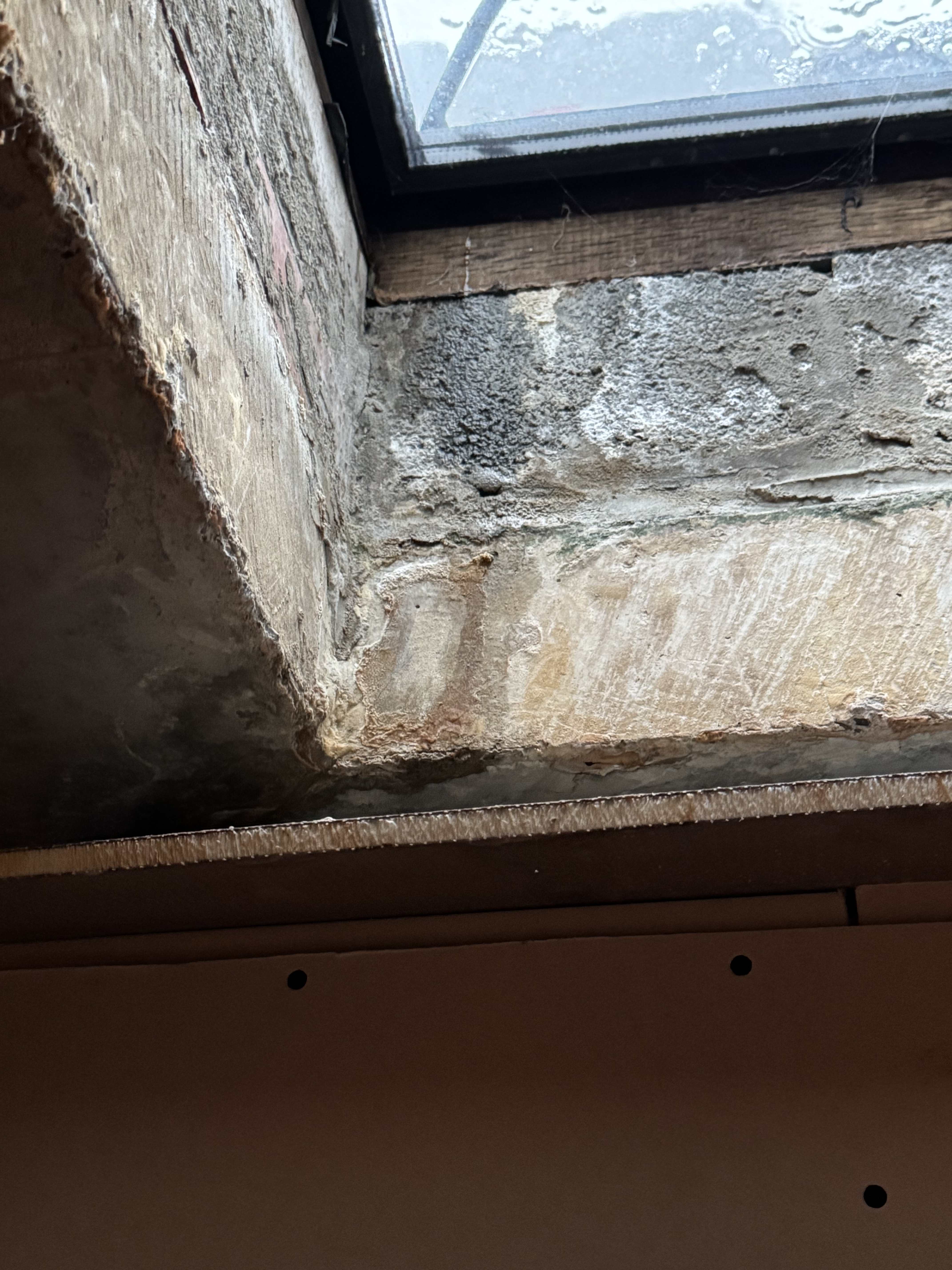

Posted (edited)
Strange isn’t it . Had a tiny leak here about 2 yrs ago over the upstand . Bit of expanding foam all golden . Suddenly today ….
Still could be worse !
That corner is lowest of them all . So I guess if any are going to leak from the tiniest of holes it would be this one . Rains probably right up to the glass externally ( I can’t see it as decking masks it ) .

Posted
18 hours ago, Onoff said:
Why not apply damp proof stuff to the inside faces?
Actually I like this idea more ! I.e less work !
So the upstands are a mix of timber and structural silicon at the top where the frame sits on . So I need something pretty thick and sticky to coat that with . Needs to get in all the gaps . What should I use ?
Posted
All joking aside, how about a wet room tanking kit? Tape the corners & between the different substrates then paint on the flexible tanking slurry.

Posted (edited)
4 minutes ago, SteamyTea said:
What do you mean by that?
Is silicon recommended by the glazing firm to bond glass to frame and frame to upstand . Think it was called ssg4000 ultra glaze  or something
Edited by Pocster
Posted
4 minutes ago, Pocster said:
ssg4000 ultra glaze
That is just an ordinary silicone sealant, it is the frame and glazing that are structural.
I suspect it is a high modulus sealant (don't move much in service), similar to what I used to stick the steam rooms together with.

Posted

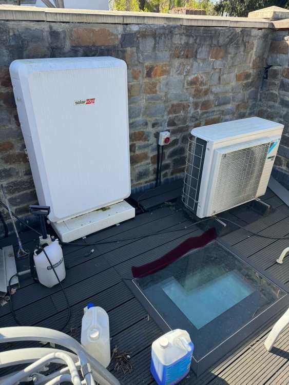

Decision made . Will take them out next summer . Bitumen paint asphalt joints around them . Structural silicone them back in . Delays the job by a year so that’s a win 👍
Posted

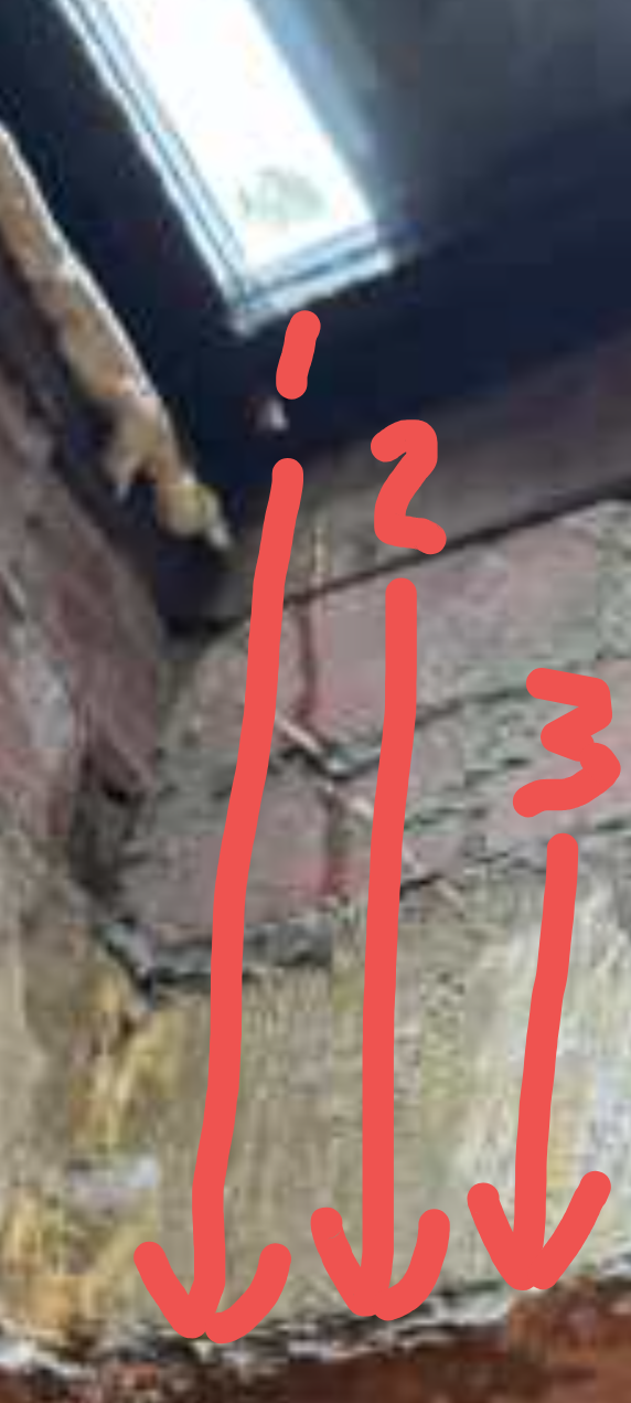

10 hours ago, Onoff said:
Where's it coming from again? Under the glass, top of the brick or top of the slab?
Not 1 or 2 - that was the original problem !!
So 3 directly where glazing frame sits on asphalt roof .
