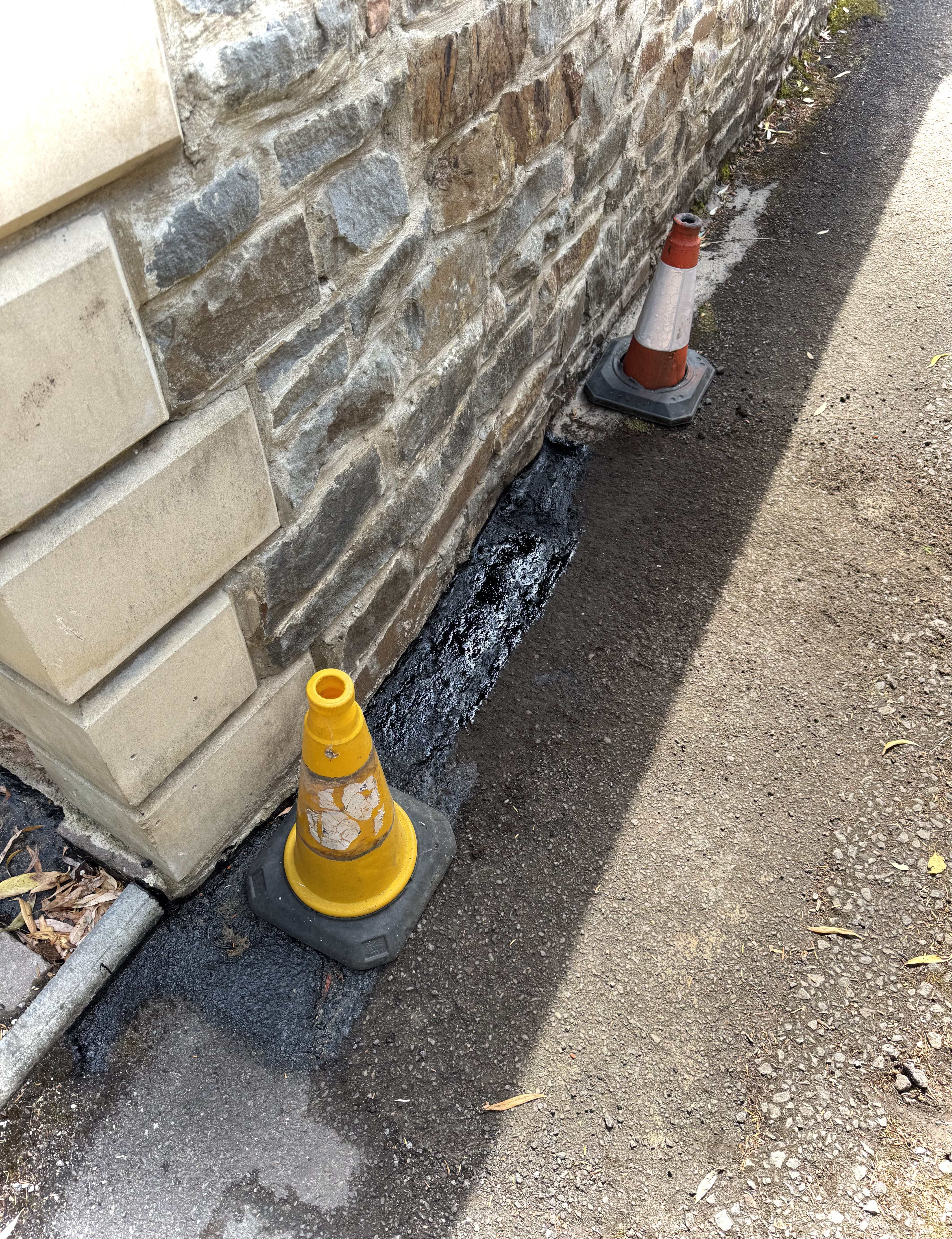

First proper rain for weeks . Still a slight leak .
So will bitumen paint a wider area of that corner outside
Bitumen paint, a friend to many of us in these situations!!
Yeah I could just blast a sq metre of the lane with it . But I really want to know the exact area . It was a fair bit of rain , some heavy , so a good test .

So bitumen’d along this bit . Did clear off the loose soil . But as I painted it on I created a depression as it pulled the loose stuff up . Will paint again later today . Tomorrow will stick a bit of cement in that depression though .
Also bought a larger tin - ready to paint the entire width of the lane if need be .
Won’t bother with anymore water tests as it’s incredibly difficult too make it leak but Mr. Rain seems very good at its job .

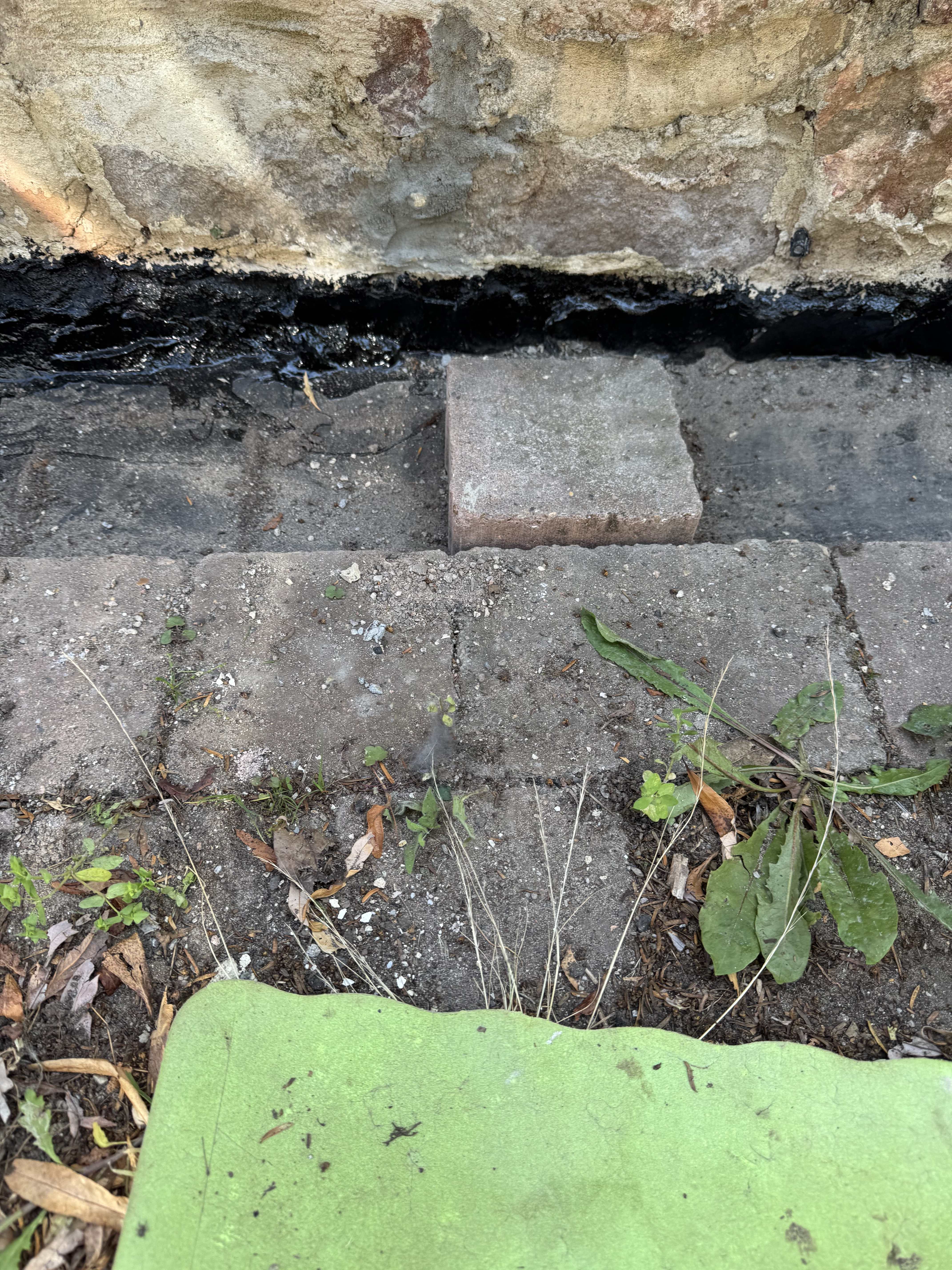

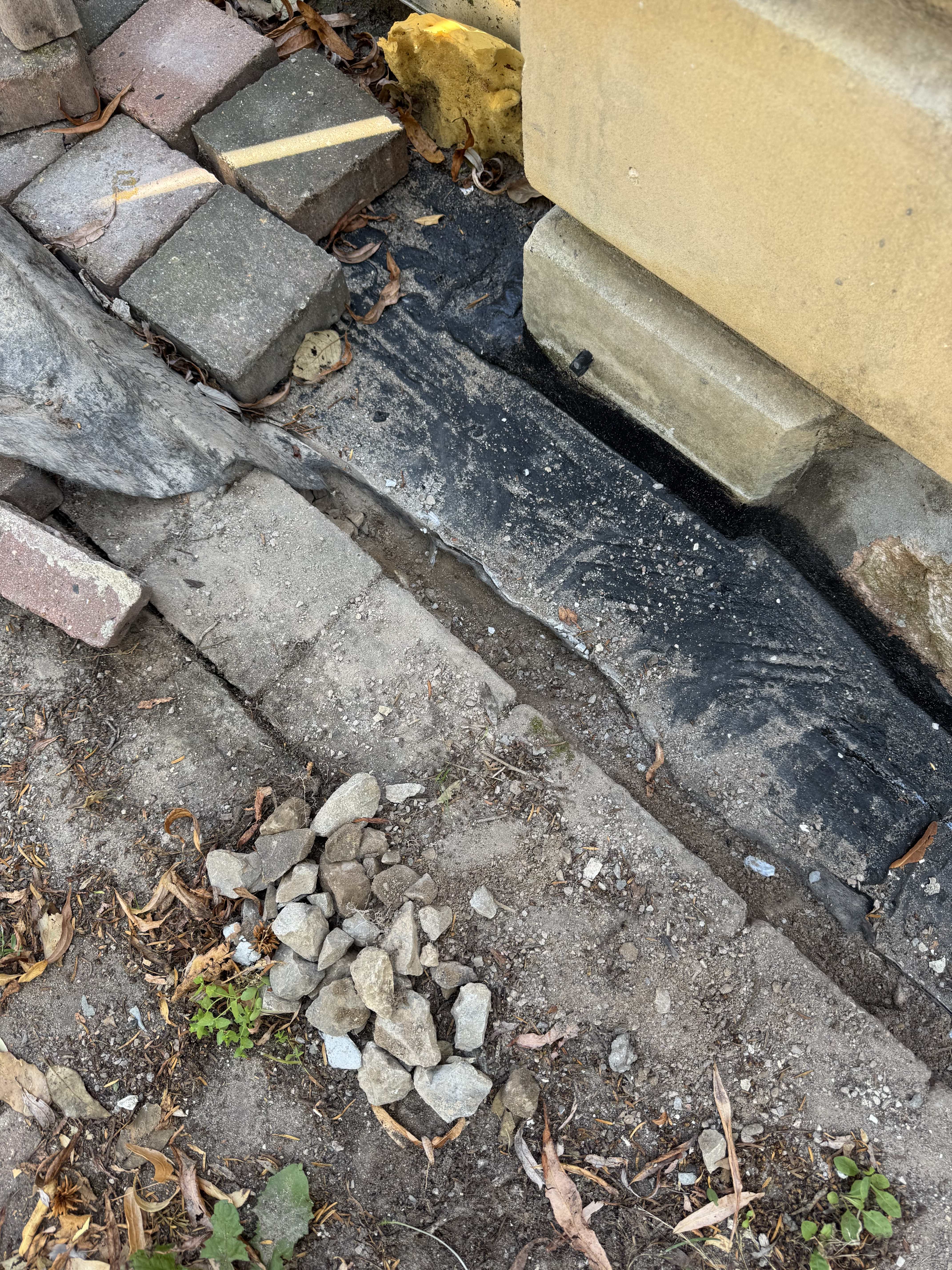

Even though it still leaks I decided to put back the block pavers .
Firstly they won’t fit I poured the concrete to high - not exactly thrilled about angle grinding them in half - any suggestions?
Secondly clearing crap out the way I still have mot type chippings and loose ground potentially where water could get in …
What to do ? . Remove another row of pavers ? ; concrete it ? - then fill with nice chippings ??
No idea of course if this is the place of water ingress .
Dig up rest of lane edge and bitumen paint ?
You decide reader !!

Trickle/ladel more of the black stuff to give you an extra couple of inches then relay blocks!
Ok boss

At 3am I had a new plan enter my head .
Got 2 300litre water butts out the front .
Connect a hose to one and attenuate the flow so it gently empties into that concrete section above the paving . But dead slow so doesn’t overspill to the left nor right ( the lane ) . This can continue over a period of time until all 300litres has emptied . A slow but consistent test
Edited by Pocster
What about waiting for the hottest, longest dry spell possible.... And pour several litres (and several litres more...) of clear water sealant/weather proofing type stuff over the entire suspect area. Absolutely drown it in the stuff, in the hope it trickles through all the tiny joints and soaks in.... Then sets?! Preventing water soaking through.
Nothing to lose, other then a £50 note!
