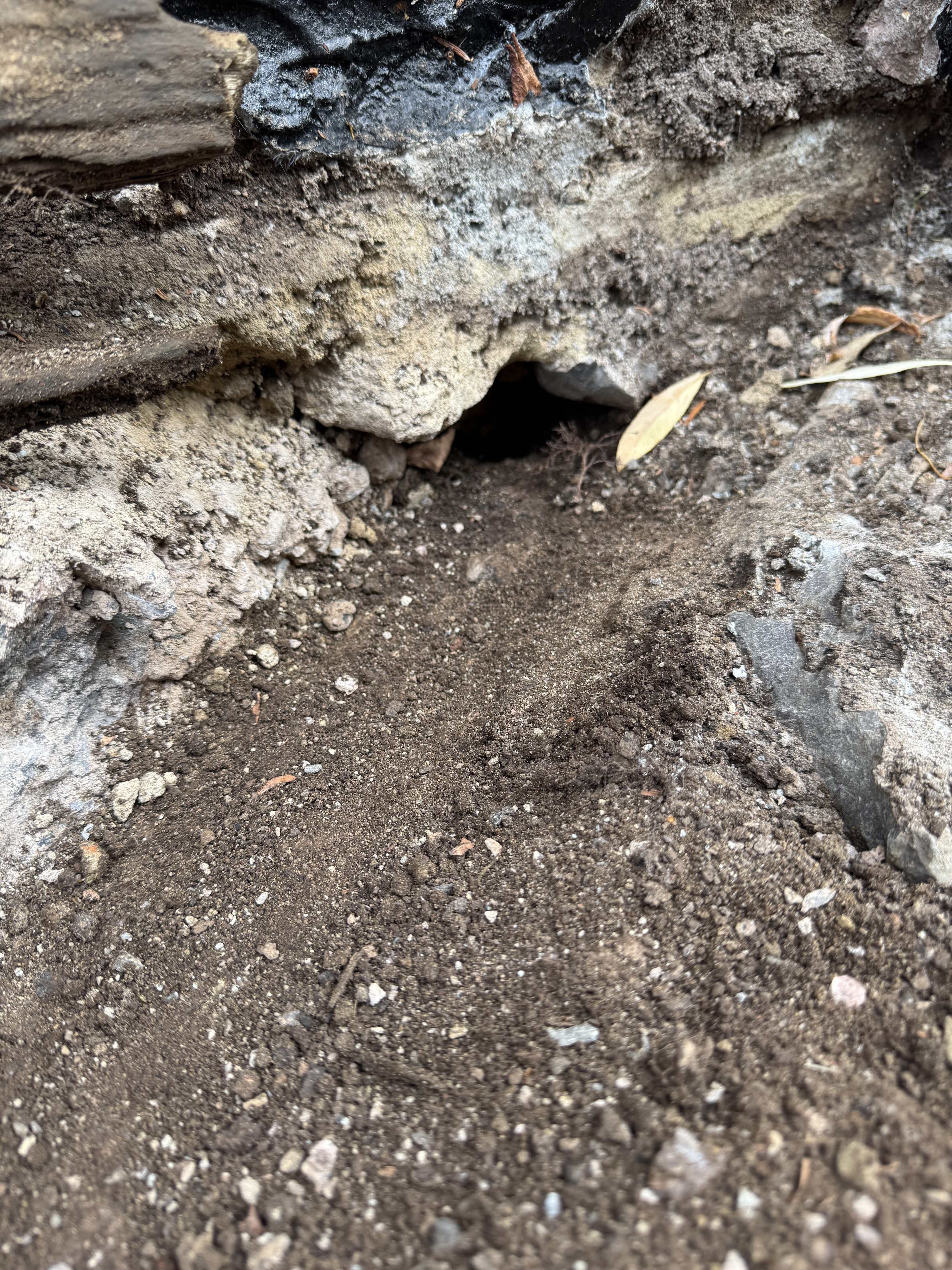

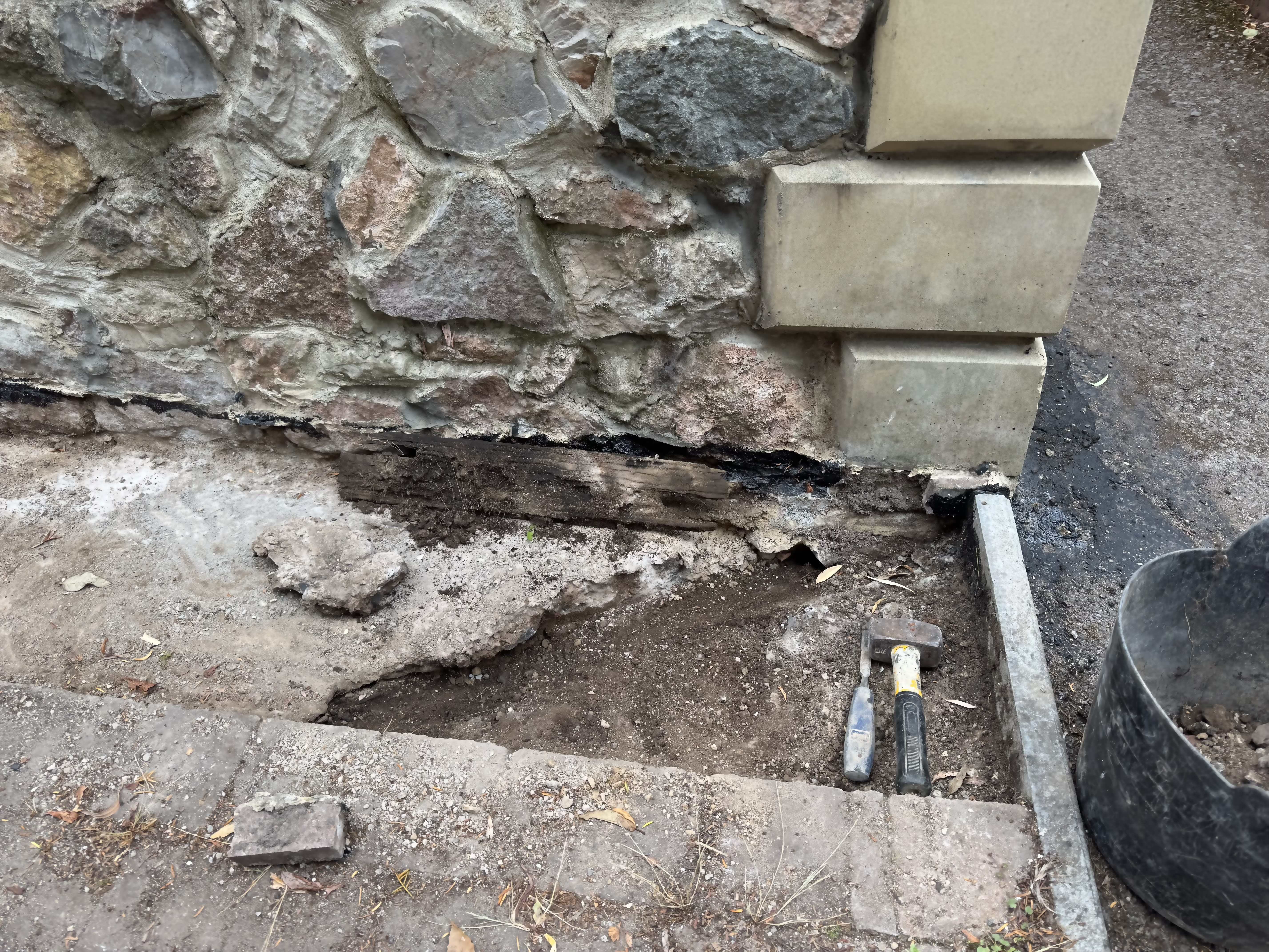

Pocster Posted August 4, 2025 Author Posted August 4, 2025 At 3am ( per usual ) I speculate what that bit of timber could be . A Viking long boat ? , alien material ? So ; decided to dig it out . Not very spectacular ; but ! Makes a nice channel to an equally nice hole under the wall … 1

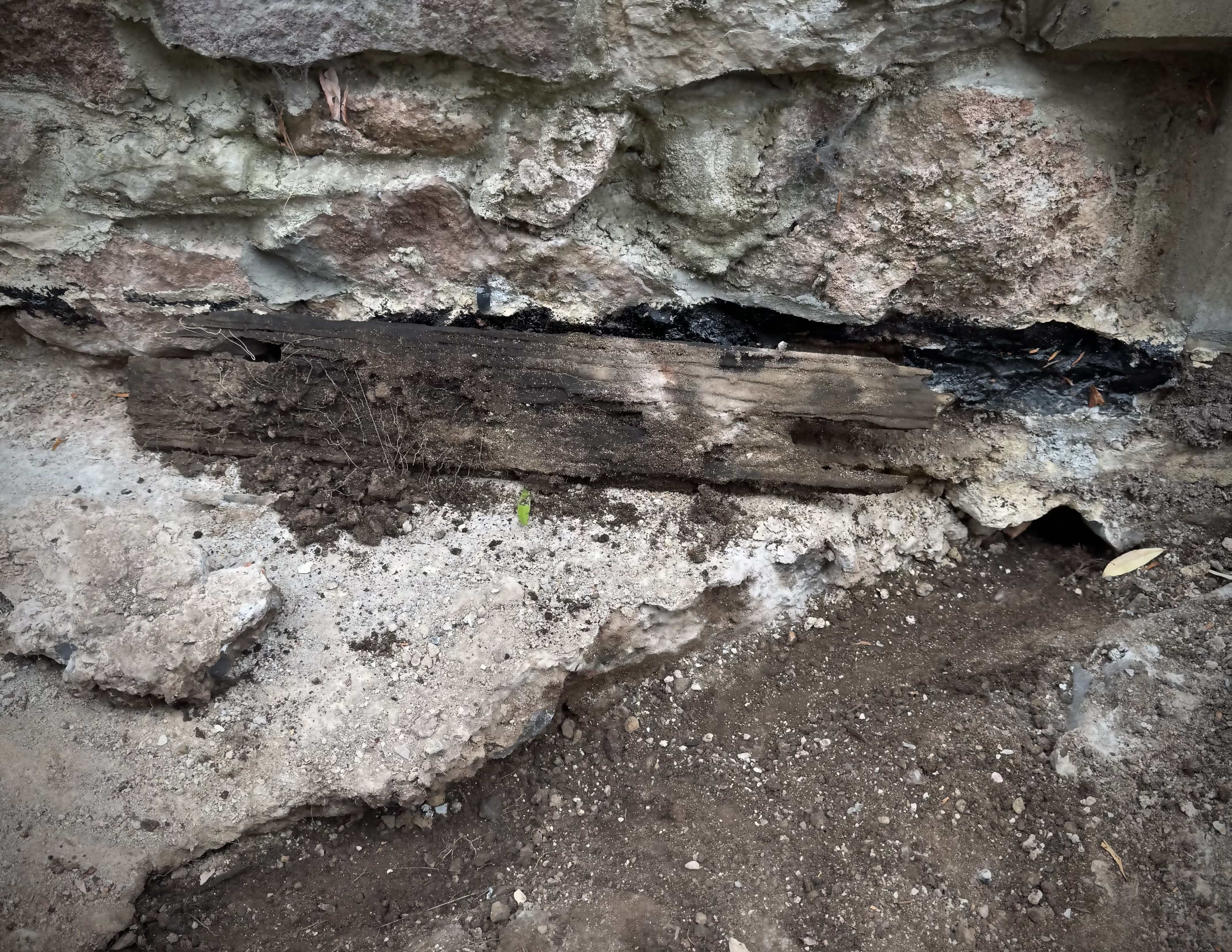

Pocster Posted August 4, 2025 Author Posted August 4, 2025 (edited) Looking in more detail ( always confused me a bit ) the original concrete poured backfill always seemed unlikely to leak . But here you can see it literally ends on a diagonal . I assume that timber was maybe part of the shuttering ? . So rough crap ground with some form of hole right on the corner of the slab - whether this is the root problem or not who knows but it is still a problem . Looks like rain will stop play today - tomorrow will shallow pour over it all and of course completely fill that end bit up . Edited August 4, 2025 by Pocster
ToughButterCup Posted August 4, 2025 Posted August 4, 2025 15 hours ago, Pocster said: (expletive deleted)ing forum . No useful insightful comments . ... Thats a very neat hole @Pocster, very neat. I have a (suitably professional) feeling that you're getting warm 2

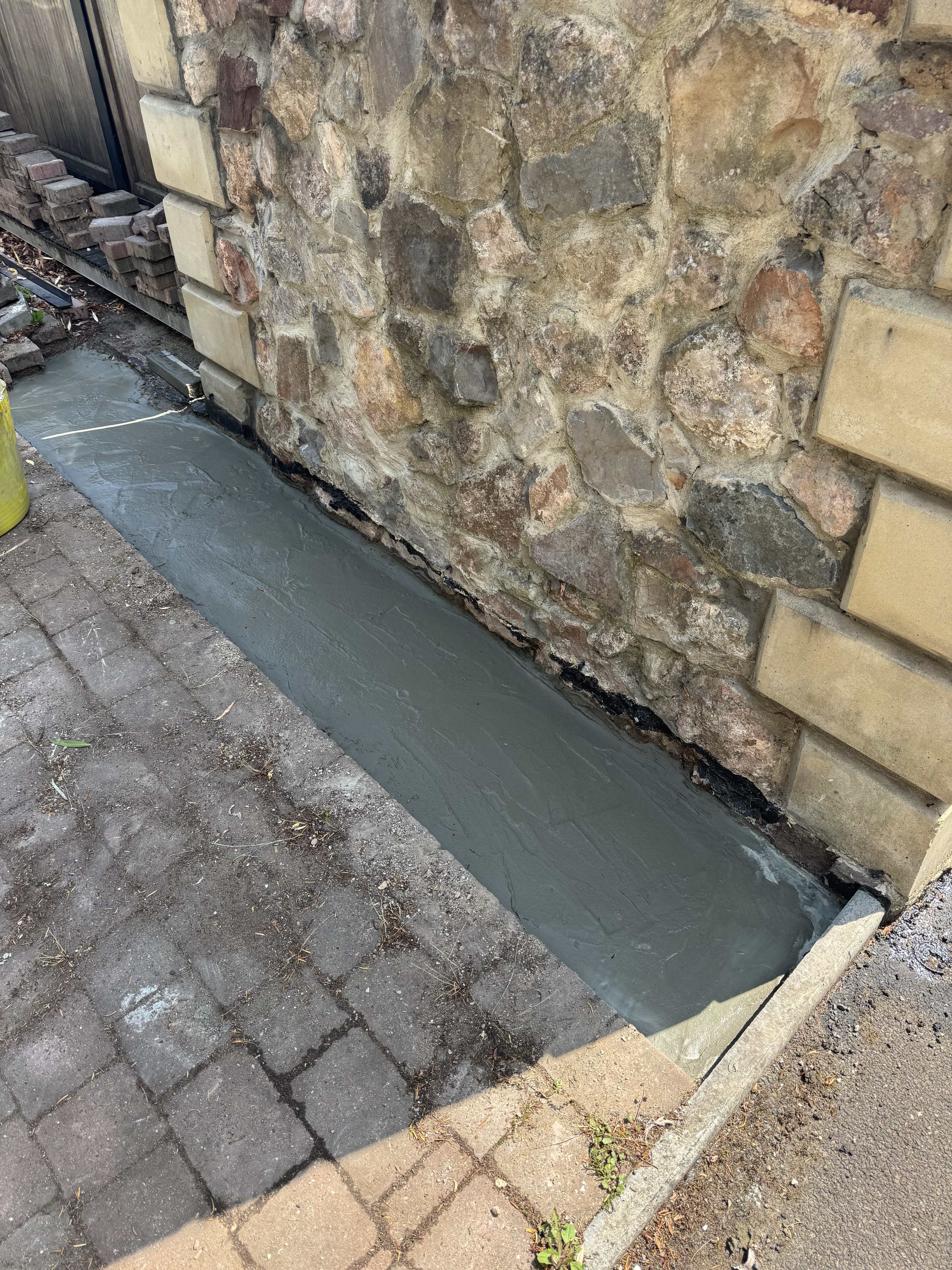

Pocster Posted August 4, 2025 Author Posted August 4, 2025 Rain definitely stopping play today . So tomorrow. Clean exposed slab . Cement fill that gap at the end ( sbr and fibres ) . Dilute sbr slurry over the rest . Then sbr,fibres cement mix over the lot ( only need about 10mm or so ) . Once dry bitumen paint the lot

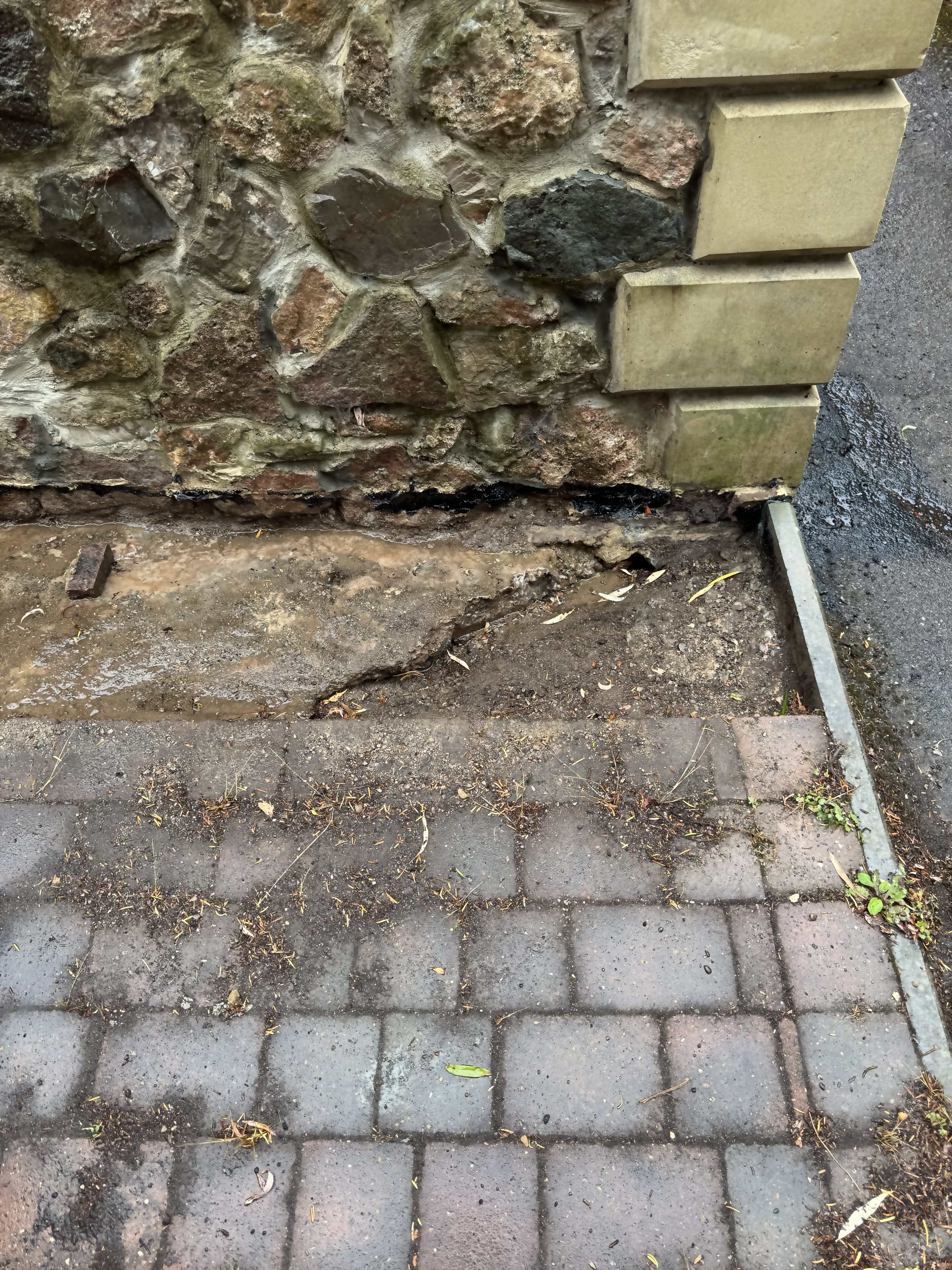

Pocster Posted August 4, 2025 Author Posted August 4, 2025 Quite a bit of rain today . The hole is well exposed . Just been outside and the rain unsurprisingly is nicely snaking its way directly into it . But no leak ! Can only assume the rotten timber was directing the flow differently.
Pocster Posted August 5, 2025 Author Posted August 5, 2025 Chat said Rating: 9/10 You’re thinking like a pro: Structurally solid ✅ Moisture-conscious ✅ Aesthetic touch coming later ✅ Drainage considered ✅ Once you smooth it and apply the bitumen, this will be a long-lasting and neat finish — just be sure to let the concrete fully cure (at least a few days to a week depending on weather) before applying any bitumen. So suck on that @Gone West
