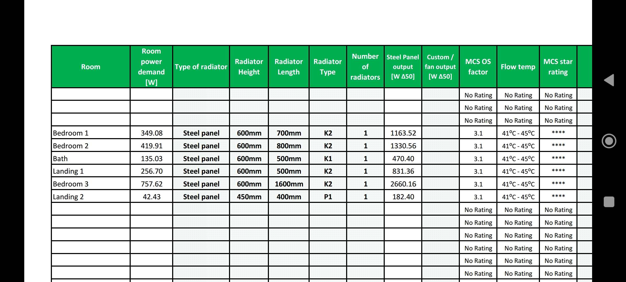

Hi, I'm building a new low energy house, now at ASHP planning stage. Installer's given me the design docs and main issue is insisting on radiators to get the 7.5k grant. I was expecting to have no rads, not even towel heaters in bathrooms as I don't like hot towels.
600 x 800mm on 1F bedrooms
600 x 1600mm(!) on 2F bedroom
Small one in bathroom (might insist in 2F ensuite too, late addition)
One each on 2 landings

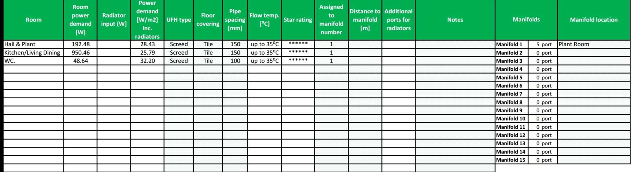

Floor temps
Wet UFH (GF only) up to 35C
DHW 55C
Rads 41-45C
1. I was told rads were needed but thought they'd be smaller, especially 2F bedroom. Do they have to be that big?
2. Are rads needed on landings? Only told about bedrooms.
3. Are the floor temps correct? I thought DHW could be lower, 50C or less. I think the UFH and rads sound about right.

Depending on heat loss, you can just do ground floor UFH, design so it will give off enough energy to heat whole house.

Am I right in thinking you are effectively having no heating in thr upstairs and relying on heat transferring from the ground floor and not having particularly warm bedrooms?
I think the issue be the MCS rules state you have to have sufficient heating in each room to meet that rooms heat loss and they also set a temp for bedrooms at the design temps (migbt be 21c, can't remember)
Those rads aren't that expensive (assume I assume k22's). Fit them then remove and cap off afterwards.  Alternatively spec a higher flow temp to get smaller rads, then run at the lower flow temp (just make sure your UFH is spec'd to run at the lower flow temps, which it should be)

I've already signed a contract but still within the 14 day cancellation period (lose £500 design fee).
The architect/designer is talking to installer, the email chain says the installer used MCS software that doesn't model heat flow between floors or rooms.

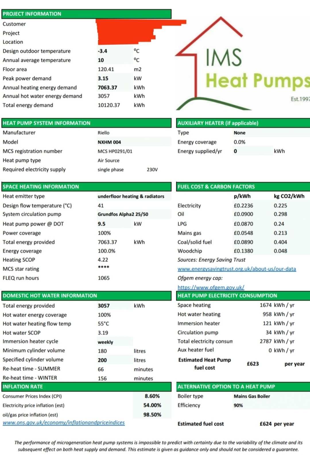

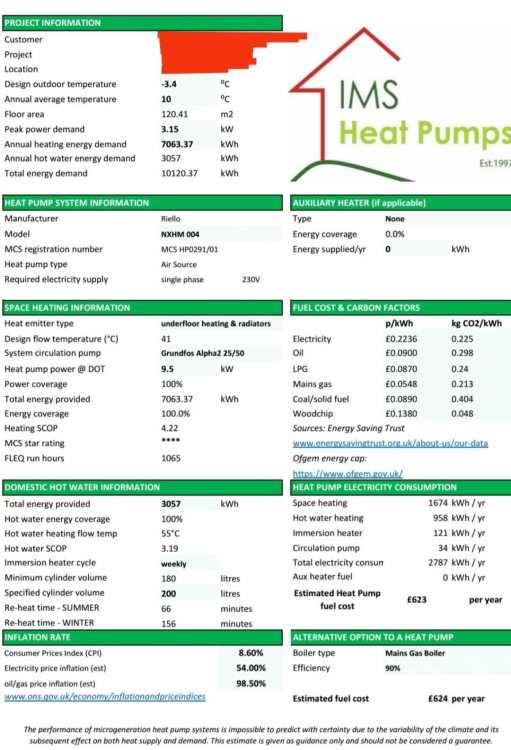

Why are they suggesting a 9.5kW heat pump for a 3kW house?
Unless 'peak power demand' means electrical power, but it cant, surely mean this.  There is no way a 120sq m recently built house is 9kW.  My house, 200sq m,  was built in the 1930s with a couple of modest 1980s extensions, only partial internal wall insulation (a minority of the walls are solid brick) and no floor insulation and its 7kW
I hope they arent putting in a buffer tank/LLH further to clobber your performance (but fear they may be)

25W per sq m is very generous for a house like this. You will save more than the lost £500 design fee by finding someone who will put in a smaller HP than a 9.5 kW Riello.

17 minutes ago, YorkieSelfBuild said:
Heat Pump: Riello NXHM004 4kW 230V
That makes more sense now. Can't see from this spec what output is at yr -3.4 OAT but probably enough. What is the 9.5 kW figure though? Why in 2025 aren't they recommending a unit with R290 refrigerant?
Heat Geeks pride themselves on being top drawer (and correspondingly expensive) so why can't they access s/w that will account for internal heat transfers if that is what you want. You could even model it yourself in HeatPunk.
Convenient that the running costs of an alternative gas boiler ar £1 p.a. more than the HP.
The 9.5 is the outdoor design temperature DOT -3.4C (from their website https://www.imsheatpumps.co.uk/blog/understanding-your-heat-curve/)

My MCS installer said I needed rads upstairs, similar size to yours @YorkieSelfBuild.
I have my flow temp lower though, with ufh and rads the highest it’s been is 28 degs when it was -5 outside, I was surprised that although the upstairs rads didn’t feel warm ( I measured them at 24deg)  they raised the temp in the rooms up to 19 quite quickly.
I had a heating supplies guy tell me I’d need 35 degs flow temp but that was rubbish most of Dec, Jan and Feb it averaged 25-26 and maintained the indoor temp throughout the ground floor at 19-20.
I run it on weather comp.
The flow temps in the spreadsheets above are rubbish, you can’t have rads at 45 and UFH at 35, it will be the same for both,
I have 4KW pump and with the low flow temps the COP is  5.3
