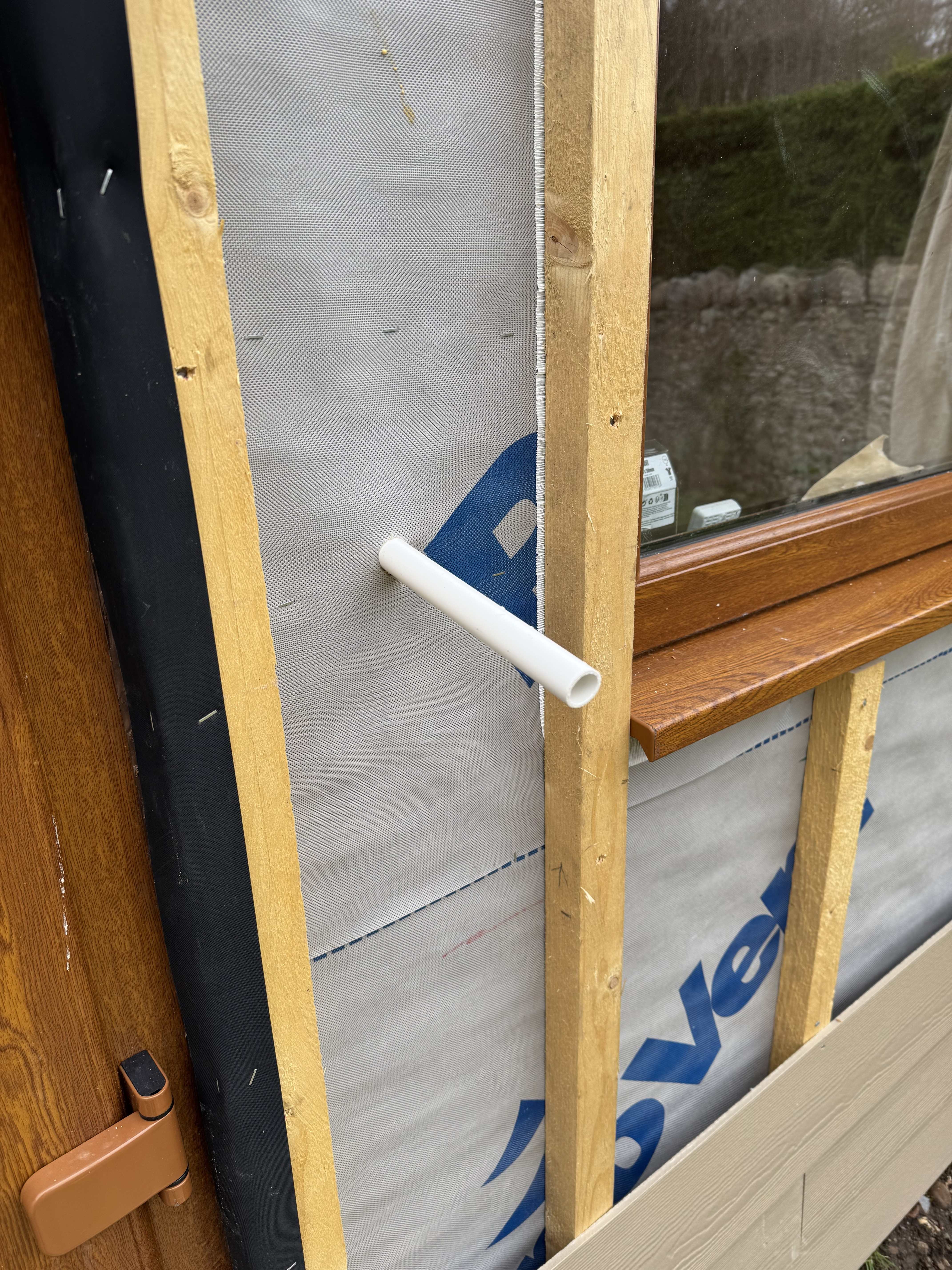

plockhart Posted February 25, 2025 Posted February 25, 2025 (edited) I have ran a 20mm conduit from the inside of my garden room to the outside, with the intention of running the 1.5mm T&E to an outdoor light somewhere nearby. I would like to seal the conduit but I'm not sure how to do that as the conduit won't be going into anything for this fixing. The conduit and cable will be between 38mm battens, and will be behind cladding. I have attached a picture of the conduit which I still need to trim back to behind the batten depth. I will most likely have to run the cable to it's destination before putting on the external cladding (since the cable will be inaccessible as I build the cladding bottom up), so that means the seal of the conduit would need to be resistant to movement as I work with the cable at its destination. What would you recommend I do? Thanks! Edited February 25, 2025 by plockhart

Russell griffiths Posted February 25, 2025 Posted February 25, 2025 Cut the conduit proud of the membrane by 5mm, Push the cable through with loads of spare, silicon the cable into the conduit and seal the conduit to the membrane, it’s that simple. if you want to be more thorough you can buy a square of membrane that has a small stretchy area in the middle designed to be placed tightly over pipes and taped onto the membrane.
plockhart Posted February 25, 2025 Author Posted February 25, 2025 2 hours ago, Russell griffiths said: [..] silicon the cable into the conduit [..] Do you silicone the outside end, the interior end, or go wild and fill the entire conduit 😅 Also do you need to do anything to prevent condensation in the conduit not being able to escape outside? Thanks in advance.
Russell griffiths Posted February 25, 2025 Posted February 25, 2025 Just the ends. ,don’t be overthinking this. 1
Nickfromwales Posted February 25, 2025 Posted February 25, 2025 Does the conduit fall downhill from inside to out? If so, you just seal internally. If the conduit is flat, drill again and set it at a fall.

plockhart Posted February 26, 2025 Author Posted February 26, 2025 Thanks all for the additional replies. Some commentary from me: yes the conduit is on a slight fall the top and bottoms of the battens will have insect mesh but that won't stop the small stuff getting in I suppose
crispy_wafer Posted February 26, 2025 Posted February 26, 2025 28 minutes ago, Pocster said: Expanding foam yep, then ct1 over each end, if insects want to get in they are gonna need strong digging tools 1

plockhart Posted February 26, 2025 Author Posted February 26, 2025 Are some folks advocating doing the full length in expanding foam? Presumably the amps is low enough that I don't worry about cable temperature (1.5mm2)?
crispy_wafer Posted February 26, 2025 Posted February 26, 2025 Nah, a squirt in the end about 30mm or so each end and a very quick trigger, how far into the conduit the foam spreads I don't know. once two cables are in, the nozzle will only go so far. 1 1
Pocster Posted February 26, 2025 Posted February 26, 2025 (edited) 24 minutes ago, crispy_wafer said: Nah, a squirt in the end about 30mm or so each end and a very quick trigger, how far into the conduit the foam spreads I don't know. once two cables are in, the nozzle will only go so far. Done this on a zillion cables/ pipes in conduit. Squirt it in both ends as the man said last night. Edited February 26, 2025 by Pocster 1
