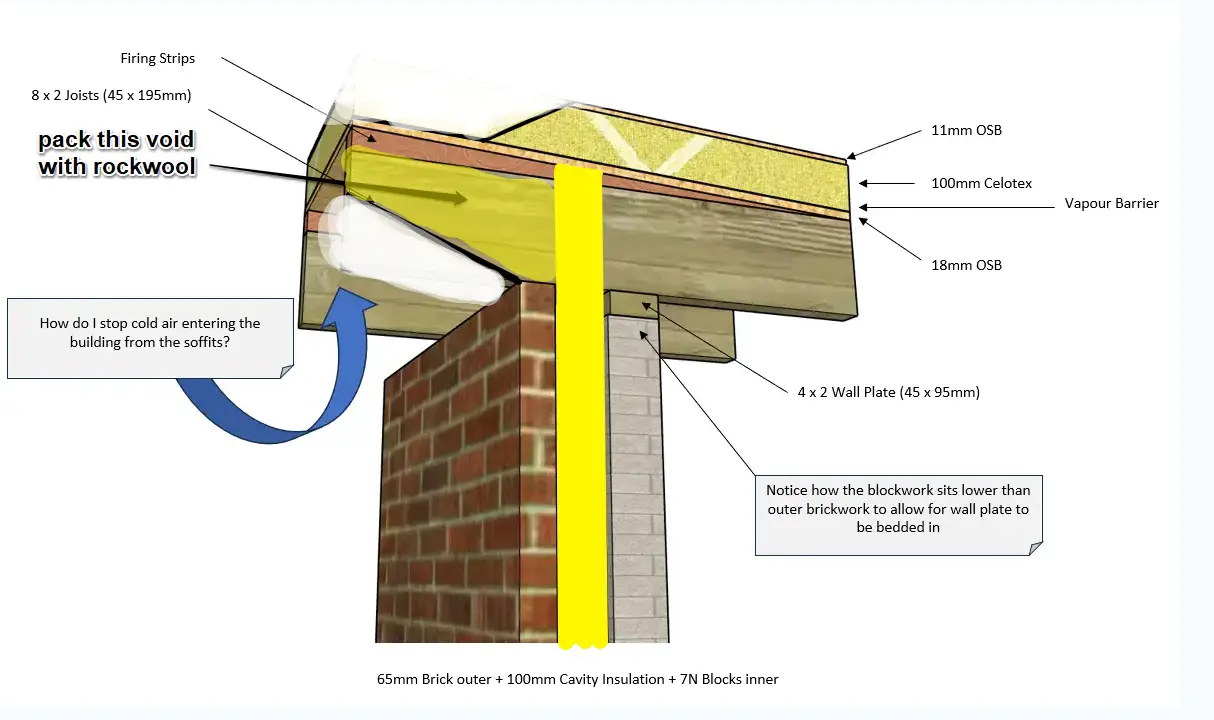

  16. Hi, I am constructing a timber framed garden room and I have not got electrics in it yet. It has insulation in the walls, a warm roof, and an insulated concrete base, and all the glazing is in. The humidity remains consistently high in it (95% humidity vs the 80% humidity outside) and I'm wondering should I try to do anything about it or worry. A few weeks ago it was particularly cold and there was condensation in the corners of the room (tiny sparkles near the top) as well tiny pools of water on the glazing on the inside along the beads. I have 2 trains of thought: - close all the trickle vents, cover the conduit holes I made in the wall (for feeding cables through etc) to try to raise the heat inside to reduce humidity - open all the windows as well as the trickle vents to increase ventilation to lower the difference between outside and inside to reduce condensation What train of thought is correct? I don't know much about how to think about the problem! Longer term I will have a air-to-air heat pump for heating and dehumidifying and will maintain it at a better ambient temperature
  17. Thanks! if will be used for hobbies and maybe some office work in. Likely occupied 8 hours a day most days. I am going to heat/cool it with an air to air heat pump. The windows have trickle vents and then the heat pump can dehumidify
  18. I have made a start - is this what you were thinking?
  19. Ok thanks! Yes it's funny when I was doing all the plans I overlooked this until last night and had a `huh` moment. Just so I understand right, do you propose using insulation tape along all the edges where the joists meet the lower deck, and then taping where the joists meet the wall? Or are you talking about bringing the roof vapour barrier down along the exterior of the building to meet with the insulation at the eaves? If it is that then alas I already have my fascias on with nails.
  20. Hi, I am building a timber framed garden room, which has a warm flat roof. The construction of the roof is: 18mm osb lower deck vapour barrier 100mm PIR 11mm upper deck EPDM I have been working on the interior now, and I am starting to work on the vapour barrier there. Intend to foil tape over the joins of the PIR board in the walls to form a barrier. Then I intend to roll a vapour barrier across the insulated concrete floor, and join it up to the foil on the walls. What do I do as it goes up to the ceiling? It will meet the lower deck of the ceiling, which acts as a break in the vapour barrier. The wall construction from inside to out is: plasterboard 38mm service void 25mm PIR 95mm studs (with PIR inbetween) breathable membrane 38mm battens weatherboard The ceiling finish will just a 12.5mm sheet of acoustic plasterboard attached to the underside of the joists. Attached is a work in progress photo. Are you meant to add a vapour barrier on the underside of the lower deck as well (and thus I would have to go around all the joists)? Or add a vapour barrier to the underside of the joists before attaching the plasterboard (sealing around holes made for electric cables). Or do you do nothing, as it is just an 18mm osb sheet between the vapour barriers and it doesn't matter? Thanks in advance!
  21. I'm just noticing the link to the forum post I was talking about did not go through ok. Here it is here. And attached is the picture I refer to. Thanks for the replies everyone. I continued my research a bit more before I saw these and found a stockist of DriTherm Cavity Slab 32 insulation slab which use case seems similar. I would prefer a flexible product over a rigid board to be able to stuff it into the spaces I have created, but that's just a preference. I will look into the boards as well. My overhang is about 112mm and I already put the fascias on because I was in a race against the Scottish weather putting the roof on, so I just have access from below before I put the soffits on.
