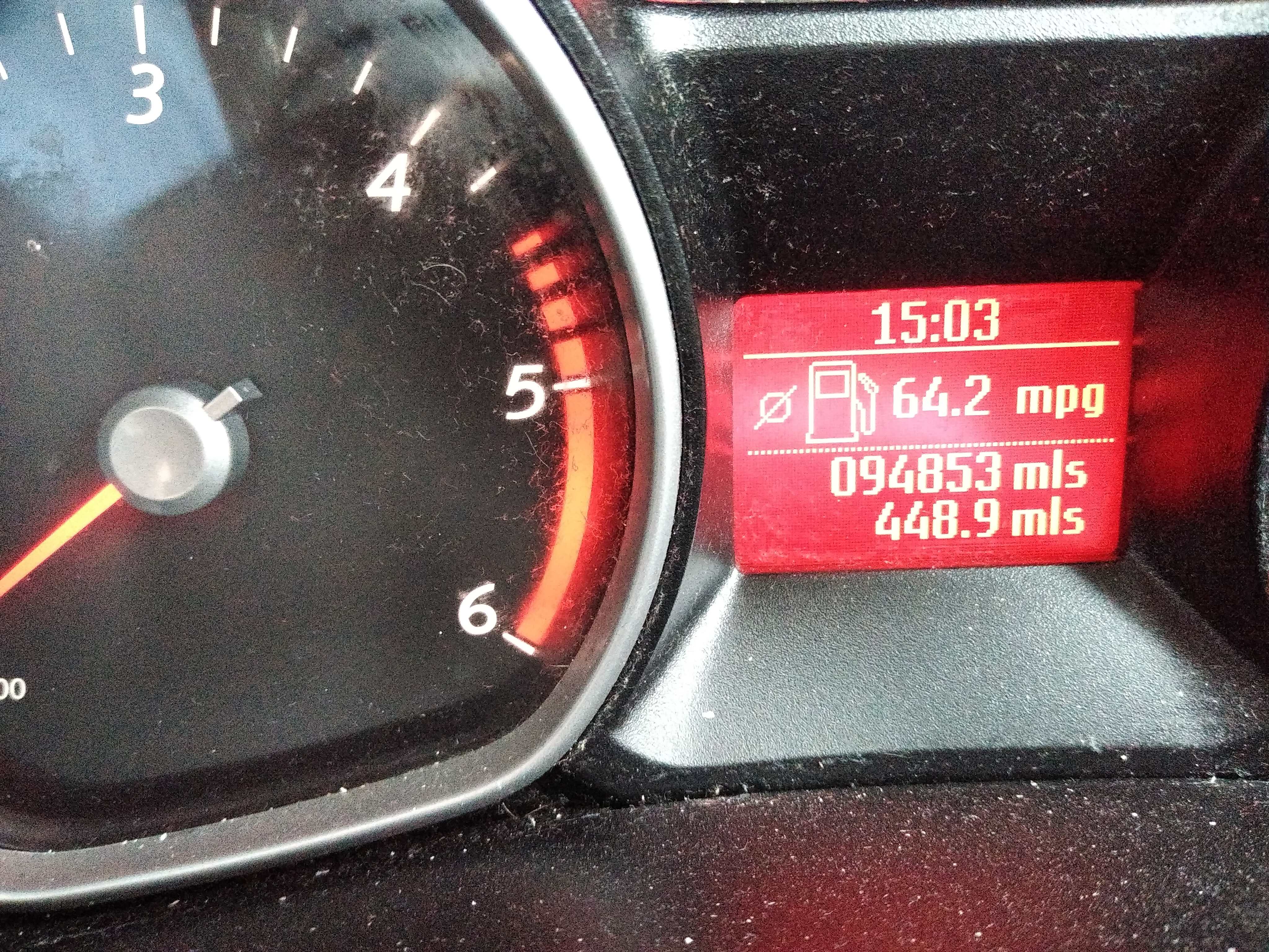

SteamyTea Posted February 21, 2025 Posted February 21, 2025 7 minutes ago, JohnMo said: VW beetle I had a 1200, did about 25 miles to the gallon. And smelt of gasoline when I turned the heater on. Just about to drive back from Buckinghamshire. At over 60 MPG. How things have changed.

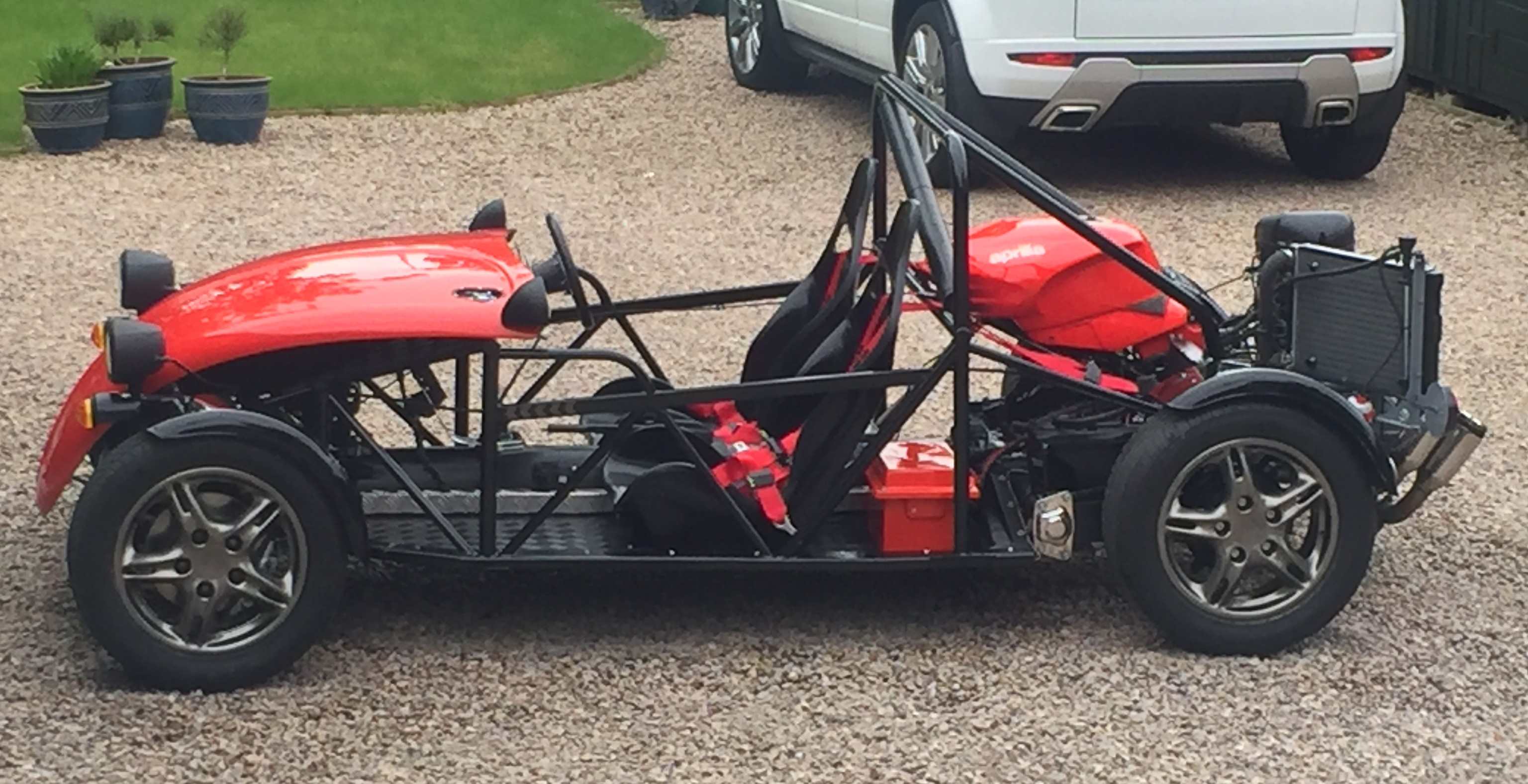

JohnMo Posted February 21, 2025 Posted February 21, 2025 Just now, SteamyTea said: smelt of gasoline Maybe a hole in the heat exchanger or a petrol leak? I had one also. Definitely got a more than 25mpg. But yes things have changed. My beetle has also changed over the years also, owned it for 36 years and 25 years old when I bought it. Now has a space frame and Aprillia RSV 1000cc V twin engine, and doesn't need heating anymore. 2
