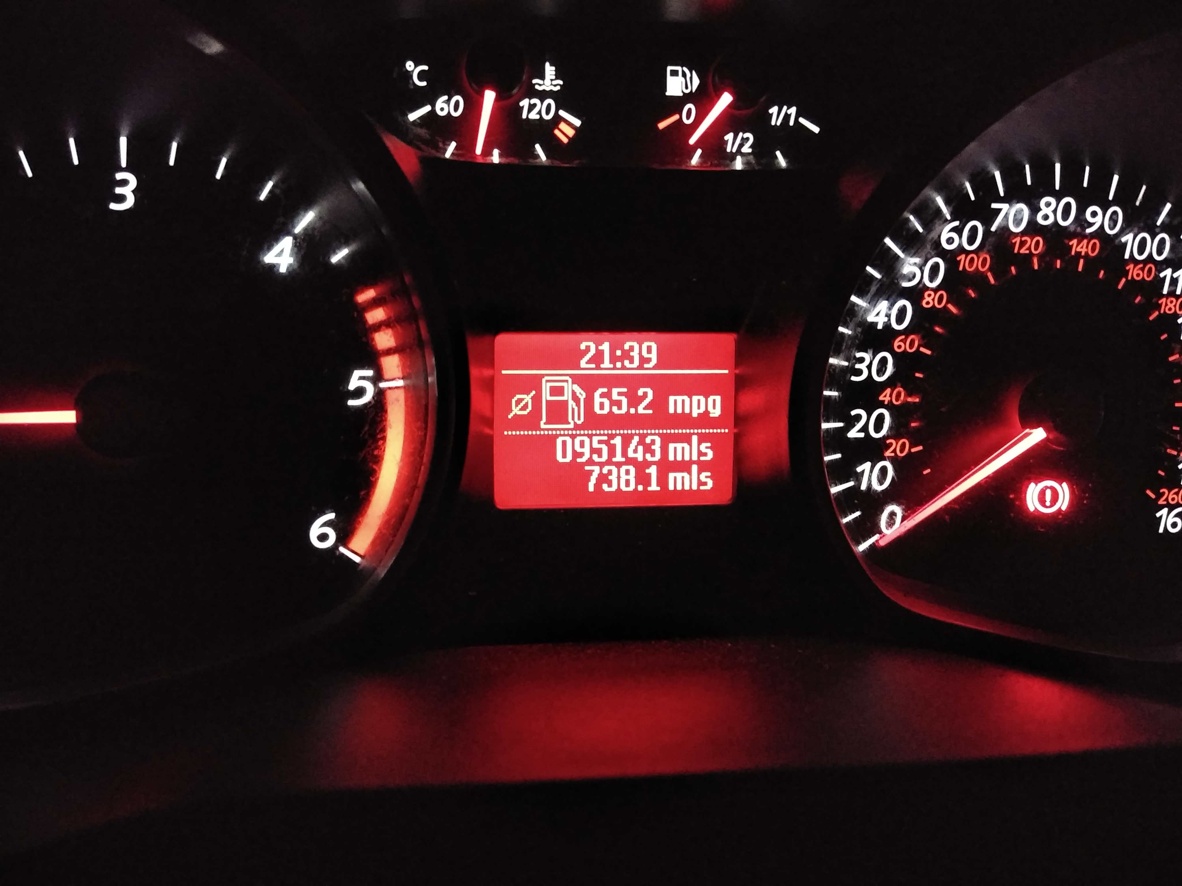

6 hours ago, JohnMo said:
But yes things have changed
My milage has
