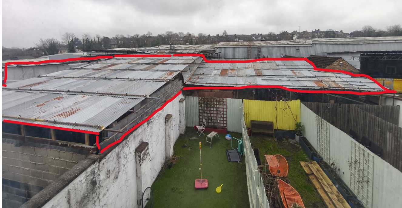

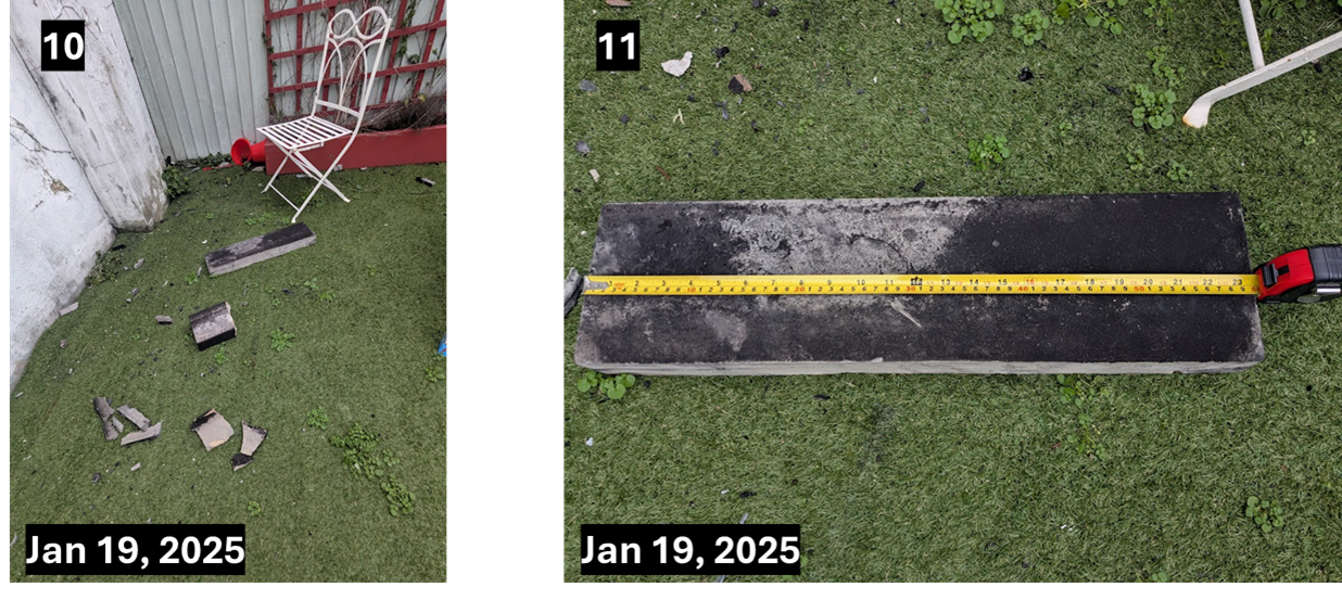

I hope you are well. My home is one of 6 properties that has had to face an unauthorised scaffold and corrugated iron roof structure that was built in 1-day by a mechanic at the beginning of January 2025, without notification. I was shocked when I returned from work. Part of the roof structure was built on a fire-damaged garden wall that I share with the owner of the mechanic's yard, which was never inspected for structural integrity. In fact, I returned home after the roof was constructed to find 60cm chunks of burnt out coping blocks had fallen into my back garden. I have children, and so I have told them not to go into the garden until something gets sorted.

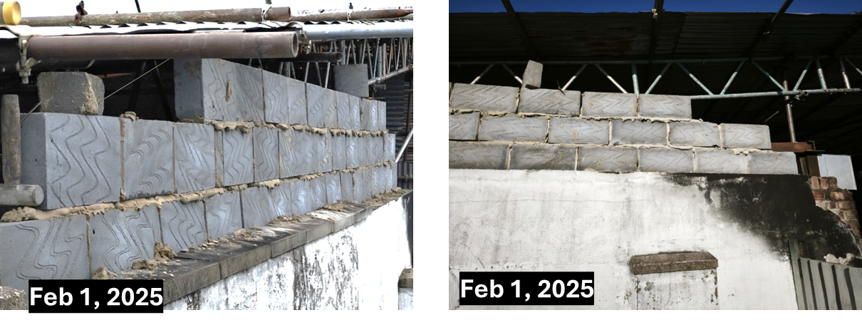

Background: In December 2024, a huge fire broke out in the mechanic's yard, gutting it. My back garden shares a wall and fence with the mechanic's yard, which suffered damage. The highest point of the yard's roof was equal to the highest point of our shared wall, so it was not noticeable before the fire. Following the fire, the owner of the yard built a significantly higher scaffold + corrugated iron roof, on our shared wall, but it also now extends across the back garden of several residential properties. Bits of scaffold hangs over into my garden. It has completely changed the skyline view from our back gardens, as it looks like we all live in a prison camp. Then there is the worry about the damaged shared wall taking the  weight of breeze blocks that look to be poorly cemented on top.

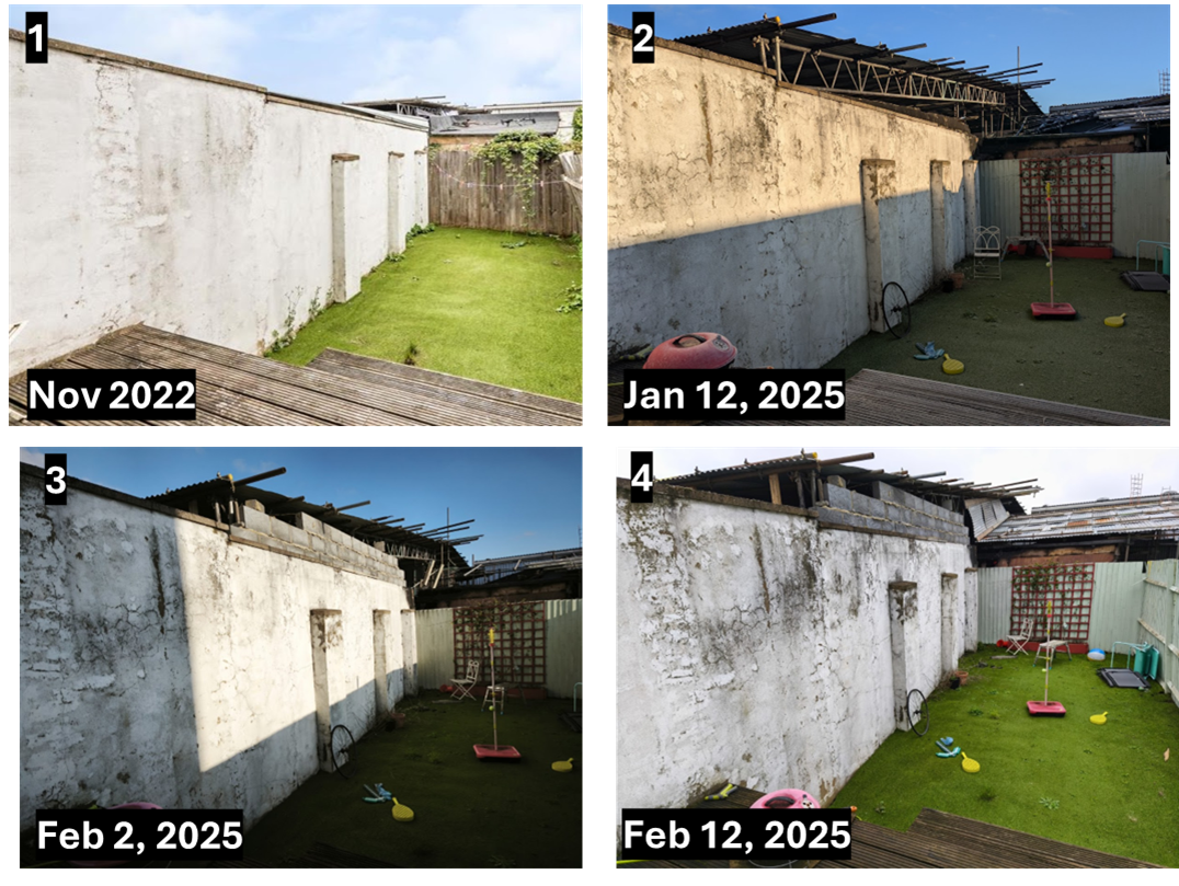

I have inserted some images below.
Before and after the fire, showing the post-fire unauthorised roof structure.
Breeze block addition to the shared fire-damaged wall, under the roof structure.
Coping stones that broke off from top of fire damaged wall into my garden
The extent of the structure spanning 6 residential back gardens, with no space between the shared walls and the edge of the structure (photo taken from my child's bedroom window).

You will need to push the council to deal with this as unless you have very deep pockets they are the only way forward. I suspect that the owner will try to argue it is reinstatement so dig out any old pictures that show how high the old wall was OR that this roof is temporary cover while they build the new one underneath but this does not explain the new blocks. On your deeds does it say who owns the wall? You need to be aware that in planning law you are not entitled to a view but you are entitled to object to anybody building in it.

The Health and Safety Executive is another route - that's a temporary scaffold with a roof so was it erected to a proper design? (As it's insurance related they may have of course). I'd expect HSE will investigate if you report that there's a large temporary scaffold and large bits of masonry have since fallen from height into your garden (as proved by your timestamped photos)

Large pieces of masonry falling from a commercial building onto my land, just missing my small child. HSE will be round within a few hours.
