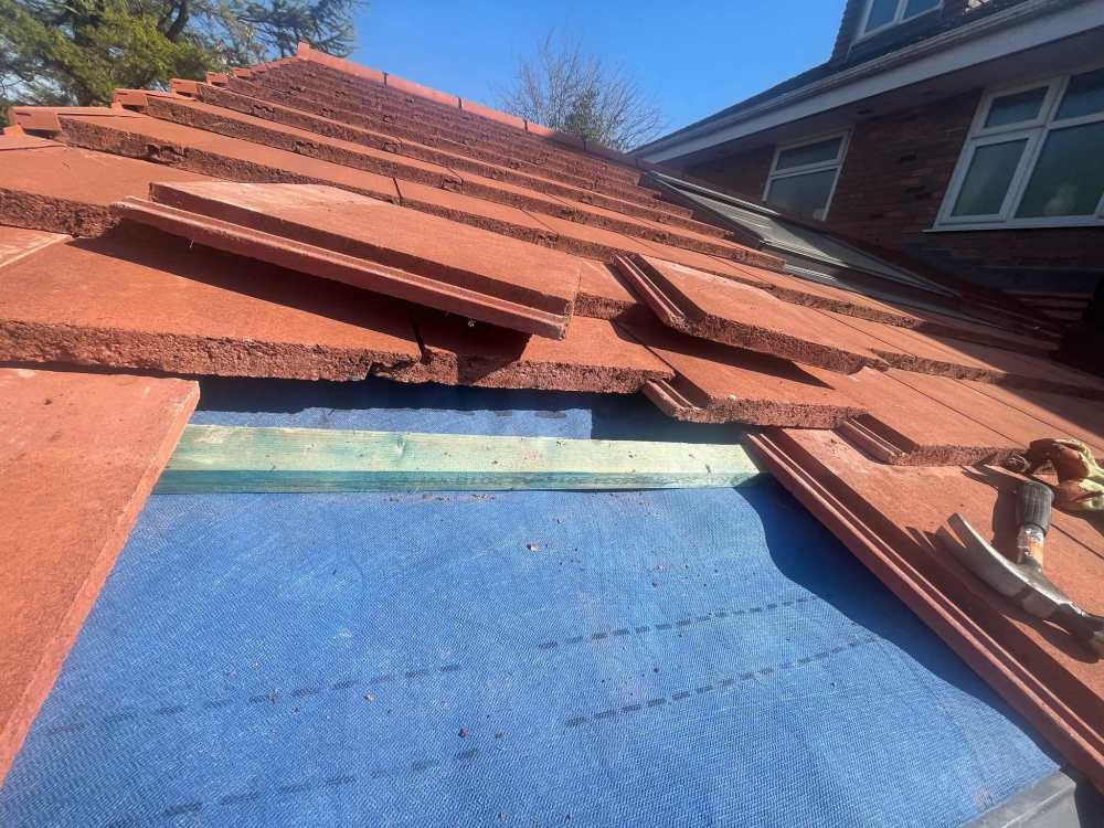

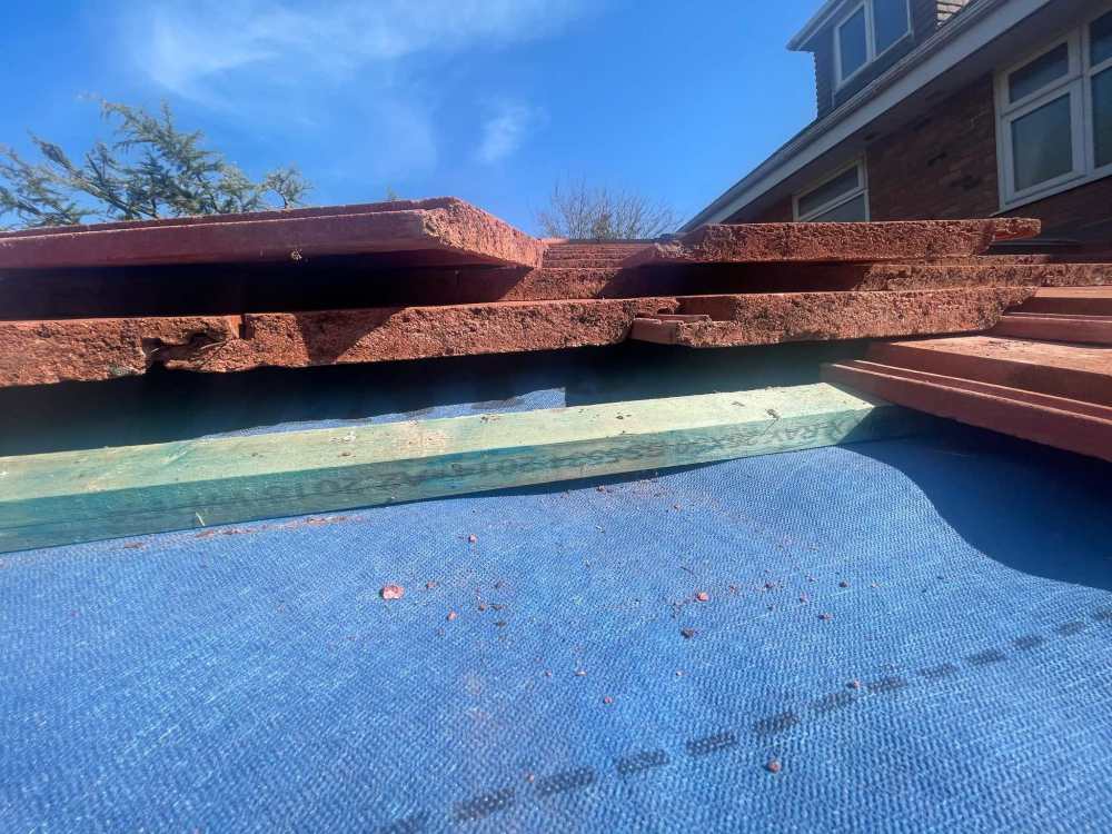

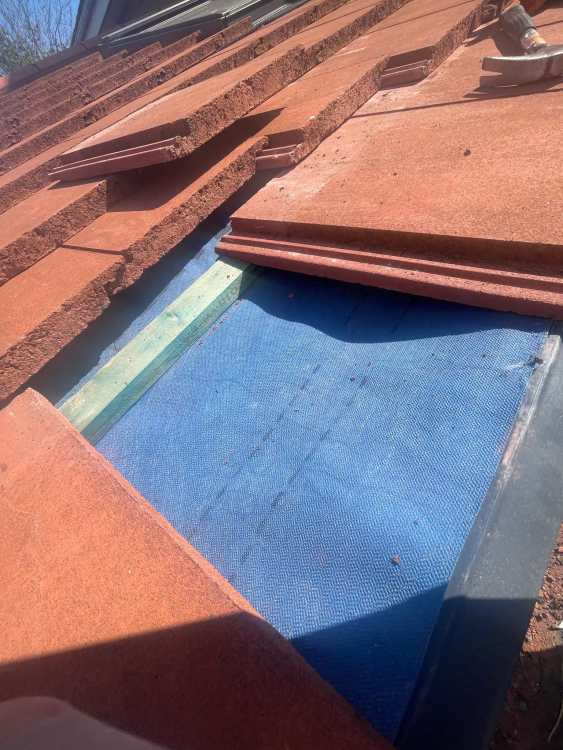

Update on this one, I took some tiles off to have a better look at the eaves detail. Was difficult to photograph so i've done a short video instead.
Summary of problems & questions.
  • Gaps between roof kingspan and wall plate,
    • Can the gaps here be simply foamed to improve insulation / stop wind draughts going into the plasterboard?
  • Large gap between wall kingspan and inside block wall.
    • It really shouldn't be like this right?
    • again can the fix be foam the gap between block and kingspan, then put the wool back over?#
  • Wall king span had quite a bit of movement / play in it.
    • Do i need to fix this if i foam the gaps between the kingspan and block?
Here's the video with all the detail.

Firstly the easy bit, the Kingspan to wall plate junction, yes this can be foamed and obviously ensure the gap above remains clear.
and here in lays the problem why PIR cavity insulation gets such a bad rap!! Poor installation. You are correct that will be doing very little work currently, in practice when it was installed and built up, plastic retaining rings should have been installed to keep it held tight against inner leaf. Clearly doing this now would be a major major job.
what size cavity is it and what thickness were the boards? How clear is the cavity on the outer leaf side? I’m thinking your probably going to need some sort of wedge, but it’ll be difficult for it to not just dig into the PIR
Roof and wall insulation should overlap.
The wall insulation should be tight against the inner leaf.
I suspect the timber batten was an attempt to close the cavity at the eaves for fire.
Don’t use foam.
Get the works done properly.

It looks like it might just be the top board that’s loose. Pause the video. Pull it back in place as best you can and fill any voids with mineral wool/rockwool.
Extend the PIR between the rafters to the wall plate.
Seal the top of the cavity wall with a bagged cavity barrier.
Don’t block the eaves ventilation.

The builder should have closed the cavity at the top with a half-hour fire-resisting cavity barrier.
You have plenty of options but I suspect the least time consuming will be a bagged fire barrier. If you put one in you need to close the cavity before you extend the insulation between the rafters down to the eaves.
You can use a strip of 12mm thick calcium silicate board - Supalux or other equal board. This might be the easiest in terms of space  but it could tern out to be time consuming.
