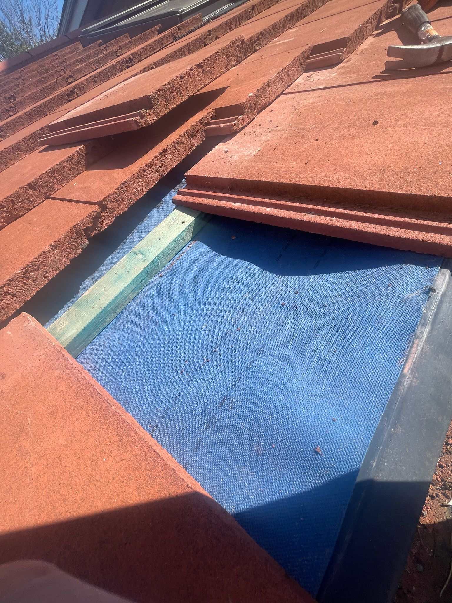

Changing topic ever so slightly as I need an answer on this for the roof. As I'm about to order all the extra Kingspan for it (i'll be removing all the tiles and taping/sealing all the gaps between insulation of what's there already AND adding more whilst im there.
My question is how much of an airgap do i need to retain between the top of the Kingspan that's between the rafters AND the underside of the vapor proof membrane? In the photos below i've shown how my tiles are arranged, they're sat ontop of 25mm counter battens so a good 25-40mm or so higher than the membrane.
The rafters are 170mm tall, there's 100mm Kingspan between them. Given that there is an airgap between the membrane and tiles. How much of an airgap do i need to leave between top of kingspan and underside of membrane? 1" or 2"? Or can I entirely fill the void between rafters with no airgap at all?

If the insulation is hard up to the battens it can be an issue.  It is best to leave 25mm so that any water will run down the membrane and will not get trapped by the battens. If the roof is counter battened, this will be enough. Are you planning to strip the whole roof to do this?
Gov't Best Practice guide for rooms-in-roofs says 50mm ventilation gap between the insulation and the membrane. I realise yours is not but it sounds like the set-up is similar.
Yeah ok, if I add 40mm more kingspan that'd leave me with  30mm clearance to top of rafters.
I read the 50mm clearance required is because of sagging of the membrane etc. But ours looks pretty tight to be honest.

Yes going to be completely stripped
tiles off, battens and membrane all off.
Do you think 20mm airgap between kingspan and membrane will suffice? 50mm insulation is no more expensive than 40mm weirdly. And probably easier to sell on if I over order!

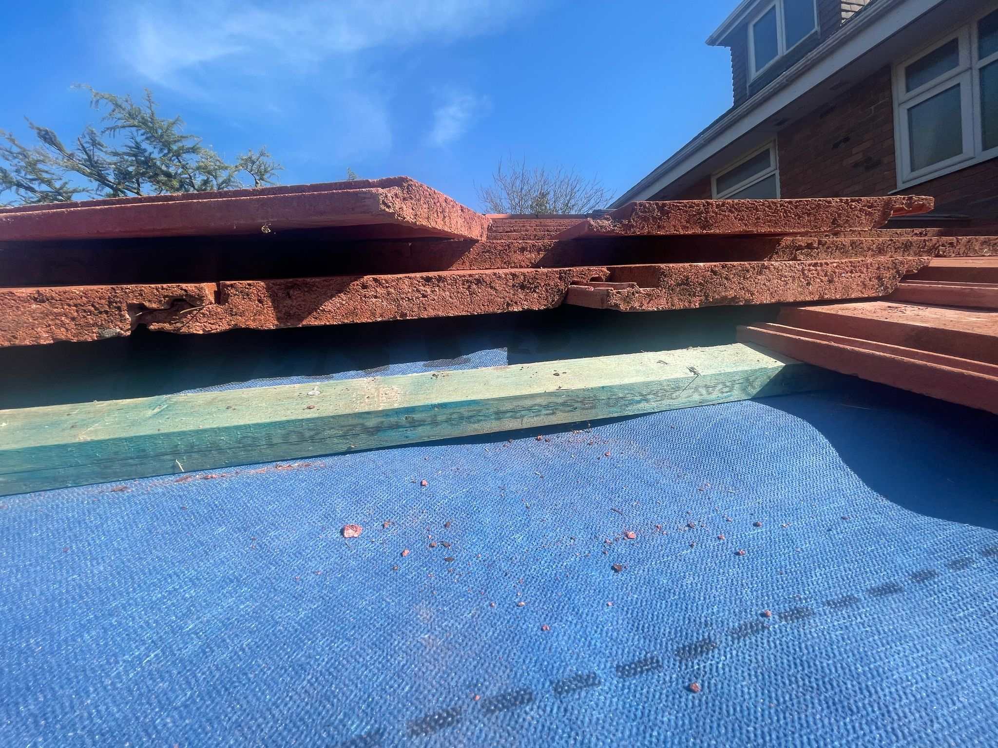

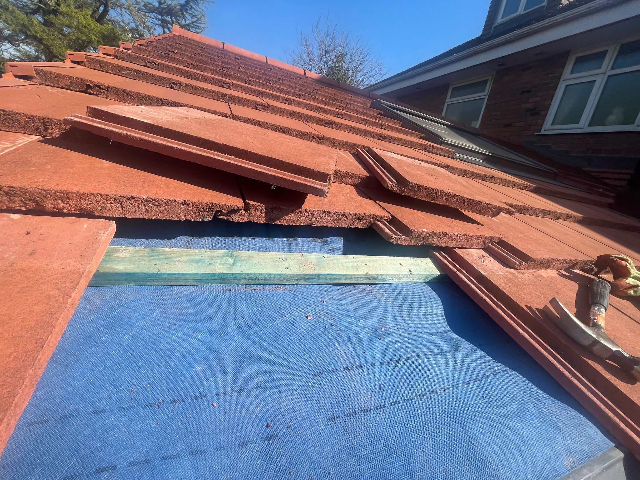

RE: wall gaps. Absolutely, take a look at this video. We've a vented tile on the roof for an extractor fan in the bathroom that I wanted to inspect.  Looking under there confirmed that I need to have all the tiles took off and insulate all these roof properly tbh. it's a complete mess.

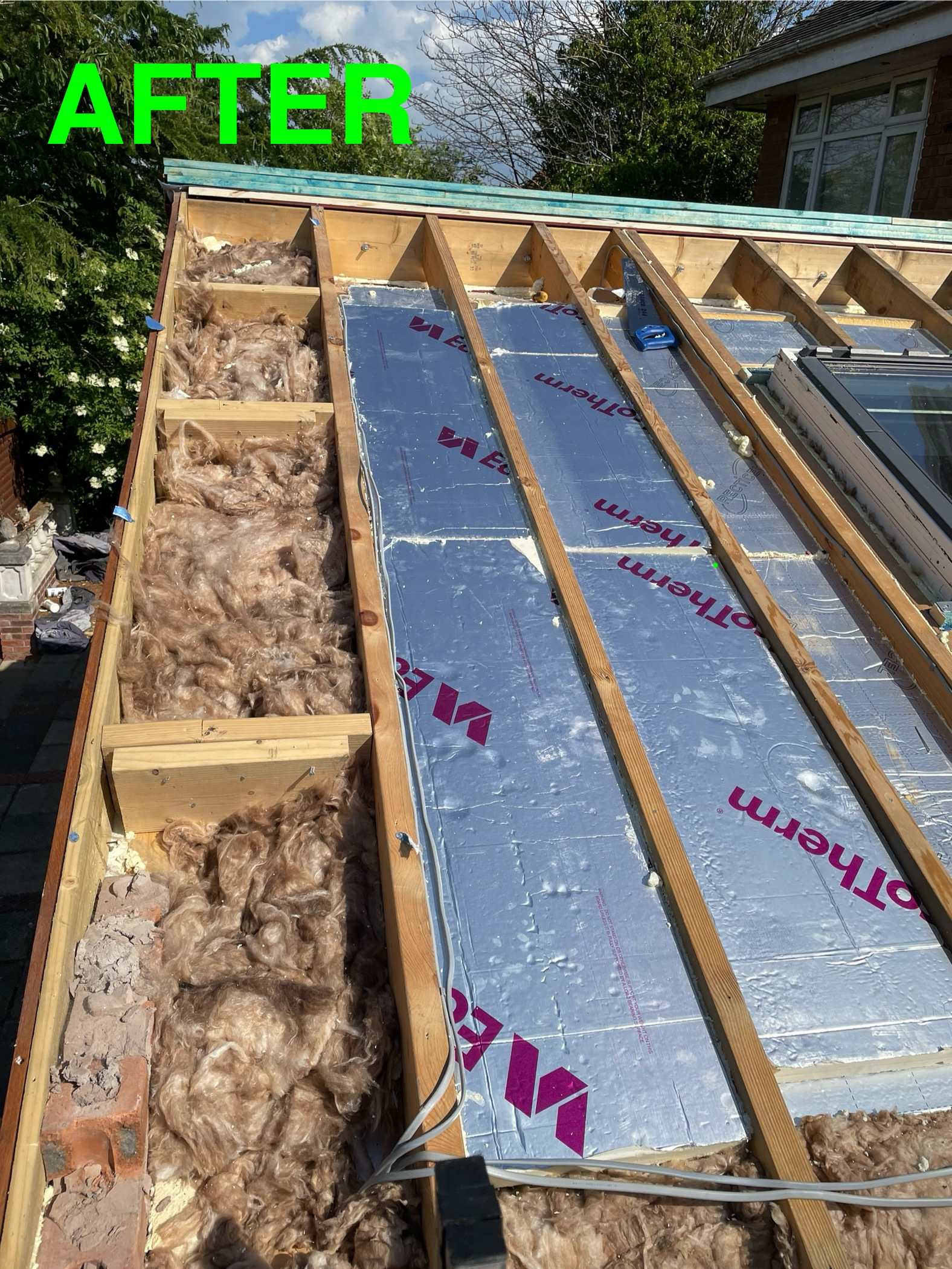

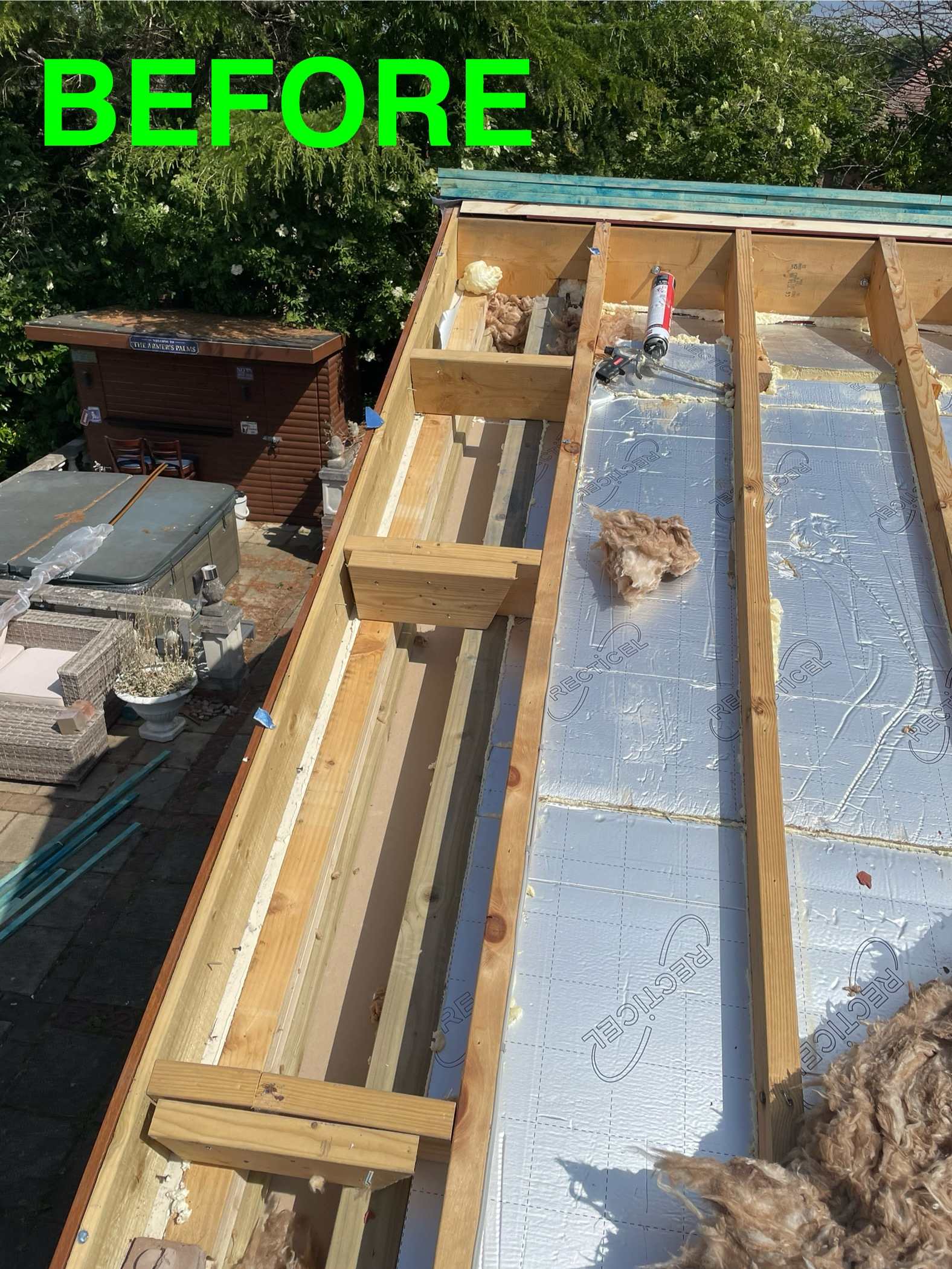

  • 1 month later...

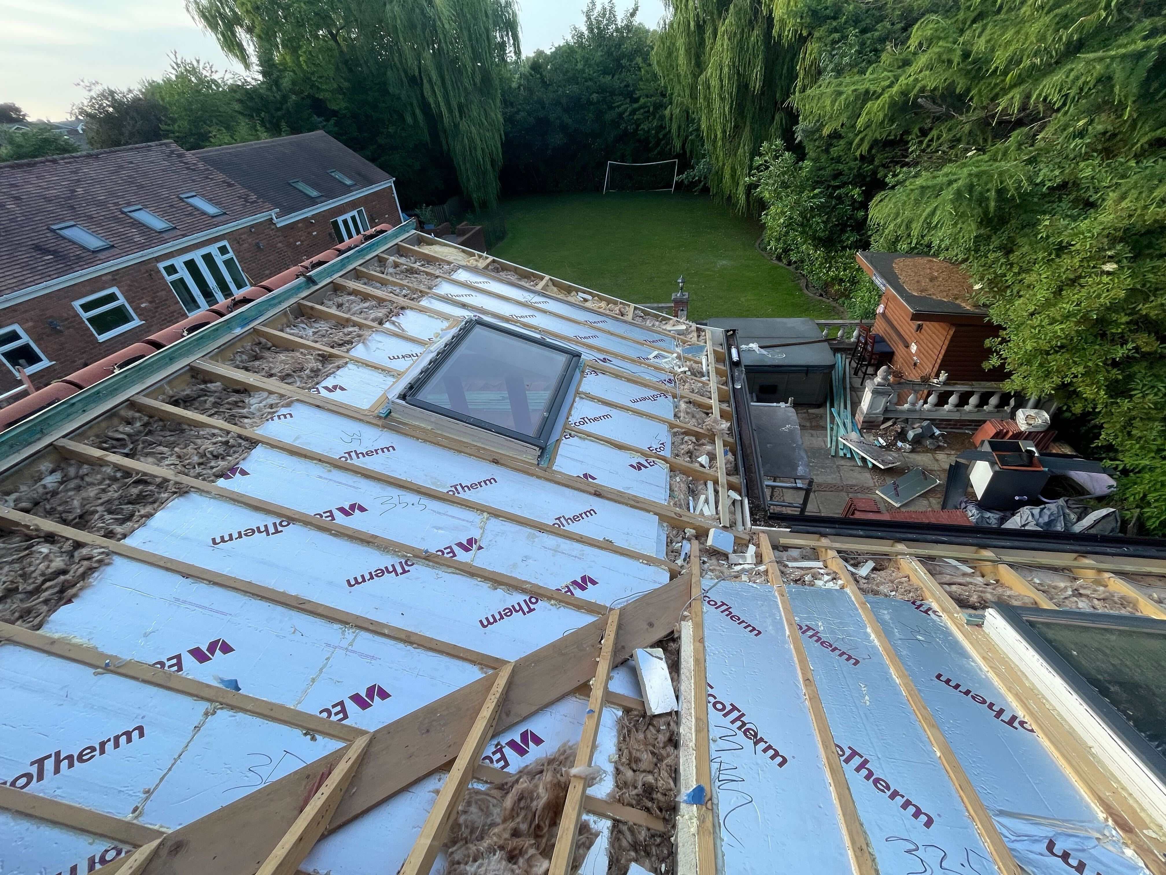

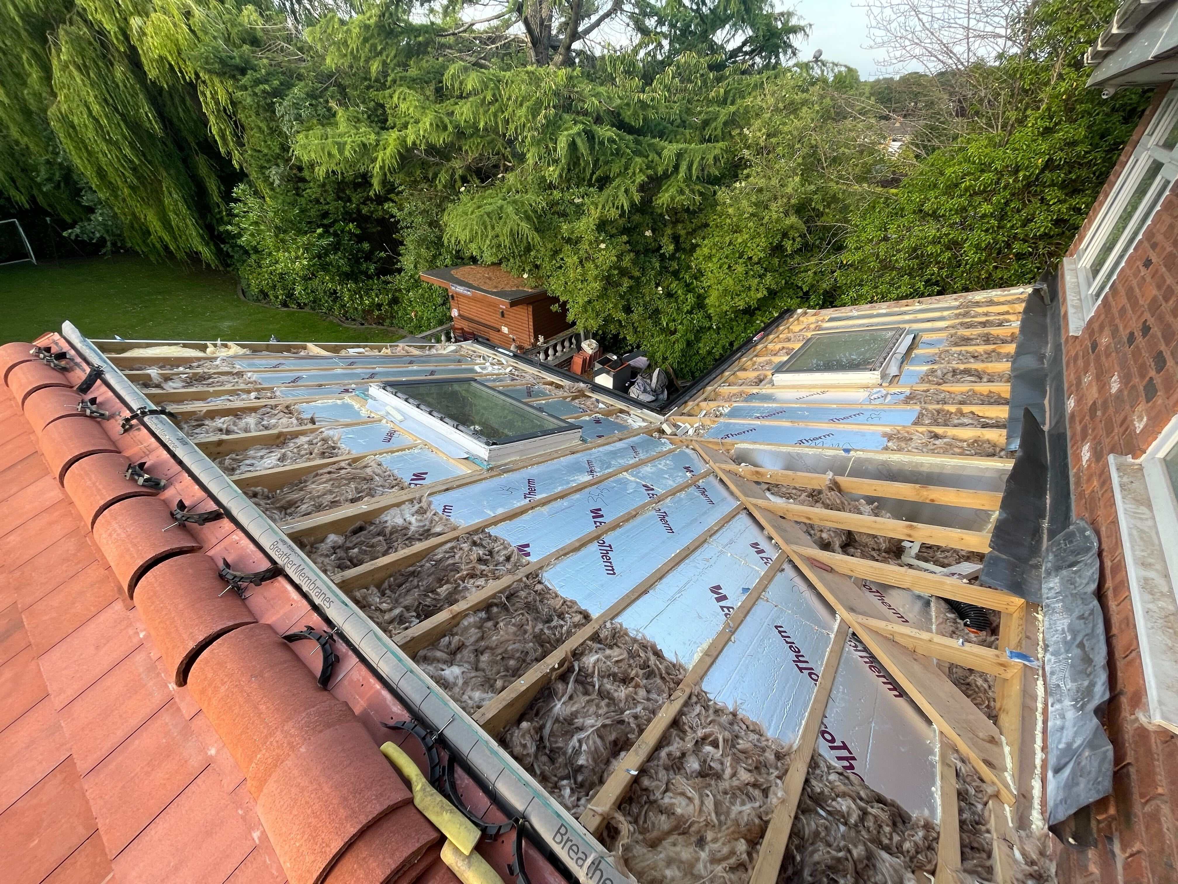

Update on this one, we said we'd take the  roof off and do everything we can to improve the insulation off. Well we did half of the extension, it took ages due to just how many problems I found. There were literally parts with zero insulation. Or other parts where the gaps between the kingspan were so large you could get your hand through em!  So really positive news that we found so many issues.
Work included, all tiles off, felt and battens off too..... then foaming and taping every joint, then adding another 50mm kingspan ontop (ensuring we left a 25mm air gap between felt and board)... then foaming all the joints on that too...
It took a full day, but really pleased to say the difference is HUUUUUUUUGE. Room is massively retaining heat compared to previous. And we've not done the more problematic half of the roof yet (based on the thermal images) so excited to see what we find on that side. Likely cracking on with that half on june 9th. So will update then too...
But in the mean time, here's the before and afters. Very pleased we did this, despite the cost!

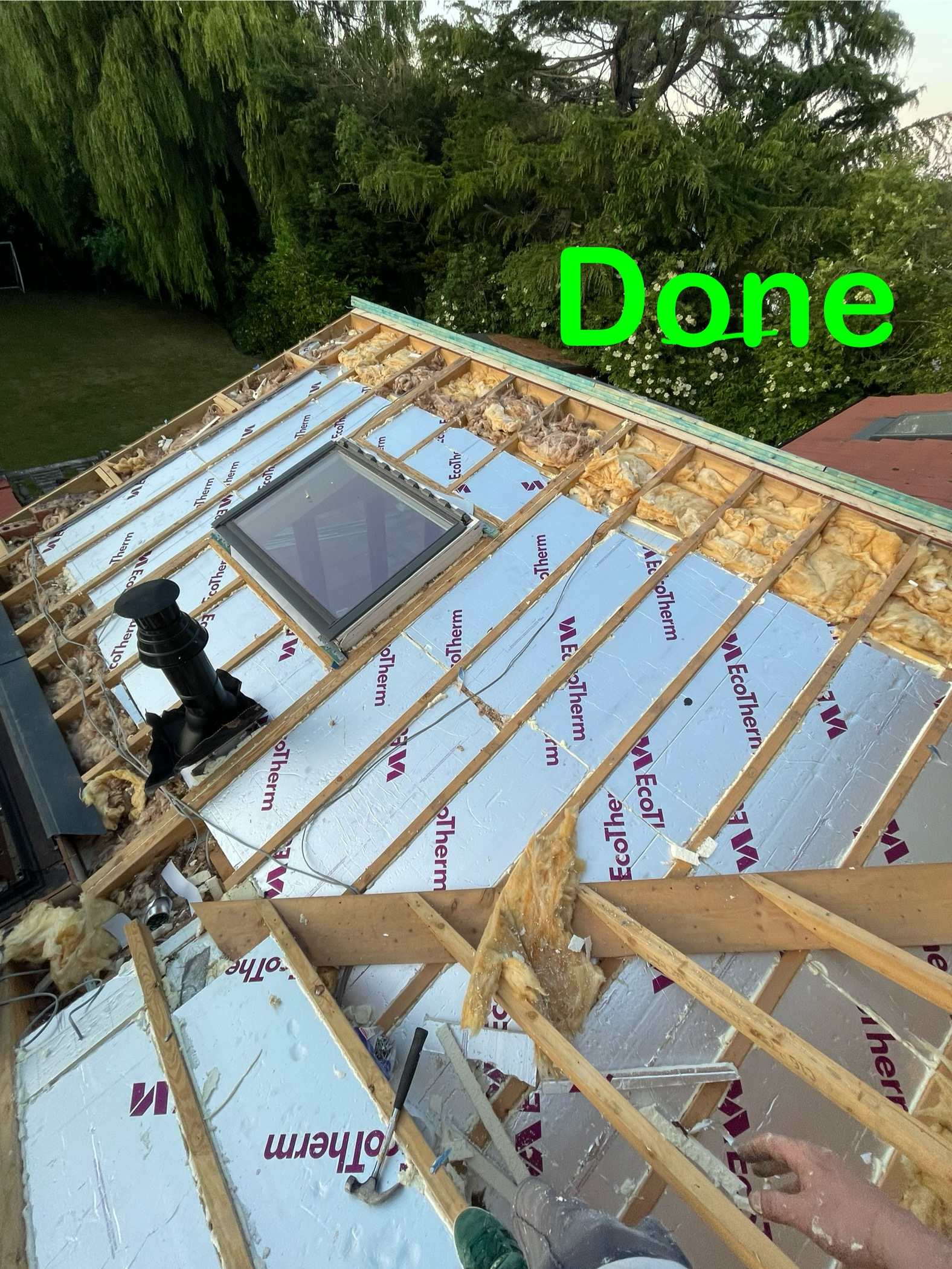

And one last update.
We did the other half earlier this week. Same process. Foam and tape all the gaps, adding another 50mm kingspan ontop, then foaming that in place too. (Also adding 100mm kingspan to the areas that had ZERO!).
Reassuringly, .... the places that the thermal camera identified as cold spots from the interior, married exactly up with the worst problems I  found whilst up here. It was worst where the extension joined onto the main wall of the rest of the property, AND where the roof changes direction on the corners. Those places were pretty much entirely uninsulated, or had massive gaps between the boards, where you could visibly see the back of the plaster board.
I haven't had time to "test" it yet. But I feel like i've done everything I can at this point (bar external insulation which I probably cant be arsed with).
So yeah, may this be a great read and hopefully insightful for anyone who finds themselves in a similar situation.
Wanted to say thanks to everyone on the group with your help advice and guidance. And finish by saying..... if you want a job done right.... you guessed it..... Do it yourself!

Well done - clearly the poorly installed installation was very much the driver for your heat loss issues - only thing I don't understand is why there is a mixture of materials - surely with the roof off it could have all been kooltherm PIR?
thanks, it would appear that was a big issue, and not surprised when I saw the lack of cohesiveness in the finished work!.
Re: materials. Beneath all the wool in shot there, there is consistently either 150mm or even 200MM kingspan.. i threw the wool in the places I did just as even more coz I had it spare and it didn't prevent the airflow in the places where I bunged it in.
Basically I never want to do this again, so went O.T.T....coz i've got O.C.D.... and P.T.S.D now :D
