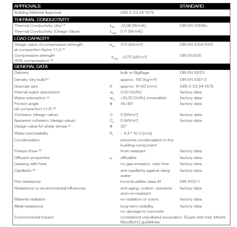

mjc55 Posted 3 hours ago Posted 3 hours ago On 14/02/2025 at 23:23, Gus Potter said: To question (a) correct, (b) first part .. yes they can make the thermal detailing easier depending on what level of insulation you want to achieve. Sometimes it's cheeper and most effective to go for a simple strip found that a local builder can do in their sleep and add a bit of extra insulation elsewhere in the easy places.. this can be called the compensatory design approach to insulation for example. Design is often about making educated compromises on some details so you end up with a better job performing and buildable job at the end of the day. It's surprising what you can get a raft to sit on in terms of ground bearing capacity. I've done some whacky ones with an allowable soil bearing capacity of 30 kPa in soft SAND near the coast... a nice value is normally around 100kPa about ten tonnes a square metre. But that is not all of the story. A low bearing capacity soil can also be a CLAY soil where is swells and shrinks. This makes things more tricky as while the soil may carry the load ok it keeps wanting to move up and down over the seasons. You can do rafts down to quite a depth at times. Down to 1.0m is perfectly doable at times but beyond a 600mm depth of hardcore the NHBC want the fill to be specified and designed by an SE say. Sometimes (you need to be brave and get your sums right) we dig out the heavy soil and replace with insulation and a less dense material so the soil at the base of the excavation does not "know" we have popped a house on top. Here is an opportunity to use say Foamglass Geocell as it is light weight, good bearing capacity and has a quantifiable U value. @Gus Potter How did you find the foam glass? Thinking of using it on our Pod (testbed for main house build). Quick calcs seem to indicate that costs are not too extreme and certainly easier to put in place. Would be interested in your experience of it.
Nickfromwales Posted 3 hours ago Posted 3 hours ago 7 minutes ago, mjc55 said: @Gus Potter How did you find the foam glass? Thinking of using it on our Pod (testbed for main house build). Quick calcs seem to indicate that costs are not too extreme and certainly easier to put in place. Would be interested in your experience of it. I saw it being used on a previous project where the client had a semi subterranean basement, and this was dropped down around (outside) the uninsulated concrete, filling the 300mm gap after the shuttering was withdrawn. Defo a simple solution in a difficult situation, but not the cheapest if you have an opportunity to use something else. 1
mjc55 Posted 3 hours ago Posted 3 hours ago 2 minutes ago, Nickfromwales said: I saw it being used on a previous project where the client had a semi subterranean basement, and this was dropped down around (outside) the uninsulated concrete, filling the 300mm gap after the shuttering was withdrawn. Defo a simple solution in a difficult situation, but not the cheapest if you have an opportunity to use something else. Waiting for a quote, but in our situation doesn't seem massively more expensive. Of course this might change when we get the quote including delivery costs!
