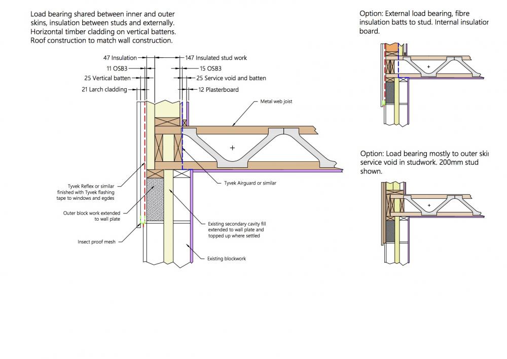

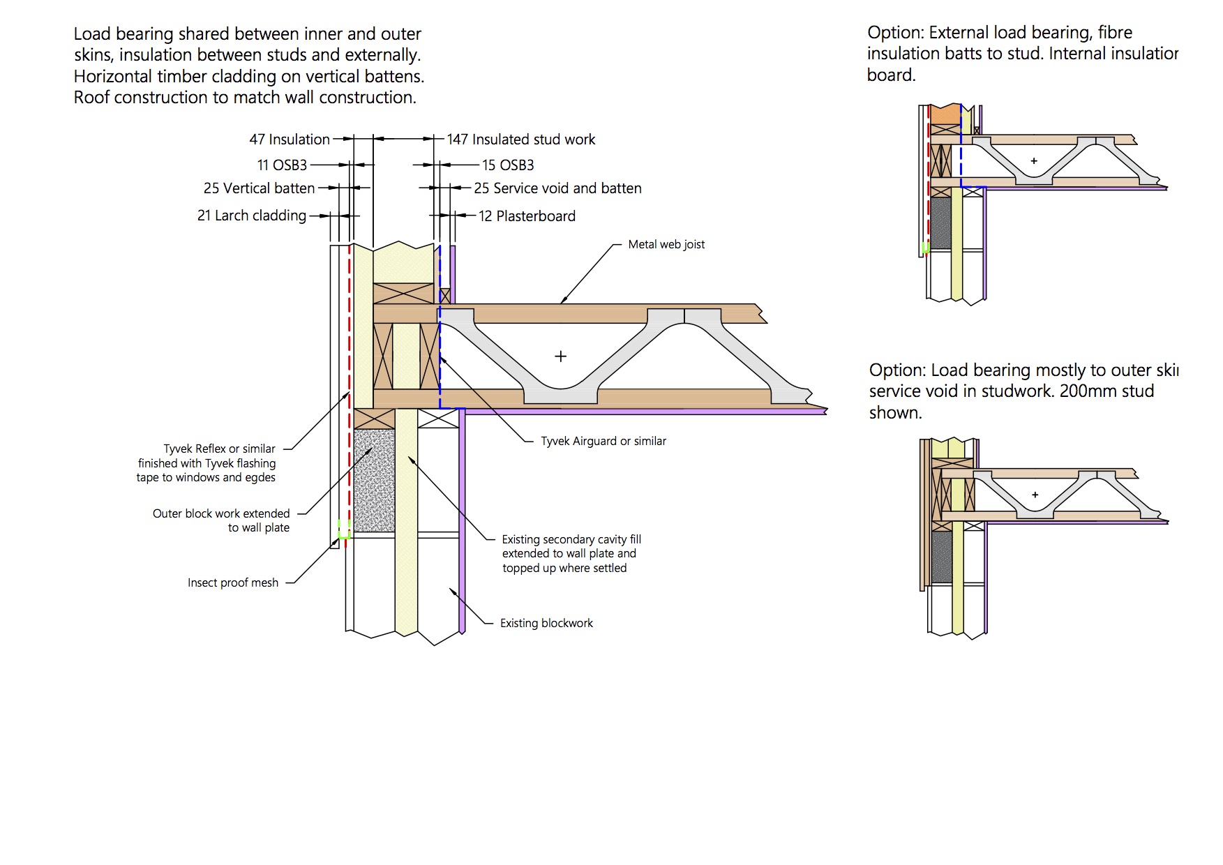

bissoejosh Posted December 4, 2017 Share Posted December 4, 2017 (edited) A while ago I found the detail(s) shown below. These might help @Rdddk ? - Does anyone have any views on their pros/cons? I'm not too sure on the detailing for the air-guard as shown which looks like it would be fiddly . I'd had planned to simply wrap the airtight membrane around the joist end before tucking back in to the wet plaster coat below. Thanks as always Edited December 4, 2017 by bissoejosh typo 1 Link to comment Share on other sites More sharing options...

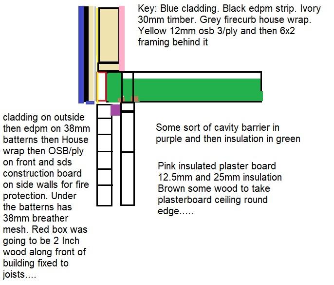

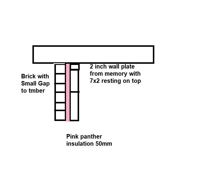

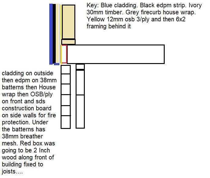

glenboy Posted August 8, 2020 Share Posted August 8, 2020 (edited) @Simplysimon yeah its 7x2 timber floor joist. which at the moment are over hanging the outer leaf. with a facia and sofit in wood. Here are a couple of drawings of what I have now and what I am sort of looking at doing...but maybe stick some dpc under it.... yeah timber floor with chicken wire and insulation between it.... Cedral click cladding by the way... Edited August 8, 2020 by glenboy Link to comment Share on other sites More sharing options...
Simplysimon Posted August 8, 2020 Share Posted August 8, 2020 1 hour ago, glenboy said: @Simplysimon yeah its 7x2 timber floor joist. which at the moment are over hanging the outer leaf. with a facia and sofit in wood. Here are a couple of drawings of what I have now and what I am sort of looking at doing...but maybe stick some dpc under it.... yeah timber floor with chicken wire and insulation between it.... Cedral click cladding by the way... that's not going to work, a big cold bridge at floor level. why is there edpm? i don't think it will meet regs for u value to start with. best case scenario would be to take kit to walls still with some insulation under, binder along inner wall and hang joists off that. i take it that there's currently a flat roof single extension and you're going two storey? if so, have you checked to see whether founds are up to it? Link to comment Share on other sites More sharing options...
glenboy Posted August 8, 2020 Share Posted August 8, 2020 (edited) 1 hour ago, Simplysimon said: that's not going to work, a big cold bridge at floor level. why is there edpm? i don't think it will meet regs for u value to start with. best case scenario would be to take kit to walls still with some insulation under, binder along inner wall and ha joists off thatng. i take it that there's currently a flat roof single extension and you're going two storey? if so, have you checked to see whether founds are up to it? Well it is first floor and the cedral click ask for the edpm to run upto the top of the batterns which I think are 38mm deep by 100mm wideand the edpm is fixed to that. Yep it is going on the current flat roof extension to 2 storey. Yep the foundations are up to it as I dug them out. I think from memory its 1.5 meters deep there. Other option I can only think of would be this...... maybe have another block between the joists. Celotex at the front and the knuff wall behind the block. An the pink panther insulation is in the 50mm cavity below Edited August 8, 2020 by glenboy Link to comment Share on other sites More sharing options...

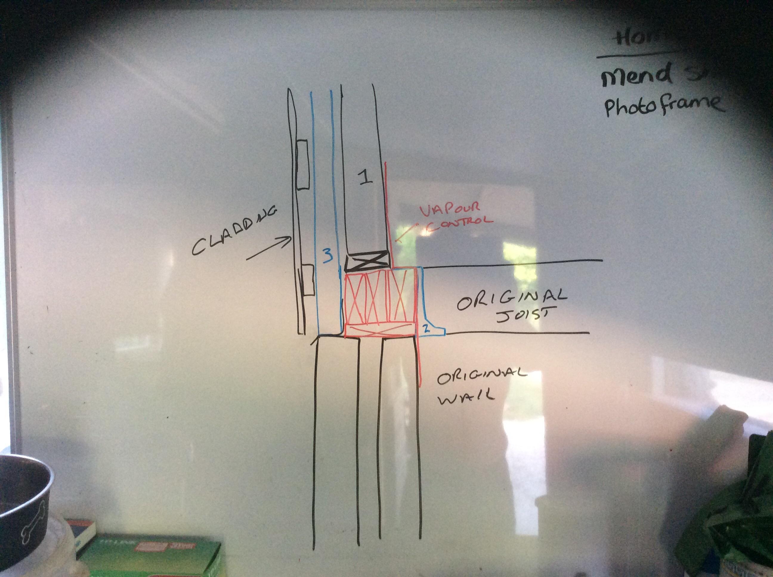

Russell griffiths Posted August 8, 2020 Share Posted August 8, 2020 not to scale, and you will obviously need to check with your structural engineer regarding loading, but I think this will be easier to build, your original ideas will be a pain to air seal and insulate well. Cutting the joists back short will allow you to install a rim board that could have a VCL stapled to it so when you build the upper storey you will have something to tape to. 1. New wall 2. Joist hanger 3. insulation just me thinking out loud. Link to comment Share on other sites More sharing options...

Russell griffiths Posted August 9, 2020 Share Posted August 9, 2020 Or as Simon pointed out, remove the two vertical timbers in my drawing and drop the stud wall down to fix the rim board to, this will tie things together nicely. Link to comment Share on other sites More sharing options...
