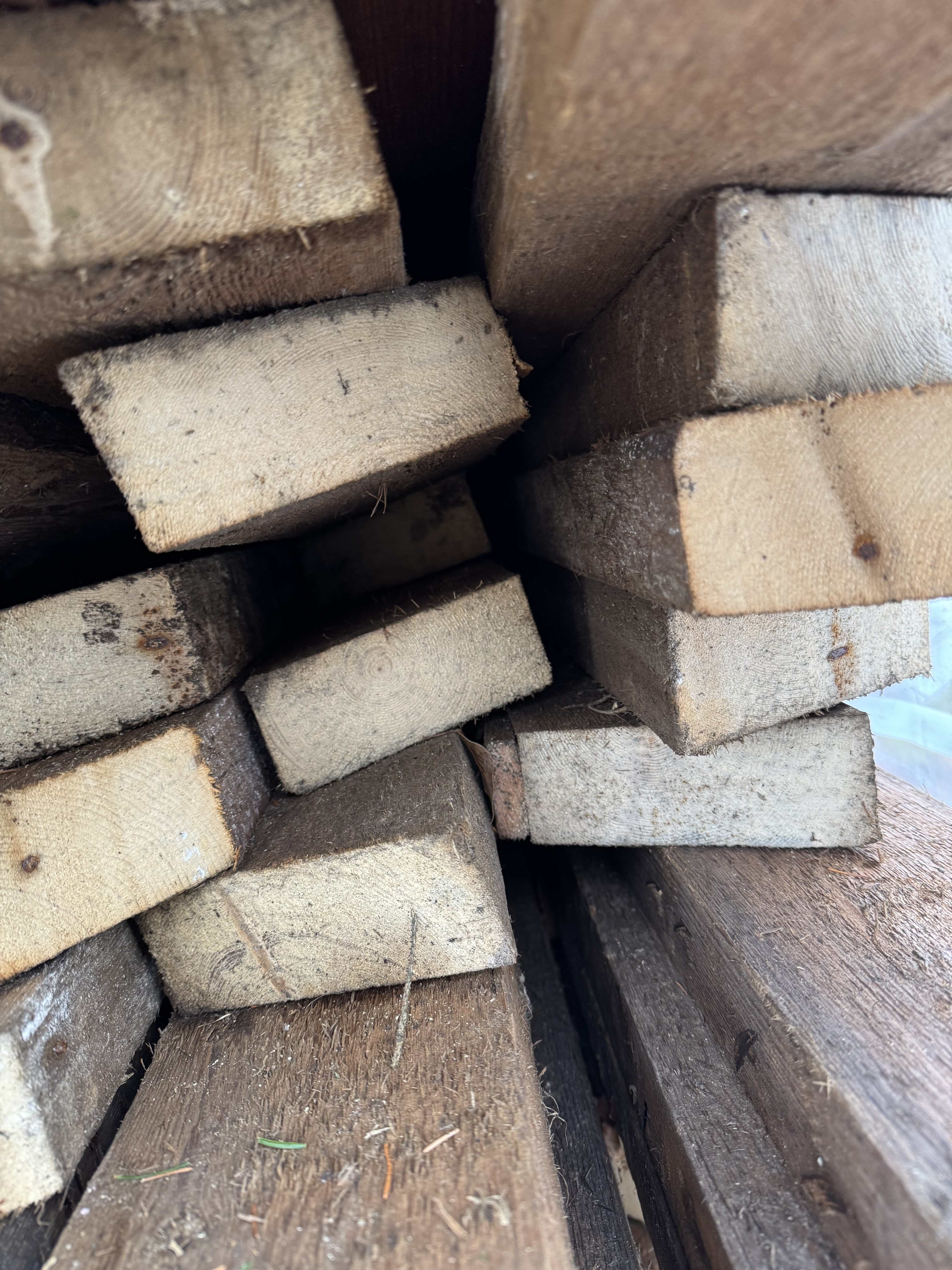

Pendicle Posted January 27, 2025 Posted January 27, 2025 So we have now demolished a self built house built in 1960, we have saved all the floor and roof rafters and would like to use in the roof of the new build. Is there a way to get them tested/graded so we can see if they meet current structural requirements. Visually they are in great condition. We are in Glasgow. Our structural engineer left the company we are working with and now have a young graduate working on our project and not keen on our recycling ideas. We want to recycle because its the right thing to do and looks great quality wood and a waste not to reuse and it may save us money although that is not necessarily the main driving factor. We basically hand demolished the house ourselves and removed every nail, I intend to use the bricks in gabions in the garden and to create paths. We aimed to put very little in landfill.

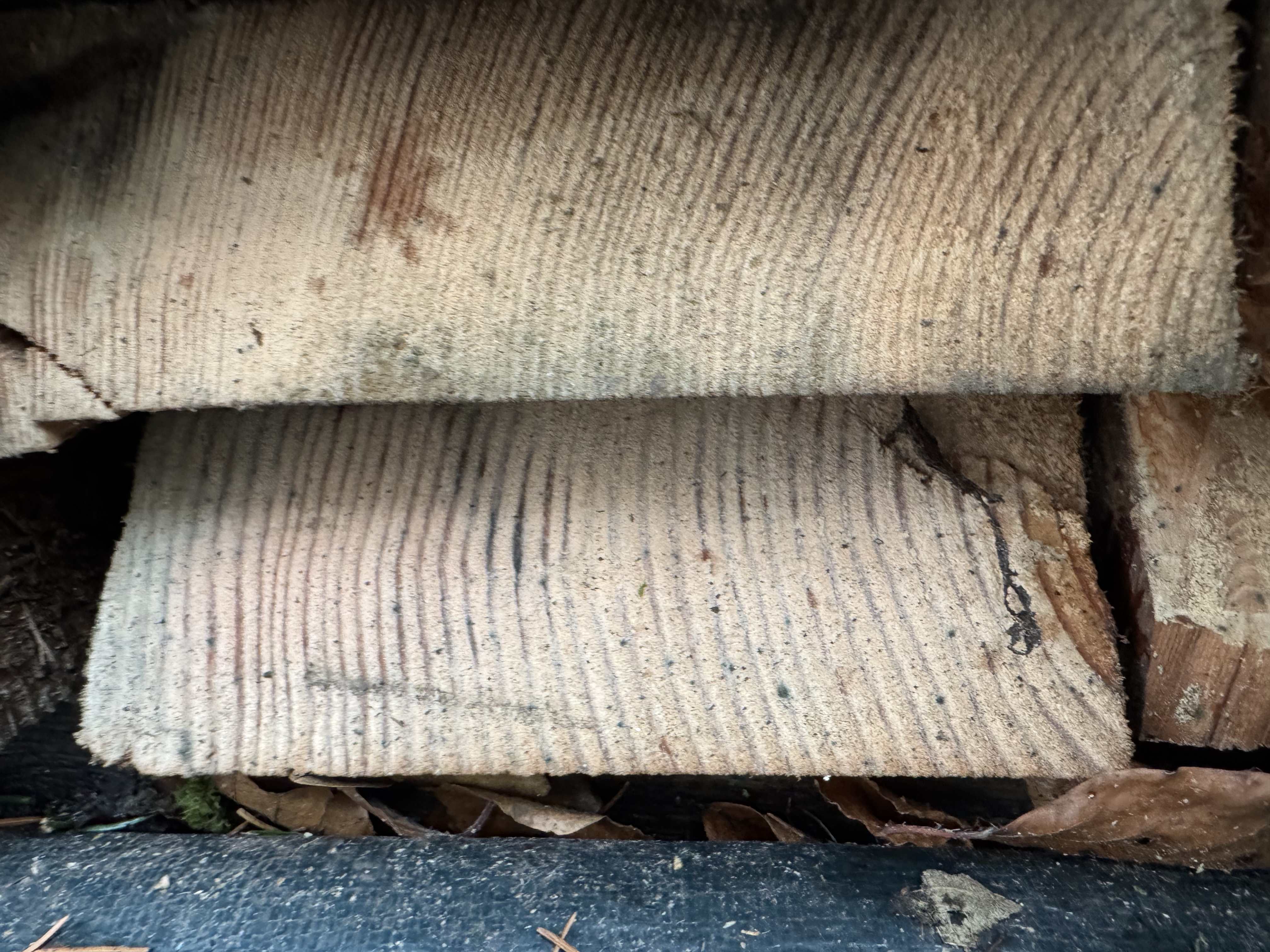

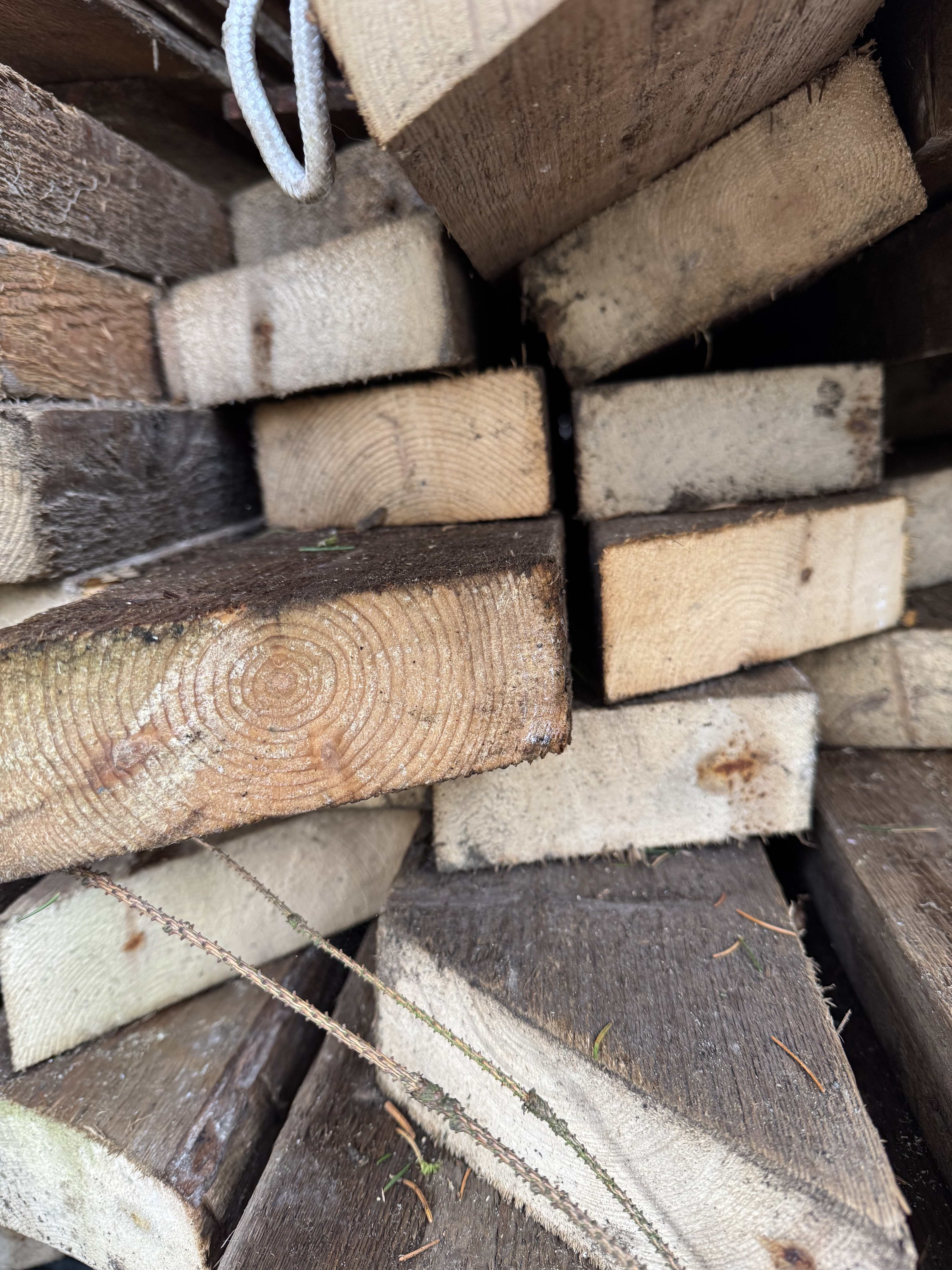

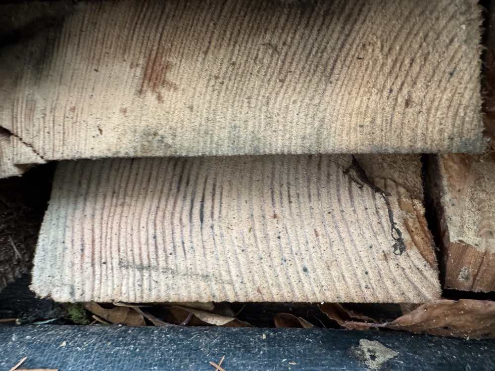

saveasteading Posted January 27, 2025 Posted January 27, 2025 Great idea to reuse it. Its quite likely better than at the local BM anyway. Photos of it? Most timber is visually graded, from the closeness of rhe growth rings and the amount of knots. So you need help from your BM (agree to buy everything else from them) or an SE. OR you could design as if it as C16 timber and be on the safe side. 1

saveasteading Posted January 27, 2025 Posted January 27, 2025 1 hour ago, sgt_woulds said: softwood timbers from the 50-s to the 60's Good point. A UK Power guy dated a pole to the late 1940s based on having a wide grain and lots of knots...ie a British fir tree that grew rapidly, and was all there was. Even now you can buy Highlands timber that is C16 or ungraded, but not C24. 1
SteamyTea Posted January 27, 2025 Posted January 27, 2025 4 hours ago, saveasteading said: Even now you can buy Highlands timber that is C16 or ungraded, but not C24. That may just be the economics of production and supply. If the main timber needed locally is C16 and ungraded, then it is better to concentrate on producing that, then let others produce the C24, which may be used more local to the production point. In economics, this is known as Division of Labour. 1
saveasteading Posted January 27, 2025 Posted January 27, 2025 22 minutes ago, SteamyTea said: may just be the economics of production and supply It is because the trees grow very quickly in the climate, unlike cold places where the growth rings are closer together ( eg Finland, Canada, and previously Russia). Also i was informed by a Finnish timber merchant manager that their flat land results in straightness and strength. 1

saveasteading Posted January 28, 2025 Posted January 28, 2025 19 minutes ago, SteamyTea said: a different cultiva Presumably all natural forests have changed genetically to suit the circumstances. Then they replant as monoculture with something faster growing and alien. Commercial forests are not generally attractive to be in for human leisure, and are deserts of needles and darkness on the ground. But I still favour timber. We must wish @Pendiclewell in reusing the salvaged timber. I think I can tell C24 from C16 by sight. Especially as C24 appears to be more wide grained than in the past. 1

Pendicle Posted February 4, 2025 Author Posted February 4, 2025 Thank you for all your comments and suggestions @MikeSharp01 @Beau @BadgerBodger @saveasteading @G and J @Russell griffiths @ToughButterCup @sgt_woulds @SteamyTea The gentleman who built the house we have demolished was a building surveyor and it looks like he did a lot of recycling on his build. While stripping off plaster board in the attic rooms we found large cinema posters mounted on thick card from the 60s for a cinema on Victoria rd Glasgow, the building was knocked down in the 60s. Most we had to cut to remove so we played a family quiz while removing, what film is this a poster for? I Should share and make a build hub quiz. I have attached photo. we have lots of made up ground under the house although clay at a decent level. While gardening we have found chimney pots and bricks and 2 sinks. I will tell you all about my rubble drywall pathways in another post! The rafters are in a marquee in the garden, so storing is not an issue for now and HID is of the the same mind. They are straight and over 8m long and de nailed, they are from rafters from the roof and 2x floors so lots of them. Yes we had planned to also use to build garage/shed/tree house. I have attached a photo of end grain. @saveasteading good suggestions on asking local timber yard. I recently was given a contact of a tree surgeon who also has a saw mill in his garage who might be worth a call. Essentially as our neighbours ash tree with ash die back in the storm has split at its folk and mangled our Heras fence and leaning precariously on our ash and cherry tree. Although that’s another issue as the neighbour who owns the unmanaged woods from said tree has moved away and now need to go through title register to get contact details. They have another 2 ash trees very close to our boundary and new house which also have ash dieback. 1
