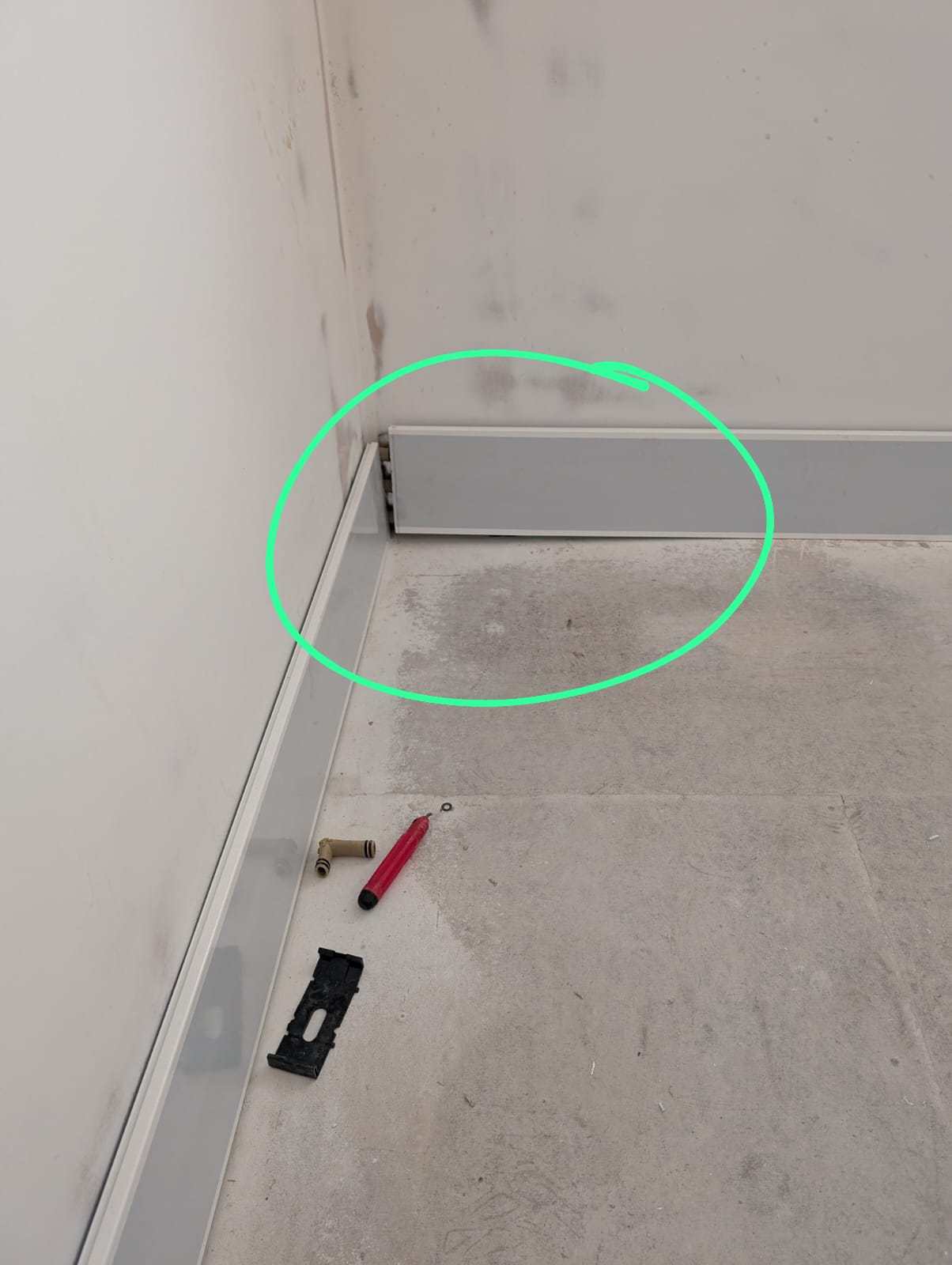

Self-levelling on wooden floors
We are having a renovation and our builders have put in new boards for all the floors - by the time we come to fit the skirting boards (we are fitting thermalskirt), we just realized that the floors are not levelled.
On consulting the builder, he said that the job for floor levelling is not part of the job for setting the new floors (?!?!), and that we have to find some other way to level the floors. (i.e we got a massively unhelpful builder)
I think some self-levelling compound in that area could work - I know it works for concrete floors, but not sure if this could work on wooden floorboards too?
If we were to find someone to do it, how much should we expect them to charge (the area is around 12m2), and how long would it take to fix this?
Thank you!
Yes it works. make sure it sticks by applying PVA first.
I even used it on an ancient tongue and groove floor once and it was fine.   It was a 2 part, vinyl based product which has some flexibility.
Just in that corner and zero to about 10mm? easy enough.
Most domestic floors are far from level, but you wouldn't notice unless trying to play marbles on a hard floor finish*.
Your skirtings are like a straight edge so are emphasising the gap. Unless you know otherwise about the rest of the room.
It is an easy job, and the better products are self levelling. a general builder can do it.
so you are looking at a half hour for just that corner, or 2 hours for the whole room.
* that is a good test, or a golf or other hard ball.
