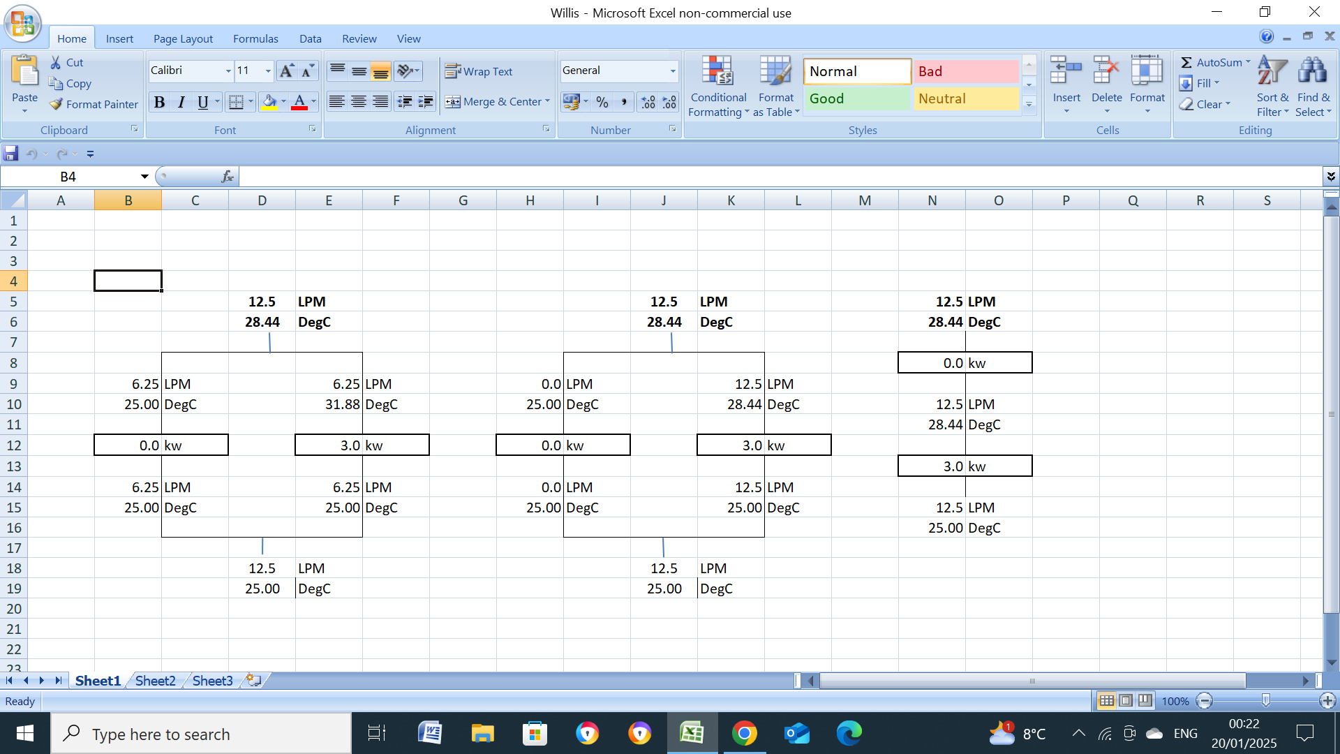

Nickfromwales Posted January 19, 2025 Posted January 19, 2025 5 minutes ago, John Carroll said: With the 2 in parallel, say 3kw each, assuming a total flowrate of 12.5LPM, 6.25LPM through each, gives a dT of 6.88C, a return temp of 42C gives a flow temp of 48.88C. 2 in series, flow through both is 12.5LPM, dT through each is 3.44C, it enters first heater at 42C, leaves at 45.44C, enters the second at 45.44C, leaves at 48.88C. Switch one off (still in series) dT through first (12.5LPM) is 3.44C and 0C through the second, flow temperature 45.44C. 2 in parallel, one switched off, dT through switched on one, (at 6.25LPM), 6.88C, flow temp 48.88C, dT through second (switched OFF) 0C, flow temp 42C, 6.25LPM at 48.8C mixed with 6.25LPM at 42C gives 12.5LPM at 45.44C. Yup. We’re just wasting time discussing a problem that doesn’t exist, unfortunately.

John Carroll Posted January 20, 2025 Posted January 20, 2025 7 hours ago, Russdl said: As someone who has lived with Willis heater UFH for a few years our experience is that having the water flow through 2 Willis heaters (one 'on' one 'off') mixes down the temperature of the water exiting the 'on' Willis heater. It would, wouldn't it. Yes, it would and will, but the outlet flow and temperature will be the same, whatever configuration you use or way you install the heaters. 1
