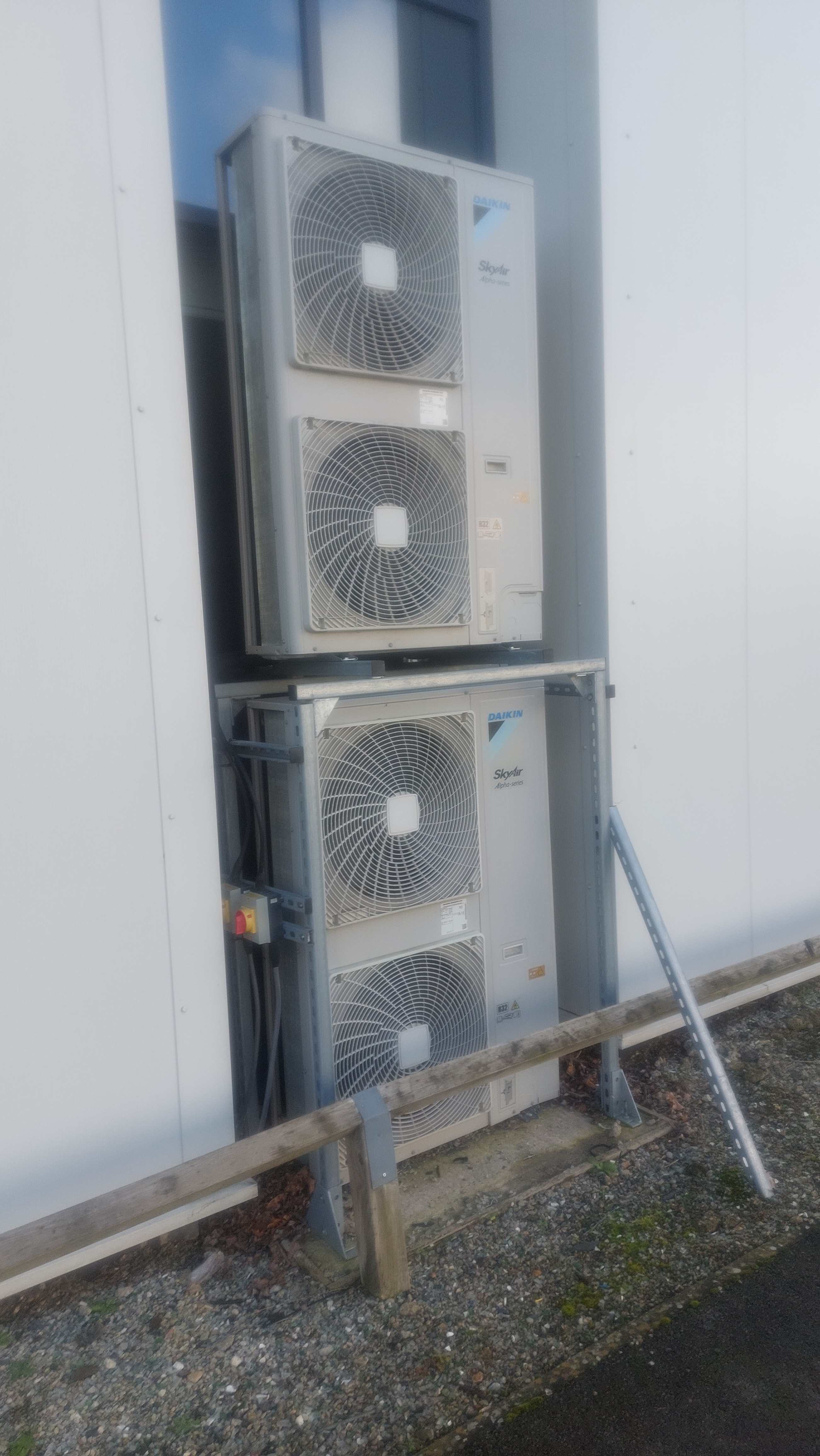

saveasteading Posted January 19, 2025 Posted January 19, 2025 On the other hand, it is better than tucking it away too tightly enclosed. Here is an example of why I don't trust most supposed expert installers in this subject. Retrofitted by the tenant for a new server room in that room. Location useless for efficiency obviously, but also that the rear intakes are jammed tight with leaves. But it's tidy.
JohnMo Posted January 19, 2025 Posted January 19, 2025 48 minutes ago, saveasteading said: But it's tidy. And covering a window?
saveasteading Posted January 19, 2025 Posted January 19, 2025 51 minutes ago, JohnMo said: And covering a window? Yes. Covers window, minimises fresh air intake (even more so when vehicles park there), difficult to clean or service. If the bracing was hit by a vehicle.....? I met the supposed expert who was sent by the tenant to justify that and other stuff. He installed it....a fitter really , who should not specify or design, and he assured me it was fine. It is going to be relocated but not by his business. And people say I should trust specialists?
