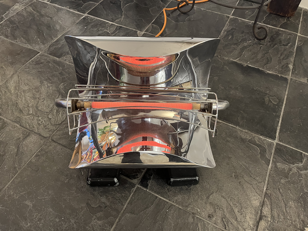

Alan Ambrose Posted January 17, 2025 Posted January 17, 2025 (edited) OK hold my beer.... Get your sparks to disconnect and measure the cold resistance of a heater and the voltage you actually have there on no-load (or if they're lazy, just assume 230V). Divide one by the other and that's your inrush current. If you've ever seen an old fashioned resistance heater heat up, you'll remember it takes a minute or so to do that. That is, much longer than any RCBO curve, which are designed for machinery in-rush currents. While it's heating up, the resistance goes up and the current goes down ... until it reaches a steady state. Measure the current at this stage with a clamp meter and you'll know the steady-state current (and hot resistance come to that). Now you've got inrush current and steady-state current. Just size your MCBs/RCBOs accordingly to fit the inrush current (actually cold-state current - there's not really an inrush currrent - that is usually associated with sub-1s timescale). Yeah, probably 20A, but worth checking to avoid further problems. BTW, worth the sparks checking the nominal power of the heaters - on a 16A trip, each is probably 3kW. Yeah, I appreciate they probably dont glow... Edited January 17, 2025 by Alan Ambrose 1
