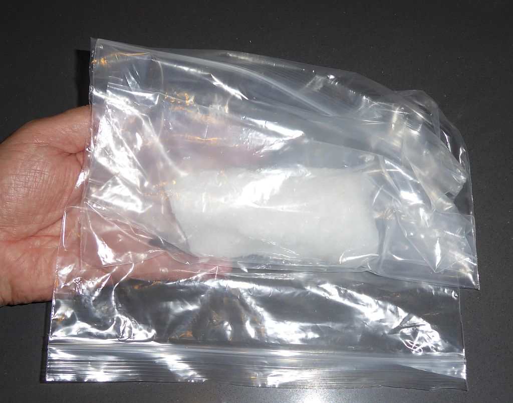

Jeremy Harris Posted January 17, 2025 Author Posted January 17, 2025 33 minutes ago, SteamyTea said: Can you get it analysed to find out what is in it. We have a lazer spectroscope thinking at work, not sure if it does all chemicals or just metals, never tried it out. I could post you a lump of it easily enough. I've got a few bits sat in a box here from the big icicle of the stuff that formed down the rear of the case.

Jeremy Harris Posted January 17, 2025 Author Posted January 17, 2025 34 minutes ago, SteamyTea said: Going up country tomorrow, so almost passing your place if you are about. We've got a couple of things on tomorrow, but if you know roughly when you might be around I'm sure I can be in. Not sure how big a lump you would like, this is the largest of the bits I've kept:

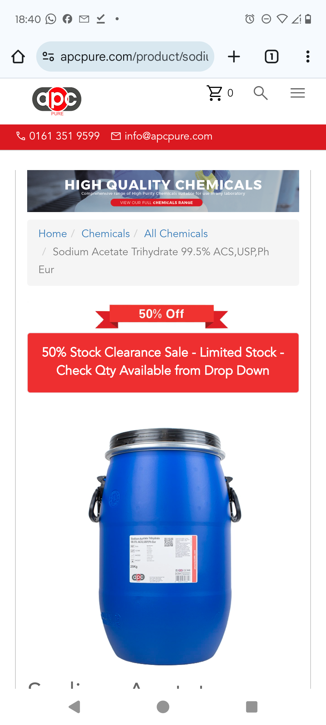

Onoff Posted January 17, 2025 Posted January 17, 2025 Around £230 for 25kg and it comes with it's own plastic containment vessel! If there's space for expansion inside the Sunamp then how does it expand / rupture? For some reason I always thought the PCM was contained in a vacuum, is it?

Nickfromwales Posted January 17, 2025 Posted January 17, 2025 15 minutes ago, Onoff said: Around £230 for 25kg and it comes with it's own plastic containment vessel! I'll drop the wife's hair straighteners in that, poke 3 holes in the top, and name it "Sanump". Dragons Den here I come. 1
JohnMo Posted January 17, 2025 Posted January 17, 2025 15 minutes ago, Onoff said: Around £230 for 25kg and it comes with it's own plastic containment vessel! If there's space for expansion inside the Sunamp then how does it expand / rupture? For some reason I always thought the PCM was contained in a vacuum, is it? Think if you mix with Agar Agar, the solidification process becomes more repeatable and repeatable over time

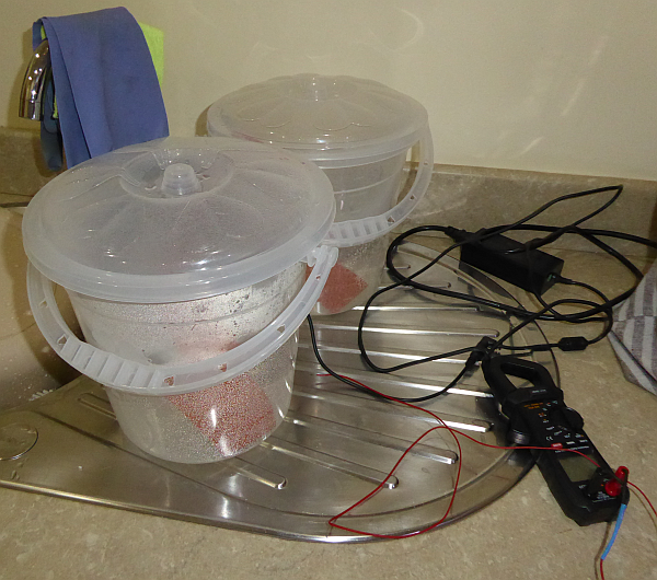

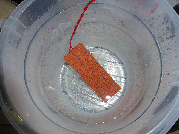

Jeremy Harris Posted January 17, 2025 Author Posted January 17, 2025 17 minutes ago, Mike said: I have just such a system: one 20L electric tea urn + a rechargeable camping shower - total cost around £100, no plumbing required Funnily enough I ordered one of those USB rechargeable camping showers 2 days ago! To get warm water for a shower I put together a Heath Robinson arrangement using stuff I had around, two spare 20W, 12V silicone rubber heating mats (I had to buy four when I only needed one for a bag warmer), a 6A, 12V power supply and a couple of 5 litre lidded buckets. This worked very well, the heaters were plonked into each bucket and left on all night. By the morning we had two buckets of water at around 38°C, which was fine for a sort of cup-over-head type shower. we could have filled them from the boiling water tap, as the boiler for that holds 20 litres, but that would have meant carrying the buckets upstairs, which seemed like too much effort first thing in the morning! The bucket warming experiment, before I set them up properly upstairs: 2

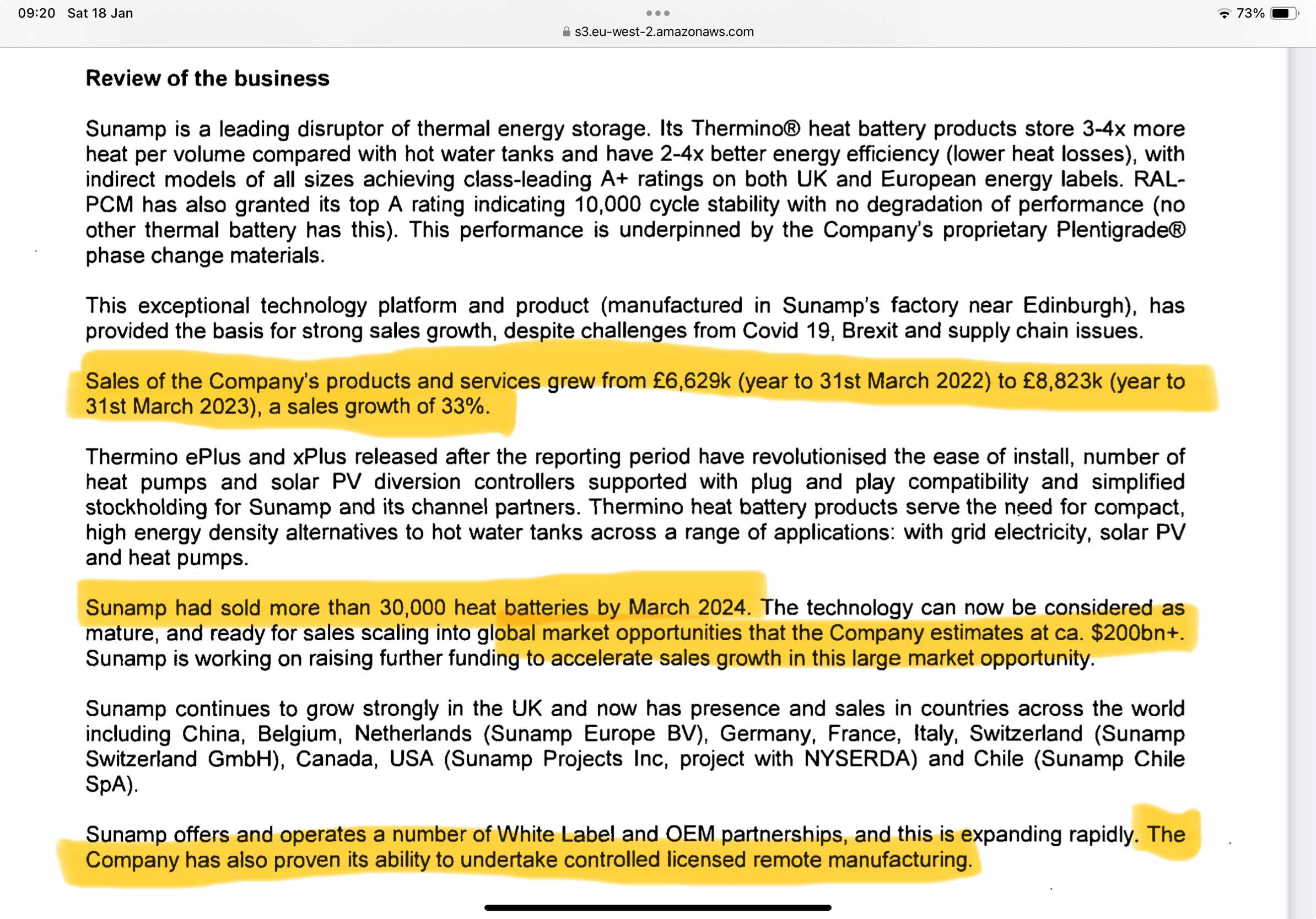

Barney12 Posted January 18, 2025 Posted January 18, 2025 13 hours ago, Nickfromwales said: Met a chap at a public show who’d just paid £14k for 2x Thermino 210 units (replacement names for the old 9’s) and I almost keeled over. WTF. Here’s an extract from their accounts. Some impressive numbers which perhaps underlines that self build won’t even be registering in their core marketing plans. However, if the failure rate of units on this forum is representative of all sales then they have an eye watering legacy cost. I suspect they will be doing everything they can to reduce those costs (I.e. not paying!) thus I think @Jeremy Harris has had a great result. I read a book last week (which I’d highly recommend) called “Supremacy: AI, ChatGPT and the Race That Will Change the World”. I seem to remember it mentioned that using general release of products early and let let Jo public be the testers was now a completely acceptable risk. Anyway making a profit is so last year 😀, it’s all about the exit. 1
Jeremy Harris Posted January 18, 2025 Author Posted January 18, 2025 1 hour ago, Barney12 said: I read a book last week (which I’d highly recommend) called “Supremacy: AI, ChatGPT and the Race That Will Change the World”. I seem to remember it mentioned that using general release of products early and let let Jo public be the testers was now a completely acceptable risk. Anyway making a profit is so last year 😀, it’s all about the exit. This approach of releasing immature products to the market and allowing the early adopters to test them is now the norm with some cars, too, it seems. I made the massive mistake of buying a new Tesla Model 3 in 2019, when it was first available here. That car had so many manufacturing defects, mostly down to process control (or the absence of) and poor software that clearly hadn't been fully tested, that it had to get taken back to the nearest Tesla service centre 6 times during my first few months of ownership. Given that this was a ~150 mile round trip each time I ended up sick and tired of the thing, so sold it after 14 months (and I'd never buy another one). Its replacement was a car that had been in production for three years, and it showed. Zero defects or issues in three years of ownership. The moral of this story is to never, ever, buy a brand new product. It's not a new thing, either. There's an old saying in aviation "Never fly the Mk 1 of anything". It does seem that technology companies, in particular, are far too willing to inconvenience early adopters, though. 2
