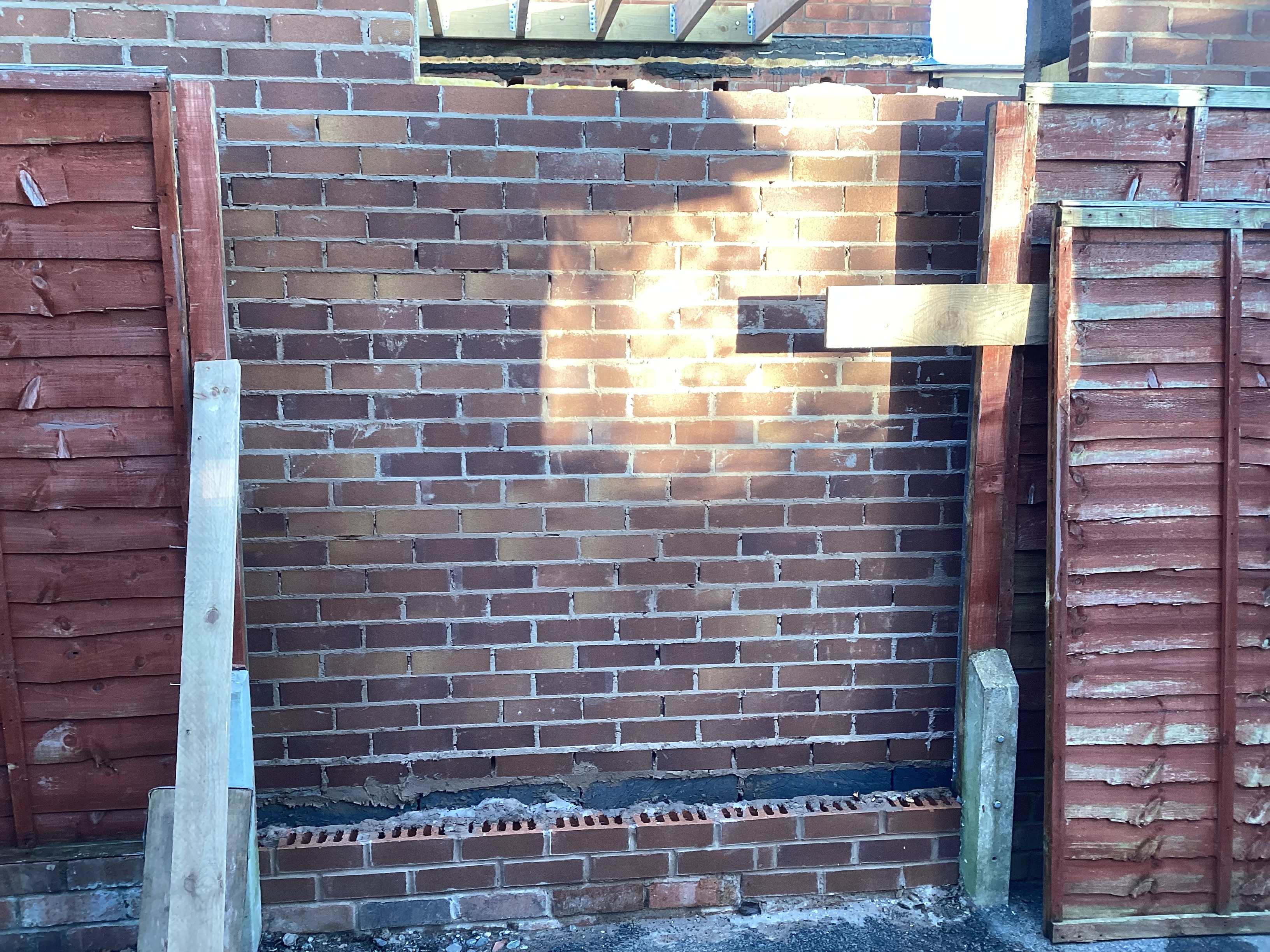

I am being told that this wall being built next to our extension is of sufficient standard to pass building control and the test of time. I have challenged the builder who assured me it will pass building regulations !
Posted (edited)
It is part of a 13 meter wall that is going to be a two storey side/ rear building extension with a gable end and a pitched roof . It is being built by an individual small builder and monitored by Stroma building control . Hope this helps?

So this is the outer leaf of a cavity wall your neighbour is building? It's shit brickwork but if it's not yours and fence panels will cover it then where's the issue? Did you allow them access to build from your side or did the brickies have to build from the other side?

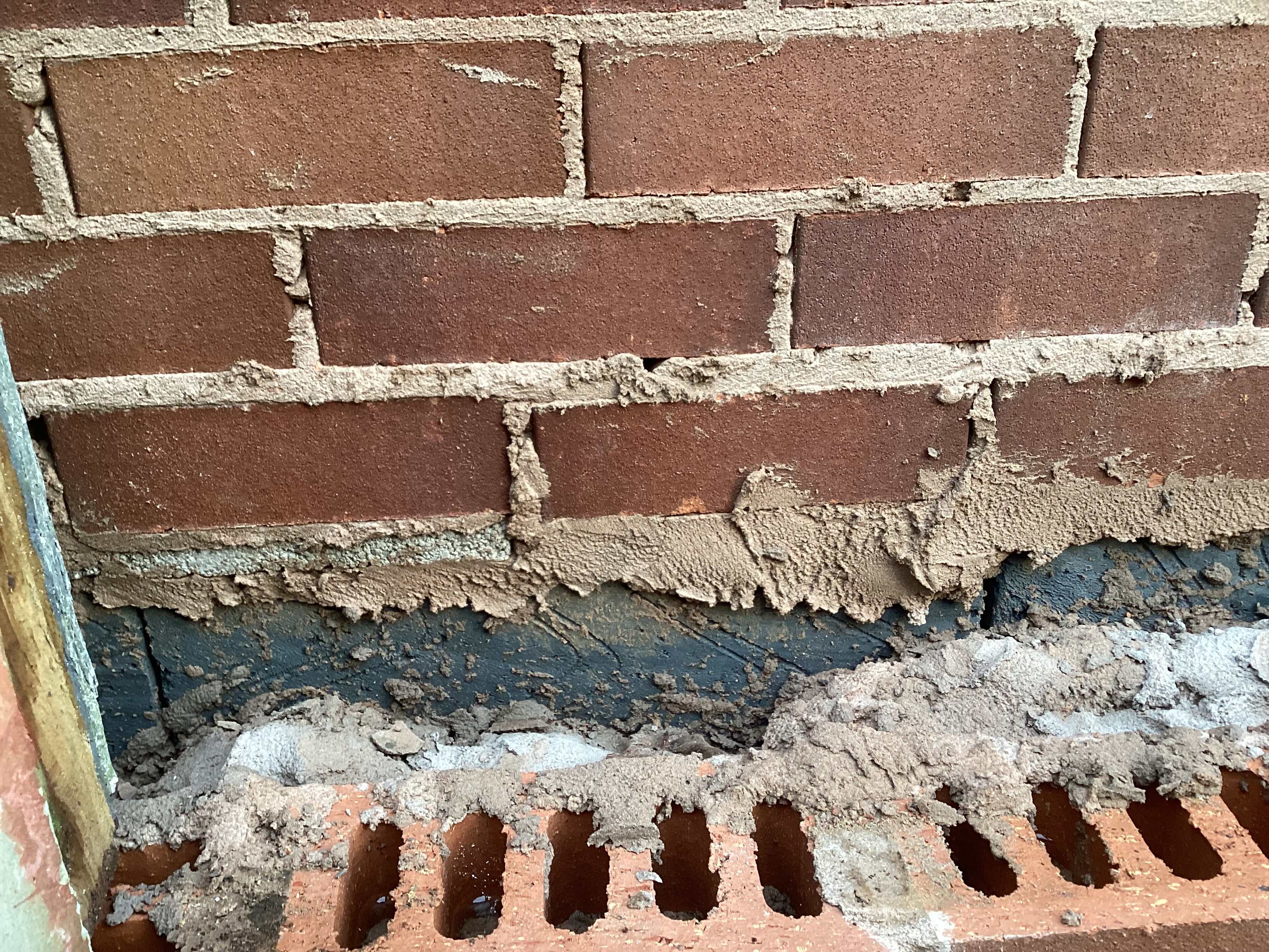

Fencing is coming down . Bricks in the bottom picture are a boundary wall that the builder damaged whilst building the footings for the wall behind it. The wall behind that you can see in the other pictures is the outer skim of the neighbours 2 storey wall.
Posted
It looks like they built it overhand as they did not have access.  When the fence is down they could point it up or render it if you allow them access.

It is sloppy, even for overhand work. I'd approach the BCO and suggest that it contravenes Part 7 (b):
Materials and workmanship
7.—Building work shall be carried out—
(a)with adequate and proper materials which—
(i)are appropriate for the circumstances in which they are used,
(ii)are adequately mixed or prepared, and
(iii)are applied, used or fixed so as adequately to perform the functions for which they are designed; and
(b)in a workmanlike manner.

Or, more discretely as it's not your problem, just inform the neighbour and allow him to take it up with the BCO.
I'm not saying it's good, but I've seen far worse from 'brick technicians' laying overhand.
An old-fashioned time-served craftsman 'brickie' would find this unacceptable, but there can't be more than a handful of breeding pairs left in the country... probably extinct by the end of this year!

If there are concerns about longevity of this wall, your neighbour ought to be even more concerned than you are. I'd start by talking to them and offer access to your side for the builder to improve it.
  • Like 2
Posted

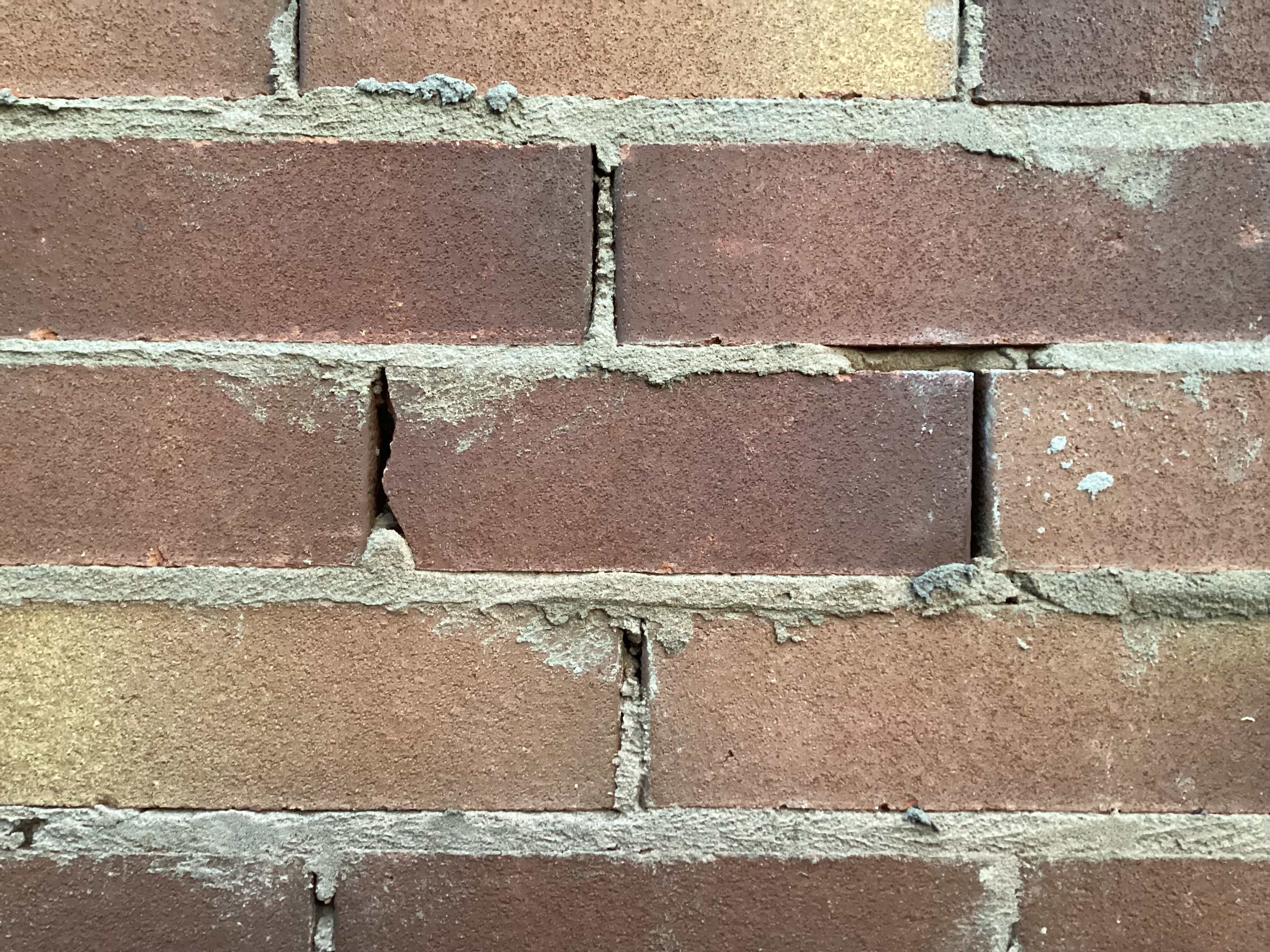

Neighbour is 86 and doesn’t appear to be concerned about what is occurring, presume he’s here for a good time now not a long time! Referring back to the original question which nobody seems to answer, will it pass building regulations with the damp proof course bridged or not there and large gaps in the mortar beds and sometimes no mortar in the perps and without any pointing?

It’s down to opinion unless the BCO is called to site as a complaint? It doesn’t have to look pretty to be functional, in a nutshell. Damp course being bridged = not your concern…perps missing or poorly executed = not your concern…
If it falls over and squashes you, then it becomes your concern. You claim on their insurance, after the event.
Once the fence goes back up, do you actually care about this? I can’t see why you would, but if it’s an eye-sore then just add a trellis header to the fence and worry about things more important to you?
Please don’t read that as me being sarcastic, I am not, just perhaps a reality check and taking you off the boil to reevaluate ;)

Thanks nick. Was hoping the fence wouldn’t be needed when the wall was built as it’s so close to the boundary. Our real concern is we want this house to be a forever home and the higher the wall gets the worse the workmanship and I can’t see it lasting the test of time. This will no doubt become our issue after the neighbour has gone and it needs replacing in the future as over half this wall is alongside our house and is not accessible to carry out repairs from either side!
