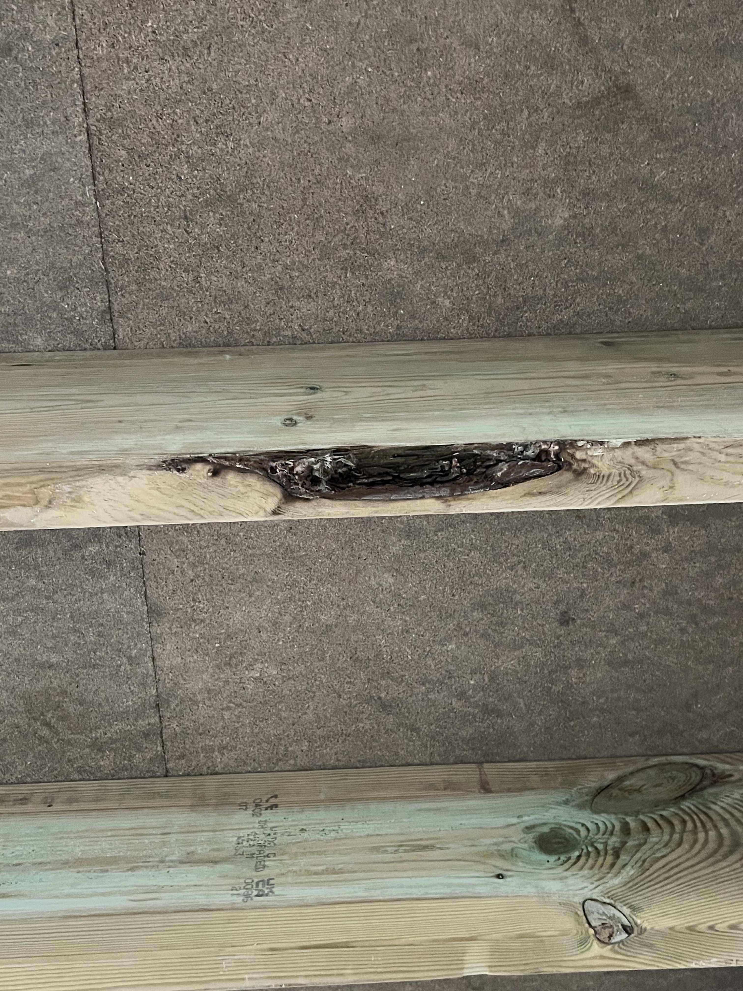

Firsttimereno Posted Sunday at 12:01 Share Posted Sunday at 12:01 We’re having a loft conversion done and noticed one of the timbers used appears a bit rotten? Should we ask for this to be changed? Link to comment Share on other sites More sharing options...
Marvin Posted Sunday at 12:06 Share Posted Sunday at 12:06 How deep are the joists. How deep is the hole. Link to comment Share on other sites More sharing options...
ToughButterCup Posted Sunday at 12:09 Share Posted Sunday at 12:09 I don't think that's rotten. If that timber has the same grading stamp as the one next to it - '.... CE [...] CERTIFIED UK ' etc. then don't worry. You might want to double - up (sister) that timber though out of caution. Link to comment Share on other sites More sharing options...
joe90 Posted Sunday at 12:12 Share Posted Sunday at 12:12 (edited) +1 that’s rot, Just a natural defect in the tree and I wouldn’t worry about it, timbers are always over sized. Edited Sunday at 12:13 by joe90 Link to comment Share on other sites More sharing options...
ProDave Posted Sunday at 12:24 Share Posted Sunday at 12:24 If I had received that bit of timber from the merchant, I would either have rejected it, or chosen to use that particular piece in a place where it was being cut into short lengths. Same as I do for a warped bit of timber. Link to comment Share on other sites More sharing options...
Russell griffiths Posted Sunday at 13:12 Share Posted Sunday at 13:12 The timber should all be graded either c16 or c24 the grading takes place and the timber is marked up to state it’s grading. if this looks like damage that was caused as the tree grew then it was graded then it’s fine it passed, if it looks like damage caused by the guys on site after it was graded, then it’s fine would now be below grade and should be changed. that looks like a natural anomaly as the tree has grown so as long as it’s got it’s correct markings on it, it should be fine. Link to comment Share on other sites More sharing options...
saveasteading Posted Sunday at 14:09 Share Posted Sunday at 14:09 That never passed a grade test by machine or inspection. I was told by a timber importer that they had quality issues with Russian timber where rotten timber would be concealed in the centre of a bundle. The strength grading would be dubious too, and I think the merchant did their own grading. That would be 1990s. Maybe one of those. Link to comment Share on other sites More sharing options...
